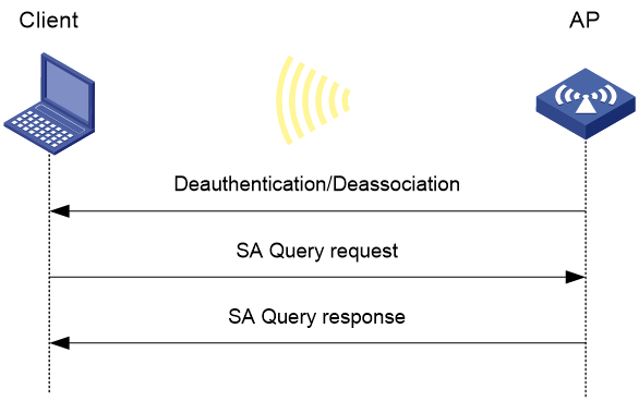

Open system authentication

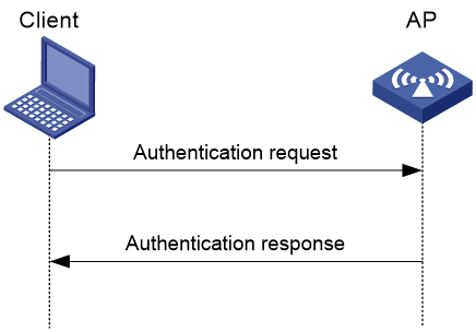

Open system authentication is the default and simplest authentication algorithm. Any client that requests authentication by using this algorithm can pass the authentication.
Open system authentication uses the following process:
1.     The client sends an authentication request to the AP.
2.     The AP sends an authentication response to the client after the client passes the authentication.
Figure 1 Open system authentication process

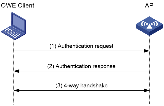

Shared key authentication

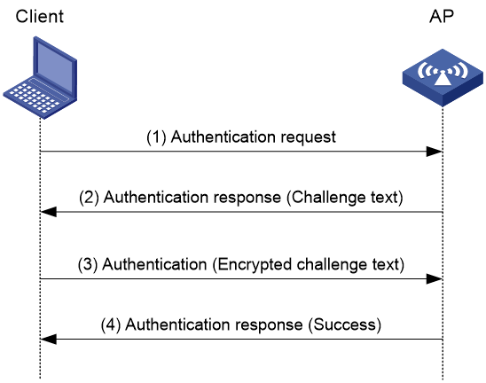

Shared key authentication uses a WEP key for the AP and client to complete authentication.
Shared key authentication uses the following process:
2.     The AP randomly generates a challenge text and sends it to the client.
3.     The client uses the WEP key to encrypt the challenge text and sends it to the AP.
4.     The AP uses the WEP key to decrypt the challenge text and compares the decrypted challenge text with the original challenge text. If they are identical, the client passes the authentication. If they are not, the authentication fails.
Figure 2 Shared key authentication process

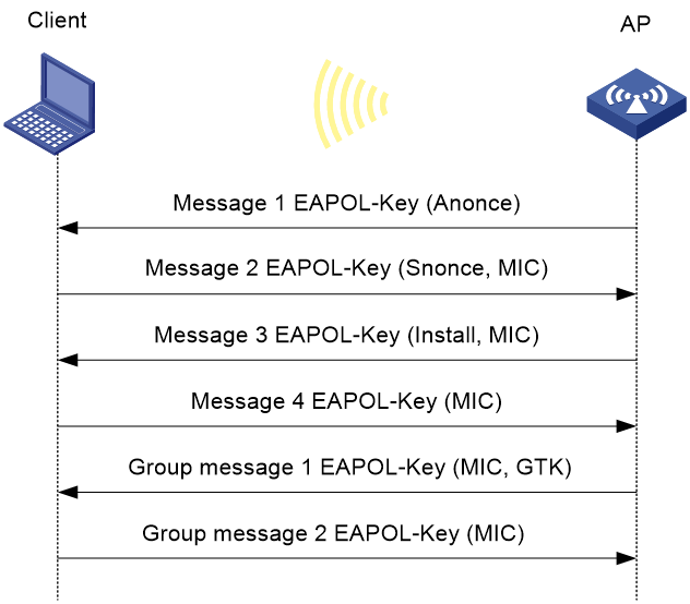

RSN key negotiation
RSN uses EAPOL-Key packets in the four-way handshake to negotiate the PTK and the GTK.
Figure 6 RSN key negotiation process
RSN key negotiation uses the following process:
1.     The AP sends the client EAPOL-Key message 1 that contains a random value ANonce.
2.     The client performs the following operations:
a.     Uses the random value SNonce, ANonce, and PMK to generate a PTK by using the KDF.
b.     Uses the KCK in the PTK to generate the MIC.
c.     Returns EAPOL-Key message 2 that contains the SNonce and MIC.
3.     The AP performs the following operations:
a.     Uses the SNonce, ANonce, and PMK to generate a PTK by using the KDF.
c.     Compares the received MIC with the local MIC.
d.     Generates a GTK with the random GMK and MAC address of the AP by using the KDF if the two MICs are the same.
e.     Returns EAPOL-Key message 3 that contains the key installation request tag, MIC, and GTK.
4.     The client performs the following operations:
a.     Compares the received MIC with the local MIC.
b.     Installs the PTK and GTK if the two MICs are the same.
c.     Returns EAPOL-Key message 4 that contains the MIC.
5.     The AP performs the following operations:

Active SA query
As shown in Figure 7, active SA query uses the following process:
1.     The client sends an association or reassociation request to the AP.
2.     Upon receiving the request, the AP sends a response to inform the client that the request is denied and the client can associate at a later time. The response contains the association comeback time.
3.     The AP sends an SA query request to verify the status of the client:
¡     If the AP receives an SA query response within the timeout time, it considers the client online.
¡     If the AP does not receive an SA query response within the timeout time, it sends another SA query request. If the AP receives an SA query response within the retransmission time, it considers the client online. The AP does not respond to any association or reassociation requests from the client until the association comeback time times out.
¡     If the AP does not receive an SA query response within the retransmission time, it considers the client offline and allows the client to reassociate.
Figure 7 Active SA query process
Passive SA query
As shown in Figure 8, passive SA query uses the following process:
1.     The client triggers the SA query process upon receiving an unencrypted disassociation or deauthentication frame.
2.     The client sends an SA query request to the AP.
3.     The AP sends an SA query response to the client:
¡     If the client receives the response, the client determines that the AP is online and does not process the disassociation or deauthentication frame.
¡     If the client does not receive a response, the client determines that the AP is offline and disassociates with the AP.
Figure 8 Passive SA query process

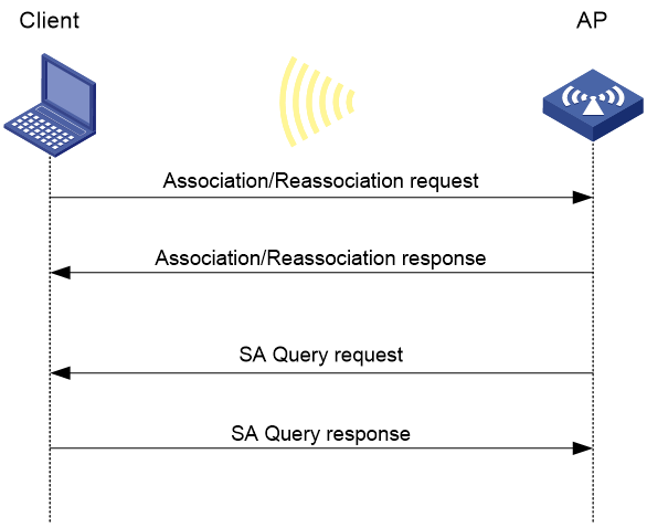

Enhanced open system authentication
Enhanced open system authentication uses Opportunistic Wireless Encryption (OWE) to negotiate keys for encrypting data packets of OWE-capable clients, providing open system authentication with enhanced security performance.
Enhanced open system authentication uses the following procedure:
2.     The AP determines that the client can pass wireless link layer authentication and sends an authentication response to the client to notify the client of the authentication success.
3.     The client and the AP perform 4-way handshake to generate a key for encryption.
Figure 9 Enhanced open system authentication process

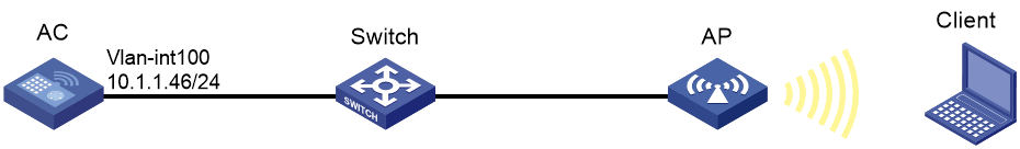

WLAN security configuration examples
Example: Configuring shared key authentication
As shown in Figure 10, the switch functions as a DHCP server to assign IP addresses to the AP and client. Configure shared key authentication to enable the client to access the network by using WEP key 12345.
Figure 10 Network diagram
# Create a WLAN service template named service1.
<AC> system-view
[AC] wlan service-template service1
# Specify an SSID of service for the service template.
[AC-wlan-st-service1] ssid service
# Configure a WEP40 plaintext key of 12345 as WEP key 2, and apply WEP key 2.
[AC-wlan-st-service1] cipher-suite wep40
[AC-wlan-st-service1] wep key 2 wep40 pass-phrase simple 12345
[AC-wlan-st-service1] wep key-id 2
# Enable service template service1.
[AC-wlan-st-service1] service-template enable
[AC-wlan-st-service1] quit
# Create an AP named ap1 and specify the model and serial ID.
[AC] wlan ap ap1 model WA6320
[AC-wlan-ap-ap1] serial-id 219801A28N819CE0002T
# Bind service template service1 to radio 1 of the AP and enable radio 1.
[AC-wlan-ap-ap1] radio 1
[AC-wlan-ap-ap1-radio-1] service-template service1
[AC-wlan-ap-ap1-radio-1] radio enable
[AC-wlan-ap-ap1-radio-1] return
# Use the display wlan service-template command to verify that the WLAN service template has been configured correctly.

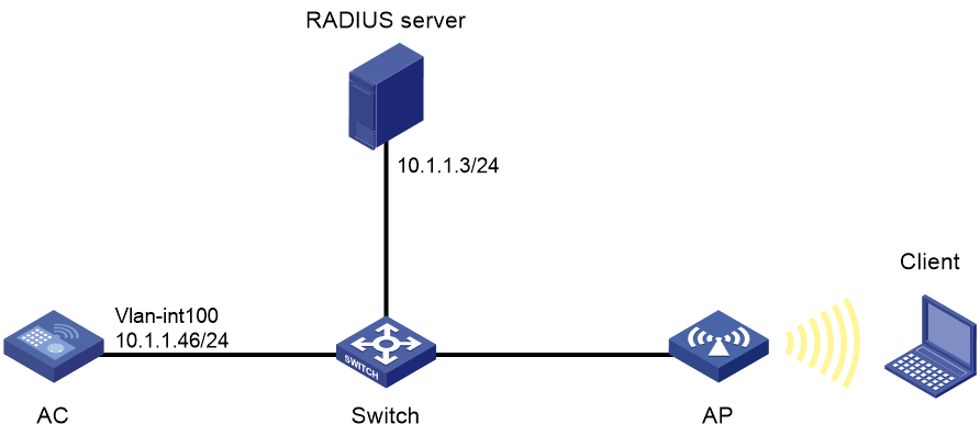

Example: Configuring PSK authentication and bypass authentication
As shown in Figure 11, the switch functions as a DHCP server to assign IP addresses to the AP and client.
·     Configure open system authentication and bypass authentication.
·     Configure the client to use preshared key 12345678 to access the network.
Figure 11 Network diagram

Example: Configuring PSK authentication and MAC authentication
As shown in Figure 12, the switch functions as a DHCP server to assign IP addresses to the AP and client.
·     Configure open system authentication and MAC authentication so that the client can access the network by using login username abc and password 123.
Figure 12 Network diagram

Example: Configuring 802.1X AKM
As shown in Figure 13, the switch functions as a DHCP server to assign IP addresses to the AP and client.
·     Configure open system authentication and 802.1X authentication so that the client can access the network by using login username abcdef and password 123456.
·     Configure 802.1X as the AKM mode.
Figure 13 Network diagram
1.     Configure a username of abcdef and a password of 123456 on the RADIUS server and make sure the RADIUS server and AC can reach each other. (Details not shown.)
2.     Configure the 802.1X client.
<AC> system-view
[AC] dot1x
[AC] dot1x authentication-method eap
3.     Create a WLAN service template named service1.
4.     Specify an SSID of service for the service template.
5.     Configure WLAN security for service template service1:
# Configure 802.1X as the AKM mode.
[AC-wlan-st-service1] akm mode dot1x
# Configure CCMP as the cipher suite and WPA as the security IE.
[AC-wlan-st-service1] cipher-suite ccmp
[AC-wlan-st-service1] security-ie wpa
# Configure the 802.1X authentication mode.
[AC-wlan-st-service1] client-security authentication-mode dot1x
6.     Enable service template service1.
7.     Configure a RADIUS scheme:
# Create a RADIUS scheme named radius1 and enter its view.
[AC] radius scheme radius1
# Specify the primary authentication server and accounting server.
[AC-radius-radius1] primary authentication 10.1.1.3 1812
[AC-radius-radius1] primary accounting 10.1.1.3 1813
# Set the shared keys for authentication and accounting to 12345 in plaintext.
[AC-radius-radius1] key authentication simple 12345
[AC-radius-radius1] key accounting simple 12345
# Set the format for the usernames sent to the RADIUS server based on the RADIUS server configuration:
¡     Exclude domain names from the usernames sent to the RADIUS server.
[Device-radius-rs1] user-name-format without-domain
[Device-radius-rs1] quit
¡     Include domain names in the usernames sent to the RADIUS server.
[Device-radius-rs1] user-name-format with-domain
8.     Create an ISP domain named dom1 and configure a RADIUS scheme for the ISP domain.
[AC] domain dom1
[AC-isp-dom1] authentication lan-access radius-scheme radius1
[AC-isp-dom1] authorization lan-access radius-scheme radius1
[AC-isp-dom1] accounting lan-access radius-scheme radius1
[AC-isp-dom1] quit
9.     Configure ISP domain dom1 as the default ISP domain.
[AC] domain default enable dom1
10.     Create an AP named ap1 and specify the model and serial ID.
11.     Bind service template service1 to radio 1 of the AP and enable radio 1.
For more information about the AAA and RADIUS commands in this section, see User Access and Authentication Command Reference.
<AC> display wlan service-template service1 verbose
Service template name                            : service1

Example: Configuring management frame protection
As shown in Figure 14, the switch functions as a DHCP server to assign IP addresses to the AP and client.
·     Configure the CCMP cipher suite, RSN security IE, and management frame protection.
Figure 14 Network diagram
1.     Create a WLAN service template named service1.
<AC> system-view
2.     Specify an SSID of service for the service template.
3.     Configure management frame protection:
# Enable management frame protection in optional mode.
[AC-wlan-st-service1] pmf optional
# Set the KDF to sha1-and-sha256.
[AC-wlan-st-service1] key-derivation sha1-and-sha256
4.     Configure the 802.11i mechanism:
# Configure the PSK AKM mode and the 12345678 plaintext key.
[AC-wlan-st-service1] akm mode psk
[AC-wlan-st-service1] preshared-key pass-phrase simple 12345678
# Configure CCMP as the cipher suite and RSN as the security IE.
[AC-wlan-st-service1] security-ie rsn
5.     Enable service template service1.
6.     Create an AP named ap1 and specify the model and serial ID.
[AC-wlan-ap-ap1] serial-id 219801A0CNC138011454
7.     Bind service template service1 to radio 1 of the AP and enable radio 1.

Example: Configuring dynamic WEP
As shown in Figure 15, the switch functions as a DHCP server to assign IP addresses to the AP and client.
·     Configure dynamic WEP.
Figure 15 Network diagram
2.     Configure the 802.1X client. (Details not shown.)
<AC> system-view
5.     Enable dynamic WEP.
[AC-wlan-st-service1] wep mode dynamic
6.     Configure the 802.1X authentication mode.
7.     Enable service template service1.
8.     Configure a RADIUS scheme:
9.     Create an ISP domain named dom1 and configure a RADIUS scheme for the ISP domain.
[AC] domain dom1
[AC-isp-dom1] quit
10.     Configure ISP domain dom1 as the default ISP domain.
11.     Create an AP named ap1 and specify the model and serial ID.
12.     Bind service template service1 to radio 1 of the AP and enable radio 1.
Description                                      : Not configured
SSID                                             : service
SSID-hide                                        : Disabled
User-isolation                                   : Disabled
Service template status                          : Enabled
Maximum clients per BSS                          : 64
Frame format                                     : Dot3
Seamless roam status                             : Disabled
Seamless roam RSSI threshold                     : 50
Seamless roam RSSI gap                           : 20
VLAN ID                                          : 1
AKM mode                                         : Not configured
Security IE                                      : Not configured
Cipher suite                                     : WEP104
WEP key ID                                       : 1
TKIP countermeasure time                         : 0
PTK lifetime                                     : 43200 sec
PTK rekey                                        : Enabled
GTK rekey                                        : Enabled
GTK rekey method                                 : Time-based
GTK rekey time                                   : 86400 sec
GTK rekey client-offline                         : Enabled
WPA3 status                                      : Disabled
PPSK                                             : Disabled
PPSK Fail Permit                                 : Enabled
Enhance-open status                              : Disabled
Enhanced-open transition-mode service-template   : N/A
User authentication mode                         : 802.1X
Intrusionprotection                              : Disabled
Intrusionprotection mode                         : Temporary-block
Temporary block time                             : 180 sec
Temporaryservicestop time                        : 20 sec
Fail VLAN ID                                     : Not configured
802.1X handshake                                 : Disabled
802.1X handshake secure                          : Disabled
802.1X domain                                    : Not configured
MAC-auth domain                                  : Not configured
Max 802.1X users per BSS                         : 4096
Max MAC-auth users per BSS                       : 4096
802.1X re-authenticate                           : Disabled
Authorization fail mode                          : Online
Accounting fail mode                             : Online
Authorization                                    : Permitted
Key derivation                                   : N/A
PMF status                                       : Disabled
Hotspot policy number                            : Not configured
Forwarding policy status                         : Disabled
Forward policy                                   : Not configured
Forwarder                                        : AC
FT status                                        : Disabled
QoS trust                                        : Port
QoS priority                                     : 0
Example: Configuring private PSK authentication and MAC authentication
As shown in Figure 16, the switch functions as a DHCP server to assign IP addresses to the AP and client.
·     Configure the MAC authentication mode so that the client can access the network by using its MAC address as the login username and password.
·     Configure the private PSK AKM mode so that the client can use its MAC address as the PSK.
Figure 16 Network diagram
1.     Configure a username of 00-23-12-45-67-7a and a password of 00-23-12-45-67-7a on the RADIUS server and make sure the RADIUS server and AC can reach each other. (Details not shown.)
2.     Create a WLAN service template named service1.
<AC> system-view
3.     Specify an SSID of service for the service template.
4.     Configure WLAN security for service template service1:
# Configure private PSK as the AKM mode.
# Configure MAC authentication.
[AC-wlan-st-service1] client-security authentication-mode mac

6.     Configure a RADIUS scheme:
# Set the shared keys for authentication and accounting to 12345678 in plaintext.
[AC-radius-radius1] key authentication simple 12345678
[AC-radius-radius1] key accounting simple 12345678
7.     Create an ISP domain named dom1 and configure a RADIUS scheme for the ISP domain.
[AC] domain dom1
[AC-isp-dom1] quit
8.     Configure the MAC address as the username and password for ISP domain dom1.
[AC] mac-authentication domain dom1
[AC] mac-authentication user-name-format mac-address with-hyphen lowercase
9.     Create an AP named ap1 and specify the model and serial ID.
10.     Bind service template service1 to radio 1 of the AP and enable radio 1.
