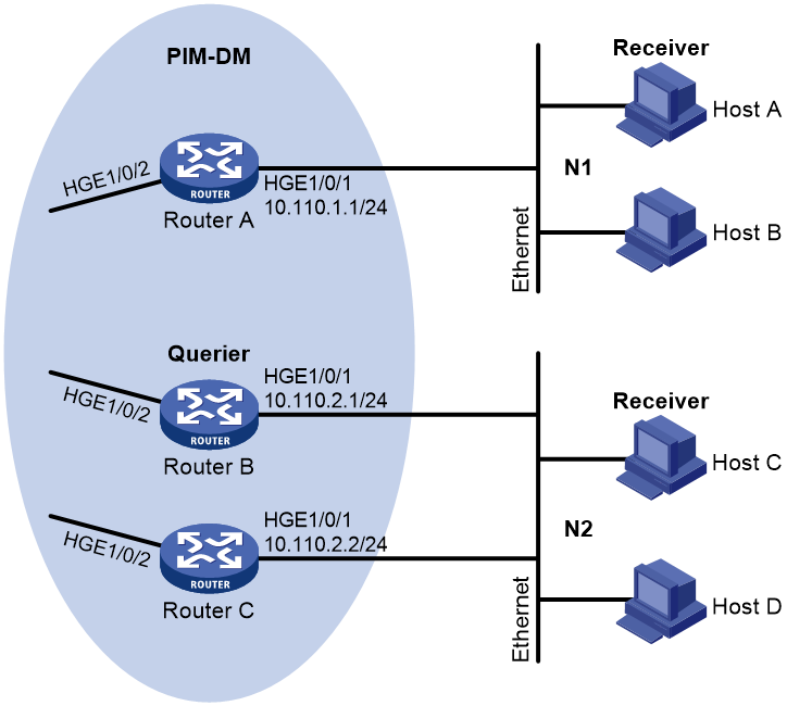

All devices that run IGMP on the same subnet can get IGMP membership report messages (called reports) from hosts. However, only one device can act as the IGMP querier to send IGMP query messages (called queries). The querier election mechanism determines which device acts as the IGMP querier on the subnet.
In IGMPv1, the DR elected by the multicast routing protocol (such as PIM) acts as the IGMP querier. For more information about DR, see "Configuring PIM."
Figure 1 IGMP queries and reports
As shown in Figure 1, Host B and Host C are interested in the multicast data addressed to the multicast group G1. Host A is interested in the multicast data addressed to G2. The following process describes how the hosts join the multicast groups and how the IGMP querier (Device B in Figure 1) maintains the multicast group memberships:
1.     The hosts send unsolicited IGMP reports to the multicast groups they want to join without having to wait for the IGMP queries.
2.     The IGMP querier periodically multicasts IGMP queries (with the destination address of 224.0.0.1) to all hosts and devices on the local subnet.
3.     After receiving a query message, the host whose report delay timer expires first sends an IGMP report to multicast group G1 to announce its membership for G1. In this example, Host B sends the report message. After receiving the report from Host B, Host C suppresses its own report for G1.
Because IGMP devices already know that G1 has a minimum of one member, other members do not need to report their memberships. This mechanism, known as the host IGMP report suppression, helps reduce traffic on the local subnet.
4.     At the same time, Host A sends a report to the multicast group G2 after receiving a query.
5.     Through the query and response process, the IGMP devices (Device A and Device B) determine that the local subnet has members of G1 and G2. The multicast routing protocol (PIM, for example) on the devices generates (*, G1) and (*, G2) multicast forwarding entries, where asterisk (*) represents any multicast source. These entries are the basis for subsequent multicast forwarding.
6.     When the multicast data addressed to G1 or G2 reaches an IGMP device, the device looks up the multicast forwarding table. Based on the (*, G1) or (*, G2) entries, the device forwards the multicast data to the local subnet. Then, the receivers on the subnet can receive the data.

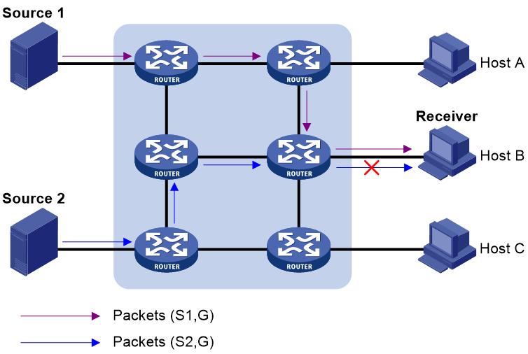

As shown in Figure 2, the network has two multicast sources: Source 1 (S1) and Source 2 (S2). Both of these sources can send multicast data to the multicast group G. Host B wants to receive the multicast data addressed to G from Source 1 but not from Source 2.
Figure 2 Flow paths of source-and-group-specific multicast traffic
In IGMPv1 or IGMPv2, Host B cannot select multicast sources when it joins the multicast group G. The multicast streams from both Source 1 and Source 2 flow to Host B whether or not it needs them.
In IGMPv3, Host B can explicitly express that it needs to receive multicast data destined to the multicast group G from Source 1 but not from Source 2.

Example: Configuring basic IGMP features
As shown in Figure 5:
·     OSPF and PIM-DM run on the network.
·     VOD streams are sent to receiver hosts in multicast. Receiver hosts of different organizations form stub networks N1 and N2. Host A and Host C are receiver hosts in N1 and N2, respectively.
·     IGMPv2 runs between Router A and N1, and between the other two routers and N2. Router A acts as the IGMP querier in N1. Router B acts as the IGMP querier in N2 because it has a lower IP address.
Configure the routers to meet the following requirements:
·     The hosts in N1 can join only multicast group 224.1.1.1.
·     The hosts in N2 can join any multicast groups.
Figure 5 Network diagram
Assign an IP address and subnet mask to each interface, and configure OSPF on the routers in the PIM-DM domain.

# Display IGMP information for HundredGigE 1/0/1 on Router B.
[RouterB] display igmp interface hundredgige 1/0/1
 HundredGigE1/0/1(10.110.2.1):
   IGMP is enabled.
   IGMP version: 2
   Query interval for IGMP: 125s
   Other querier present time for IGMP: 255s
   Maximum query response time for IGMP: 10s
   Querier for IGMP: 10.110.2.1 (This router)
  IGMP groups reported in total: 1
Example: Configuring IGMP SSM mapping
As shown in Figure 6:
·     OSPF runs on the network.
·     The PIM-SM domain uses the SSM model for multicast delivery. The SSM group range is 232.1.1.0/24.
·     IGMPv3 runs on HundredGigE 1/0/1 on Router D. The receiver host runs IGMPv2, and does not support IGMPv3. The receiver host cannot specify multicast sources in its membership reports.
·     Source 1, Source 2, and Source 3 send multicast packets to multicast groups in the SSM group range 232.1.1.0/24.
Configure the IGMP SSM mapping feature on Router D so that the receiver host can receive multicast data only from Source 1 and Source 3.
Figure 6 Network diagram

Assign an IP address and subnet mask to each interface, and configure OSPF on the routers in the PIM-SM domain.

2.     Configure the SSM group range:
# On Router D, specify 232.1.1.0/24 as the SSM group range.
[RouterD] acl basic 2000
[RouterD-acl-ipv4-basic-2000] rule permit source 232.1.1.0 0.0.0.255
[RouterD-acl-ipv4-basic-2000] quit
[RouterD] pim
[RouterD-pim] ssm-policy 2000
[RouterD-pim] quit
# Configure the SSM group range on Router A, Router B, and Router C in the same way Router D is configured. (Details not shown.)
3.     Configure IGMP SSM mappings on Router D.
[RouterD] igmp
[RouterD-igmp] ssm-mapping 133.133.1.1 2000
[RouterD-igmp] ssm-mapping 133.133.3.1 2000
[RouterD-igmp] quit
# On Router D, display IGMP SSM mappings for multicast group 232.1.1.1 on the public network.
[RouterD] display igmp ssm-mapping 232.1.1.1
 Group: 232.1.1.1
 Source list:
        133.133.1.1
        133.133.3.1
