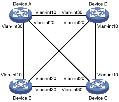

As shown in Figure 4, the same level routers on a network, including non-DIS routers, establish adjacency with each other.
Figure 4 DIS in the IS-IS broadcast network
The DIS creates and updates pseudonodes, and generates LSPs for the pseudonodes, to describe all routers on the network.
A pseudonode represents a virtual node on the broadcast network. It is not a real router. In IS-IS, it is identified by the system ID of the DIS and a 1-byte Circuit ID (a non-zero value).
Using pseudonodes simplifies network topology and can reduce the amount of resources consumed by SPF.
On an IS-IS broadcast network, all routers establish adjacency relationships, but they synchronize their LSDBs through the DIS.

Configuring IPv6 IS-IS MTR
On a network, IPv4 and IPv6 topologies must be consistent so that both IPv6 IS-IS and IPv4 IS-IS can use the SPF algorithm to perform route calculation. If they are different, routers supporting both IPv4 and IPv6 might send IPv6 packets to routers that do not support IPv6, resulting in packet loss.
To resolve this issue, configure IPv6 IS-IS MTR to perform route calculation separately in IPv4 and IPv6 topologies.
Figure 7 Network diagram
As shown in Figure 7, the numbers refer to the link costs. Router A, Router B, and Router D support both IPv4 and IPv6. Router C supports only IPv4 and cannot forward IPv6 packets.
Enable IPv6 IS-IS MTR on Router A, Router B, Router C, and Router D to make them perform route calculation separately in IPv4 and IPv6 topologies. With this configuration, Router A does not forward IPv6 packets destined to Router D through Router B, avoiding packet loss.
As a best practice to avoid route calculation failures, configure this feature when both IPv4 and IPv6 topologies exist in the network.

On an NBMA network, many P2P links might exist. As shown in Figure 8, Routers A, B, C and D run IS-IS. When Router A generates an LSP, it floods the LSP out of VLAN-interface 10, VLAN-interface 20, and VLAN-interface 30. After Router D receives the LSP from VLAN-interface 30, it floods it out of VLAN-interface 10 and VLAN-interface 20 to Router B and Router C. However, Router B and Router C have already received the LSP from Router A. Repeated LSP flooding consumes extra bandwidth.
Figure 8 Network diagram of a fully meshed network
To avoid this problem, you can add interfaces to a mesh group or block some interfaces.
·     An interface in a mesh group floods a received LSP only to interfaces not in the mesh group.
·     A blocked interface sends LSPs only after receiving LSP requests.
Before you configure this task, you must consider redundancy for interfaces in case LSP packets cannot be flooded because of link failures.

Configuring IS-IS LFA FRR
A link or router failure on a path can cause packet loss. IS-IS LFA FRR enables fast rerouting to minimize the failover time.
Figure 9 Network diagram for IS-IS LFA FRR
In Figure 9, after you enable LFA FRR on Router B, IS-IS automatically calculates or designates a backup next hop when a link failure is detected. In this way, packets are directed to the backup next hop to reduce traffic recovery time. Meanwhile, IS-IS calculates the shortest path based on the new network topology, and forwards packets over the path after network convergence.
When a primary link failure occurs, BFD can detect and report the link failure to IS-IS for a primary-backup path switchover. This can shorten the duration of service interruption.
You can assign a backup next hop for IS-IS FRR through the following ways:
·     Enable IS-IS LFA FRR to calculate a backup next hop through LFA calculation.
·     Designate a backup next hop with a routing policy for routes matching specific criteria.

As shown in Figure 10, Switch A, Switch B, Switch C, and Switch D reside in an IS-IS AS.
Switch A and B are Level-1 switches, Switch D is a Level-2 switch, and Switch C is a Level-1-2 switch. Switch A, Switch B, and Switch C are in Area 10, and Switch D is in Area 20.
Figure 10 Network diagram
1.     Configure IP addresses for interfaces. (Details not shown.)
2.     Configure IS-IS:
# Configure Switch A.
<SwitchA> system-view
[SwitchA] isis 1
[SwitchA-isis-1] is-level level-1
[SwitchA-isis-1] network-entity 10.0000.0000.0001.00
[SwitchA-isis-1] quit
[SwitchA-Vlan-interface100] isis enable 1
# Configure Switch B.
<SwitchB> system-view
[SwitchB] isis 1
[SwitchB-isis-1] is-level level-1
[SwitchB-isis-1] network-entity 10.0000.0000.0002.00
[SwitchB-isis-1] quit
[SwitchB] interface vlan-interface 200
[SwitchB-Vlan-interface200] isis enable 1
[SwitchB-Vlan-interface200] quit
# Configure Switch C.
<SwitchC> system-view
[SwitchC] isis 1
[SwitchC-isis-1] network-entity 10.0000.0000.0003.00
[SwitchC-isis-1] quit
[SwitchC] interface vlan-interface 100
[SwitchC-Vlan-interface100] isis enable 1
[SwitchC-Vlan-interface100] quit
[SwitchC] interface vlan-interface 200
[SwitchC-Vlan-interface200] isis enable 1
[SwitchC-Vlan-interface200] quit
[SwitchC] interface vlan-interface 300
[SwitchC-Vlan-interface300] isis enable 1
[SwitchC-Vlan-interface300] quit
# Configure Switch D.
<SwitchD> system-view
[SwitchD] isis 1
[SwitchD-isis-1] is-level level-2
[SwitchD-isis-1] network-entity 20.0000.0000.0004.00
[SwitchD-isis-1] quit
[SwitchD] interface vlan-interface 100
[SwitchD-Vlan-interface100] isis enable 1
[SwitchD-Vlan-interface100] quit
[SwitchD] interface vlan-interface 300
[SwitchD-Vlan-interface300] isis enable 1
[SwitchD-Vlan-interface300] quit
# Display the IS-IS LSDB on each switch to verify the LSPs.
[SwitchA] display isis lsdb
                       Database information for IS-IS(1)
                          Level-1 Link State Database
LSPID                 Seq Num      Checksum   Holdtime   Length  ATT/P/OL
0000.0000.0001.00-00* 0x00000004   0xdf5e     1096       68      0/0/0
0000.0000.0002.00-00  0x00000004   0xee4d     1102       68      0/0/0
0000.0000.0002.01-00  0x00000001   0xdaaf     1102       55      0/0/0
0000.0000.0003.00-00  0x00000009   0xcaa3     1161       111     1/0/0
0000.0000.0003.01-00  0x00000001   0xadda     1112       55      0/0/0
    *-Self LSP, +-Self LSP(Extended), ATT-Attached, P-Partition, OL-Overload
[SwitchB] display isis lsdb
0000.0000.0001.00-00  0x00000006   0xdb60     988         68      0/0/0
0000.0000.0002.00-00* 0x00000008   0xe651     1189        68      0/0/0
0000.0000.0002.01-00* 0x00000005   0xd2b3     1188        55      0/0/0
0000.0000.0003.00-00  0x00000014   0x194a     1190        111     1/0/0
0000.0000.0003.01-00  0x00000002   0xabdb     995         55      0/0/0
[SwitchC] display isis lsdb
0000.0000.0001.00-00  0x00000006   0xdb60     847         68      0/0/0
0000.0000.0002.00-00  0x00000008   0xe651     1053        68      0/0/0
0000.0000.0002.01-00  0x00000005   0xd2b3     1052        55      0/0/0
0000.0000.0003.00-00* 0x00000014   0x194a     1051        111     1/0/0
0000.0000.0003.01-00* 0x00000002   0xabdb     854         55      0/0/0
                          Level-2 Link State Database
0000.0000.0003.00-00* 0x00000012   0xc93c     842         100     0/0/0
0000.0000.0004.00-00  0x00000026   0x331      1173        84      0/0/0
0000.0000.0004.01-00  0x00000001   0xee95     668         55      0/0/0
[SwitchD] display isis lsdb
0000.0000.0003.00-00  0x00000013   0xc73d        1003          100     0/0/0
0000.0000.0004.00-00* 0x0000003c   0xd647        1194          84      0/0/0
0000.0000.0004.01-00* 0x00000002   0xec96        1007          55      0/0/0
# Display the IS-IS routing information on each switch.
[SwitchA] display isis route
                         Route information for IS-IS(1)
                         Level-1 IPv4 Forwarding Table
 IPv4 Destination     IntCost    ExtCost ExitInterface   NextHop         Flags
 10.1.1.0/24          10         NULL    Vlan100         Direct          D/L/-
 10.1.2.0/24          20         NULL    Vlan100         10.1.1.1        R/-/-
 192.168.0.0/24       20         NULL    Vlan100         10.1.1.1        R/-/-

Example: Configuring DIS election
As shown in Figure 11, Switches A, B, C, and D reside in IS-IS area 10 on a broadcast network (Ethernet). Switch A and Switch B are Level-1-2 switches, Switch C is a Level-1 switch, and Switch D is a Level-2 switch.
Change the DIS priority of Switch A to make it elected as the Level-1-2 DIS router.
Figure 11 Network diagram

The output shows that when the default DIS priority is used, Switch C is the DIS for Level-1, and Switch D is the DIS for Level-2. The pseudonodes of Level-1 and Level-2 are 0000.0000.0003.01 and 0000.0000.0004.01.

Example: Configuring IS-IS authentication
As shown in Figure 13, Switch A, Switch B, Switch C, and Switch D reside in the same IS-IS routing domain. Run IS-IS among them.
Switch A, Switch B, and Switch C belong to Area 10, and Switch D belongs to Area 20.
·     Configure neighbor relationship authentication between neighbors.
·     Configure area authentication in Area 10 to prevent untrusted routes from entering into the area.
·     Configure routing domain authentication on Switch C and Switch D to prevent untrusted routes from entering the routing domain.
Figure 13 Network diagram
2.     Configure basic IS-IS:
[SwitchA] isis 1
[SwitchB] isis 1
[SwitchC] isis 1
[SwitchD] isis 1
[SwitchD-isis-1] network-entity 20.0000.0000.0001.00
3.     Configure neighbor relationship authentication between neighbors:
# Set the authentication mode to MD5 and set the plaintext key to eRq on VLAN-interface 100 of Switch A and on VLAN-interface 100 of Switch C.
[SwitchA-Vlan-interface100] isis authentication-mode md5 plain eRg
[SwitchC-Vlan-interface100] isis authentication-mode md5 plain eRg
# Set the authentication mode to MD5 and set the plaintext key to t5Hr on VLAN-interface 200 of Switch B and on VLAN-interface 200 of Switch C.
[SwitchB-Vlan-interface200] isis authentication-mode md5 plain t5Hr
[SwitchC-Vlan-interface200] isis authentication-mode md5 plain t5Hr
# Set the authentication mode to MD5 and set the plaintext key to hSec on VLAN-interface 300 of Switch D and on VLAN-interface 300 of Switch C.
[SwitchC-Vlan-interface300] isis authentication-mode md5 plain hSec
[SwitchD-Vlan-interface300] isis authentication-mode md5 plain hSec
4.     Set the area authentication mode to MD5 and set the plaintext key to 10Sec on Switch A, Switch B, and Switch C.
[SwitchA] isis 1
[SwitchA-isis-1] area-authentication-mode md5 plain 10Sec
[SwitchB] isis 1
[SwitchB-isis-1] area-authentication-mode md5 plain 10Sec
[SwitchC] isis 1
[SwitchC-isis-1] area-authentication-mode md5 plain 10Sec
5.     Set routing domain authentication mode to MD5 and set the plaintext key to 1020Sec on Switch C and Switch D.
[SwitchC] isis 1
[SwitchC-isis-1] domain-authentication-mode md5 plain 1020Sec
[SwitchD] isis 1
[SwitchD-isis-1] domain-authentication-mode md5 plain 1020Sec

IPv6 IS-IS configuration examples
Example: Configuring IPv6 IS-IS basics
As shown in Figure 18, Switch A, Switch B, Switch C, and Switch D, all enabled with IPv6, reside in the same AS. Configure IPv6 IS-IS on the switches so that they can reach each other.
Switch A and Switch B are Level-1 switches, Switch D is a Level-2 switch, and Switch C is a Level-1-2 switch.
Figure 18 Network diagram
1.     Configure IPv6 addresses for interfaces. (Details not shown.)
2.     Configure IPv6 IS-IS:
[SwitchA] isis 1
[SwitchA-isis-1] address-family ipv6
[SwitchA-isis-1-ipv6] quit
[SwitchA-Vlan-interface100] isis ipv6 enable 1
[SwitchB] isis 1
[SwitchB-isis-1] address-family ipv6
[SwitchB-isis-1-ipv6] quit
[SwitchB-Vlan-interface200] isis ipv6 enable 1
[SwitchC] isis 1
[SwitchC-isis-1] address-family ipv6
[SwitchC-isis-1-ipv6] quit
[SwitchC-Vlan-interface100] isis ipv6 enable 1
[SwitchC-Vlan-interface200] isis ipv6 enable 1
[SwitchC-Vlan-interface300] isis ipv6 enable 1
[SwitchD] isis 1
[SwitchD-isis-1] address-family ipv6
[SwitchD-isis-1-ipv6] quit
[SwitchD-Vlan-interface300] isis ipv6 enable 1

Example: Configuring BFD for IPv6 IS-IS
As shown in Figure 19:
·     Configure IPv6 IS-IS on Switch A and Switch B so that they can reach other.
·     Enable BFD on VLAN-interface 10 of Switch A and Switch B.
After the link between Switch B and the Layer 2 switch fails, BFD can quickly detect the failure and notify IPv6 IS-IS of the failure. Then Switch A and Switch B communicate through Switch C.
Figure 19 Network diagram
Table 8 Interface and IP address assignment
Device
[SwitchA] isis 1
[SwitchA-Vlan-interface10] isis ipv6 enable 1
[SwitchA-Vlan-interface10] quit
[SwitchA] interface vlan-interface 11
[SwitchA-Vlan-interface11] isis ipv6 enable 1
[SwitchA-Vlan-interface11] quit
[SwitchB] isis 1
[SwitchB] interface vlan-interface 10
[SwitchB-Vlan-interface10] isis ipv6 enable 1
[SwitchB-Vlan-interface10] quit
[SwitchB] interface vlan-interface 13
[SwitchB-Vlan-interface13] isis ipv6 enable 1
[SwitchB-Vlan-interface13] quit
[SwitchC] isis 1
[SwitchC] interface vlan-interface 11
[SwitchC-Vlan-interface11] isis ipv6 enable 1
[SwitchC-Vlan-interface11] quit
[SwitchC] interface vlan-interface 13
[SwitchC-Vlan-interface13] isis ipv6 enable 1
[SwitchC-Vlan-interface13] quit
3.     Configure BFD functions:
# Enable BFD and configure BFD parameters on Switch A.
[SwitchA] bfd session init-mode active
[SwitchA-Vlan-interface10] isis ipv6 bfd enable
[SwitchA-Vlan-interface10] bfd min-transmit-interval 500
[SwitchA-Vlan-interface10] bfd min-receive-interval 500
[SwitchA-Vlan-interface10] bfd detect-multiplier 7
[SwitchA-Vlan-interface10] return
# Enable BFD and configure BFD parameters on Switch B.
[SwitchB] bfd session init-mode active
[SwitchB-Vlan-interface10] isis ipv6 bfd enable
[SwitchB-Vlan-interface10] bfd min-transmit-interval 500
[SwitchB-Vlan-interface10] bfd min-receive-interval 500
[SwitchB-Vlan-interface10] bfd detect-multiplier 6
# Display BFD session information on Switch A.
<SwitchA> display bfd session
 Total sessions: 1        Up sessions: 1        Init mode: Active
 IPv6 session working in control packet mode:
       Local discr: 1441                 Remote discr: 1450
         Source IP: FE80::20F:FF:FE00:1202 (link-local address of Vlan-interface10 on Switch A)
    Destination IP: FE80::20F:FF:FE00:1200 (link-local address of Vlan-interface10 on Switch B)
     Session state: Up                      Interface: Vlan10
         Hold time: 2319ms
# Display routes destined for 2001:4::0/64 on Switch A.
<SwitchA> display ipv6 routing-table 2001:4::0 64
Summary count : 1
Destination: 2001:4::/64                                 Protocol  : IS_L1
NextHop    : FE80::20F:FF:FE00:1200                      Preference: 15
Interface  : Vlan10                                      Cost      : 10
The output shows that Switch A and Switch B communicate through VLAN-interface 10. Then the link over VLAN-interface 10 fails.
Summary count : 1
NextHop    : FE80::BAAF:67FF:FE27:DCD0                   Preference: 15
Interface  : Vlan11                                      Cost      : 20
The output shows that Switch A and Switch B communicate through VLAN-interface 11.
