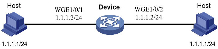

As shown in Figure 2, Host A and Host B are on the same subnet. Host A sends a packet to Host B as follows:
1.     Host A looks through the ARP table for an ARP entry for Host B. If one entry is found, Host A uses the MAC address in the entry to encapsulate the IP packet into a data link layer frame. Then Host A sends the frame to Host B.
2.     If Host A finds no entry for Host B, Host A buffers the packet and broadcasts an ARP request. The payload of the ARP request contains the following information:
¡     Sender IP address and sender MAC address—Host A's IP address and MAC address.
¡     Target IP address—Host B's IP address.
¡     Target MAC address—An all-zero MAC address.
All hosts on this subnet can receive the broadcast request, but only the requested host (Host B) processes the request.
3.     Host B compares its own IP address with the target IP address in the ARP request. If they are the same, Host B operates as follows:
a.     Adds the sender IP address and sender MAC address into its ARP table.
b.     Encapsulates its MAC address into an ARP reply.
c.     Unicasts the ARP reply to Host A.
4.     After receiving the ARP reply, Host A operates as follows:
a.     Adds the MAC address of Host B into its ARP table.
b.     Encapsulates the MAC address into the packet and sends the packet to Host B.
Figure 2 ARP address resolution process

Common proxy ARP configuration example
Example: Configuring common proxy ARP
As shown in Figure 6, Host A and Host D have the same IP prefix and mask, but they are located on different subnets separated by the switch. Host A belongs to VLAN 1, and Host D belongs to VLAN 2. No default gateway is configured on Host A and Host D.
Configure common proxy ARP on the switch to enable communication between the two hosts.
Figure 6 Network diagram

Example: Configuring ARP fast-reply
As shown in Figure 7, all clients are in VLAN 2, and access the network through the switch. They have obtained IP addresses through DHCP.
Enable ARP snooping and ARP fast-reply for VLAN 2. The switch directly returns an ARP reply without broadcasting received ARP requests in the VLAN.
Figure 7 Network diagram
# Enable ARP snooping for VLAN 2 on the switch.
<Switch> system-view
[Switch] vlan 2
[Switch-vlan2] arp snooping enable
# Enable ARP fast-reply for VLAN 2 on the switch.
[Switch-vlan2] arp fast-reply enable
[Switch-vlan2] quit
