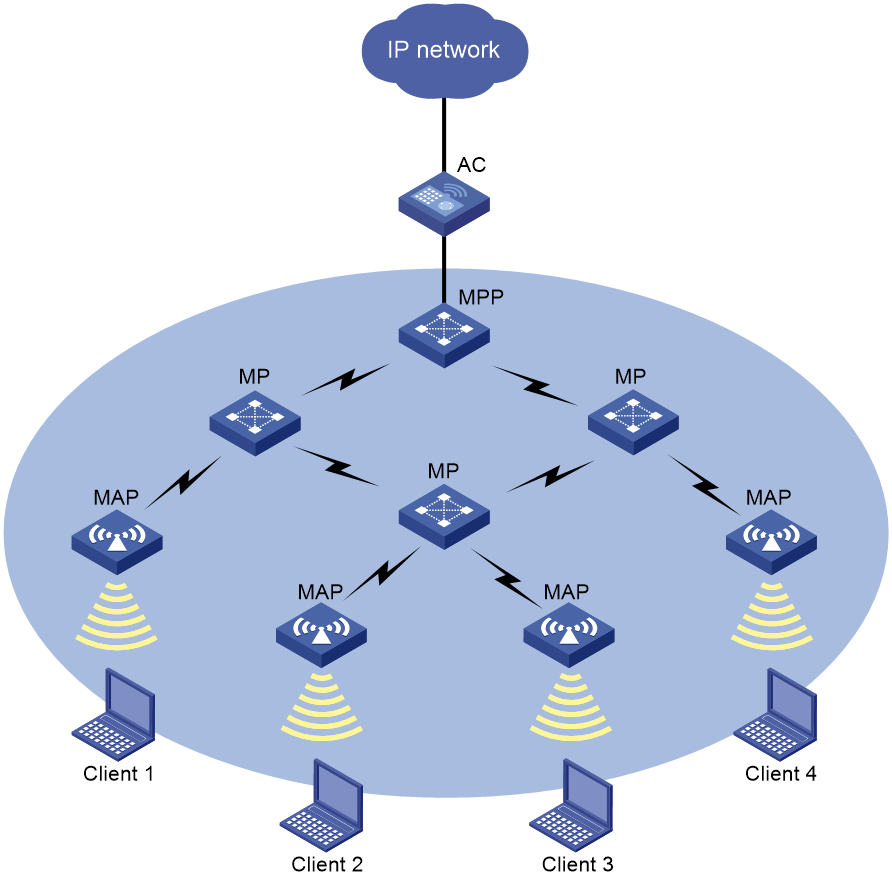

WLAN mesh network
Figure 1 shows a WLAN mesh network.
APs on a WLAN mesh network are mesh points (MPs). MPs play the following roles:
·     Single-purpose MP—Provides only mesh services.
·     Mesh access point (MAP)—Provides both mesh and access services.
·     Mesh portal point (MPP)—Provides a wired connection to a wired network.

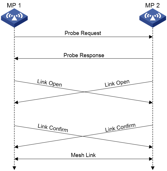

Neighbor discovery and mesh link establishment
MPs must operate at the same radio mode and on the same channel to discover each other. MPs can establish a mesh link after they discover each other and establish a peer relationship.
The following are the available discovery methods:
·     Active scanning—The MP sends Probe Request frames to discover neighbors and establish peer relationships.
·     Passive scanning—The MP listens to Beacon frames to collect information about other MPs. If there are neighbors, the AP sends Probe Request frames to request establishing a peer relationship.
This section uses active scanning to describe the neighbor discovery and mesh link establishment process.
As shown in Figure 2, MPs attempt to establish peer relationships by exchanging their mesh profiles in Probe Request and Probe Response frames.
One MP adds another MP as a mesh peer if the following conditions are met:
·     The MPs' mesh profiles match.
·     The Accepting Peer Links bit in the received request or response is set.
The MP peers attempt to establish a mesh link by sending a Link Open request to each other. The mesh link is established after the MP peers acknowledge the Link Open request received from each other.
Figure 2 Neighbor discovery and mesh link establishment on a WLAN mesh network

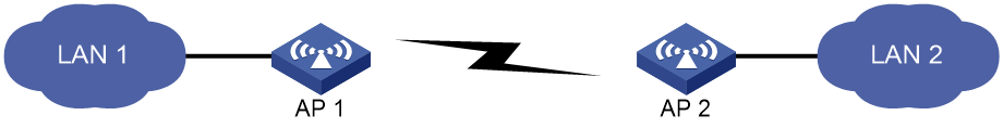

Point-to-point topology
As shown in Figure 3, you can set up a mesh link between two APs to connect two LANs.
Figure 3 WDS point to point topology

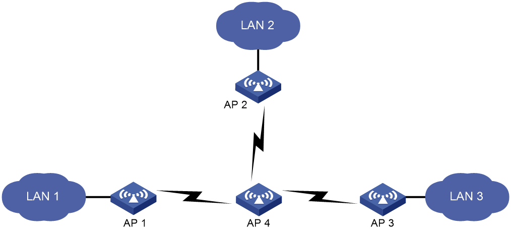

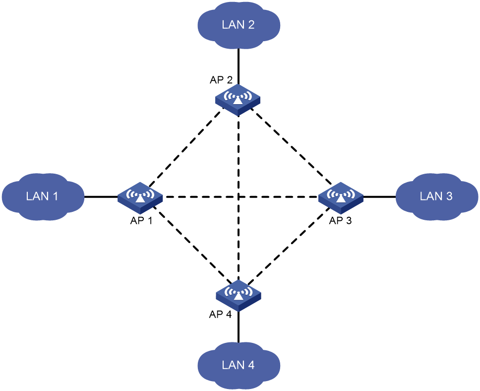

Star topology
As shown in Figure 4, you can set up mesh links between one central AP and multiple leaf APs to connect multiple LANs. In this topology, all data between LANs must traverse the central AP (AP 4 in this example).
Figure 4 Star topology

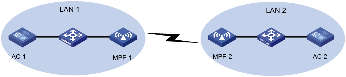

Topology created without administrative intervention
Without administrative intervention, the WDS topology depends on the result of automatic neighbor discovery and mesh link establishment between APs.
Figure 5 Automatic topology setup

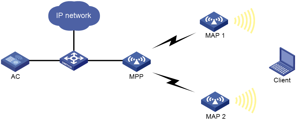

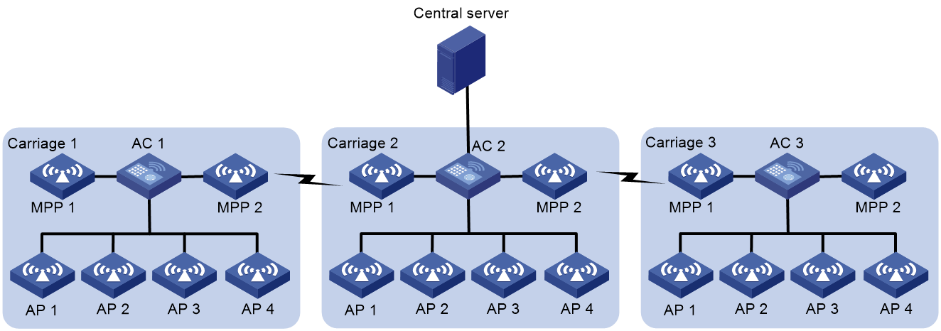

VLAN
VLANs can be deployed in mesh networks for devices in different LANs to communicate with each other. Figure 6 shows the application of VLANs in high-speed railway mesh networks.
As shown in Figure 6, an AC and multiple APs are deployed in each carriage on a train. All devices are assigned to the same VLAN. Therefore, the two APs at both ends of each carriage can act as MPPs to establish mesh links with the MPPs on the adjacent carriages. Other APs provide WLAN access services. All devices communicate with the outside through the central server deployed in the middle of the train.
In this scenario, IP address conflict might occur because all ACs use the same configuration for easy configuration and maintenance. To address this issue, configure NAT on each AC and configure the mesh interfaces to allow the VLAN for MPP communications. For more information about NAT, see Network Connectivity Configuration Guide.
Figure 6 High-speed railway mesh network

Example: Configuring WLAN mesh
As shown in Figure 7, establish an 802.11n 5GHz WLAN mesh network to provide network access for the clients. Configure the MP and MAPs to establish mesh links on channel 149.
Figure 7 Network diagram
1.     Configure a mesh profile:
# Create a mesh profile.
<AC> system-view
[AC] wlan mesh-profile 1
# Set the mesh ID to 1.
[AC-wlan-mesh-profile-1] mesh-id 1
# Enable SAE for authentication and key management.
[AC-wlan-mesh-profile-1] akm mode sae
# Configure a preshared key.
[AC-wlan-mesh-profile-1] preshared-key pass-phrase simple 12345678
# Enable the mesh profile.
[AC-wlan-mesh-profile-1] mesh-profile enable
[AC-wlan-mesh-profile-1] quit
2.     Configure a service template.
[AC] wlan service-template service1
[AC-wlan-st-service1] ssid mesh-network
[AC-wlan-st-service1] service-template enable
[AC-wlan-st-service1] quit
3.     Configure settings for the MPP:
# Create an AP template for the MPP. Make sure you select the correct AP model and specify the correct serial ID.
[AC] wlan ap mpp model WA6320
[AC-wlan-ap-mpp] serial-id 219801A28N819CE0002T
# Bind the mesh profile to the MPP's radio 1.
[AC-wlan-ap-mpp] radio 1
[AC-wlan-ap-mpp-radio-1] mesh-profile 1
# Set the radio type of the MPP's radio 1 to 802.11n (5GHz).
[AC-wlan-ap-mpp-radio-1] type dot11an
# Set the working channel of the radio to 149.
[AC-wlan-ap-mpp-radio-1] channel 149
# Enable the radio.
[AC-wlan-ap-mpp-radio-1] radio enable
[AC-wlan-ap-mpp-radio-1] quit
# Disable the MPP from sending neighbor probe requests.
[AC-wlan-ap-mpp] portal-service enable
[AC-wlan-ap-mpp] quit
4.     Configure settings for the MAPs:
# Create an AP template for MAP 1. Make sure you select the correct AP model and specify the correct serial ID.
[AC] wlan ap map1 model WA6320
[AC-wlan-ap-map1] serial-id 219801A28N819CE0003T
# Bind the mesh profile to the MAP's radio 1.
[AC-wlan-ap-map1] radio 1
[AC-wlan-ap-map1-radio-1] mesh-profile 1
# Bind the service template to the MAP's radio 1.
[AC-wlan-ap-map1-radio-1] service-template service1
# Set the radio type of the MAP's radio 1 to 802.11n (5GHz).
[AC-wlan-ap-map1-radio-1] type dot11an
[AC-wlan-ap-map1-radio-1] channel 149
# Add the MAC address of radio 1 on the MPP to the mesh peer whitelist to avoid loops. MAP 1 can set up a mesh link only with the MPP.
[AC-wlan-ap-map1-radio-1] mesh peer-mac-address 77a2-c25d-e316
# Enable the radio.
[AC-wlan-ap-map1-radio-1] radio enable
[AC-wlan-ap-map1-radio-1] quit
[AC-wlan-ap-map1] quit
# Configure settings for MAP 2 in the same way settings for MAP 1 are configured.
[AC] wlan ap map2 model WA6320
[AC-wlan-ap-map2] serial-id 219801A28N819CE0004T
[AC-wlan-ap-map2] radio 1
[AC-wlan-ap-map2-radio-1] mesh-profile 1
[AC-wlan-ap-map2-radio-1] service-template service1
[AC-wlan-ap-map2-radio-1] type dot11an
[AC-wlan-ap-map2-radio-1] channel 149
[AC-wlan-ap-map2-radio-1] mesh peer-mac-address 77a2-c25d-e316
[AC-wlan-ap-map2-radio-1] radio enable
[AC-wlan-ap-map2-radio-1] quit
[AC-wlan-ap-map2] quit
[AC] quit
# Verify that the MPP and MAPs can establish mesh links.
<AC> display wlan mesh-link ap
AP Name: mpp
 Peer           Local          Status     RSSI Packets(Rx/Tx)
 4a9b-c5bb-e43f 77a2-c25d-e316 Forwarding 22   6058/1900
 a6b5-1c5a-22ff 77a2-c25d-e316 Forwarding 35   5354/1900
AP Name: map1
 77a2-c25d-e316 4a9b-c5bb-e43f Forwarding 22   1900/6058
AP Name: map2
 77a2-c25d-e316 a6b5-1c5a-22ff Forwarding 35   1900/5354
# Verify that the clients have associated with their respective APs.
<AC> display wlan client
Total number of clients: 1
MAC address    Username             AP name               R IP address      VLAN
000f-e265-6400 N/A                  mpp                   1 1.1.1.1         300
Example: Configuring VLAN settings for a WLAN mesh network
As shown in Figure 8, both LAN 1 and LAN 2 belong to VLAN 2. Configure MPP 1 and MPP 2 to establish a mesh link on channel 149, and to permit traffic from VLAN 2.
Figure 8 Network diagram
<AC1> system-view
[AC1] wlan mesh-profile 1
[AC1-wlan-mesh-profile-1] mesh-id 1
[AC1-wlan-mesh-profile-1] akm mode sae
[AC1-wlan-mesh-profile-1] preshared-key pass-phrase simple 12345678
[AC1-wlan-mesh-profile-1] mesh-profile enable
[AC1-wlan-mesh-profile-1] quit
[AC1] wlan service-template service1
[AC1-wlan-st-service1] ssid mesh-network
[AC1-wlan-st-service1] service-template enable
[AC1-wlan-st-service1] quit
[AC1] wlan ap mpp1 model WA6320
[AC1-wlan-ap-mpp1] serial-id 219801A28N819CE0002T
# Bind the mesh profile to radio 1 of the MPP.
[AC1-wlan-ap-mpp1] radio 1
[AC1-wlan-ap-mpp1-radio-1] mesh-profile 1
# Set the radio type for radio 1 of the MPP to 802.11n (5GHz).
[AC1-wlan-ap-mpp1-radio-1] type dot11an
[AC1-wlan-ap-mpp1-radio-1] channel 149
# Enable the radio.
[AC1-wlan-ap-mpp1-radio-1] radio enable
[AC1-wlan-ap-mpp1-radio-1] quit
4.     Configure the mesh interface:
# Create mesh interface 1.
[AC1-wlan-ap-mpp1] interface wlan-mesh 1
[AC1-wlan-ap-mpp1-wlan-mesh-1] quit
# Bind the mesh interface to radio 1 of the MPP.
[AC1-wlan-ap-mpp1-radio-1] mesh-interface 1
# Set the link type to trunk.
[AC1-wlan-ap-mpp1-wlan-mesh-1] mesh-port link type trunk
# Assign the trunk port to VLAN 2.
[AC1-wlan-ap-mpp1-wlan-mesh-1] mesh-port trunk permit vlan 2
# Enable remote configuration assignment.
[AC1-wlan-ap-mpp1] remote-configuration enable
5.     Configure AC 2 in the same way AC 1 is configured.
# Configure VLAN-interface 2 on both AC 1 and AC 2 to verify that AC 1 and AC 2 can ping each other successfully.
