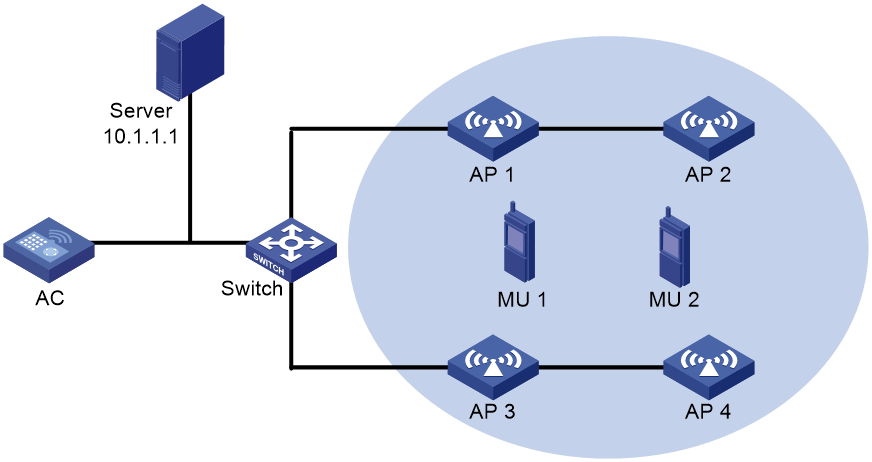

Wireless location tracks 802.11 devices for medical monitoring, asset management, and logistics management.

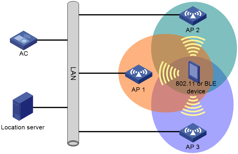

Wireless location system
As shown in Figure 1, a wireless location system contains 802.11 devices, information receivers (802.11 APs), and a location server. 802.11 devices include Tags (small wireless devices that can only send 802.11 packets periodically) and MUs (all 802.11 devices except Tags).
Figure 1 Wireless location system
Wireless location mechanism
Wireless location operates as follows:
1.     The 802.11 device sends a wireless packet.
2.     Upon receiving the wireless packet, the APs encapsulate the collected location information (including RSSI and timestamp) in location packets, and then send the packets to the location server.
3.     The location server calculates the location of the 802.11 device.
A location server needs location information from a minimum of three APs to locate an 802.11 device.

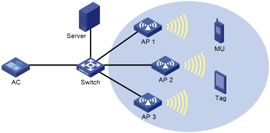

Example: Configuring AeroScout location
As shown in Figure 2, configure wireless location on AP 1, AP 2, and AP 3 to locate the MU and the Tag.
Figure 2 Network diagram
1.     Configure the location server:
¡     Set the IP addresses of the three APs on the location server, or configure the location server to discover APs through broadcast. (Details not shown.)
¡     Configure wireless location on the location server. (Details not shown.)
2.     Configure the APs:
¡     Configure AP 1.
# Create manual AP ap1, and specify the AP model and serial ID.
<AC> system-view
[AC] wlan ap ap1 model WA6320
[AC-wlan-ap-ap1] serial-id 219801A28N819CE0002T
[AC-wlan-ap-ap1] quit
# Enable AeroScout location.
[AC-wlan-ap-ap1] rfid-tracking aeroscout enable
# Enable radio-based location.
[AC-wlan-ap-ap1] radio 1
[AC-wlan-ap-ap1-radio-1] rfid-tracking radio enable
# Specify the type of devices to locate as Tag.
[AC-wlan-ap-ap1-radio-1] rfid-tracking mode tag
# Specify the type of devices to locate as MU.
[AC-wlan-ap-ap1-radio-1] rfid-tracking mode mu
# Enable radio 1 of AP 1.
[AC-wlan-ap-ap1-radio-1] radio enable
[AC-wlan-ap-ap1-radio-1] quit
[AC] quit
¡     Configure AP 2 and AP 3 in the same way AP 1 is configured.
# Verify that wireless location is enabled and the type of devices to locate is MU/Tag for each AP.
<AC> display wlan rfid-tracking radio
                                 Wireless Locating
 AP                                 Radio   Type
 ap1                                1       MU/Tag
 ap2                                1       MU/Tag
 ap3                                1       MU/Tag
# Verify that you can view location information for the MU and the Tag by maps, forms or reports provided by the graphics software. (Details not shown.)

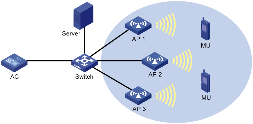

Example: Configuring RF fingerprinting
As shown in Figure 3, configure RF fingerprinting for AP 1, AP 2, and AP 3 to locate the MUs.
Figure 3 Network diagram
1.     Configure AP 1:
<AC> system-view
# Enable RF fingerprinting.
[AC-wlan-ap-ap1] rfid-tracking fingerprint enable
# Specify an IPv4 address and a port number for the location server.
[AC-wlan-ap-ap1] rfid-tracking fingerprint engine-address 192.168.10.10 engine-port 1145
# Specify a port to listen for messages from the location server.
[AC-wlan-ap-ap1] rfid-tracking fingerprint vendor-port 3000
[AC] quit
2.     Configure AP 2 and AP 3 in the same way AP 1 is configured.
# Verify that RF fingerprinting is enabled and the type of devices to locate is MU for each AP.
                                 Wireless Locating
 AP                                 Radio   Type
 ap1                                1       MU
 ap2                                1       MU
 ap3                                1       MU
# Verify that you can view location information for the MUs by maps, forms, or reports provided by the graphics software. (Details not shown.)
