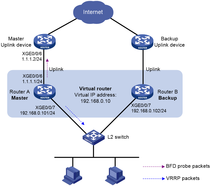

Associating Track with VRRP
When VRRP is operating in standard mode or load balancing mode, associate the Track module with the VRRP group to implement the following actions:
·     Change the priority of a router according to the status of the uplink. If a fault occurs on the uplink of the router, the VRRP group is not aware of the uplink failure. If the router is the master, hosts in the LAN cannot access the external network. To resolve this problem, configure a detection module-Track-VRRP collaboration. The detection module monitors the status of the uplink of the router and notifies the Track module of the detection result.
When the uplink fails, the detection module notifies the Track module to change the status of the monitored track entry to Negative. The priority of the master decreases by a user-specified value. A router with a higher priority in the VRRP group becomes the master.
·     Monitor the master on a backup. If a fault occurs on the master, the backup operating in switchover mode will switch to the master immediately to maintain normal communication.
When VRRP is operating in load balancing mode, associate the Track module with the VRRP VF to implement the following functions:
·     Change the priority of the AVF according to its uplink state. When the uplink of the AVF fails, the track entry changes to Negative state. The weight of the AVF decreases by a user-specified value. The VF with a higher priority becomes the new AVF to forward packets.
·     Monitor the AVF status from the LVF. When the AVF fails, the LVF that is operating in switchover mode becomes the new AVF to ensure continuous forwarding.
For more information about configuring VRRP, see "Configuring VRRP."

Example: Configuring VRRP-Track-NQA collaboration
As shown in Figure 2:
·     Host A requires access to Host B. The default gateway of Host A is 10.1.1.10/24.
·     Router A and Router B belong to VRRP group 1. The virtual IP address of VRRP group 1 is 10.1.1.10.
Configure VRRP-Track-NQA collaboration to monitor the uplink on the master and meet the following requirements:
·     When Router A operates correctly, it forwards packets from Host A to Host B.
·     When NQA detects a fault on the uplink of Router A, Router B forwards packets from Host A to Host B.
Figure 2 Network diagram

Example: Configuring BFD for the VRRP master to monitor the uplink
As shown in Figure 4:
·     Router A and Router B belong to VRRP group 1. The virtual IP address of VRRP group 1 is 192.168.0.10.
·     The default gateway of the hosts in the LAN is 192.168.0.10.
Configure VRRP-Track-BFD collaboration to monitor the uplink on the master and meet the following requirements:
·     When Router A operates correctly, hosts in the LAN access the Internet through Router A.
·     When Router A detects that the uplink is down through BFD, Router B can preempt as the master. The hosts in the LAN can access the Internet through Router B.
Figure 4 Network diagram
1.     Configure Router A:
# Specify 10.10.10.10 as the source address of BFD echo packets.
<RouterA> system-view
[RouterA] bfd echo-source-ip 10.10.10.10
# Create track entry 1 for the BFD session on Router A to verify the reachability of the uplink device (1.1.1.2).
[RouterA] track 1 bfd echo interface ten-gigabitethernet 0/0/6 remote ip 1.1.1.2 local ip 1.1.1.1
# Create VRRP group 1, and specify 192.168.0.10 as the virtual IP address of the group.
[RouterA] interface ten-gigabitethernet 0/0/7
[RouterA-Ten-GigabitEthernet0/0/7] vrrp vrid 1 virtual-ip 192.168.0.10
# Set the priority of Router A to 110 in VRRP group 1.
[RouterA-Ten-GigabitEthernet0/0/7] vrrp vrid 1 priority 110
# Associate VRRP group 1 with track entry 1 and decrease the router priority by 20 when the state of track entry 1 changes to negative.
[RouterA-Ten-GigabitEthernet0/0/7] vrrp vrid 1 track 1 priority reduced 20
[RouterA-Ten-GigabitEthernet0/0/7] return
2.     On Router B, create VRRP group 1, and specify 192.168.0.10 as the virtual IP address of the group.
<RouterB> system-view
[RouterB] interface ten-gigabitethernet 0/0/7
[RouterB-Ten-GigabitEthernet0/0/7] vrrp vrid 1 virtual-ip 192.168.0.10
[RouterB-Ten-GigabitEthernet0/0/7] return
# Display detailed information about the VRRP group on Router A.
<RouterA> display vrrp verbose
IPv4 virtual router information:
 Running mode      : Standard
 Total number of virtual routers : 1
   Interface Ten-GigabitEthernet0/0/7
     VRID             : 1               Adver timer  : 100 centiseconds
     Admin status     : Up              State        : Master
     Config pri       : 110             Running pri  : 110
     Preempt mode     : Yes             Delay time   : 0 centiseconds
     Auth type        : None
     Virtual IP       : 192.168.0.10
     Virtual MAC      : 0000-5e00-0101
     Master IP        : 192.168.0.101
   VRRP track information:
     Track object   : 1              State : Positive          Pri reduced : 20
# Display information about track entry 1 on Router A.
<RouterA> display track 1
Track ID: 1
  State: Positive
  Duration: 0 days 0 hours 0 minutes 32 seconds
  Notification delay: Positive 0, Negative 0 (in seconds)
  Tracked object:
    BFD session mode: Echo
    Outgoing interface: Ten-GigabitEthernet0/0/6
    VPN instance name: --
    Remote IP: 1.1.1.2
    Local IP: 1.1.1.1
# Display detailed information about the VRRP group on Router B.
<RouterB> display vrrp verbose
     Admin status     : Up              State        : Backup
     Config pri       : 100             Running pri  : 100
     Become master    : 2200 milliseconds left
     Auth type        : None
The output shows that when the status of track entry 1 becomes Positive, Router A is the master and Router B the backup.
# Display information about track entry 1 when the uplink of Router A goes down.
Track ID: 1
  State: Negative
  Tracked object:
    Remote IP: 1.1.1.2
    Local IP: 1.1.1.1
     Config pri       : 110             Running pri  : 90
     Become Master    : 2200 milliseconds left
     Auth type        : None
     Master IP        : 192.168.0.102
     Track object   : 1              State : Negative          Pri reduced : 20
# Display detailed information about VRRP group 1 on Router B.
     Auth type        : None
The output shows that when Router A detects that the uplink fails through BFD, it decreases its priority by 20. Router B then preempts as the master.

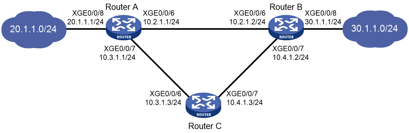

Example: Configuring static routing-Track-NQA collaboration
As shown in Figure 5:
·     Router A is the default gateway of the hosts in network 20.1.1.0/24.
·     Router D is the default gateway of the hosts in network 30.1.1.0/24.
·     Hosts in the two networks communicate with each other through static routes.
To ensure network availability, configure route backup and static routing-Track-NQA collaboration on Router A and Router D as follows:
·     On Router A, assign a higher priority to the static route to 30.1.1.0/24 with next hop Router B. This route is the master route. The static route to 30.1.1.0/24 with the next hop Router C acts as the backup route. When the master route is unavailable, the backup route takes effect.
·     On Router D, assign a higher priority to the static route to 20.1.1.0/24 with next hop Router B. This route is the master route. The static route to 20.1.1.0/24 with next hop Router C acts as the backup route. When the master route is unavailable, the backup route takes effect.

1.     Configure the IP address of each interface, as shown in Figure 5. (Details not shown.)
2.     Configure Router A:
# Configure a static route to 30.1.1.0/24 with next hop 10.1.1.2 and the default priority (60). Associate this static route with track entry 1.
[RouterA] ip route-static 30.1.1.0 24 10.1.1.2 track 1
# Configure a static route to 30.1.1.0/24 with next hop 10.3.1.3 and priority 80.
[RouterA] ip route-static 30.1.1.0 24 10.3.1.3 preference 80
# Configure a static route to 10.2.1.4 with next hop 10.1.1.2.
[RouterA] ip route-static 10.2.1.4 24 10.1.1.2
# Create an NQA operation with administrator name admin and operation tag test.
[RouterA] nqa entry admin test
# Specify the ICMP echo operation type.
[RouterA-nqa-admin-test] type icmp-echo
# Specify 10.2.1.4 as the destination address of the operation.
[RouterA-nqa-admin-test-icmp-echo] destination ip 10.2.1.4
# Specify 10.1.1.2 as the next hop of the operation.
[RouterA-nqa-admin-test-icmp-echo] next-hop ip 10.1.1.2
# Configure the ICMP echo operation to repeat every 100 milliseconds.
[RouterA-nqa-admin-test-icmp-echo] frequency 100
# Configure reaction entry 1, specifying that five consecutive probe failures trigger the Track module.
[RouterA-nqa-admin-test-icmp-echo] reaction 1 checked-element probe-fail threshold-type consecutive 5 action-type trigger-only
[RouterA-nqa-admin-test-icmp-echo] quit
# Start the NQA operation.
[RouterA] nqa schedule admin test start-time now lifetime forever
# Configure track entry 1, and associate it with reaction entry 1 of the NQA operation.
[RouterA] track 1 nqa entry admin test reaction 1
3.     Configure Router B:
# Configure a static route to 30.1.1.0/24 with next hop 10.2.1.4.
[RouterB] ip route-static 30.1.1.0 24 10.2.1.4
# Configure a static route to 20.1.1.0/24 with next hop 10.1.1.1.
[RouterB] ip route-static 20.1.1.0 24 10.1.1.1
4.     Configure Router C:
# Configure a static route to 30.1.1.0/24 with next hop 10.4.1.4.
<RouterC> system-view
[RouterC] ip route-static 30.1.1.0 24 10.4.1.4
# Configure a static route to 20.1.1.0/24 with next hop 10.3.1.1.
[RouterC] ip route-static 20.1.1.0 24 10.3.1.1
5.     Configure Router D:
# Configure a static route to 20.1.1.0/24 with next hop 10.2.1.2 and the default priority (60). Associate this static route with track entry 1.
<RouterD> system-view
[RouterD] ip route-static 20.1.1.0 24 10.2.1.2 track 1
# Configure a static route to 20.1.1.0/24 with next hop 10.4.1.3 and default priority 80.
[RouterD] ip route-static 20.1.1.0 24 10.4.1.3 preference 80
# Configure a static route to 10.1.1.1 with next hop 10.2.1.2.
[RouterD] ip route-static 10.1.1.1 24 10.2.1.2
[RouterD] nqa entry admin test
[RouterD-nqa-admin-test] type icmp-echo
# Specify 10.1.1.1 as the destination address of the operation.
[RouterD-nqa-admin-test-icmp-echo] destination ip 10.1.1.1
# Specify 10.2.1.2 as the next hop of the operation.
[RouterD-nqa-admin-test-icmp-echo] next-hop ip 10.2.1.2
[RouterD-nqa-admin-test-icmp-echo] frequency 100
[RouterD-nqa-admin-test-icmp-echo] reaction 1 checked-element probe-fail threshold-type consecutive 5 action-type trigger-only
[RouterD-nqa-admin-test-icmp-echo] quit
[RouterD] nqa schedule admin test start-time now lifetime forever
[RouterD] track 1 nqa entry admin test reaction 1
# Display information about the track entry on Router A.
[RouterA] display track all
Track ID: 1
  State: Positive
  Tracked object:
    NQA entry: admin test
    Reaction: 1
    Remote IP/URL: 10.2.1.4
    Local IP:--
    Interface:--
The output shows that the status of the track entry is Positive, indicating that the NQA operation has succeeded and the master route is available.
# Display the routing table of Router A.
[RouterA] display ip routing-table
Destinations : 10       Routes : 10
10.1.1.0/24         Direct 0    0            10.1.1.1        XGE0/0/6
10.1.1.1/32         Direct 0    0            127.0.0.1       InLoop0
10.2.1.0/24         Static 60   0            10.1.1.2        XGE0/0/6
10.3.1.0/24         Direct 0    0            10.3.1.1        XGE0/0/7
10.3.1.1/32         Direct 0    0            127.0.0.1       InLoop0
20.1.1.0/24         Direct 0    0            20.1.1.1        XGE0/0/8
20.1.1.1/32         Direct 0    0            127.0.0.1       InLoop0
30.1.1.0/24         Static 60   0            10.1.1.2        XGE0/0/6
127.0.0.0/8         Direct 0    0            127.0.0.1       InLoop0
127.0.0.1/32        Direct 0    0            127.0.0.1       InLoop0
The output shows that Router A forwards packets to 30.1.1.0/24 through Router B.
# Remove the IP address of Ten-GigabitEthernet 0/0/6 on Router B.
[RouterB] interface ten-gigabitethernet 0/0/6
[RouterB-Ten-GigabitEthernet0/0/6] undo ip address
Track ID: 1
  State: Negative
  Tracked object:
    Reaction: 1
    Local IP:--
    Interface:--
The output shows that the status of the track entry is Negative, indicating that the NQA operation has failed and the master route is unavailable.
30.1.1.0/24         Static 80   0            10.3.1.3        XGE0/0/7
The output shows that Router A forwards packets to 30.1.1.0/24 through Router C. The backup static route has taken effect.
# Verify that hosts in 20.1.1.0/24 can communicate with the hosts in 30.1.1.0/24 when the master route fails.
[RouterA] ping -a 20.1.1.1 30.1.1.1
Ping 30.1.1.1: 56  data bytes, press CTRL_C to break
Reply from 30.1.1.1: bytes=56 Sequence=1 ttl=254 time=2 ms
Reply from 30.1.1.1: bytes=56 Sequence=2 ttl=254 time=1 ms
Reply from 30.1.1.1: bytes=56 Sequence=3 ttl=254 time=1 ms
Reply from 30.1.1.1: bytes=56 Sequence=4 ttl=254 time=2 ms
Reply from 30.1.1.1: bytes=56 Sequence=5 ttl=254 time=1 ms
--- Ping statistics for 30.1.1.1 ---
5 packet(s) transmitted, 5 packet(s) received, 0.00% packet loss
round-trip min/avg/max/std-dev = 1/1/2/1 ms
# Verify that the hosts in 30.1.1.0/24 can communicate with the hosts in 20.1.1.0/24 when the master route fails.
[RouterD] ping -a 30.1.1.1 20.1.1.1
Ping 20.1.1.1: 56  data bytes, press CTRL_C to break
Reply from 20.1.1.1: bytes=56 Sequence=1 ttl=254 time=2 ms
Reply from 20.1.1.1: bytes=56 Sequence=2 ttl=254 time=1 ms
Reply from 20.1.1.1: bytes=56 Sequence=3 ttl=254 time=1 ms
Reply from 20.1.1.1: bytes=56 Sequence=4 ttl=254 time=1 ms
Reply from 20.1.1.1: bytes=56 Sequence=5 ttl=254 time=1 ms
--- Ping statistics for 20.1.1.1 ---

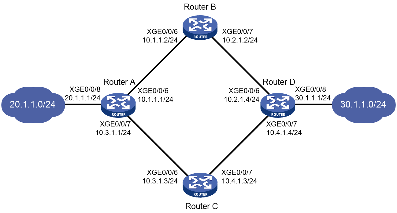

Example: Configuring static routing-Track-BFD collaboration
As shown in Figure 6:
·     Router B is the default gateway of the hosts in network 30.1.1.0/24.
To ensure network availability, configure route backup and static routing-Track-BFD collaboration on Router A and Router B as follows:
·     On Router A, assign a higher priority to the static route to 30.1.1.0/24 with next hop Router B. This route is the master route. The static route to 30.1.1.0/24 with next hop Router C acts as the backup route. When the master route is unavailable, BFD can quickly detect the route failure to make the backup route take effect.
·     On Router B, assign a higher priority to the static route to 20.1.1.0/24 with next hop Router A. This route is the master route. The static route to 20.1.1.0/24 with next hop Router C acts as the backup route. When the master route is unavailable, BFD can quickly detect the route failure to make the backup route take effect.
Figure 6 Network diagram
1.     Configure the IP address of each interface, as shown in Figure 6. (Details not shown.)
# Configure a static route to 30.1.1.0/24 with next hop 10.2.1.2 and the default priority (60). Associate this static route with track entry 1.
[RouterA] ip route-static 30.1.1.0 24 10.2.1.2 track 1
# Configure track entry 1, and associate it with the BFD session to verify the connectivity between Router A and Router B.
[RouterA] track 1 bfd echo interface ten-gigabitethernet 0/0/6 remote ip 10.2.1.2 local ip 10.2.1.1
# Configure a static route to 20.1.1.0/24 with next hop 10.2.1.1 and default priority (60). Associate this static route with track entry 1.
[RouterB] ip route-static 20.1.1.0 24 10.2.1.1 track 1
# Configure a static route to 20.1.1.0/24 with next hop 10.4.1.3 and the priority 80.
[RouterB] ip route-static 20.1.1.0 24 10.4.1.3 preference 80
# Specify 1.1.1.1 as the source address of BFD echo packets.
[RouterB] bfd echo-source-ip 1.1.1.1
# Configure track entry 1, and associate it with the BFD session to verify the connectivity between Router B and Router A.
[RouterB] track 1 bfd echo interface ten-gigabitethernet 0/0/6 remote ip 10.2.1.1 local ip 10.2.1.2
# Configure a static route to 30.1.1.0/24 with next hop 10.4.1.2.
[RouterC] ip route-static 30.1.1.0 24 10.4.1.2
[RouterB] ip route-static 20.1.1.0 24 10.3.1.1
Track ID: 1
  State: Positive
  Tracked object:
    Remote IP: 10.2.1.2
    Local IP: 10.2.1.1
The output shows that the status of the track entry is Positive, indicating that next hop 10.2.1.2 is reachable.
Destinations : 9        Routes : 9
10.2.1.0/24         Direct 0    0            10.2.1.1        XGE0/0/6
10.2.1.1/32         Direct 0    0            127.0.0.1       InLoop0
30.1.1.0/24         Static 60   0            10.2.1.2        XGE0/0/6
Track ID: 1
  State: Negative
  Tracked object:
    Remote IP: 10.2.1.2
    Local IP: 10.2.1.1
The output shows that the status of the track entry is Negative, indicating that next hop 10.2.1.2 is unreachable.
# Verify that the hosts in 20.1.1.0/24 can communicate with the hosts in 30.1.1.0/24 when the master route fails.
[RouterB] ping -a 30.1.1.1 20.1.1.1
Example: Configuring VRRP-Track-interface management collaboration
As shown in Figure 7:
Configure VRRP-Track-interface management collaboration to monitor the uplink interface on the master and meet the following requirements:
·     When Router A operates correctly, Router A forwards packets from Host A to Host B.
·     When VRRP detects a fault on the uplink interface of Router A through the interface management module, Router B forwards packets from Host A to Host B.
Figure 7 Network diagram
1.     Configure the IP address of each interface, as shown in Figure 7. (Details not shown.)
# Configure track entry 1, and associate it with the link status of the uplink interface Ten-GigabitEthernet 0/0/7.
[RouterA] track 1 interface ten-gigabitethernet 0/0/7
# Create VRRP group 1, and configure virtual IP address 10.1.1.10 for the group.
[RouterA] interface ten-gigabitethernet 0/0/6
[RouterA-Ten-GigabitEthernet0/0/6] vrrp vrid 1 virtual-ip 10.1.1.10
[RouterA-Ten-GigabitEthernet0/0/6] vrrp vrid 1 priority 110
# Associate VRRP group 1 with track entry 1 and decrease the router priority by 30 when the state of track entry 1 changes to negative.
[RouterA-Ten-GigabitEthernet0/0/6] vrrp vrid 1 track 1 priority reduced 30
3.     On Router B, create VRRP group 1, and configure virtual IP address 10.1.1.10 for the group.
[RouterB-Ten-GigabitEthernet0/0/6] vrrp vrid 1 virtual-ip 10.1.1.10
# Ping Host B from Host A to verify that Host B is reachable. (Details not shown.)
# Display detailed information about VRRP group 1 on Router A.
[RouterA-Ten-GigabitEthernet0/0/6] display vrrp verbose
   Interface Ten-GigabitEthernet0/0/6
     Auth type        : None
     Virtual IP       : 10.1.1.10
     Master IP        : 10.1.1.1
     Track object   : 1              State : Positive          Pri reduced : 30
[RouterB-Ten-GigabitEthernet0/0/6] display vrrp verbose
     Auth type        : None
The output shows that in VRRP group 1, Router A is the master and Router B is a backup. Router A forwards packets from Host A to Host B.
# Shut down the uplink interface Ten-GigabitEthernet 0/0/7 on Router A.
[RouterA-Ten-GigabitEthernet0/0/6] interface ten-gigabitethernet 0/0/7
[RouterA-Ten-GigabitEthernet0/0/7] shutdown
[RouterA-Ten-GigabitEthernet0/0/7] display vrrp verbose
     Config pri       : 110             Running pri  : 80
     Auth type        : None
     Master IP        : 10.1.1.2
     Track object   : 1              State : Negative          Pri reduced : 30
     Auth type        : None
The output shows that Router A becomes the backup, and Router B becomes the master. Router B forwards packets from Host A to Host B.
Example: Configuring VRRP-Track-route management collaboration
As shown in Figure 8:
·     BGP peer relationships are established between Router A and Router C and between Router B and Router D. Router C and Router D advertise the default route 0.0.0.0/0 to Router A and Router B.
Configure VRRP-Track-route management collaboration to meet the following requirements:
·     When VRRP detects the removal of the default route from the routing table of Router A through route management, Router B forwards packets from Host A to Host B.
Figure 8 Network diagram
1.     Configure the IP address of each interface, as shown in Figure 8. (Details not shown.)
2.     Establish an IBGP peer relationship between Router A and Router C, and configure Router C to advertise the default route 0.0.0.0/0 to Router A.
[RouterA] bgp 100
[RouterA-bgp-default] peer 10.1.2.2 as-number 100
[RouterA-bgp-default] address-family ipv4
[RouterA-bgp-default-ipv4] peer 10.1.2.2 enable
[RouterC] bgp 100
[RouterC-bgp-default] peer 10.1.2.1 as-number 100
[RouterC-bgp-default] address-family ipv4
[RouterC-bgp-default-ipv4] peer 10.1.2.1 enable
[RouterC-bgp-default-ipv4] peer 10.1.2.1 default-route-advertise
[RouterC-bgp-default-ipv4] quit
3.     Configure Router B and Router D in the same way Router A and Router C are configured. (Details not shown.)
4.     Configure Track and VRRP on Router A:
# Configure track entry 1, and associate it with the default route 0.0.0.0/0.
[RouterA] track 1 ip route 0.0.0.0 0.0.0.0 reachability
[RouterA-Ten-GigabitEthernet0/0/6] quit
5.     On Router B, create VRRP group 1, and configure virtual IP address 10.1.1.10 for the group.
[RouterB-Ten-GigabitEthernet0/0/6] quit
[RouterA] display vrrp verbose
     Auth type        : None
[RouterB] display vrrp verbose
     Auth type        : None
# Disable Router C from exchanging routing information with Router A so that the default route 0.0.0.0/0 is removed from Router A.
[RouterC-bgp-default-ipv4] undo peer 10.1.2.1 enable
     Auth type        : None
     Auth type        : None
