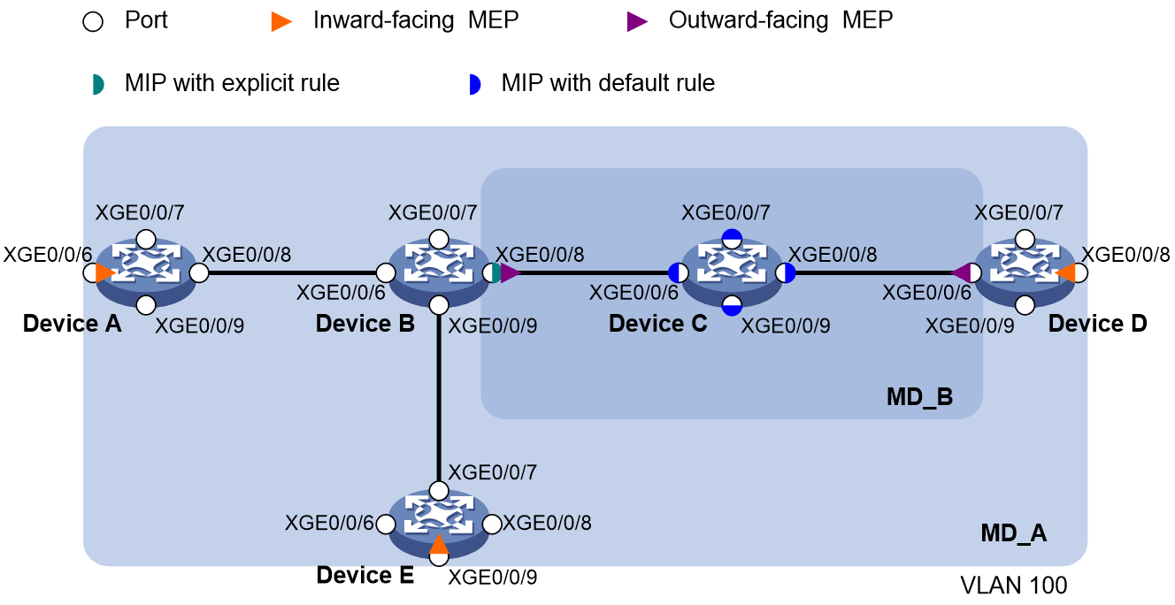

To accurately locate faults, CFD introduces eight levels (from 0 to 7) to MDs. The bigger the number, the higher the level and the larger the area covered. Domains can touch or nest (if the outer domain has a higher level than the nested one) but cannot intersect or overlap.
MD levels facilitate fault location and make fault location more accurate. As shown in Figure 1, MD_A in light blue nests MD_B in dark blue. If a connectivity fault is detected at the boundary of MD_A, any of the devices in MD_A, including Device A through Device E, might fail. If a connectivity fault is also detected at the boundary of MD_B, the failure points can be any of Device B through Device D. If the devices in MD_B can operate correctly, at least Device C is operational.
This section assumes that physical links between devices are in good condition.
Figure 1 Two nested MDs
CFD exchanges messages and performs operations on a per-domain basis. By planning MDs correctly in a network, you can use CFD to rapidly locate failure points.

Example: Configuring CFD in an Ethernet network
As shown in Figure 4:
·     The network comprises five devices and is divided into two MDs: MD_A (level 5) and MD_B (level 3). All ports belong to VLAN 100, and the MAs in the two MDs all serve VLAN 100. Assume that the MAC addresses of Device A through Device E are 0010-FC01-6511, 0010-FC02-6512, 0010-FC03-6513, 0010-FC04-6514, and 0010-FC05-6515, respectively.
·     MD_A has three edge ports: Ten-GigabitEthernet 0/0/6 on Device A, Ten-GigabitEthernet 0/0/8 on Device D, and Ten-GigabitEthernet 0/0/9 on Device E. They are all inward-facing MEPs. MD_B has two edge ports: Ten-GigabitEthernet 0/0/8 on Device B and Ten-GigabitEthernet 0/0/6 on Device D. They are both outward-facing MEPs.
·     In MD_A, Device B is designed to have MIPs when its port is configured with low level MEPs. Port Ten-GigabitEthernet 0/0/8 is configured with MEPs of MD_B, and the MIPs of MD_A can be configured on this port. You must configure the MIP generation rule of MD_A as explicit.
·     The MIPs of MD_B are designed on Device C, and are configured on all ports. You must configure the MIP generation rule as default.
·     Configure CC to monitor the connectivity among all the MEPs in MD_A and MD_B. Configure LB to locate link faults, and use the AIS function to suppress the error alarms that are reported.
·     Configure port collaboration on Ten-GigabitEthernet 0/0/8 of Device B. After the outward-facing MEP on the interface detects a link fault, the interface is shut down or blocked.
·     After the status information of the entire network is obtained, use LT, LM, one-way DM, two-way DM, and TST to detect link faults.
Figure 4 Network diagram
On each device shown in Figure 4, create VLAN 100 and assign ports Ten-GigabitEthernet 0/0/6 through Ten-GigabitEthernet 0/0/9 to VLAN 100.
1.     Enable CFD:
# Enable CFD on Device A.
<DeviceA> system-view
[DeviceA] cfd enable
# Configure Device B through Device E in the same way Device A is configured. (Details not shown.)
2.     Configure service instances:
# Create MD_A (level 5) on Device A, and create service instance 1 (in which the MA is identified by a VLAN and serves VLAN 100).
[DeviceA] cfd md MD_A level 5
[DeviceA] cfd service-instance 1 ma-id vlan-based md MD_A vlan 100
# Configure Device E in the same way Device A is configured. (Details not shown.)
# Create MD_A (level 5) on Device B, and create service instance 1 (in which the MA is identified by a VLAN and serves VLAN 100).
[DeviceB] cfd md MD_A level 5
[DeviceB] cfd service-instance 1 ma-id vlan-based md MD_A vlan 100
# Create MD_B (level 3), and create service instance 2 (in which the MA is identified by a VLAN and serves VLAN 100).
[DeviceB] cfd md MD_B level 3
[DeviceB] cfd service-instance 2 ma-id vlan-based md MD_B vlan 100
# Configure Device D in the same way Device B is configured. (Details not shown.)
# Create MD_B (level 3) on Device C, and create service instance 2 (in which the MA is identified by a VLAN and serves VLAN 100).
[DeviceC] cfd md MD_B level 3
[DeviceC] cfd service-instance 2 ma-id vlan-based md MD_B vlan 100
3.     Configure MEPs:
# On Device A, configure a MEP list in service instance 1, and create inward-facing MEP 1001 in service instance 1 on Ten-GigabitEthernet 0/0/6.
[DeviceA] cfd meplist 1001 4002 5001 service-instance 1
[DeviceA] interface ten-gigabitethernet 0/0/6
[DeviceA-Ten-GigabitEthernet0/0/6] cfd mep 1001 service-instance 1 inbound
[DeviceA-Ten-GigabitEthernet0/0/6] quit
# On Device B, configure a MEP list in service instances 1 and 2.
[DeviceB] cfd meplist 1001 4002 5001 service-instance 1
[DeviceB] cfd meplist 2001 4001 service-instance 2
# Create outward-facing MEP 2001 in service instance 2 on Ten-GigabitEthernet 0/0/8.
[DeviceB] interface ten-gigabitethernet 0/0/8
[DeviceB-Ten-GigabitEthernet0/0/8] cfd mep 2001 service-instance 2 outbound
[DeviceB-Ten-GigabitEthernet0/0/8] quit
# On Device D, configure a MEP list in service instances 1 and 2.
[DeviceD] cfd meplist 1001 4002 5001 service-instance 1
[DeviceD] cfd meplist 2001 4001 service-instance 2
# Create outward-facing MEP 4001 in service instance 2 on Ten-GigabitEthernet 0/0/6.
[DeviceD] interface ten-gigabitethernet 0/0/6
[DeviceD-Ten-GigabitEthernet0/0/6] cfd mep 4001 service-instance 2 outbound
[DeviceD-Ten-GigabitEthernet0/0/6] quit
# Create inward-facing MEP 4002 in service instance 1 on Ten-GigabitEthernet 0/0/8.
[DeviceD] interface ten-gigabitethernet 0/0/8
[DeviceD-Ten-GigabitEthernet0/0/8] cfd mep 4002 service-instance 1 inbound
[DeviceD-Ten-GigabitEthernet0/0/8] quit
# On Device E, configure a MEP list in service instance 1.
[DeviceE] cfd meplist 1001 4002 5001 service-instance 1
# Create inward-facing MEP 5001 in service instance 1 on Ten-GigabitEthernet 0/0/9.
[DeviceE] interface ten-gigabitethernet 0/0/9
[DeviceE-Ten-GigabitEthernet0/0/9] cfd mep 5001 service-instance 1 inbound
[DeviceE-Ten-GigabitEthernet0/0/9] quit
4.     Configure MIPs:
# Configure the MIP generation rule in service instance 1 on Device B as explicit.
[DeviceB] cfd mip-rule explicit service-instance 1
# Configure the MIP generation rule in service instance 2 on Device C as default.
[DeviceC] cfd mip-rule default service-instance 2
5.     Configure CC:
# On Device A, enable the sending of CCM frames for MEP 1001 in service instance 1 on Ten-GigabitEthernet 0/0/6.
[DeviceA-Ten-GigabitEthernet0/0/6] cfd cc service-instance 1 mep 1001 enable
# On Device B, enable the sending of CCM frames for MEP 2001 in service instance 2 on Ten-GigabitEthernet 0/0/8.
[DeviceB-Ten-GigabitEthernet0/0/8] cfd cc service-instance 2 mep 2001 enable
# On Device D, enable the sending of CCM frames for MEP 4001 in service instance 2 on Ten-GigabitEthernet 0/0/6.
[DeviceD-Ten-GigabitEthernet0/0/6] cfd cc service-instance 2 mep 4001 enable
# Enable the sending of CCM frames for MEP 4002 in service instance 1 on Ten-GigabitEthernet 0/0/8.
[DeviceD-Ten-GigabitEthernet0/0/8] cfd cc service-instance 1 mep 4002 enable
# On Device E, enable the sending of CCM frames for MEP 5001 in service instance 1 on Ten-GigabitEthernet 0/0/9.
[DeviceE-Ten-GigabitEthernet0/0/9] cfd cc service-instance 1 mep 5001 enable
6.     Configure AIS:
# Enable AIS on Device B. Configure the AIS frame transmission level as 5 and AIS frame transmission interval as 1 second in service instance 2.
[DeviceB] cfd ais enable
[DeviceB] cfd ais level 5 service-instance 2
[DeviceB] cfd ais period 1 service-instance 2
7.     Configure port collaboration on Ten-GigabitEthernet 0/0/8:
# Specify the triggering event as cc-expire and triggered action as shutdown for port collaboration on the interface.
[DeviceB-Ten-GigabitEthernet0/0/8] cfd port-trigger cc-expire action shutdown
# Specify the triggering event as rdi and triggered action as block for port collaboration on the interface.
[DeviceB-Ten-GigabitEthernet0/0/8] cfd port-trigger rdi action block
1.     Verify the LB function when the CC function detects a link fault:
# Enable LB on Device A to check the status of the link between MEP 1001 and MEP 5001 in service instance 1.
[DeviceA] cfd loopback service-instance 1 mep 1001 target-mep 5001
Loopback to MEP 5001 with the sequence number start from 1001-43404:
Reply from 0010-fc05-6515: sequence number=1001-43404 time=5ms
Reply from 0010-fc05-6515: sequence number=1001-43405 time=5ms
Reply from 0010-fc05-6515: sequence number=1001-43406 time=5ms
Reply from 0010-fc05-6515: sequence number=1001-43407 time=5ms
Reply from 0010-fc05-6515: sequence number=1001-43408 time=5ms
Sent: 5        Received: 5        Lost: 0
2.     Verify the LT function after the CC function obtains the status information of the entire network:
# Identify the path between MEP 1001 and MEP 5001 in service instance 1 on Device A.
[DeviceA] cfd linktrace service-instance 1 mep 1001 target-mep 5001

# Use short-period two-way DM to test the two-way frame delay from MEP 1001 to MEP 4002 in service instance 1 on Device A.
[DeviceA] cfd dm two-way service-instance 1 mep 1001 target-mep 4002

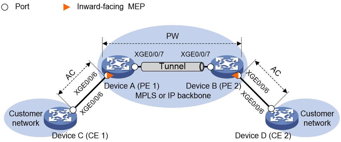

Example: Configuring CFD in a Layer 2 VPN (L2VPN networking)
As shown in Figure 5:
·     Configure a static PW between PE 1 and PE 2 to enable CE 1 and CE 2 to communicate with each other. Assume that the MAC addresses of Device A through Device D are 0010-FC01-6511, 0010-FC02-6512, 0010-FC03-6513, and 0010-FC04-6514, respectively.
·     Configure Ten-GigabitEthernet 0/0/6.1 on Device A and Device B as AC interfaces, and associate them with cross-connect svc of cross-connect group vpna.
·     Assign the network to MD_A (level 5). MD_A has two edge interfaces: Ten-GigabitEthernet 0/0/6.1 on Device A and Ten-GigabitEthernet 0/0/6.1 on Device B. They are both inward-facing MEPs.
·     Configure CC to monitor the connectivity between the inward-facing MEPs. Configure LB to locate link faults.
·     After the status information of the entire network is obtained, use LT, LM, and DM to detect link faults.
Figure 5 Network diagram
