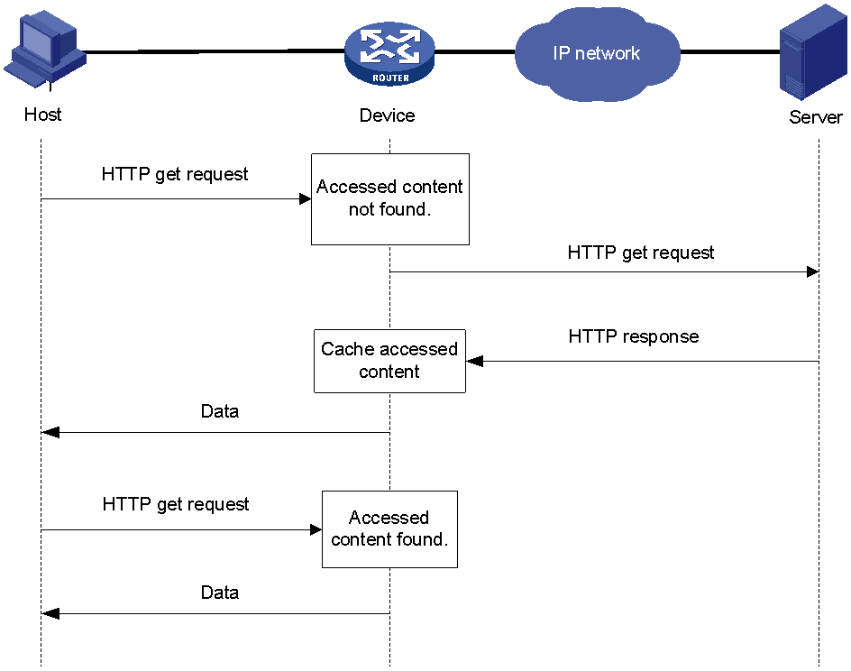

Web caching mechanism
Figure 1 shows the Web caching mechanism.
Figure 1 Web caching mechanism
1.     The host sends an HTTP GET request to the device.
2.     The device identifies whether the Web caching feature is configured to cache Web content from the Web server.
¡     If not, the device forwards the request directly to the Web server. The Web caching feature does not take part in the communication between the host and the Web server.
¡     If yes, the device forwards the request to the Web caching process.
3.     The Web caching process obtains the URL of the request and looks up its cache for the requested content.
¡     If the requested content is found in the cache, the device retrieves the content and sends the content to the host. The HTTP GET operation is completed.
¡     If the requested content is not found, the device re-constructs the request and sends the request to the Web server.
4.     The Web server sends the requested content to the device.
5.     The device identifies whether the Web caching feature is configured to cache the content.
¡     If yes, the device uses the Web caching feature to cache the content, re-constructs a response, and sends the response to the host.
¡     If not, the device re-constructs a response and sends the response to the host.

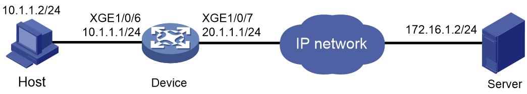

Example: Configuring Web caching
As shown in Figure 2, configure and enable Web caching on the device to cache Web content from the server.
Figure 2 Network diagram
1.     Configure IP addresses for interfaces. (Details not shown.)
2.     Create and enter Web cache view.
<Device> system-view
[Device] web-cache slot 1
3.     Configure Web caching parameters.
# Set the Web cache directory to slot0#flash:/webcache.
[Device-web-cache-slot1] file-directory slot1#flash:/webcache
# Set the Web caching listening port number to 9955.
[Device-web-cache-slot1] listen-port 9955
# Set the maximum total size for Web cache files to 10 GB.
[Device-web-cache-slot1] cache-limit 10
# Specify the types of the files on webpages to be cached.
[Device-web-cache-slot1] cached-data doc docx
4.     Enable Web caching.
[Device-web-cache-slot1] http enable

The command output shows the Web caching feature is operating correctly.
·     The value of the Miss count field in the command output from the first display command is 1. The value of the Hit count field in the command output from the second display command is 1. The second HTTP request hits the Web cache.
·     The value of the Download size field in the command output from the second display command is the same as that from the first display command. No Web data was downloaded from the Web server to the device after the device sent the second HTTP request.
