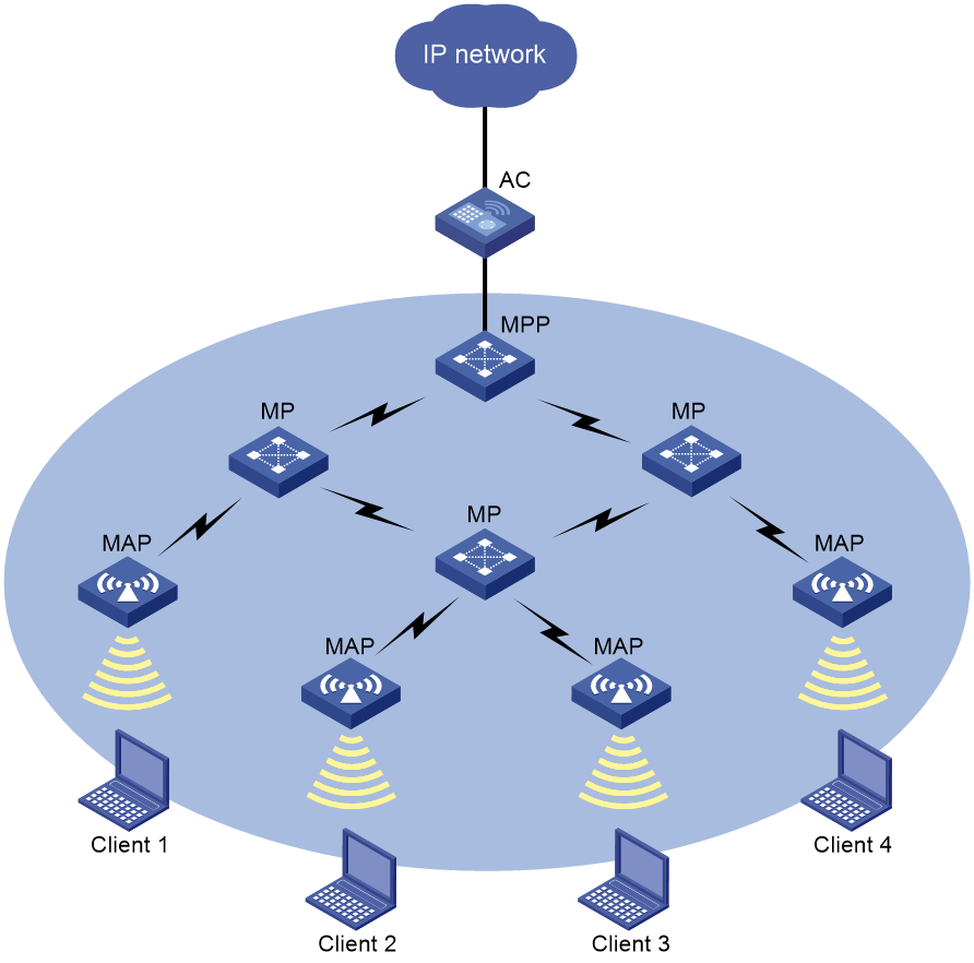

WLAN mesh network
Figure 1 shows a WLAN mesh network.
APs on a WLAN mesh network are mesh points (MPs). MPs play the following roles:
·     Single-purpose MP—Provides only mesh services.
·     Mesh access point (MAP)—Provides both mesh and access services.
·     Mesh portal point (MPP)—Provides a wired connection to a wired network.
Figure 1 WLAN mesh network diagram

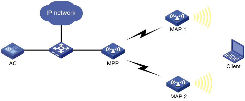

Wireless distribution system
Wireless distribution systems (WDSs) are applications of WLAN mesh. A WDS uses the mesh links between APs to connect dispersed LANs. The APs transfer the 802.3 frames that come from the LANs in the form of 802.11s frames over the mesh links.
You can create a WDS in point-to-point or star topology by administratively making sure mesh links are established between selected APs. Alternatively, you can use the topology that is created automatically by APs through automatic neighbor discovery and mesh link establishment without administrative intervention.

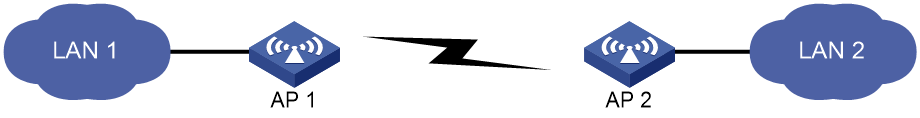

Point-to-point topology
As shown in Figure 3, you can set up a mesh link between two APs to connect two LANs.
Figure 3 WDS point to point topology

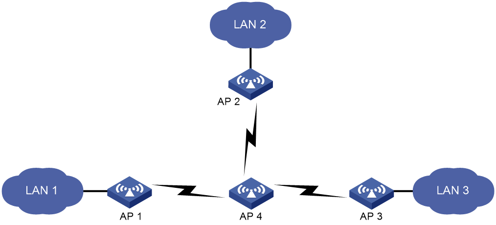

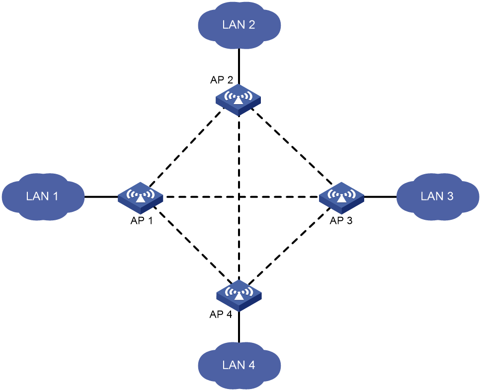

Star topology
As shown in Figure 4, you can set up mesh links between one central AP and multiple leaf APs to connect multiple LANs. In this topology, all data between LANs must traverse the central AP (AP 4 in this example).
Figure 4 Star topology

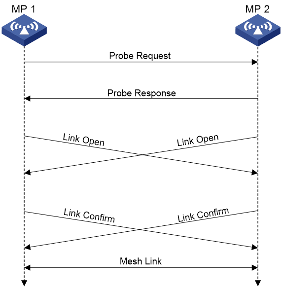

Topology created without administrative intervention
Without administrative intervention, the WDS topology depends on the result of automatic neighbor discovery and mesh link establishment between APs.
Figure 5 Automatic topology setup

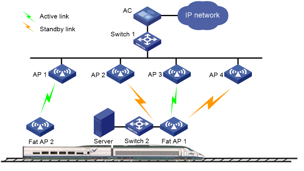

As shown in Figure 7, AP 1 through AP 4 are trackside MPs, and fat AP 1 and fat AP 2 are onboard MPs.
Figure 7 MLSP mesh network diagram

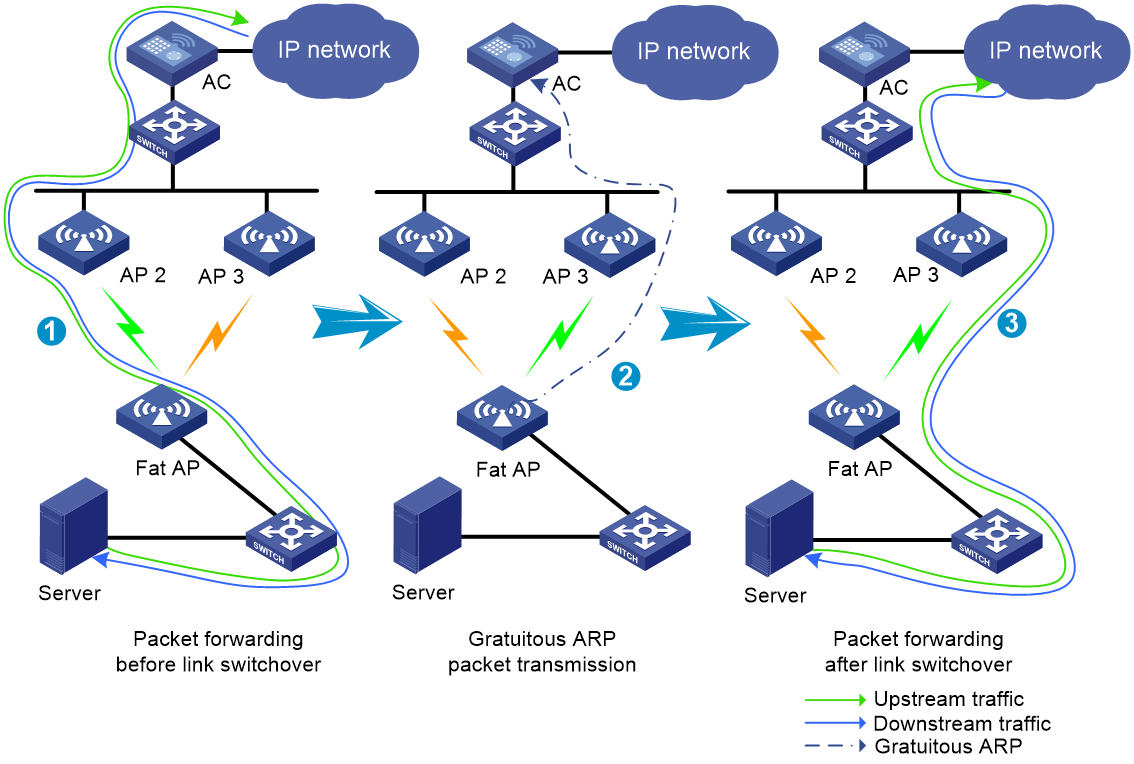

MLSP proxy
This feature enables an onboard MP to proxy an onboard device (typically an onboard server) for fast downlink packet forwarding path change when link switchover occurs.
As shown in Figure 8, an onboard MP uses the MAC address of the proxied device to send gratuitous ARP packets for MAC address table update of trackside MPs. This ensures fast transmission of downlink packets over the new active link after a link switchover.
Figure 8 Fast packet forwarding path change

Configuring MLSP
Prerequisites for MLSP
Make sure you have finished basic mesh profile and mesh policy configuration and the onboard MPs can successfully establish mesh links with the trackside MPs.
Configuring trackside MPs
2.     Enter mesh policy view.
wlan mesh-policy policy-name
3.     Enable mesh link initiation.
link-initiation enable
By default, mesh link initiation is enabled.
4.     Specify the signal transmission method.
transmission-method { air | waveguide }
By default, signals are transmitted over the air.
5.     (Optional.) Configure mesh link establishment and maintenance:
¡     Set the mesh link establishment threshold.
link-establish-threshold threshold-value
By default, the mesh link establishment threshold is 5 dBm.
¡     Set the mesh link hold RSSI.
link-hold-rssi value
By default, the mesh link hold RSSI is 15.
As a best practice, set the link hold RSSI for trackside MPs smaller than the link hold RSSI for onboard MPs in case the trackside MPs terminates mesh links actively.
¡     Set the mesh link saturation RSSI.
link-saturation-rssi value
By default, the mesh link saturation RSSI is 150.
¡     Disable temporary mesh link establishment.
undo temporary-link enable
By default, temporary mesh link establishment is enabled.
To prevent frequent temporary mesh link establishment from affecting trackside MP performance, you can disable this feature.
¡     Set the level of interval for sending keepalive requests.
active-link keepalive-transmit-level value
By default, the level of interval for sending keepalive request is 0.
Set the level on the AC that manages trackside MPs. Trackside MPs inform onboard MPs of the level to control the keepalive requests sent by the onboard MPs.
6.     (Optional.) Configure trackside MPs in the garage to switch from a fixed channel to an automatic channel.
a.     Specify the garage as the location of trackside MPs.
location-mode number
By default, the location of trackside MPs is not specified.
When the train returns to the garage, the onboard AP operating in fixed channel mode establishes a main link of mode 7 with the trackside fit APs in the garage. After the trackside fit APs send a specific number of keepalive packets to the onboard AP, the onboard AP will determine that the train is stopped and will automatically switch from fixed channel mode to auto channel mode.
b.     Bind a mesh policy to the trackside MP.
# Enter AP view.
wlan ap ap-name
# Enter radio view.
radio radio-id
# Bind a mesh policy to the radio.
mesh-policy name policy-name
By default:
-     In radio view, an AP uses the configuration in an AP group's radio view.
-     In an AP group's radio view, the system-defined mesh policy default_mesh_policy is bound to a radio.
Enabling Comware 7 APs to establish mesh connections with Comware 5 APs
In a scenario where both Comware 7 and Comware 5 APs are deployed, enable this feature on all Comware 7 APs that require mesh connections.
By default, a default mesh policy named default_mesh_policy exists.
3.     Enable Comware 7 APs to establish mesh connections with Comware 5 APs.
comware5-compatibility enable
By default, Comware 7 APs cannot establish mesh connections with Comware 5 APs.

Example: Configuring WLAN mesh
As shown in Figure 9, establish an 802.11n 5GHz WLAN mesh network to provide network access for the clients. Configure the MP and MAPs to establish mesh links on channel 149.
Figure 9 Network diagram
1.     Configure a mesh profile:
# Create a mesh profile.
<AC> system-view
[AC] wlan mesh-profile 1
# Set the mesh ID to 1.
[AC-wlan-mesh-profile-1] mesh-id 1
# Enable SAE for authentication and key management.
[AC-wlan-mesh-profile-1] akm mode sae
# Configure a preshared key.
[AC-wlan-mesh-profile-1] preshared-key pass-phrase simple 12345678
# Enable the mesh profile.
[AC-wlan-mesh-profile-1] mesh-profile enable
[AC-wlan-mesh-profile-1] quit
2.     Configure a service template.
[AC] wlan service-template service1
[AC-wlan-st-service1] ssid mesh-network
[AC-wlan-st-service1] service-template enable
[AC-wlan-st-service1] quit
3.     Configure settings for the MPP:
# Create an AP template for the MPP. Make sure you select the correct AP model and specify the correct serial ID.
[AC] wlan ap mpp model WA6320
[AC-wlan-ap-mpp] serial-id 219801A28N819CE0002T
# Bind the mesh profile to the MPP's radio 1.
[AC-wlan-ap-mpp] radio 1
[AC-wlan-ap-mpp-radio-1] mesh-profile 1
# Set the radio type of the MPP's radio 1 to 802.11n (5GHz).
[AC-wlan-ap-mpp-radio-1] type dot11an
# Set the working channel of the radio to 149.
[AC-wlan-ap-mpp-radio-1] channel 149
# Enable the radio.
[AC-wlan-ap-mpp-radio-1] radio enable
[AC-wlan-ap-mpp-radio-1] quit
# Disable the MPP from sending neighbor probe requests.
[AC-wlan-ap-mpp] portal-service enable
[AC-wlan-ap-mpp] quit
4.     Configure settings for the MAPs:
# Create an AP template for MAP 1. Make sure you select the correct AP model and specify the correct serial ID.
[AC] wlan ap map1 model WA6320
[AC-wlan-ap-map1] serial-id 210235A29G007C000050
# Bind the mesh profile to the MAP's radio 1.
[AC-wlan-ap-map1] radio 1
[AC-wlan-ap-map1-radio-1] mesh-profile 1
# Bind the service template to the MAP's radio 1.
[AC-wlan-ap-map1-radio-1] service-template service1
# Set the radio type of the MAP's radio 1 to 802.11n (5GHz).
[AC-wlan-ap-map1-radio-1] type dot11an
[AC-wlan-ap-map1-radio-1] channel 149
# Add the MAC address of radio 1 on the MPP to the mesh peer whitelist to avoid loops. MAP 1 can set up a mesh link only with the MPP.
[AC-wlan-ap-map1-radio-1] mesh peer-mac-address 77a2-c25d-e316
# Enable the radio.
[AC-wlan-ap-map1-radio-1] radio enable
[AC-wlan-ap-map1-radio-1] quit
[AC-wlan-ap-map1] quit
# Configure settings for MAP 2 in the same way settings for MAP 1 are configured.
[AC] wlan ap map2 model WA6320
[AC-wlan-ap-map2] serial-id 210235A29G007C000090
[AC-wlan-ap-map2] radio 1
[AC-wlan-ap-map2-radio-1] mesh-profile 1
[AC-wlan-ap-map2-radio-1] service-template service1
[AC-wlan-ap-map2-radio-1] type dot11an
[AC-wlan-ap-map2-radio-1] channel 149
[AC-wlan-ap-map2-radio-1] mesh peer-mac-address 77a2-c25d-e316
[AC-wlan-ap-map2-radio-1] radio enable
[AC-wlan-ap-map2-radio-1] quit
[AC-wlan-ap-map2] quit
[AC] quit
# Verify that the MPP and MAPs can establish mesh links.
<AC> display wlan mesh-link ap
AP Name: mpp
 Peer           Local          Status     RSSI Packets(Rx/Tx)
 4a9b-c5bb-e43f 77a2-c25d-e316 Forwarding 22   6058/1900
 a6b5-1c5a-22ff 77a2-c25d-e316 Forwarding 35   5354/1900
AP Name: map1
 77a2-c25d-e316 4a9b-c5bb-e43f Forwarding 22   1900/6058
AP Name: map2
 77a2-c25d-e316 a6b5-1c5a-22ff Forwarding 35   1900/5354
# Verify that the clients have associated with their respective APs.
<AC> display wlan client
Total number of clients: 1
MAC address    Username                                   R IP address      VLAN
000f-e265-6400 N/A                                        1 1.1.1.1         300
Example: Configuring VLAN settings for a WLAN mesh network
As shown in Figure 10, both LAN 1 and LAN 2 belong to VLAN 2. Configure MPP 1 and MPP 2 to establish a mesh link on channel 149, and to permit traffic from VLAN 2.
Figure 10 Network diagram

Example: Configuring MLSP
As shown in Figure 11, trackside MPs (AP 1 and AP 2) are connected to the AC through Switch 1, and the onboard MP (fat AP) is connected to the onboard server through Switch 2. Configure MLSP for the onboard MP to communicate with trackside MPs.
Figure 11 Network diagram
·     If multiple servers exist on the train, and each server must be connected to a different VLAN, configure the following settings:
¡     Create VLANs and VLAN interfaces on Switch 2. The VLAN interfaces are used as the gateways for the servers.
¡     Configure a static route from the IP network to each server.
·     If onboard devices and devices on the IP network communicate at Layer 3 and onboard MPs are deployed at both ends of the train, OSPF is required for traffic between these devices to be dynamically forwarded by the MP at the front or rear. You must configure the network type as NBMA on VLAN interfaces on Switch 1 and Switch 2, and manually specify the neighbor for the interfaces.
1.     Specify the IP address and gateway of the onboard server as 192.168.20.3 and 192.168.20.2, respectively. (Details not shown.)

# Display mesh link information on the onboard MP to verify that mesh links have been established.
<FatAP> display wlan mesh-link
 Peer MAC       RSSI BSSID          Interface         Link state    Online time
 d461-fe59-8620 74   d461-fe59-8380 WLAN-MeshLink129  Active(ac)    00h 02m 27s
 d461-fe59-87d0 49   d461-fe59-8380 WLAN-MeshLink130  Standby(ac)   00h 02m 07s
# Display mesh link information on the onboard MP to verify that an active/standby link switchover has occurred.
 d461-fe59-8620 52   d461-fe59-8380 WLAN-MeshLink129  Standby(ac)   00h 02m 37s
 d461-fe59-87d0 72   d461-fe59-8380 WLAN-MeshLink130  Active(ac)    00h 02m 17s
