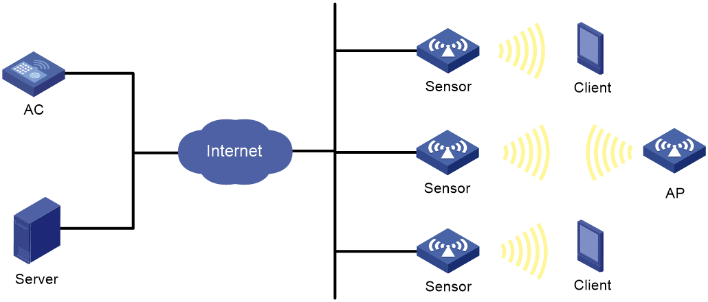

WLAN probe system
As shown in Figure 1, a WLAN probe system contains the following devices:
·     Sensors—APs enabled with WLAN probe. They scan the channels, collect wireless device information, and report the information to the server.
·     AC—Manages sensors and reports information received from sensors to the server.
·     Server—Analyzes the information received from sensors and the AC.
Figure 1 WLAN probe system
Working mechanism
A WLAN probe system operates as follows:
1.     Wireless devices send 802.11 packets.
2.     Sensors collect wireless device information, such as MAC address, device type, RSSI, and time stamp from the packets.
3.     Sensors send collected device information to the AC or server.
4.     The server analyzes the received information.

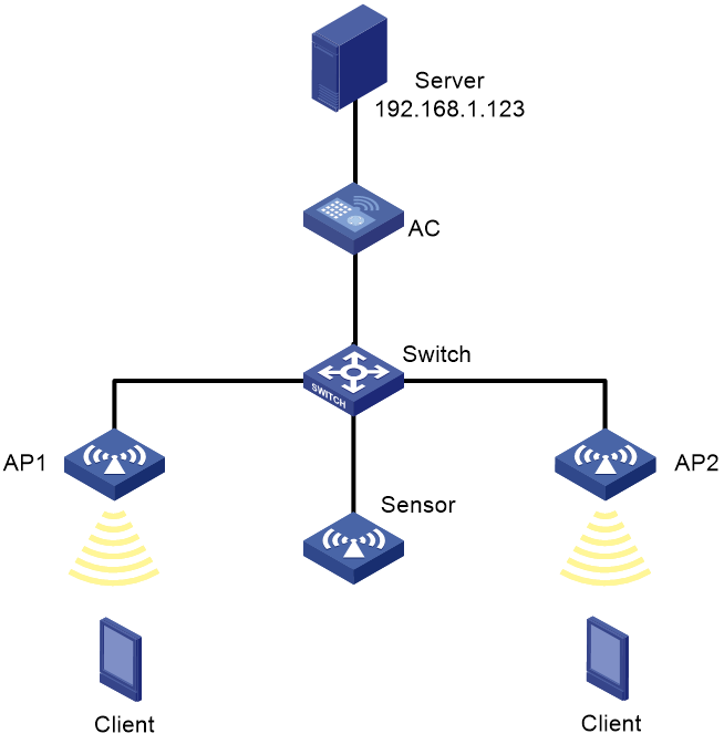

Example: Configuring WLAN probe
As shown in Figure 2, AP 1 and AP 2 provide wireless services for clients through SSID abc.
Enable WLAN probe on the sensor, and configure the AC to report the received wireless device information to the server.
Figure 2 Network diagram
# Configure wireless service settings on the AC. (Details not shown.)
For more information, see "Configuring WLAN access."
# Create AP Sensor, and enable WLAN probe for the AP.
<AC> system-view
[AC] wlan ap Sensor model WA6320
[AC-wlan-ap-Sensor] serial-id 219801A28N819CE0002T
[AC-wlan-ap-Sensor] radio 1
[AC-wlan-ap-Sensor-radio-1] radio enable
[AC-wlan-ap-Sensor-radio-1] client-proximity-sensor enable
[AC-wlan-ap-Sensor-radio-1] quit
[AC-wlan-ap-Sensor] radio 2
[AC-wlan-ap-Sensor-radio-2] radio enable
[AC-wlan-ap-Sensor-radio-2] client-proximity-sensor enable
[AC-wlan-ap-Sensor] quit
# Configure the sensor to report wireless device information to the AC.
[AC] client-proximity-sensor report-ac enable
# Configure the AC to report wireless device information to the UDP server with IP address 192.168.1.123 and port number 1234, and set the report interval to 20 seconds.
[AC] client-proximity-sensor udp-server 192.168.1.123 port 1234 interval 20
# Display wireless device information detected by the sensor.
[AC] display client-proximity-sensor device
Total 3 detected devices
MAC address    Type      Duration    Sensors Channel Status
0021-632F-E9E5 Client    00h 10m 46s 1       11      Active
0021-6330-148B Client    00h 10m 46s 1       6       Active
0212-34B8-A8E0 Client    00h 10m 46s 1       1       Active
# On the management console of the server, view the wireless device information received from the AC. (Details not shown.)
