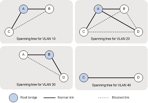

About PVST
In an STP- or RSTP-enabled LAN, all bridges share one spanning tree. Traffic from all VLANs is forwarded along the spanning tree, and ports cannot be blocked on a per-VLAN basis to prune loops.
PVST allows every VLAN to have its own spanning tree, which increases usage of links and bandwidth. Because each VLAN runs RSTP independently, a spanning tree only serves its VLAN.
A PVST-enabled H3C device can communicate with a third-party device that is running Rapid PVST or PVST. The PVST-enabled H3C device supports fast network convergence like RSTP when connected to PVST-enabled H3C devices or third-party devices enabled with Rapid PVST.
PVST protocol frames
As shown in Figure 7, a PVST BPDU uses the same format as an RSTP BPDU except the following differences:
·     The destination MAC address of a PVST BPDU is 01-00-0c-cc-cc-cd, which is a private MAC address.
·     Each PVST BPDU carries a VLAN tag. The VLAN tag identifies the VLAN to which the PVST BPDU belongs.
·     The organization code and PID fields are added to the LLC header of the PVST BPDU.
Figure 7 PVST BPDU format
A port's link type determines the type of BPDUs the port sends.
·     An access port sends RSTP BPDUs.
·     A trunk or hybrid port sends RSTP BPDUs in the default VLAN and sends PVST BPDUs in other VLANs.
How PVST works
PVST implements per-VLAN spanning tree calculation by mapping each VLAN to an MSTI. In PVST, each VLAN runs RSTP independently to maintain its own spanning tree without affecting the spanning trees of other VLANs. In this way, loops in each VLAN are eliminated and traffic of different VLANs is load shared over links. PVST uses RSTP BPDUs in the default VLAN and PVST BPDUs in other VLANs for spanning tree calculation.
PVST uses the same port roles and port states as RSTP for rapid transition. For more information, see "Basic concepts in RSTP."

·     PVST mode—All ports of the device send PVST BPDUs. Each VLAN maintains a spanning tree. In a network, the amount of spanning trees maintained by all devices equals the number of PVST-enabled VLANs multiplied by the number of PVST-enabled ports. If the amount of spanning trees exceeds the capacity of the network, device CPUs will be overloaded. Packet forwarding is interrupted, and the network becomes unstable.The device supports a maximum of 15 spanning tree-enabled VLANs.

Compatibility of the PVST mode depends on the link type of a port.
·     On an access port, the PVST mode is compatible with other spanning tree modes in all VLANs.
·     On a trunk port or hybrid port, the PVST mode is compatible with other spanning tree modes only in the default VLAN.

As shown in Figure 20, all devices on the network are in the same MST region. Device A and Device B work at the distribution layer. Device C and Device D work at the access layer.
Configure MSTP so that frames of different VLANs are forwarded along different spanning trees.
·     VLAN 10 frames are forwarded along MSTI 1.
·     VLAN 30 frames are forwarded along MSTI 3.
·     VLAN 40 frames are forwarded along MSTI 4.
·     VLAN 20 frames are forwarded along MSTI 0.
VLAN 10 and VLAN 30 are terminated on the distribution layer devices, and VLAN 40 is terminated on the access layer devices. The root bridges of MSTI 1 and MSTI 3 are Device A and Device B, respectively, and the root bridge of MSTI 4 is Device C.
Figure 20 Network diagram

In this example, Device B has the lowest root bridge ID. As a result, Device B is elected as the root bridge in MSTI 0.
When the network is stable, you can use the display stp brief command to display brief spanning tree information on each device.
# Display brief spanning tree information on Device A.
[DeviceA] display stp brief
 VLAN ID     Port                         Role  STP State     Protection
 10          GigabitEthernet1/0/1         DESI  FORWARDING    NONE
 10          GigabitEthernet1/0/3         DESI  FORWARDING    NONE
 20          GigabitEthernet1/0/1         DESI  FORWARDING    NONE
 20          GigabitEthernet1/0/2         DESI  FORWARDING    NONE
 20          GigabitEthernet1/0/3         DESI  FORWARDING    NONE
 30          GigabitEthernet1/0/2         DESI  FORWARDING    NONE
 30          GigabitEthernet1/0/3         ROOT  FORWARDING    NONE
# Display brief spanning tree information on Device B.
[DeviceB] display stp brief
 10          GigabitEthernet1/0/2         DESI  FORWARDING    NONE
 10          GigabitEthernet1/0/3         ROOT  FORWARDING    NONE
 20          GigabitEthernet1/0/3         ROOT  FORWARDING    NONE
 30          GigabitEthernet1/0/1         DESI  FORWARDING    NONE
 30          GigabitEthernet1/0/3         DESI  FORWARDING    NONE
# Display brief spanning tree information on Device C.
[DeviceC] display stp brief
 10          GigabitEthernet1/0/1         ROOT  FORWARDING    NONE
 10          GigabitEthernet1/0/2         ALTE  DISCARDING    NONE
 20          GigabitEthernet1/0/1         ROOT  FORWARDING    NONE
 20          GigabitEthernet1/0/2         ALTE  DISCARDING    NONE
 40          GigabitEthernet1/0/3         DESI  FORWARDING    NONE
# Display brief spanning tree information on Device D.
[DeviceD] display stp brief
 20          GigabitEthernet1/0/1         ALTE  DISCARDING    NONE
 20          GigabitEthernet1/0/2         ROOT  FORWARDING    NONE
 20          GigabitEthernet1/0/3         ALTE  DISCARDING    NONE
 30          GigabitEthernet1/0/1         ROOT  FORWARDING    NONE
 30          GigabitEthernet1/0/2         ALTE  DISCARDING    NONE
 40          GigabitEthernet1/0/3         ROOT  FORWARDING    NONE
Based on the output, you can draw a topology for each VLAN spanning tree, as shown in Figure 23.
Figure 23 VLAN spanning tree topologies
