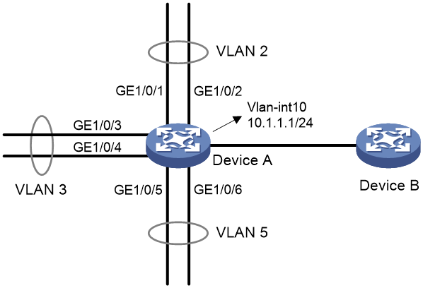

VLAN frame encapsulation
To identify Ethernet frames from different VLANs, IEEE 802.1Q inserts a four-byte VLAN tag between the destination and source MAC address (DA&SA) field and the Type field.
Figure 1 VLAN tag placement and format

VLAN configuration examples
Example: Configuring port-based VLANs
As shown in Figure 2:
·     Host A and Host C belong to Department A. VLAN 100 is assigned to Department A.
·     Host B and Host D belong to Department B. VLAN 200 is assigned to Department B.
Configure port-based VLANs so that only hosts in the same department can communicate with each other.
Figure 2 Network diagram
1.     Configure Device A:
# Create VLAN 100, and assign GigabitEthernet 1/0/1 to VLAN 100.
<DeviceA> system-view
[DeviceA] vlan 100
[DeviceA-vlan100] port gigabitethernet 1/0/1
[DeviceA-vlan100] quit
# Create VLAN 200, and assign GigabitEthernet 1/0/2 to VLAN 200.
[DeviceA] vlan 200
[DeviceA-vlan200] port gigabitethernet 1/0/2
[DeviceA-vlan200] quit
# Configure GigabitEthernet 1/0/3 as a trunk port, and assign the port to VLANs 100 and 200.
[DeviceA] interface gigabitethernet 1/0/3
[DeviceA-GigabitEthernet1/0/3] port link-type trunk
[DeviceA-GigabitEthernet1/0/3] port trunk permit vlan 100 200
Please wait... Done.
2.     Configure Device B in the same way Device A is configured. (Details not shown.)
3.     Configure hosts:
a.     Configure Host A and Host C to be on the same IP subnet. For example, 192.168.100.0/24.
b.     Configure Host B and Host D to be on the same IP subnet. For example, 192.168.200.0/24.
# Verify that Host A and Host C can ping each other, but they both fail to ping Host B and Host D. (Details not shown.)
# Verify that Host B and Host D can ping each other, but they both fail to ping Host A and Host C. (Details not shown.)
# Verify that VLANs 100 and 200 are correctly configured on Device A.
[DeviceA-GigabitEthernet1/0/3] display vlan 100
 VLAN ID: 100
 VLAN type: Static
 Route interface: Not configured
 Description: VLAN 0100
 Tagged ports:
 Untagged ports:
    GigabitEthernet1/0/1
[DeviceA-GigabitEthernet1/0/3] display vlan 200
 VLAN ID: 200
 VLAN type: Static
 Description: VLAN 0200
 Tagged ports:
 Untagged ports:
    GigabitEthernet1/0/2
Configuring super VLANs

Figure 4 shows the workflow of advertising the voice VLAN information to IP phones.
Figure 4 Workflow of advertising the voice VLAN information to IP phones
IP phone access methods
Connecting the host and the IP phone in series
As shown in Figure 5, the host is connected to the IP phone, and the IP phone is connected to the device. In this scenario, the following requirements must be met:
·     The host and the IP phone use different VLANs.
·     The IP phone is able to send out VLAN-tagged packets, so that the device can differentiate traffic from the host and the IP phone.
·     The port connecting to the IP phone forwards packets from the voice VLAN and the PVID.
Figure 5 Connecting the host and IP phone in series

As shown in Figure 7, Device A transmits traffic from IP phones and hosts.
For correct voice traffic transmission, perform the following tasks on Device A:
·     Configure voice VLANs 2 and 3 to transmit voice packets from IP phone A and IP phone B, respectively.
·     Configure GigabitEthernet 1/0/1 and GigabitEthernet 1/0/2 to operate in automatic voice VLAN assignment mode.
·     Add MAC addresses of IP phones A and B to the device for voice packet identification. The mask of the two MAC addresses is FFFF-FF00-0000.
·     Set an aging timer for voice VLANs.
Figure 7 Network diagram

Example: Configuring manual voice VLAN assignment mode
As shown in Figure 8, IP phone A send untagged voice traffic.
To enable GigabitEthernet 1/0/1 to transmit only voice packets, perform the following tasks on Device A:
·     Create VLAN 2. This VLAN will be used as a voice VLAN.
·     Configure GigabitEthernet 1/0/1 to operate in manual voice VLAN assignment mode and add it to VLAN 2.
·     Add the OUI address of IP phone A to the OUI list of Device A.
Figure 8 Network diagram
