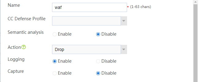

# In the basic configuration area, configure the following parameters:
¡     Enter name waf.
¡     Set the action to drop.
¡     Enable logging.
¡     Use the default settings for other parameters.
Figure 2 Configuring the basic settings

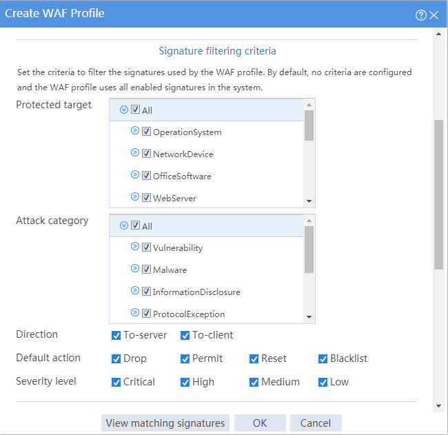

# In the Signature filtering criteria area, perform the following settings:
¡     Select All for the protected targets.
¡     Select All for the attack categories.
¡     Set To-server and To-client for the direction.
¡     Set the default actions to drop, permit, reset, and blacklist.
¡     Set the severity levels to critical, high, medium, and low.
Figure 3 Signature filtering criteria configuration
