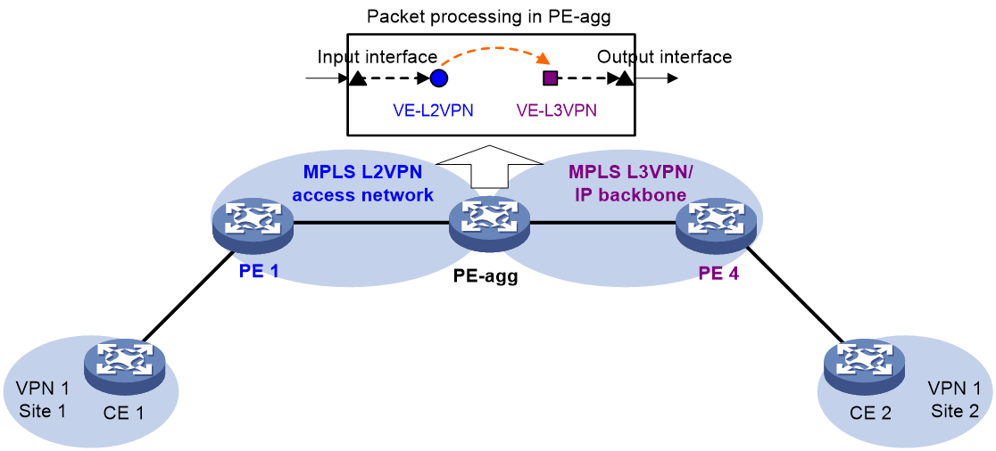

Improved L2VPN access to L3VPN or IP backbone
In the improved networking mode, the functions of the two devices that connect the MPLS L2VPN and the MPLS L3VPN or IP backbone can be implemented on one device. Thus, you can reduce the number of devices to be deployed, and lower the networking cost and the network deployment complexity.
As shown in Figure 2, the PE Aggregation (PE-agg) device connects the MPLS L2VPN with the MPLS L3VPN or IP backbone. PE-agg terminates the MPLS L2VPN and provides access to the MPLS L3VPN or IP backbone.
Configure the PE-agg as follows so the PE-agg can implement the functions of both PE 2 and PE 3 in Figure 1:
1.     Create a terminating virtual Ethernet (VE) interface on the PE-agg to terminate MPLS L2VPN packets.
This interface is referred to as the VE-L2VPN (L2VE) interface. The functions and configurations of the interface are similar to those of the terminating interface (Terminating int) in Figure 1.
2.     Create an access VE interface on the PE-agg to provide access to the backbone, and configure the interface and the L2VE interface have the same interface number.
This interface is referred to as the VE-L3VPN (L3VE) interface. The functions and configurations of the interface are similar to those of the access interface (Access int) in Figure 1. The IP address of the L3VE interface must be in the same network segment as the AC interface of CE 1. When the backbone is an MPLS L3VPN, bind the VPN instance to the L3VE interface. The interface can then forward user packets through the VPN routes.
The L2VE interface directly delivers the obtained Layer 2 packets to the L3VE interface. The two VE interfaces can be considered directly connected through a physical link.
Figure 2 Network diagram
The PE-agg connects the MPLS L2VPN and the backbone through the L2VE interface and the L3VE interface. You can assume that the MPLS L2VPN is connected to the backbone through an Ethernet or VLAN link. If a user is not connected to the MPLS L2VPN through Ethernet or VLAN, you must configure MPLS L2VPN interworking on the user access PE (PE 1) and the L2VE interface of the PE-agg.

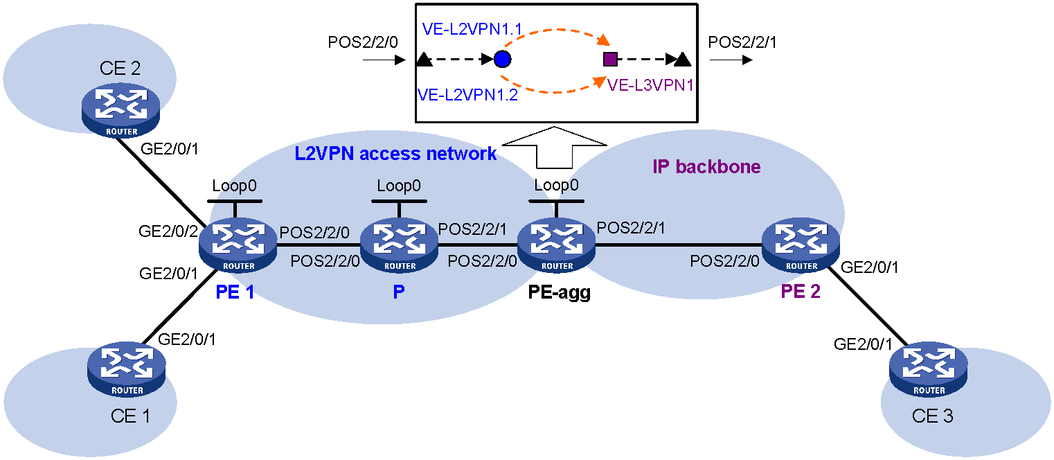

To configure L2VPN access to MPLS L3VPN or IP backbone through multiple PWs, you must create multiple subinterfaces on the L2VE interface. All these subinterfaces on the L2VE interface must be connected to the same L3VE interface.
The VPLS access to L3VPN or IP backbone model does not support creating L2VE subinterfaces.

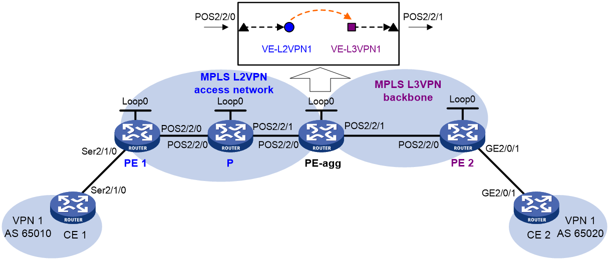

Example: Configuring access to MPLS L3VPN through an LDP MPLS L2VPN
The MPLS L2VPN in this configuration example is a point-to-point MPLS L2VPN that provides PPP-to-Ethernet interworking.
The backbone is an MPLS L3VPN, which advertises VPN routes through BGP and forwards VPN packets based on MPLS labels.
CE 1 and CE 2 belong to VPN 1 whose route target is 111:1 and RD is 200:1. CE 1 is connected to PE 1 through interface Serial 2/1/0, which uses PPP encapsulation. CE 2 is connected to the MPLS L3VPN through interface GigabitEthernet 2/0/1.
Perform the following configurations to allow communication between CE 1 and CE 2:
·     Set up an LDP PW between PE 1 and PE-agg, so that CE 1 can access the MPLS L3VPN through MPLS L2VPN.
·     Configure MPLS L2VPN interworking on interface Serial 2/1/0 of PE 1 and the L2VE interface of PE-agg.
This configuration is required because CE 1 is connected to the MPLS L2VPN through PPP, not Ethernet or VLAN.
·     Run EBGP between CE 1 and PE-agg and between CE 2 and PE 2 to exchange VPN routing information.
·     Run MP-IBGP between PE-agg and PE 2 to exchange VPN routing information.
·     Run IS-IS between PE-agg and PE 2 to ensure IP connectivity within the backbone.
·     Run OSPF among PE 1, P, and PE-agg to ensure IP connectivity between the PEs.
Figure 3 Network diagram
Device
Interface
IP address
Device
Interface
IP address
CE 1
Ser2/1/0
100.1.1.1/24
PE-agg
Loop0
3.3.3.9/32
PE 1
Loop0
1.1.1.9/32
POS2/2/0
10.2.2.2/24
POS2/2/0
10.2.1.1/24
POS2/2/1
10.3.3.1/24
P
Loop0
2.2.2.9/32
VE-L3VPN1
100.1.1.2/24
POS2/2/0
10.2.1.2/24
PE 2
Loop0
4.4.4.9/32
POS2/2/1
10.2.2.1/24
POS2/2/0
10.3.3.2/24
CE 2
GE2/0/1
100.2.1.2/24
GE2/0/1
100.2.1.1/24
1.     Configure IP addresses for interfaces as shown in Table 1. (Details not shown.)
2.     Create VE-L2VPN 1 and VE-L3VPN 1 on PE-agg:
# Create VE-L2VPN 1.
<PEagg> system-view
[PEagg] interface ve-l2vpn 1
[PEagg-VE-L2VPN1] quit
# Create VE-L3VPN 1.
[PEagg] interface ve-l3vpn 1
[PEagg-VE-L3VPN1] quit

# Configure PE-agg.
[PEagg] l2vpn enable
d.     Configure the AC interfaces of PE 1 and PE-agg, create PWs that support interworking, and bind the interface to the PWs:
# On Serial 2/1/0 of PE 1, configure PPP to support IPCP negotiation without IP address.
[PE1] interface serial 2/1/0
[PE1-Serial2/1/0] link-protocol ppp
[PE1-Serial2/1/0] ppp ipcp ignore local-ip
[PE1-Serial2/1/0] quit
# On PE 1, create a PW that supports interworking in the group, and bind Serial 2/1/0 to the PW.
[PE1] xconnect-group 1
[PE1-xcg-1] connection 1
[PE1-xcg-1-1] ac interface serial 2/1/0
[PE1-xcg-1-1] interworking ipv4
[PE1-xcg-1-1] peer 3.3.3.9 pw-id 101
[PE1-xcg-1-1-3.3.3.9-101] quit
# On the L2VE interface of PE-agg, specify the default next hop as 100.1.1.2.
[PEagg-VE-L2VPN1] default-nexthop ip 100.1.1.2
# On PE-agg, create a PW that supports interworking in the group, and bind VE-L2VPN 1 to the PW.
[PEagg] xconnect-group 1
[PEagg-xcg-1] connection 1
[PEagg-xcg-1-1] ac interface ve-l2vpn 1
[PEagg-xcg-1-1] interworking ipv4
[PEagg-xcg-1-1] peer 1.1.1.9 pw-id 101
[PEagg-xcg-1-1-1.1.1.9-101] quit
e.     Configure the AC interface of CE 1 (Serial 2/1/0).
<CE1> system-view
[CE1] interface serial 2/1/0
[CE1-Serial2/1/0] link-protocol ppp
[CE1-Serial2/1/0] ip address 100.1.1.1 24
4.     Configure MPLS L3VPN:
a.     Configure IS-IS on PE 2 and PE-agg, and advertise interface addresses:
# Configure PE-agg.
[PEagg] isis 1
[PEagg-isis-1] network-entity 10.0000.0000.0001.00
[PEagg-isis-1] quit
[PEagg] interface pos 2/2/1
[PEagg-Pos2/2/1] isis enable 1
[PEagg-Pos2/2/1] quit
[PEagg] interface loopback 0
[PEagg-LoopBack0] isis enable 1
[PEagg-LoopBack0] quit
# Configure PE 2.
[PE2] isis 1
[PE2-isis-1] network-entity 10.0000.0000.0002.00
[PE2-isis-1] quit
[PE2] interface pos 2/2/0
[PE2-Pos2/2/0] isis enable 1
[PE2-Pos2/2/0] quit
[PE2] interface loopback 0
[PE2-LoopBack0] isis enable 1
[PE2-LoopBack0] quit
b.     Configure basic MPLS and MPLS LDP on PE-agg and PE 2:
# Configure PE-agg.
[PEagg-Pos2/2/1] mpls enable
[PEagg-Pos2/2/1] mpls ldp enable
# Configure PE 2.
[PE2] mpls lsr-id 4.4.4.9
[PE2] mpls ldp
[PE2-ldp] lsp-trigger all
[PE2-ldp] quit
[PE2-Pos2/2/0] mpls enable
[PE2-Pos2/2/0] mpls ldp enable
[PE2-Pos2/2/0] quit
c.     On PE-agg and PE 2, create VPN instance VPN1, and bind the VPN instance to the interface connected to the CE:
# Configure PE-agg.
[PEagg] ip vpn-instance VPN1
[PEagg-vpn-instance-VPN1] route-distinguisher 200:1
[PEagg-vpn-instance-VPN1] vpn-target 111:1 both
[PEagg-vpn-instance-VPN1] quit
[PEagg-VE-L3VPN1] ip binding vpn-instance VPN1
[PEagg-VE-L3VPN1] ip address 100.1.1.2 24
# Configure PE 2.
[PE2] ip vpn-instance VPN1
[PE2-vpn-instance-VPN1] route-distinguisher 200:1
[PE2-vpn-instance-VPN1] vpn-target 111:1 both
[PE2-vpn-instance-VPN1] quit
[PE2] interface gigabitethernet 2/0/1
[PE2-GigabitEthernet2/0/1] ip binding vpn-instance VPN1
[PE2-GigabitEthernet2/0/1] ip address 100.2.1.1 24
[PE2-GigabitEthernet2/0/1] quit
d.     Establish EBGP peer relationships between CE 1 and PE-agg, and between CE 2 and PE 2 to redistribute VPN routes:
# Configure CE 1 and specify PE-agg as the peer.
<CE1> system-view
[CE1] bgp 65010
[CE1-bgp] peer 100.1.1.2 as-number 100
[CE1-bgp] address-family ipv4
[CE1-bgp-ipv4] peer 100.1.1.2 enable
[CE1-bgp-ipv4] import-route direct
[CE1-bgp-ipv4] quit
[CE1-bgp] quit
# Configure PE-agg and specify CE 1 as the peer.
[PEagg] bgp 100
[PEagg-bgp] ip vpn-instance VPN1
[PEagg-bgp-VPN1] peer 100.1.1.1 as-number 65010
[PEagg-bgp-VPN1] address-family ipv4
[PEagg-bgp-ipv4-VPN1] peer 100.1.1.1 enable
[PEagg-bgp-ipv4-VPN1] import-route direct
[PEagg-bgp-ipv4-VPN1] quit
[PEagg-bgp-VPN1] quit
[PEagg-bgp] quit
# Configure CE 2 and specify PE 2 as the peer.
[CE2] bgp 65020
[CE2-bgp] peer 100.2.1.1 as-number 100
[CE2-bgp] address-family ipv4
[CE2-bgp-ipv4] peer 100.2.1.1 enable
[CE2-bgp-ipv4] import-route direct
[CE2-bgp-ipv4] quit
[CE2-bgp] quit
# Configure PE 2 and specify CE 2 as the peer.
[PE2] bgp 100
[PE2-bgp] ip vpn-instance VPN1
[PE2-bgp-VPN1] peer 100.2.1.2 as-number 65020
[PE2-bgp-VPN1] address-family ipv4
[PE2-bgp-ipv4-VPN1] peer 100.2.1.2 enable
[PE2-bgp-ipv4-VPN1] import-route direct
[PE2-bgp-ipv4-VPN1] quit
[PE2-bgp-VPN1] quit
[PE2-bgp] quit
e.     Establish an MP-IBGP peer relationship between PE-agg and PE 2:
# Configure PE-agg.
[PEagg] bgp 100
[PEagg-bgp] peer 4.4.4.9 as-number 100
[PEagg-bgp] peer 4.4.4.9 connect-interface loopback 0
[PEagg-bgp] address-family vpnv4
[PEagg-bgp-vpnv4] peer 4.4.4.9 enable
[PEagg-bgp-vpnv4] quit
[PEagg-bgp] quit
# Configure PE 2.
[PE2] bgp 100
[PE2-bgp] peer 3.3.3.9 as-number 100
[PE2-bgp] peer 3.3.3.9 connect-interface loopback 0
[PE2-bgp] address-family vpnv4
[PE2-bgp-vpnv4] peer 3.3.3.9 enable
[PE2-bgp-vpnv4] quit
[PE2-bgp] quit
5.     The default MTU value varies by interface type. To avoid packet fragmentation, set the MTU value for each POS interface on each device to 1500 bytes. The following shows the MTU configuration on PE 1.
[PE1] interface pos 2/2/0
[PE1-Pos2/2/0] mtu 1500
[PE1-Pos2/2/0] shutdown
[PE1-Pos2/2/0] undo shutdown
# Ping CE 2 from CE 1 to verify their connectivity.
<CE1> ping 100.2.1.2
Ping 100.2.1.2 (100.2.1.2): 56 data bytes, press CTRL_C to break
56 bytes from 100.2.1.2: icmp_seq=0 ttl=128 time=1.073 ms
56 bytes from 100.2.1.2: icmp_seq=1 ttl=128 time=1.428 ms
56 bytes from 100.2.1.2: icmp_seq=2 ttl=128 time=19.367 ms
56 bytes from 100.2.1.2: icmp_seq=3 ttl=128 time=1.013 ms
56 bytes from 100.2.1.2: icmp_seq=4 ttl=128 time=0.684 ms
--- Ping statistics for 100.2.1.2 ---
round-trip min/avg/max/std-dev = 0.684/4.713/19.367/7.331 ms

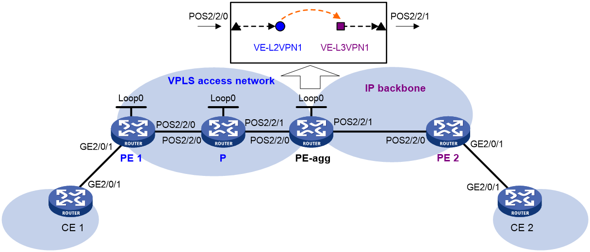

Example: Configuring access to IP backbone through an LDP VPLS
Create an LDP PW between PE 1 and PE-agg on the VPLS access network, so that CE 1 can access the IP backbone through the PW.
Configure OSPF process 2 to advertise routing information on the IP backbone.
Figure 4 Network diagram
Device
Interface
IP address
Device
Interface
IP address
CE 1
GE2/0/1
100.1.1.1/24
PE-agg
Loop0
3.3.3.9/32
PE 1
Loop0
1.1.1.9/32
POS2/2/0
10.2.2.2/24
POS2/2/0
10.2.1.1/24
POS2/2/1
10.3.3.1/24
P
Loop0
2.2.2.9/32
VE-L3VPN1
100.1.1.2/24
POS2/2/0
10.2.1.2/24
PE 2
POS2/2/0
10.3.3.2/24
POS2/2/1
10.2.2.1/24
GE2/0/1
100.2.1.1/24
CE 2
GE2/0/1
100.2.1.2/24
1.     Configure IP addresses for interfaces as shown in Table 2. (Details not shown.)

Example: Configuring LDP PW access to IP backbone through L2VE subinterfaces
Create LDP PWs between PE 1 and PE-agg on the L2VPN access network, so that CE 1 and CE 2 can access the IP backbone through the PWs.
Configure L2VPN access to the IP backbone through L2VE subinterfaces.
Figure 5 Network diagram
Table 3 Interface and IP address assignment
Device
Interface
IP address
Device
Interface
IP address
CE 1
GE2/0/1
100.1.1.1/24
CE 2
GE 1/0/1
100.1.1.2/24
PE 1
Loop0
1.1.1.9/32
PE-agg
Loop0
3.3.3.9/32
POS2/2/0
10.2.1.1/24
POS2/2/0
10.2.2.2/24
P
Loop0
2.2.2.9/32
POS2/2/1
10.3.3.1/24
POS2/2/0
10.2.1.2/24
VE-L3VPN1
100.1.1.3/24
POS2/2/1
10.2.2.1/24
PE 2
POS2/2/0
10.3.3.2/24
CE 3
GE2/0/1
100.2.1.2/24
GE2/0/1
100.2.1.1/24
1.     Configure IP addresses for interfaces as shown in Table 3. (Details not shown.)
# Create VE-L2VPN 1, VE-L2VPN 1.1, and VE-L2VPN 1.2.
<PEagg> system-view
[PEagg] interface ve-l2vpn 1.1
[PEagg-VE-L2VPN1.1] quit
[PEagg] interface ve-l2vpn 1.2
[PEagg-VE-L2VPN1.2] quit
# Create VE-L3VPN 1, and configure an IP address for the interface.
[PEagg-VE-L3VPN1] ip address 100.1.1.3 24
3.     Configure MPLS L2VPN:
a.     Configure OSPF on PE 1, P, and PE-agg, and advertise interface addresses:
# Configure PE 1.
<PE1> system-view
[PE1] ospf
[PE1-ospf-1] area 0
[PE1-ospf-1-area-0.0.0.0] network 1.1.1.9 0.0.0.0
[PE1-ospf-1-area-0.0.0.0] network 10.2.1.0 0.0.0.255
[PE1-ospf-1-area-0.0.0.0] quit
[PE1-ospf-1] quit
# Configure the P device.
<P> system-view
[P] ospf
[P-ospf-1] area 0
[P-ospf-1-area-0.0.0.0] network 2.2.2.9 0.0.0.0
[P-ospf-1-area-0.0.0.0] network 10.2.2.0 0.0.0.255
[P-ospf-1-area-0.0.0.0] network 10.2.1.0 0.0.0.255
[P-ospf-1-area-0.0.0.0] quit
[P-ospf-1] quit
# Configure PE-agg.
[PEagg] ospf
[PEagg-ospf-1] area 0
[PEagg-ospf-1-area-0.0.0.0] network 3.3.3.9 0.0.0.0
[PEagg-ospf-1-area-0.0.0.0] network 10.2.2.0 0.0.0.255
[PEagg-ospf-1-area-0.0.0.0] quit
[PEagg-ospf-1] quit
b.     Configure basic MPLS and MPLS LDP on PE 1, P, and PE-agg:
# Configure PE 1.
[PE1] mpls lsr-id 1.1.1.9
[PE1] mpls ldp
[PE1-ldp] lsp-trigger all
[PE1-ldp] quit
[PE1-Pos2/2/0] mpls enable
[PE1-Pos2/2/0] mpls ldp enable
[PE1-Pos2/2/0] quit
[P] mpls lsr-id 2.2.2.9
[P] mpls ldp
[P-ldp] lsp-trigger all
[P-ldp] quit
[P] interface pos 2/2/0
[P-Pos2/2/0] mpls enable
[P-Pos2/2/0] mpls ldp enable
[P-Pos2/2/0] quit
[P] interface pos 2/2/1
[P-Pos2/2/1] mpls enable
[P-Pos2/2/1] mpls ldp enable
[P-Pos2/2/1] quit
# Configure PE-agg.
[PEagg] mpls lsr-id 3.3.3.9
[PEagg] mpls ldp
[PEagg-ldp] lsp-trigger all
[PEagg-ldp] quit
[PEagg] interface pos 2/2/0
[PEagg-Pos2/2/0] mpls enable
[PEagg-Pos2/2/0] mpls ldp enable
[PEagg-Pos2/2/0] quit
c.     Enable L2VPN on PE 1 and PE-agg:
# Configure PE 1.
[PE1] l2vpn enable
# Configure PE-agg.
d.     Create cross-connect groups on PE 1 and PE-agg:
# On PE-agg, create a cross-connect group named vpna, create a cross-connect named ldp in the group, and bind VE-L2VPN 1.1 to the cross-connect.
[PEagg] xconnect-group vpna
[PEagg-xcg-vpna] connection ldp
[PEagg-xcg-vpna-ldp] ac interface ve-l2vpn 1.1
# On PE-agg, create an LDP PW for the cross-connect to bind the AC to the PW.
[PEagg-xcg-vpna-ldp] peer 1.1.1.9 pw-id 500
[PEagg-xcg-vpna-ldp-1.1.1.9-500] quit
[PEagg-xcg-vpna-ldp] quit
[PEagg-xcg-vpna] quit
# On PE-agg, create a cross-connect group named vpnb, create a cross-connect named ldp in the group, and bind VE-L2VPN 1.2 to the cross-connect.
[PEagg] xconnect-group vpnb
[PEagg-xcg-vpnb] connection ldp
[PEagg-xcg-vpnb-ldp] ac interface ve-l2vpn 1.2
[PEagg-xcg-vpnb-ldp] peer 1.1.1.9 pw-id 501
[PEagg-xcg-vpnb-ldp-1.1.1.9-501] quit
[PEagg-xcg-vpnb-ldp] quit
[PEagg-xcg-vpnb] quit
# On PE 1, create a cross-connect group named vpna, create a cross-connect named ldp in the group, and bind GigabitEthernet 2/0/1 to the cross-connect.
[PE1] xconnect-group vpna
[PE1-xcg-vpna] connection ldp
[PE1-xcg-vpna-ldp] ac interface gigabitethernet 2/0/1
# On PE 1, create an LDP PW for the cross-connect to bind the AC to the PW.
[PE1-xcg-vpna-ldp] peer 3.3.3.9 pw-id 500
[PE1-xcg-vpna-ldp-3.3.3.9-500] quit
[PE1-xcg-vpna-ldp] quit
[PE1-xcg-vpna] quit
# On PE 1, create a cross-connect group named vpnb, create a cross-connect named ldp in the group, and bind GigabitEthernet 2/0/2 to the cross-connect.
[PE1]xconnect-group vpnb
[PE1-xcg-vpnb]connection ldp
[PE1-xcg-vpnb-ldp] ac interface gigabitethernet 2/0/2
[PE1-xcg-vpnb-ldp] peer 3.3.3.9 pw-id 501
[PE1-xcg-vpnb-ldp-3.3.3.9-500] quit
[PE1-xcg-vpnb-ldp] quit
[PE1-xcg-vpnb] quit
4.     Configure OSPF process 2 to advertise routing information on the IP backbone:
# Configure CE 1.
[CE1] ospf 2
[CE1-ospf-2] area 0
[CE1-ospf-2-area-0.0.0.0] network 100.1.1.0 0.0.0.255
[CE1-ospf-2-area-0.0.0.0] quit
[CE1-ospf-2] quit
# Configure PE-agg.
[PEagg] ospf 2
[PEagg-ospf-2] area 0
[PEagg-ospf-2-area-0.0.0.0] network 100.1.1.0 0.0.0.255
[PEagg-ospf-2-area-0.0.0.0] network 10.3.3.0 0.0.0.255
[PEagg-ospf-2-area-0.0.0.0] quit
[PEagg-ospf-2] quit
# Configure PE 2.
<PE2> system-view
[PE2] ospf 2
[PE2-ospf-2] area 0
[PE2-ospf-2-area-0.0.0.0] network 100.2.1.0 0.0.0.255
[PE2-ospf-2-area-0.0.0.0] network 10.3.3.0 0.0.0.255
[PE2-ospf-2-area-0.0.0.0] quit
[PE2-ospf-2] quit
# Configure CE 2.
<CE2> system-view
[CE2] ospf 2
[CE2-ospf-2] area 0
[CE2-ospf-2-area-0.0.0.0] network 100.2.1.0 0.0.0.255
[CE2-ospf-2-area-0.0.0.0] quit
[CE2-ospf-2] quit
[PE1] int pos 2/2/0
# Ping CE 3 from CE 1 and CE 2 to verify the connectivity. This example uses CE 1.
