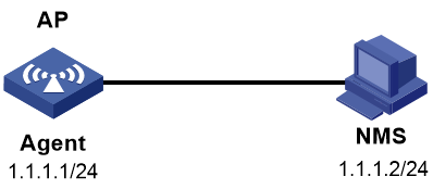

Figure1-1 Relationship between NMS, agent, and MIB

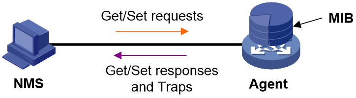

Figure1-2 MIB tree

SNMP configuration examples
Example: Configuring SNMPv1/SNMPv2c
The configuration procedure is the same for SNMPv1 and SNMPv2c. The following example configures SNMPv1.
As shown in Figure1-3, configure SNMPv1 on the NMS (1.1.1.2/24) and agent (1.1.1.1/24) so that the NMS can monitor and manage the agent and the agent automatically sends notifications to report events to the NMS.
Figure1-3 Network diagram
IMPORTANT
IMPORTANT:
For the NMS to monitor, configure, and receive notifications from the agent, make sure the agent and the NMS have the same settings.
1.     Configure the agent:
# Assign IP address 1.1.1.1/24 to the agent and make sure the agent and the NMS are reachable to each other. (Details not shown.)
# Specify SNMPv1, and create read-only community public and read and write community private.
<Agent> system-view
[Agent] snmp-agent sys-info version v1
[Agent] snmp-agent community read public
[Agent] snmp-agent community write private
# Configure contact and physical location information for the agent.
[Agent] snmp-agent sys-info contact Mr.Wang-Tel:3306
[Agent] snmp-agent sys-info location telephone-closet,3rd-floor
# Enable the agent to use SNMPv1 community name public to send SNMP notifications to the NMS at 1.1.1.2.
[Agent] snmp-agent trap enable
[Agent] snmp-agent target-host trap address udp-domain 1.1.1.2 params securityname public v1
2.     Configure the NMS:
¡     Specify SNMPv1.
¡     Create read-only community public and read and write community private.
¡     Set the timeout timer and maximum number of retries as needed.
For information about configuring the NMS, see the NMS manual.

Example: Configuring SNMPv3
As shown in Figure1-4, perform the following tasks:
·     Configure SNMPv3 on the NMS (1.1.1.2/24) and the agent (1.1.1.1/24) so that the NMS can monitor and manage the agent and the agent automatically sends notifications to report events to the NMS.
·     Configure SNMP authentication and encryption on the NMS and agent. Set the authentication algorithm to SHA-1 and the authentication key to 123456TESTauth&!, the encryption algorithm to AES algorithm and the encryption key to 123456TESTencr&!.
Figure1-4 Network diagram
