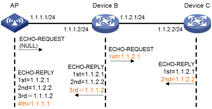

You can use the ping –r command to display the routers through which ICMP echo requests have passed. The test procedure of ping –r is as shown in Figure1-1:
1.     The source device (Device A) sends an ICMP echo request to the destination device (Device C) with the RR option empty.
2.     The intermediate device (Device B) adds the IP address of its outbound interface (1.1.2.1) to the RR option of the ICMP echo request, and forwards the packet.
3.     Upon receiving the request, the destination device copies the RR option in the request and adds the IP address of its outbound interface (1.1.2.2) to the RR option. Then the destination device sends an ICMP echo reply.
4.     The intermediate device adds the IP address of its outbound interface (1.1.1.2) to the RR option in the ICMP echo reply, and then forwards the reply.
5.     Upon receiving the reply, the source device adds the IP address of its inbound interface (1.1.1.1) to the RR option. The detailed information of routes from Device A to Device C is formatted as: 1.1.1.1 <-> {1.1.1.2; 1.1.2.1} <-> 1.1.2.2.
Figure1-1 Ping operation

As shown in Figure1-2, determine if the AP and Device C can reach each other. If they can reach each other, get detailed information about routes from the AP to Device C.
Figure1-2 Network diagram

The test procedure of ping –r is as shown in Figure1-2:
1.     The source device (the AP) sends an ICMP echo request to the destination device (Device C) with the RR option blank.
5.     Upon receiving the reply, the source device adds the IP address of its inbound interface (1.1.1.1) to the RR option. The detailed information of routes from the AP to Device C is formatted as: 1.1.1.1 <-> {1.1.1.2; 1.1.2.1} <-> 1.1.2.2.
