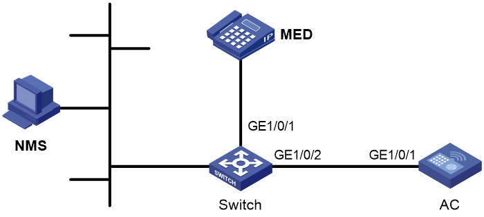

LLDP exchanges packets between neighbor agents and creates and maintains neighbor information for them. Figure1-1 shows the neighbor relationships for these LLDP agents.
Figure1-1 LLDP neighbor relationships

Example: Configuring basic LLDP functions
As shown in Figure1-5, enable LLDP globally on the switch and the AC to perform the following tasks:
·     Monitor the link between the switch and the MED on the NMS.
·     Monitor the link between the switch and the AC on the NMS.
Figure1-5 Network diagram
1.     Configure the switch:
# Enable LLDP globally.
<Switch> system-view
[Switch] lldp global enable
# Enable LLDP on GigabitEthernet 1/0/1. By default, LLDP is enabled on all ports.
[Switch] interface gigabitethernet 1/0/1
[Switch-GigabitEthernet1/0/1] lldp enable
# Set the LLDP operating mode to Rx on GigabitEthernet 1/0/1.
[Switch-GigabitEthernet1/0/1] lldp admin-status rx
[Switch-GigabitEthernet1/0/1] quit
# Enable LLDP on GigabitEthernet 1/0/2. By default, LLDP is enabled on all ports.
[Switch] interface gigabitethernet 1/0/2
[Switch-GigabitEthernet1/0/2] lldp enable
# Set the LLDP operating mode to Rx on GigabitEthernet 1/0/2.
[Switch-GigabitEthernet1/0/2] lldp admin-status rx
[Switch-GigabitEthernet1/0/2] quit
2.     Configure the AC:
<AC> system-view
[AC] lldp global enable
[AC] interface gigabitethernet 1/0/1
[AC-GigabitEthernet1/0/1] lldp enable
# Set the LLDP operating mode to Tx on GigabitEthernet 1/0/1.
[AC-GigabitEthernet1/0/1] lldp admin-status tx
[AC-GigabitEthernet1/0/1] quit
# Verify the following items on the switch:
·     GigabitEthernet 1/0/1 connects to a MED device.
·     GigabitEthernet 1/0/2 connects to a non-MED device.
·     Both ports operate in Rx mode, and they can receive LLDP frames but cannot send LLDP frames.
