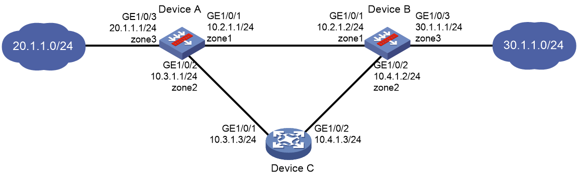

Collaboration application example
The following is an example of collaboration between NQA, Track, and static routing.
Configure a static route with next hop 192.168.0.88 on the device. If the next hop is reachable, the static route is valid. If the next hop becomes unreachable, the static route is invalid. For this purpose, configure NQA-Track-static routing collaboration as follows:
1.     Create an NQA operation to monitor the accessibility of IP address 192.168.0.88.
2.     Create a track entry and associate it with the NQA operation.
¡     When next hop 192.168.0.88 is reachable, NQA sends the result to the Track module. The Track module sets the track entry to Positive state.
¡     When the next hop becomes unreachable, NQA sends the result to the Track module. The Track module sets the track entry to Negative state.
3.     Associate the track entry with the static route.
¡     When the track entry is in Positive state, the static routing module considers the static route to be valid.
¡     When the track entry is in Negative state, the static routing module considers the static route to be invalid.

Example: Configuring static routing-Track-NQA collaboration
As shown in Figure 2:
·     Device A is the default gateway of the hosts in network 20.1.1.0/24.
·     Device D is the default gateway of the hosts in network 30.1.1.0/24.
·     Hosts in the two networks communicate with each other through static routes.
To ensure network availability, configure route backup and static routing-Track-NQA collaboration on Device A and Device D as follows:
·     On Device A, assign a higher priority to the static route to 30.1.1.0/24 with next hop Device B. This route is the master route. The static route to 30.1.1.0/24 with next hop Device C acts as the backup route. When the master route is unavailable, the backup route takes effect.
·     On Device D, assign a higher priority to the static route to 20.1.1.0/24 with next hop Device B. This route is the master route. The static route to 20.1.1.0/24 with next hop Device C acts as the backup route. When the master route is unavailable, the backup route takes effect.
Figure 2 Network diagram

Example: Configuring static routing-Track-BFD collaboration
As shown in Figure 3:
·     Device B is the default gateway of the hosts in network 30.1.1.0/24.
To ensure network availability, configure route backup and static routing-Track-BFD collaboration on Device A and Device B as follows:
·     On Device A, assign a higher priority to the static route to 30.1.1.0/24 with next hop Device B. This route is the master route. The static route to 30.1.1.0/24 with next hop Device C acts as the backup route. When the master route is unavailable, BFD can quickly detect the route failure to make the backup route take effect.
·     On Device B, assign a higher priority to the static route to 20.1.1.0/24 with next hop Device A. This route is the master route. The static route to 20.1.1.0/24 with next hop Device C acts as the backup route. When the master route is unavailable, BFD can quickly detect the route failure to make the backup route take effect.
Figure 3 Network diagram
Configuring Device A

# Configure a rule named bfdlocalout to allow Device A to send BFD echo packets to Device D.
[DeviceA-security-policy-ip] rule name bfdlocalout
[DeviceA-security-policy-ip-3-bfdlocalout] source-zone local
[DeviceA-security-policy-ip-3-bfdlocalout] destination-zone untrust
[DeviceA-security-policy-ip-2-bfdlocalout] service bfd-echo
[DeviceA-security-policy-ip-3-bfdlocalout] action pass
[DeviceA-security-policy-ip-3-bfdlocalout] quit

5.     Specify 10.10.10.10 as the source address for BFD echo packets.
[DeviceA] bfd echo-source-ip 10.10.10.10
6.     Configure track entry 1, and associate it with the BFD session to verify the connectivity between Device A and Device B.
[DeviceA] track 1 bfd echo interface gigabitethernet 1/0/1 remote ip 10.2.1.2 local ip 10.2.1.1
[DeviceA-track-1] quit

# Display information about the track entry on Device A.
[DeviceA] display track all
Track ID: 1
  State: Positive
  Duration: 0 days 0 hours 0 minutes 32 seconds
  Tracked object type: BFD
  Notification delay: Positive 0, Negative 0 (in seconds)
  Tracked object:
    BFD session mode: Echo
    Outgoing interface: GigabitEthernet1/0/1
    VPN instance name: --
    Remote IP: 10.2.1.2
    Local IP: 10.2.1.1
The output shows that the status of the track entry is Positive, indicating that next hop 10.2.1.2 is reachable.
# Display the routing table of Device A.
[DeviceA] display ip routing-table
Destinations : 9        Routes : 9
10.2.1.0/24         Direct 0    0            10.2.1.1        GE1/0/1
10.2.1.1/32         Direct 0    0            127.0.0.1       InLoop0
10.3.1.0/24         Direct 0    0            10.3.1.1        GE1/0/2
10.3.1.1/32         Direct 0    0            127.0.0.1       InLoop0
20.1.1.0/24         Direct 0    0            20.1.1.1        GE1/0/3
20.1.1.1/32         Direct 0    0            127.0.0.1       InLoop0
30.1.1.0/24         Static 60   0            10.2.1.2        GE1/0/1
127.0.0.0/8         Direct 0    0            127.0.0.1       InLoop0
127.0.0.1/32        Direct 0    0            127.0.0.1       InLoop0
The output shows that Device A forwards packets to 30.1.1.0/24 through Device B. The master static route has taken effect.
# Remove the IP address of GigabitEthernet 1/0/1 on Device B.
<DeviceB> system-view
[DeviceB-GigabitEthernet1/0/1] undo ip address
Track ID: 1
  State: Negative
  Tracked object:
    Remote IP: 10.2.1.2
    Local IP: 10.2.1.1
The output shows that the status of the track entry is Negative, indicating that next hop 10.2.1.2 is unreachable.
30.1.1.0/24         Static 80   0            10.3.1.3        GE1/0/2
The output shows that Device A forwards packets to 30.1.1.0/24 through Device C. The backup static route has taken effect.
# Verify that the hosts in 20.1.1.0/24 can communicate with the hosts in 30.1.1.0/24 when the master route fails.
[DeviceA] ping -a 20.1.1.1 30.1.1.1
Ping 30.1.1.1: 56  data bytes, press CTRL_C to break
Reply from 30.1.1.1: bytes=56 Sequence=1 ttl=254 time=2 ms
Reply from 30.1.1.1: bytes=56 Sequence=2 ttl=254 time=1 ms
Reply from 30.1.1.1: bytes=56 Sequence=3 ttl=254 time=1 ms
Reply from 30.1.1.1: bytes=56 Sequence=4 ttl=254 time=2 ms
Reply from 30.1.1.1: bytes=56 Sequence=5 ttl=254 time=1 ms
--- Ping statistics for 30.1.1.1 ---
5 packet(s) transmitted, 5 packet(s) received, 0.00% packet loss
round-trip min/avg/max/std-dev = 1/1/2/1 ms
# Verify that the hosts in 30.1.1.0/24 can communicate with the hosts in 20.1.1.0/24 when the master route fails.
[DeviceB] ping -a 30.1.1.1 20.1.1.1
Ping 20.1.1.1: 56  data bytes, press CTRL_C to break
Reply from 20.1.1.1: bytes=56 Sequence=1 ttl=254 time=2 ms
Reply from 20.1.1.1: bytes=56 Sequence=2 ttl=254 time=1 ms
Reply from 20.1.1.1: bytes=56 Sequence=3 ttl=254 time=1 ms
Reply from 20.1.1.1: bytes=56 Sequence=4 ttl=254 time=1 ms
Reply from 20.1.1.1: bytes=56 Sequence=5 ttl=254 time=1 ms
--- Ping statistics for 20.1.1.1 ---
