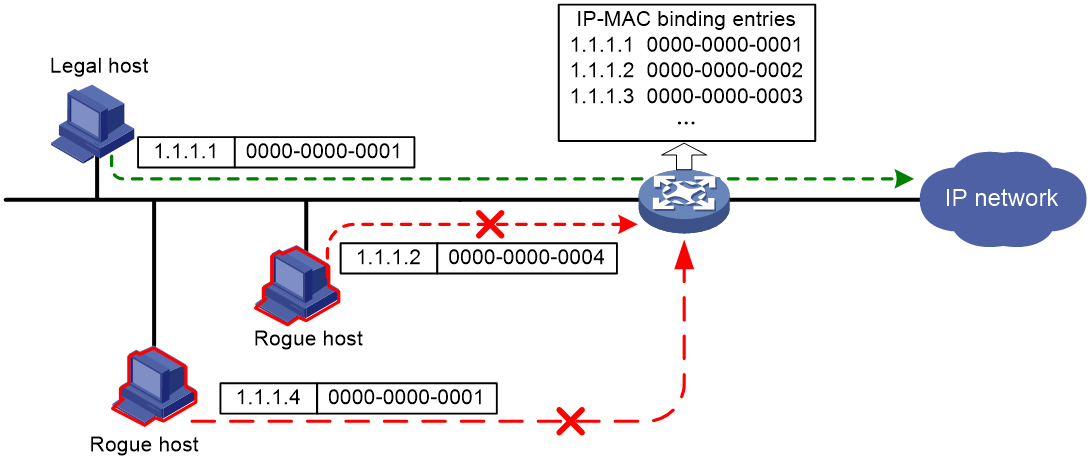

Operating mechanism
The IP-MAC binding table contains binding entries that bind IP addresses and MAC addresses. The device uses the binding entries to match an incoming packet.
As shown in Figure 1, all hosts communicate with the IP network through the device. When the device receives a packet, it compares the source IP address and source MAC address in the packet with the IP-MAC binding entries. Table 1 describes the way the device processes the packet based on the match result.
Figure 1 IP-MAC binding application scenario
Table 1 Processing of a packet based on the match result
Match result
Processing of the packet
The packet source IP address and source MAC address match the same IP-MAC binding entry.
Permits the packet.
Only the source IP address or source MAC address matches a binding entry.
Drops the packet.
The source IP address and source MAC address match two different binding entries.
Drops the packet.
Both the source IP address and the source MAC address of a packet match no IP-MAC binding entry.
Processes the packet based on the default action.

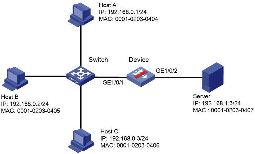

As shown in Figure 2, Host A, Host B, and the server are statically assigned IPv4 addresses. Host A and Host B communicate with the server through the gateway (the device).
Create the following IPv4-MAC binding entries on the device to permit packets only from Host A, Host B, and the server:
·     Bind IPv4 address 192.168.0.1 to MAC address 0001-0203-0404 for Host A.
·     Bind IPv4 address 192.168.0.2 to MAC address 0001-0203-0405 for Host B.
·     Bind IPv4 address 192.168.1.3 to MAC address 0001-0203-0407 for the server.
Figure 2 Network diagram

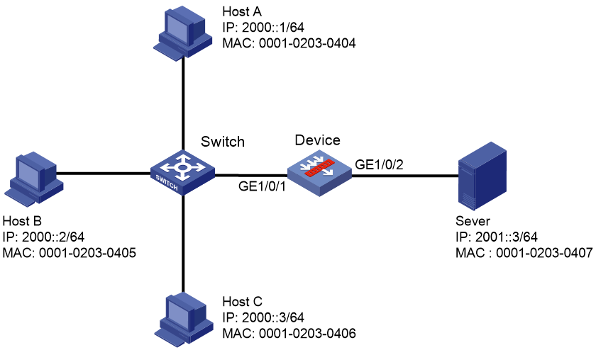

As shown in Figure 3, Host A, Host B, and the server are statically assigned IPv6 addresses. Host A and Host B communicate with the server through the gateway (the device).
Create the following IPv6-MAC binding entries on the device to permit packets only from Host A, Host B, and the server:
·     Bind IPv6 address 2000::1/64 to MAC address 0001-0203-0404 for Host A.
·     Bind IPv6 address 2000::2/64 to MAC address 0001-0203-0405 for Host B.
·     Bind IPv6 address 2001::3/64 to MAC address 0001-0203-0407 for the server.
Figure 3 Network diagram

# Create IPv6-MAC binding entries to permit packets only from Host A, Host B, and the server.
[Device] ip-mac binding ipv6 2000::1 mac-address 0001-0203-0404
[Device] ip-mac binding ipv6 2000::2 mac-address 0001-0203-0405
[Device] ip-mac binding ipv6 2001::3 mac-address 0001-0203-0407
# Set the default action to deny for packets that do not match any IP-MAC binding entries.
[Device] ip-mac binding no-match action deny
# Display IPv6-MAC binding entries.
<Device> display ip-mac binding ipv6
Total entries: 1
IP address      MAC address         VPN instance         VLAN ID
2000::1         0001-0203-0404      public               N/A
2000::2         0001-0203-0405      public               N/A
2001::3         0001-0203-0407      public               N/A
# Ping the server from Host C.
C:\> ping 2001::3
Pinging 2001::3 with 32 bytes of data:
Request timed out.
Request timed out.
Request timed out.
Request timed out.
Ping statistics for 2001::3:
   Packets: Sent = 4, Received = 0, Lost = 4 (100% loss),
The ping requests timed out, which indicates that the requests are blocked by the device.
