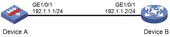

As shown in Figure 1, establish an OSPF neighbor relationship between Device A and Device B, and use a keychain to authenticate packets between the devices. Configure key 1 and key 2 for the keychain and make sure key 2 is used immediately when key 1 expires.
Figure 1 Network diagram
1.     Assign IP addresses to interfaces and configure routes, security zones, zone pairs, and interzone policies. Make sure the network connections are available. (Details not shown.)
