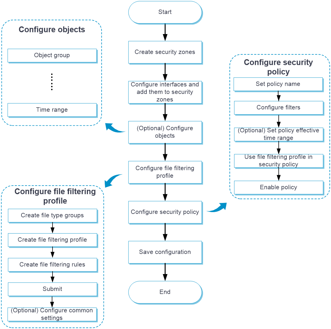

Configure file filtering as shown in Figure 1.
Figure 1 File filtering configuration procedure
Configure a file type group
Perform this task to create a file type group and configure file extensions in the group.
1.     Click the Objects tab.
2.     In the navigation pane, select APPSecurity > Data Filtering > File Type Groups.
3.     Click Create.
4.     Create a file type group.
Table 1 File type group configuration items
Item
Description
Name
Enter a name for the file type group.
Description
Enter a description for the file type group.
Predefined file extensions
Select the predefined file extensions for the file type group.
Custom file extensions
Enter the custom file extensions, one per line.
5.     Click OK.
The file type group is displayed on the File Type Groups page.
Configure a file filtering profile
Perform this task to create a file filtering profile and configure file filtering rules in the profile.
2.     In the navigation pane, select APPSecurity > File Filtering > Profiles.
3.     Click Create.
4.     Create a file filtering profile.
Table 2 File filtering profile configuration items
Items
Description
Name
Enter a name for the file filtering profile.
Description
Enter a description for the file filtering profile.
5.     In the File filtering rules area, click Create.
6.     Create a file filtering rule.
Table 3 File filtering rule configuration items
Items
Description
Name
Applications
Select the application layer protocols of the applications to which the rule applies.
Supported application layer protocols are FTP, HTTP, IMAP, NFS, POP3, RTMP, SMB, and SMTP.
File type groups
Select the file type group for the file filtering rule. A file matches a file type group if it matches a file extension in the group.
Direction
Select the file transfer direction to which the rule applies.
Options are Upload, Download, and Both.
Action
Select the action for matching packets.
Options are Permit and Drop.
Logging
Select whether to enable logging for matching packets.
Options are Enable and Disable.
7.     Click OK.
The file filtering rule is displayed on the file filtering rule list of the file filtering profile.
8.     Click OK.
The file filtering profile is displayed on the File Filtering Profiles page.
9.     Use the file filtering profile in a security policy. For more information about security policies, see security policy online help.
10.     Click Submit to activate the configuration immediately or wait 40 seconds for the configuration to be activated automatically.
After you create a file filtering profile, the configuration must be activated to take effect. By default, the configuration will be activated automatically 40 seconds later.
