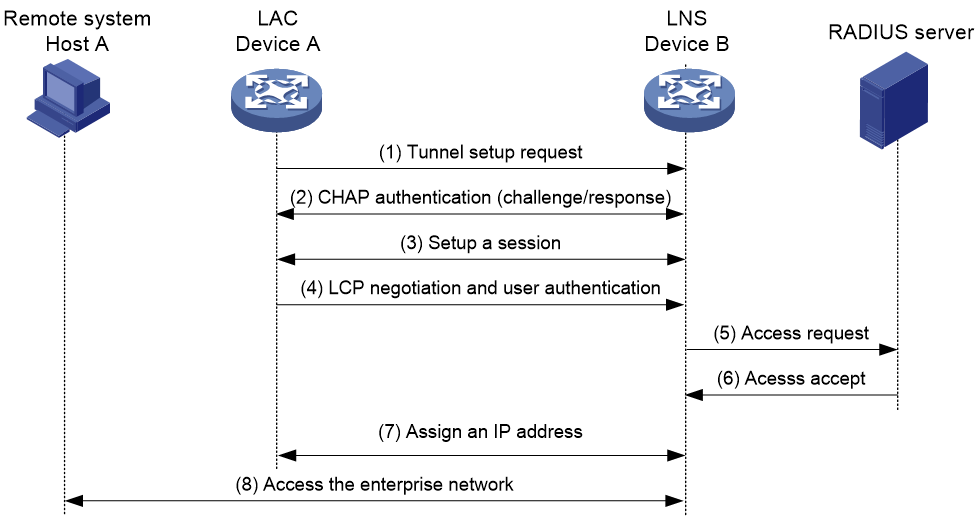

Typical L2TP networking
Figure 1 L2TP network diagram
As shown in Figure 1, a typical L2TP network has the following components:
·     Remote system—A remote system is usually a remote user's host or a remote branch's device that needs to access the private network.
·     LAC—An L2TP access concentrator (LAC) is both PPP and L2TP capable. It is usually a network access server (NAS) located at a local ISP, which provides access services mainly for PPP users.
An LAC is an endpoint of an L2TP tunnel and lies between an LNS and a remote system. It encapsulates packets received from a remote system by using L2TP and then sends the encapsulated packets to the LNS. It decapsulates packets received from the LNS and then sends the decapsulated packets to the intended remote system.
·     LNS—An L2TP network server (LNS) is both PPP and L2TP capable. It is usually an edge device on an enterprise network.
An LNS is the other endpoint of an L2TP tunnel. It is the logical termination point of a PPP session tunneled by the LAC. L2TP extends the termination point of a PPP session from a NAS to an LNS by establishing a tunnel.

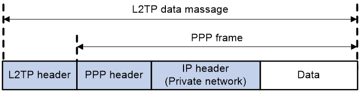

L2TP message types and encapsulation structure
L2TP uses the following types of messages:
·     Control messages—Used to establish, maintain, and delete L2TP tunnels and sessions. Control messages are transmitted over a reliable control channel, which supports flow control and congestion control.
·     Data messages—Used to encapsulate PPP frames, as shown in Figure 2. Data messages are transmitted over an unreliable data channel and are not retransmitted when packet loss occurs. Data messages can use sequence numbers to reorder packets that are disordered during transport.
Figure 2 Data message format
As shown in Figure 3, both control messages and data messages are encapsulated in UDP datagrams.
Figure 3 L2TP encapsulation structure

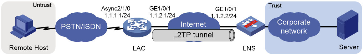

NAS-initiated tunneling mode
As shown in Figure 4, a remote system dials in to the LAC through a PPPoE/ISDN network. The LAC initiates a tunneling request to the LNS over the Internet.
Figure 4 NAS-initiated tunneling mode
A NAS-initiated tunnel has the following characteristics:
·     The remote system only needs to support PPP, and it does not need to support L2TP.
·     Authentication and accounting of the remote system can be implemented on the LAC or LNS.
Figure 5 NAS-initiated tunnel establishment process
As shown in Figure 5, the following workflow is used to establish a NAS-initiated tunnel:
1.     A remote system (Host A) initiates a PPP connection to the LAC (Device A).
2.     The remote system and LAC perform PPP LCP negotiation.
3.     The LAC authenticates PPP user information of Host A by using PAP or CHAP.
4.     The LAC sends the authentication information (username and password) to its RADIUS server (RADIUS server A) for authentication.
5.     RADIUS server A authenticates the user and returns the result.
6.     The LAC initiates an L2TP tunneling request to the LNS (Device B) when the following conditions exist:
¡     The user passes the authentication.
¡     The user is determined to be an L2TP user according to the username or the ISP domain to which the user belongs.
7.     If tunnel authentication is needed, the LAC and LNS send CHAP challenge messages to authenticate each other before successfully establishing an L2TP tunnel.
8.     The LAC and LNS negotiate to establish L2TP sessions.
9.     The LAC sends PPP user information and PPP negotiation parameters to the LNS.
10.     The LNS sends the authentication information to its RADIUS server (RADIUS server B) for authentication.
11.     RADIUS server B authenticates the user and returns the result.
12.     If the user passes the authentication, the LNS assigns a private IP address to the remote system (Host A).
13.     The PPP user can access internal resources of the enterprise.
In steps 12 and 13, the LAC forwards packets for the remote system and LNS. Host A and LAC exchange PPP frames, and the LAC and LNS exchange L2TP packets.

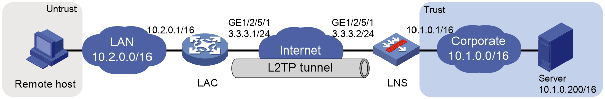

Client-initiated tunneling mode
As shown in Figure 6, a remote system running L2TP (LAC client) has a public IP address to communicate with the LNS through the Internet. The LAC client can directly initiate a tunneling request to the LNS without any dedicated LAC devices.
Figure 6 Client-initiated tunneling mode
A client-initiated tunnel has the following characteristics:
·     A client-initiated tunnel has higher security because it is established between a remote system and the LNS.
·     The remote system must support L2TP and be able to communicate with the LNS. This causes poor expandability.
As shown in Figure 7, the workflow for establishing a client-initiated tunnel is similar to that for establishing a NAS-initiated tunnel. (Details not shown.)
Figure 7 Client-initiated tunnel establishment process

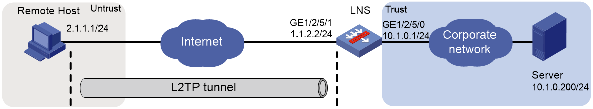

LAC-auto-initiated tunneling mode
In NAS-initiated mode, a remote system must successfully dial in to the LAC through PPPoE or ISDN.
In LAC-auto-initiated mode, you can use the l2tp-auto-client command on the LAC to trigger the LAC to initiate a tunneling request to the LNS. When a remote system accesses the private network, the LAC forwards data through the L2TP tunnel.
Figure 8 LAC-auto-initiated tunneling mode
An LAC-auto-initiated tunnel has the following characteristics:
·     The connection between a remote system and the LAC is not confined to a dial-up connection and can be any IP-based connection.
·     An L2TP session is established immediately after an L2TP tunnel is established. Then, the LAC and LNS, acting as the PPPoE client and PPPoE server, respectively, perform PPP negotiation.
·     The LNS assigns a private IP address to the LAC instead of to the remote system.
As shown in Figure 9, the workflow for establishing an LAC-auto-initiated tunnel is similar to that for establishing a NAS-initiated tunnel. (Details not shown.)
Figure 9 Establishment process for LAC-auto-initiated tunnels

Configuration example for client-initiated L2TP tunnel
Network requirements
As shown in Figure 12, a PPP user directly initiates a tunneling request to the LNS to access the corporate network.
Figure 12 Network diagram
Configuration guidelines
You must add the Virtual-Template interface on the LNS to a security zone, and permit the traffic from security zone Untrust to security zone Trust and the traffic from security zone Untrust to security zone Local.
Configuration procedure
