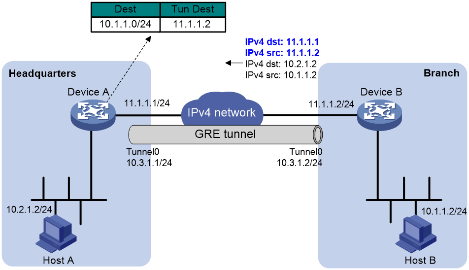

As shown in Figure 2, an IPv6 protocol packet traverses an IPv4 network through a GRE tunnel as follows:
1.     After receiving an IPv6 packet from the interface connected to IPv6 network 1, Device A processes the packet as follows:
a.     Looks up the routing table to identify the outgoing interface for the IPv6 packet.
b.     Submits the IPv6 packet to the outgoing interface—the GRE tunnel interface Tunnel 0.
2.     Upon receiving the packet, the tunnel interface encapsulates the packet with GRE and then with IPv4. In the IPv4 header:
¡     The source address is the tunnel's source address (the IP address of Interface A of Device A).
¡     The destination address is the tunnel's destination address (the IP address of Interface B of Device B).
3.     Device A looks up the routing table according to the destination address in the IPv4 header, and forwards the IPv4 packet out of the physical interface (Interface A) of the GRE tunnel.
4.     When the IPv4 arrives at the GRE tunnel destination Device B, Device B checks the destination address. Because the destination is Device B itself and the protocol number in the IP header is 47 (the protocol number for GRE), Device B submits the packet to GRE for de-encapsulation.
5.     GRE first removes the IPv4 header, and then checks the GRE key, checksum, and packet sequence number. After GRE finishes the checking, it removes the GRE header, and submits the payload to the IPv6 protocol for forwarding.
Figure 2 IPv6 networks interconnected through a GRE tunnel

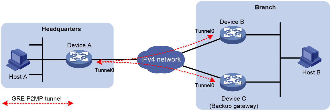

Enlarging network scope
In an IP network, the maximum TTL value of a packet is 255. If two devices have more than 255 hops in between, they cannot communicate with each other. By using a GRE tunnel, you can hide some hops to enlarge the network scope. As shown in Figure 4, only the tunnel-end devices (Device A and Device D) of the GRE tunnel are counted in hop count calculation. Therefore, there are only three hops between Host A and Host B.
Figure 4 Network diagram

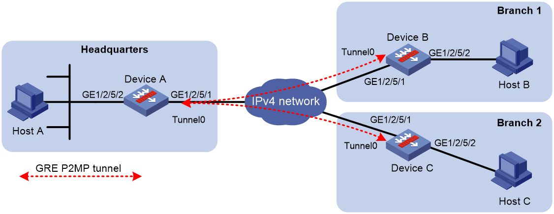

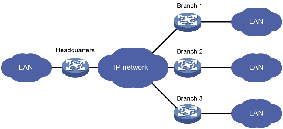

Constructing VPN
As shown in Figure 5, Site 1 and Site 2 both belong to VPN 1 and are located in different cities. Using a GRE tunnel can connect the two VPN sites across the WAN.
Figure 5 Network diagram

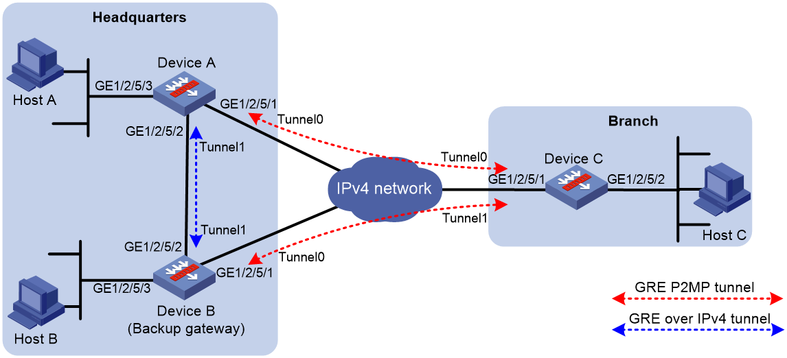

As shown in Figure 6, GRE can be used together with IPsec to form a GRE over IPsec tunnel. Packets (for example, routing protocol packets, voice data, and video data) are first encapsulated with GRE and then with IPsec. GRE over IPsec delivers the following benefits:
·     Improves transmission security.
·     Allows IPsec to protect not only unicast packets. GRE supports encapsulating multicast, broadcast, and non-IP packets. After GRE encapsulation, these packets become common unicast packets, which can be protected by IPsec.
·     Simplifies IPsec configuration. Packets are first encapsulated by GRE. You can define the packets to be protected by IPsec according to the GRE tunnel's source and destination addresses, without considering the source and destination addresses of the original packets.
Figure 6 Network diagram
GRE and IPsec can also form IPsec over GRE tunnels. As a best practice, use GRE over IPsec tunnels instead of IPsec over GRE tunnels.
For more information about IPsec, see VPN Configuration Guide.

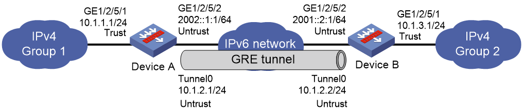

GRE configuration examples

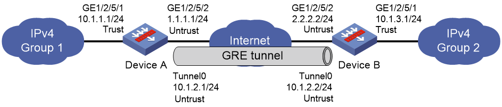

Example: Configuring an IPv4 over IPv4 GRE tunnel
As shown in Figure 7, Group 1 and Group 2 are two private IPv4 networks. The two networks both use private network addresses and belong to the same VPN. Establish a GRE tunnel between Device A and Device B to interconnect the two private IPv4 networks Group 1 and Group 2.
Figure 7 Network diagram
1.     Assign IP addresses to interfaces and configure routes, security zones, zone pairs, and interzone policies. Make sure the network connections are available. (Details not shown.)
2.     Configure Device A:
# Create tunnel interface Tunnel 0, and specify the tunnel mode as GRE/IPv4.
<DeviceA> system-view
[DeviceA] interface tunnel 0 mode gre
# Configure an IP address for the tunnel interface.
[DeviceA-Tunnel0] ip address 10.1.2.1 255.255.255.0
# Configure the source address of the tunnel interface as the IP address of GigabitEthernet 1/2/5/2 on Device A.
[DeviceA-Tunnel0] source 1.1.1.1
# Configure the destination address of the tunnel interface as the IP address of GigabitEthernet 1/2/5/2 on Device B.
[DeviceA-Tunnel0] destination 2.2.2.2
[DeviceA-Tunnel0] quit
# Configure a static route from Device A through the tunnel interface to Group 2.
[DeviceA] ip route-static 10.1.3.0 255.255.255.0 tunnel 0

Example: Configuring an IPv4 over IPv6 GRE tunnel
As shown in Figure 8, two IPv4 subnets Group 1 and Group 2 are connected to an IPv6 network. Create a GRE/IPv6 tunnel between Device A and Device B, so the two IPv4 subnets can communicate with each other through the GRE tunnel over the IPv6 network.
Figure 8 Network diagram

As shown in Figure 10, an enterprise has multiple branches. For the headquarters to communicate with the branches through tunnels, you can deploy GRE P2MP.
Configure a GRE P2MP tunnel interface on the gateway of the headquarters. Configure GRE/IPv4 or GRE/IPv6 tunnel interfaces (also called point-to-point GRE tunnel interfaces) on the gateways of the branch networks. Use the GRE P2MP tunnel interface on the headquarters gateway to set up a point-to-multipoint tunnel with the point-to-point GRE tunnel interfaces on the branch gateways.
Figure 10 GRE P2MP tunnel application

As shown in Figure 11, Device A dynamically learns GRE P2MP tunnel entry information (tunnel destination address and packet destination address) from the GRE packets received from the branch. The tunnel destination address is the source IP address in the transport protocol header of the received GRE packet. The packet destination address (destination branch network address) is the source IP address in passenger protocol header of the received GRE packet.
Figure 11 Dynamically learning a GRE P2MP tunnel entry

GRE tunnel backup in branches
As shown in Figure 12, deploy redundant gateways in the branch network. Configure a GRE P2MP tunnel interface on the gateway of the headquarters. Use the GRE P2MP tunnel interface to set up a dynamic P2MP tunnel with each branch gateway.
Assign different GRE keys to the tunnel interfaces on the branch gateways. The headquarters gateway selects a dynamic tunnel entry for the branch in the following order:
1.     The dynamic tunnel entry that does not have a GRE key.
2.     The dynamic tunnel entry that has a GRE key with a lower value.
3.     The latest learned dynamic tunnel entry.
Figure 12 GRE tunnel backup in a branch
GRE tunnel backup in the headquarters
As shown in Figure 13, deploy redundant gateways in the headquarters, one primary and one backup. Configure a GRE P2MP tunnel interface and a GRE/IPv4 or GRE/IPv6 tunnel interface on each gateway. Specify the GRE/IPv4 or GRE/IPv6 tunnel interface on the primary gateway as the backup interface of its GRE P2MP tunnel interface.
When the primary gateway cannot reach the branch network, it sends the traffic destined for the branch network to the backup gateway through the backup interface. Then, the backup gateway sends the traffic to the destination.
The backup interface is also included for tunnel selection on the primary gateway. If the backup interface does not have a GRE key, its priority is lower than all GRE P2MP dynamic tunnel entries. If the backup interface has a GRE key, the headquarters gateway compares the GRE key with the GRE keys of GRE P2MP dynamic tunnel entries. The lower the value, the higher the priority.
Figure 13 Tunnel backup in the headquarters

GRE P2MP tunnel configuration examples
Example: Configuring a GRE P2MP tunnel
As shown in Figure 14, Device A is the gateway of the headquarters, and Device B and Device C are the gateways of the branches.
Configure the devices to meet the following requirements:
·     Device A can dynamically set up a GRE P2MP tunnel with multiple branch gateways.
·     Device B and Device C each can set up a GRE tunnel with Device A.
·     Branch 1 and Branch 2 cannot communicate.
Figure 14 Network diagram
Table 1 IP address assignment
Device
Interface
IP address
Security zone
Device A
GE1/2/5/1
11.1.1.1/24
Untrust
GE1/2/5/2
192.168.11.1/24
Trust
Tunnel 0
192.168.22.1/24
Untrust
Device B
GE1/2/5/1
11.1.1.2/24
Untrust
GE1/2/5/2
192.168.12.1/24
Trust
Tunnel 0
192.168.22.2/24
Untrust
Device C
GE1/2/5/1
11.1.1.3/24
Untrust
GE1/2/5/2
192.168.13.1/24
Trust
Tunnel 0
192.168.22.3/24
Untrust
This example uses Device B to describe the gateway configuration for a branch. The gateway configuration for other branches is the same as the gateway configuration on Device B.
# Create tunnel interface Tunnel 0 and specify the tunnel mode as GRE P2MP.
[DeviceA] interface tunnel 0 mode gre-p2mp
# Specify an IP address for the tunnel interface.
[DeviceA-Tunnel0] ip address 192.168.22.1 255.255.255.0
# Specify the source IP address of the tunnel interface. The IP address is the IP address of GigabitEthernet 1/2/5/1 on Device A.
[DeviceA-Tunnel0] source 11.1.1.1
# Specify the branch network mask as 255.255.255.0 for GRE P2MP tunnel entries on tunnel interface Tunnel 0.
[DeviceA-Tunnel0] gre p2mp branch-network-mask 255.255.255.0
# Set the GRE P2MP tunnel entry aging timer to 20 seconds.
[DeviceA-Tunnel0] gre p2mp aging-time 20
# Configure a static route from Device A through Tunnel 0 to the branch.
[DeviceA] ip route-static 192.168.12.0 255.255.255.0 tunnel 0
# Add tunnel interface Tunnel 0 to security zone Untrust.
[DeviceA] security-zone name Untrust
[DeviceA-security-zone-Untrust] import interface Tunnel 0
[DeviceA-security-zone-Untrust] quit
# Allow bidirectional traffic communication between security zones Untrust and Local.
[DeviceA] security-policy ip
[DeviceA-security-policy-ip] rule name tunnel
[DeviceA-security-policy-ip-13-tunnel] source-zone untrust
[DeviceA-security-policy-ip-13-tunnel] source-zone local
[DeviceA-security-policy-ip-13-tunnel] destination-zone local
[DeviceA-security-policy-ip-13-tunnel] destination-zone untrust
[DeviceA-security-policy-ip-13-tunnel] action pass
[DeviceA-security-policy-ip-13-tunnel] quit
[DeviceA-security-policy-ip] quit
3.     Configure Device B:
# Create tunnel interface Tunnel 0 and specify the tunnel mode as GRE/IPv4.
<DeviceB> system-view
[DeviceB] interface tunnel 0 mode gre
[DeviceB-Tunnel0] ip address 192.168.22.2 255.255.255.0
# Specify the source IP address of the tunnel interface. The source IP address is the IP address of GigabitEthernet 1/2/5/1 on Device B.
[DeviceB-Tunnel0] source 11.1.1.2
# Specify the destination address of the tunnel interface. The destination address is the IP address of GigabitEthernet 1/2/5/1 on Device A.
[DeviceB-Tunnel0] destination 11.1.1.1
[DeviceB-Tunnel0] quit
# Configure a static route from Device B through Tunnel 0 to the headquarters.
[DeviceB] ip route-static 192.168.11.0 255.255.255.0 tunnel 0
[DeviceB] security-zone name Untrust
[DeviceB-security-zone-Untrust] import interface Tunnel 0
[DeviceB-security-zone-Untrust] quit
[DeviceB] security-policy ip
[DeviceB-security-policy-ip] rule name tunnel
[DeviceB-security-policy-ip-13-tunnel] source-zone untrust
[DeviceB-security-policy-ip-13-tunnel] source-zone local
[DeviceB-security-policy-ip-13-tunnel] destination-zone local
[DeviceB-security-policy-ip-13-tunnel] destination-zone untrust
[DeviceB-security-policy-ip-13-tunnel] action pass
[DeviceB-security-policy-ip-13-tunnel] quit
[DeviceB-security-policy-ip] quit
# Display GRE P2MP tunnel entries on Device A. The output shows that Device A does not have GRE P2MP tunnel entries.
[DeviceA] display gre p2mp tunnel-table interface tunnel 0
Total number:0
Dest Addr               Mask/Prefix Len Tunnel Dest Addr        Gre Key   Aging
# Ping Host A from Host B. The ping operation succeeds. (Details not shown.)
# Display GRE P2MP tunnel entries again on Device A. The output shows that Device A has created a GRE P2MP tunnel entry destined for the branch.
Total number:1
192.168.12.0            255.255.255.0   11.1.1.2                          5
Example: Configuring GRE P2MP headquarters-side tunnel backup
As shown in Figure 15, Device A is the gateway of the headquarters, Device B is the backup gateway of the headquarters, and Device C is the gateway of the branch.
Configure the devices as follows:
·     Configure a GRE P2MP tunnel interface on Device A and Device B, respectively. Device A and Device B use the interfaces to establish GRE P2MP tunnels with Device C.
·     Configure a GRE/IPv4 tunnel interface on Device A and Device B, respectively. Configure the GRE/IPv4 tunnel interface on Device A as the backup interface of the GRE P2MP tunnel interface. To avoid loops, do not configure the GRE/IPv4 tunnel interface on Device B as the backup interface of the GRE P2MP tunnel interface.
·     Configure GRE/IPv4 tunnel interfaces on Device C for the device to establish tunnels with Device A and Device B.
Figure 15 Network diagram
Table 2 IP address assignment
Device
Interface
IP address
Security zone
Device A
GE1/2/5/1
11.1.1.1/24
Untrust
GE1/2/5/2
10.1.1.1/24
Trust
GE1/2/5/3
192.168.11.1/24
Trust
Tunnel 0
172.168.1.1/24
Untrust
Tunnel 1
192.168.22.1/24
Trust
Device B
GE1/2/5/1
11.1.1.2/24
Untrust
GE1/2/5/2
10.1.1.2/24
Trust
GE1/2/5/3
192.168.11.2/24
Trust
Tunnel 0
172.168.2.2/24
Untrust
Tunnel 1
192.168.22.2/24
Trust
Device C
GE1/2/5/1
11.1.1.3/24
Untrust
GE1/2/5/2
192.168.12.1/24
Trust
Tunnel 0
172.168.1.3/24
Untrust
Tunnel 1
172.168.2.3/24
Untrust
You need to disconnect the link between Device A and Device C to verify the tunnel backup feature. To make sure Device C can detect the link loss and switch the traffic forwarding path to the link connecting Device B, perform one of the following tasks:
·     If Device C and Device A are directly connected, configure static routes on Device C.
·     If Device C and Device A are not directly connected, use one of the following methods:
¡     Configure a dynamic routing protocol on Device A, Device B, and Device C.
¡     Configure static routes on Device C and associate the routes with track entries for detecting the route reachability status. For more information about track entries, see High Availability Configuration Guide.
This example uses the static routes method.
# Create tunnel interface Tunnel 1 and specify the tunnel mode as GRE/IPv4.
[DeviceA] interface tunnel 1 mode gre

Example: Configuring GRE P2MP branch-side tunnel backup
As shown in Figure 16, Device A is the gateway of the headquarters, Device B is the gateway of the branch, and Device C is the backup gateway of the branch.
·     Configure a GRE P2MP tunnel interface on Device A. Device A uses the interface to establish a GRE P2MP tunnel with Device B and Device C.
·     Configure a GRE/IPv4 tunnel interface on Device B and Device C, respectively. The devices use the tunnel interfaces to establish tunnels with Device A.
·     Assign different GRE keys to the GRE/IPv4 tunnel interfaces on Device B and Device C. Device A selects the tunnel that has a GRE key with a higher priority to forward traffic. In this example, the tunnel destined for Device B has a higher priority.
Figure 16 Network diagram
Table 3 IP address assignment
Device
Interface
IP address
Security zone
Device A
GE1/2/5/1
11.1.1.1/24
Untrust
GE1/2/5/2
172.17.17.1/24
Trust
Tunnel 0
192.168.22.1/24
Untrust
Device B
GE1/2/5/1
11.1.1.2/24
Untrust
GE1/2/5/2
192.168.1.2/24
Trust
Tunnel 0
192.168.22.2/24
Untrust
Device C
GE1/2/5/1
11.1.1.3/24
Untrust
GE1/2/5/2
192.168.1.3/24
Trust
Tunnel 0
192.168.22.3/24
Untrust
[DeviceA] ip route-static 192.168.1.0 255.255.255.0 tunnel 0
# Set the GRE key to 1 for the tunnel interface.
[DeviceB-Tunnel0] gre key 1
[DeviceB] ip route-static 172.17.17.0 255.255.255.0 tunnel 0
4.     Configure Device C:
<DeviceC> system-view
[DeviceC] interface tunnel 0 mode gre
[DeviceC-Tunnel0] ip address 192.168.22.3 255.255.255.0
# Specify the source IP address of the tunnel interface. The source IP address is the IP address of GigabitEthernet 1/2/5/1 on Device C.
[DeviceC-Tunnel0] source 11.1.1.3
[DeviceC-Tunnel0] destination 11.1.1.1
# Set the GRE key to 2 for the tunnel interface.
[DeviceC-Tunnel0] gre key 2
[DeviceC-Tunnel0] quit
# Configure a static route from Device C through Tunnel 0 to the headquarters.
[DeviceC] ip route-static 172.17.17.0 255.255.255.0 tunnel 0
[DeviceC] security-zone name Untrust
[DeviceC-security-zone-Untrust] import interface Tunnel 0
[DeviceC-security-zone-Untrust] quit
[DeviceC] security-policy ip
[DeviceC-security-policy-ip] rule name tunnel
[DeviceC-security-policy-ip-13-tunnel] source-zone untrust
[DeviceC-security-policy-ip-13-tunnel] source-zone local
[DeviceC-security-policy-ip-13-tunnel] destination-zone local
[DeviceC-security-policy-ip-13-tunnel] destination-zone untrust
[DeviceC-security-policy-ip-13-tunnel] action pass
[DeviceC-security-policy-ip-13-tunnel] quit
[DeviceC-security-policy-ip] quit
# Configure Device C as the default gateway of Host B, and then ping Host A from Host B. The ping operation succeeds. (Details not shown.)
Total number:1
192.168.1.0           255.255.255.0   11.1.1.3                2         20
# Configure the default gateway of Host B as Device B, and then ping Host A from Host B. The ping operation succeeds. (Details not shown).
Total number:2
192.168.1.0           255.255.255.0   11.1.1.2                1         20
The output shows that Device A has two GRE P2MP tunnel entries destined for the branch. The device prefers the tunnel entry with a lower GRE key value. The entry destined for Device B is preferred.
# Shut down tunnel interface Tunnel 0 on Device B.
[DeviceB-Tunnel0] shutdown
# Change the default gateway of Host B to Device C. (Details not shown.)
# Ping Host A from Host B after the GRE P2MP tunnel entry destined for Device B ages. The ping operation succeeds. (Details not shown.)
Total number:1
192.168.1.0           255.255.255.0   11.1.1.3                2         10
The output shows that Device A can forward traffic to hosts in the branch only through Device C.
