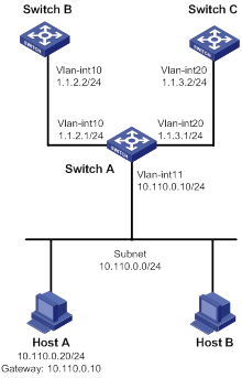

Packet type-based local PBR configuration example
Network requirements
As shown in Figure 1, Switch B and Switch C cannot reach each other.
Configure PBR on Switch A to forward all TCP packets to the next hop 1.1.2.2 (Switch B).
Figure 1 Network diagram
Configuration procedure
1.      Configure Switch A:
# Create VLAN 10 and VLAN 20.
<SwitchA> system-view
[SwitchA] vlan 10
[SwitchA-vlan10] quit
[SwitchA] vlan 20
[SwitchA-vlan20] quit
# Configure the IP addresses of VLAN-interface 10 and VLAN-interface 20.
[SwitchA-Vlan-interface10] ip address 1.1.2.1 24
[SwitchA-Vlan-interface10] quit
[SwitchA] interface vlan-interface 20
[SwitchA-Vlan-interface20] ip address 1.1.3.1 24
[SwitchA-Vlan-interface20] quit
# Configure ACL 3101 to match TCP packets.
[SwitchA] acl advanced 3101
[SwitchA-acl-ipv4-adv-3101] rule permit tcp

Packet type-based interface PBR configuration example
As shown in Figure 2, Switch B and Switch C cannot reach each other.
Configure PBR on Switch A to forward all TCP packets received on VLAN-interface 11 to the next hop 1.1.2.2 (Switch B).
Figure 2 Network diagram
1.      Make sure Switch B and Switch C can reach Host A. (Details not shown.)
2.      Configure Switch A:
[SwitchA] vlan 10
[SwitchA] vlan 20
[SwitchA-acl-ipv4-adv-3101] quit
# Configure Node 5 for the policy aaa to forward TCP packets to next hop 1.1.2.2.
[SwitchA] policy-based-route aaa permit node 5
[SwitchA-pbr-aaa-5] if-match acl 3101
[SwitchA-pbr-aaa-5] apply next-hop 1.1.2.2
[SwitchA-pbr-aaa-5] quit
# Configure interface PBR by applying the policy aaa to VLAN-interface 11.
[SwitchA] interface vlan-interface 11
[SwitchA-Vlan-interface11] ip address 10.110.0.10 24
[SwitchA-Vlan-interface11] ip policy-based-route aaa
[SwitchA-Vlan-interface11] quit
# On Host A, Telnet to Switch B that is directly connected to Switch A. The operation succeeds. (Details not shown.)
# On Host A, Telnet to Switch C that is directly connected to Switch A. The operation fails. (Details not shown.)
# Ping Switch C from Host A. The operation succeeds. (Details not shown.)
Telnet uses TCP, and ping uses ICMP. The results show the following:
·           All TCP packets arriving on VLAN-interface 11 of Switch A are forwarded to next hop 1.1.2.2.
·           Other packets are forwarded through VLAN-interface 20.
·           The interface PBR configuration is effective.

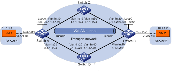

VXLAN ID-based outbound PBR configuration example
As shown in Figure 3, Switch C and Switch D are Layer 3 switches in the transport network. VXLAN 10 is configured on Switch A and Switch B (as VTEPs) to provide Layer 2 connectivity for VM 1 and VM 2 across the network sites.
·           A VXLAN tunnel between the VTEPs is manually established.
·           The tunnel is assigned to the VXLAN.
·           Remote MAC address learning is enabled.
·           The VTEPs flood VXLAN traffic in unicast mode (head-end replication).
Traffic from VM 1 to VM 2 enters the VXLAN tunnel through one of the equal-cost routes (with the next hop 2.1.1.2) between the VXLAN endpoints.
Configure PBR for Tunnel 1 on Switch A to forward the outgoing traffic through the route with the next hop 1.1.1.2.
Figure 3 Network diagram
1.      Configure IP addresses and unicast routing settings:
# Assign IP address to interfaces, as shown in Figure 3. (Details not shown.)
# Configure OSPF on all switches in the transport network. (Details not shown.)
# Enable L2VPN.
[SwitchA] l2vpn enable
# Create the VSI vpna and VXLAN 10.
[SwitchA] vsi vpna
[SwitchA-vsi-vpna] vxlan 10
[SwitchA-vsi-vpna-vxlan-10] quit
[SwitchA-vsi-vpna] quit
# Assign an IP address to Loopback 0. The IP address will be used as the source IP address of the VXLAN tunnel.
[SwitchA] interface loopback 0
[SwitchA-Loopback0] ip address 6.6.6.6 255.255.255.255
[SwitchA-Loopback0] quit
# Create a VXLAN tunnel to Switch B. The tunnel interface is Tunnel 1. The tunnel destination is Loopback 0 at 8.8.8.8 on Switch B.
[SwitchA] interface tunnel 1 mode vxlan
[SwitchA-Tunnel1] source 6.6.6.6
[SwitchA-Tunnel1] destination 8.8.8.8
[SwitchA-Tunnel1] quit
# Assign Tunnel 1 to VXLAN 10.
[SwitchA] vsi vpna
[SwitchA-vsi-vpna-vxlan-10] tunnel 1
# Create Ethernet service instance 1000 on Ten-GigabitEthernet 1/0/1 to match frames from VLAN 10.
[SwitchA] interface ten-gigabitethernet 1/0/1
[SwitchA-Ten-GigabitEthernet1/0/1] service-instance 1000
[SwitchA-Ten-GigabitEthernet1/0/1-srv1000] encapsulation s-vid 10
# Map Ethernet service instance 1000 to the VSI vpna.
[SwitchA-Ten-GigabitEthernet1/0/1-srv1000] xconnect vsi vpna
[SwitchA-Ten-GigabitEthernet1/0/1-srv1000] quit
[SwitchA-Ten-GigabitEthernet1/0/1] quit
# Configure node 5 for the policy aaa, and configure a VXLAN match criterion for the policy to forward packets with the VXLAN ID 10 to 1.1.1.2.
[SwitchA-pbr-aaa-5] if-match vxlan 10
[SwitchA-pbr-aaa-5] apply next-hop 1.1.1.2
# Apply the policy to Tunnel 1 to guide the forwarding of outgoing packets.
[SwitchA-Tunnel1] ip policy-based-route aaa egress
