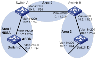

NSSA area and totally NSSA area
An NSSA area does not import AS external LSAs (Type-5 LSAs) but can import Type-7 LSAs generated by the NSSA ASBR. The NSSA ABR translates Type-7 LSAs into Type-5 LSAs and advertises the Type-5 LSAs to other areas.
As shown in Figure 4, the OSPF AS contains Area 1, Area 2, and Area 0. The other two ASs run RIP. Area 1 is an NSSA area where the ASBR redistributes RIP routes in Type-7 LSAs into Area 1. Upon receiving the Type-7 LSAs, the NSSA ABR translates them to Type-5 LSAs, and advertises the Type-5 LSAs to Area 0.
The ASBR of Area 2 redistributes RIP routes in Type-5 LSAs into the OSPF routing domain. However, Area 1 does not receive Type-5 LSAs because it is an NSSA area.
Figure 4 NSSA area

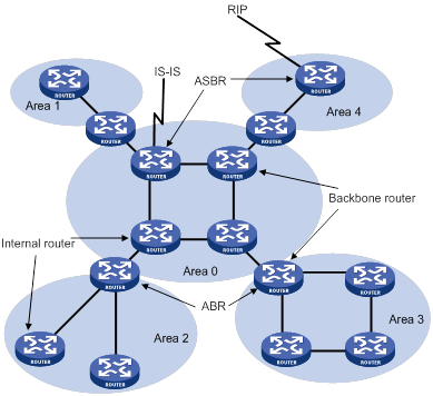

Router types
OSPF routers are classified into the following types based on their positions in the AS:
·           Internal router—All interfaces on an internal router belong to one OSPF area.
·           ABR—Belongs to more than two areas, one of which must be the backbone area. ABR connects the backbone area to a non-backbone area. An ABR and the backbone area can be connected through a physical or logical link.
·           Backbone router—No less than one interface of a backbone router must reside in the backbone area. All ABRs and internal routers in Area 0 are backbone routers.
·           ASBR—Exchanges routing information with another AS is an ASBR. An ASBR might not reside on the border of the AS. It can be an internal router or an ABR.
Figure 5 OSPF router types

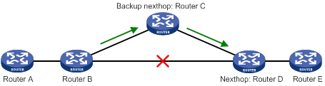

Configuring OSPF FRR
A link or router failure on a path can cause packet loss and even routing loop until OSPF completes routing convergence based on the new network topology. FRR enables fast rerouting to minimize the impact of link or node failures.
Figure 7 Network diagram for OSPF FRR
As shown in Figure 7, configure FRR on Router B by using a routing policy to specify a backup next hop. When the primary link fails, OSPF directs packets to the backup next hop. At the same time, OSPF calculates the shortest path based on the new network topology. It forwards packets over the path after network convergence.
You can configure OSPF FRR to calculate a backup next hop by using the loop free alternate (LFA) algorithm, or specify a backup next hop by using a routing policy.

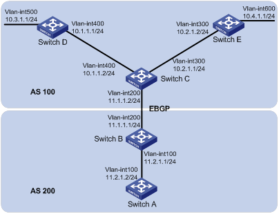

OSPF route summarization configuration example
Network requirements
As shown in Figure 10:
·           Configure OSPF on Switch A and Switch B in AS 200.
·           Configure OSPF on Switch C, Switch D, and Switch E in AS 100.
·           Configure an EBGP connection between Switch B and Switch C. Configure Switch B and Switch C to redistribute OSPF routes and direct routes into BGP and BGP routes into OSPF.
·           Configure Switch B to advertise only summary route 10.0.0.0/8 to Switch A.
Figure 10 Network diagram
Configuration procedure
1.      Configure IP addresses for interfaces. (Details not shown.)
2.      Enable OSPF:
# Configure Switch A.
<SwitchA> system-view
[SwitchA] router id 11.2.1.2
[SwitchA] ospf
[SwitchA-ospf-1] area 0
[SwitchA-ospf-1-area-0.0.0.0] network 11.2.1.0 0.0.0.255
[SwitchA-ospf-1-area-0.0.0.0] quit
[SwitchA-ospf-1] quit
# Configure Switch B.
<SwitchB> system-view
[SwitchB] router id 11.2.1.1
[SwitchB] ospf
[SwitchB-ospf-1] area 0
[SwitchB-ospf-1-area-0.0.0.0] network 11.2.1.0 0.0.0.255
[SwitchB-ospf-1-area-0.0.0.0] quit
[SwitchB-ospf-1] quit
# Configure Switch C.
<SwitchC> system-view
[SwitchC] router id 11.1.1.2
[SwitchC] ospf
[SwitchC-ospf-1] area 0
[SwitchC-ospf-1-area-0.0.0.0] network 10.1.1.0 0.0.0.255
[SwitchC-ospf-1-area-0.0.0.0] network 10.2.1.0 0.0.0.255
[SwitchC-ospf-1-area-0.0.0.0] quit
[SwitchC-ospf-1] quit
# Configure Switch D.
<SwitchD> system-view
[SwitchD] router id 10.3.1.1
[SwitchD] ospf
[SwitchD-ospf-1] area 0
[SwitchD-ospf-1-area-0.0.0.0] network 10.1.1.0 0.0.0.255
[SwitchD-ospf-1-area-0.0.0.0] network 10.3.1.0 0.0.0.255
[SwitchD-ospf-1-area-0.0.0.0] quit
[SwitchD-ospf-1] quit
# Configure Switch E.
<SwitchE> system-view
[SwitchE] router id 10.4.1.1
[SwitchE] ospf
[SwitchE-ospf-1] area 0
[SwitchE-ospf-1-area-0.0.0.0] network 10.2.1.0 0.0.0.255
[SwitchE-ospf-1-area-0.0.0.0] network 10.4.1.0 0.0.0.255
[SwitchE-ospf-1-area-0.0.0.0] quit
[SwitchE-ospf-1] quit
3.      Configure BGP to redistribute OSPF routes and direct routes:
[SwitchB] bgp 200
[SwitchB-bgp-default] peer 11.1.1.2 as 100
[SwitchB-bgp-default] address-family ipv4 unicast
[SwitchB-bgp-default-ipv4] peer 11.1.1.2 enable
[SwitchB-bgp-default-ipv4] import-route ospf
[SwitchB-bgp-default-ipv4] import-route direct
[SwitchB-bgp-default-ipv4] quit
[SwitchB-bgp-default] quit
[SwitchC] bgp 100
[SwitchC-bgp-default] peer 11.1.1.1 as 200
[SwitchC-bgp-default] address-family ipv4 unicast
[SwitchC-bgp-default-ipv4] peer 11.1.1.1 enable
[SwitchC-bgp-default-ipv4] import-route ospf
[SwitchC-bgp-default-ipv4]import-route direct
[SwitchC-bgp-default-ipv4] quit
[SwitchC-bgp-default] quit
4.      Configure Switch B and Switch C to redistribute BGP routes into OSPF:
# Configure OSPF to redistribute routes from BGP on Switch B.
[SwitchB] ospf
[SwitchB-ospf-1] import-route bgp
# Configure OSPF to redistribute routes from BGP on Switch C.
[SwitchC] ospf
[SwitchC-ospf-1] import-route bgp
# Display the OSPF routing table on Switch A.
[SwitchA] display ip routing-table
         Destinations : 16        Routes : 16
0.0.0.0/32          Direct 0    0            127.0.0.1       InLoop0
10.1.1.0/24         O_ASE2 150  1            11.2.1.1        Vlan100
10.2.1.0/24         O_ASE2 150  1            11.2.1.1        Vlan100
10.3.1.0/24         O_ASE2 150  1            11.2.1.1        Vlan100
10.4.1.0/24         O_ASE2 150  1            11.2.1.1        Vlan100
11.2.1.0/24         Direct 0    0            11.2.1.2        Vlan100
11.2.1.0/32         Direct 0    0            11.2.1.2        Vlan100
11.2.1.2/32         Direct 0    0            127.0.0.1       InLoop0
11.2.1.255/32       Direct 0    0            11.2.1.2        Vlan100
127.0.0.0/8         Direct 0    0            127.0.0.1       InLoop0
127.0.0.0/32        Direct 0    0            127.0.0.1       InLoop0
127.0.0.1/32        Direct 0    0            127.0.0.1       InLoop0
127.255.255.255/32  Direct 0    0            127.0.0.1       InLoop0
224.0.0.0/4         Direct 0    0            0.0.0.0         NULL0

OSPF NSSA area configuration example
As shown in Figure 12:
·           Configure OSPF on all switches and split AS into three areas.
·           Configure Switch A and Switch B as ABRs to forward routing information between areas.
·           Configure Area 1 as an NSSA area and configure Switch C as an ASBR to redistribute static routes into the AS.
Figure 12 Network diagram
2.      Enable OSPF (see "
3.      Basic OSPF configuration example").
4.      Configure Area 1 as an NSSA area:
[SwitchA] ospf
[SwitchA-ospf-1] area 1
[SwitchA-ospf-1-area-0.0.0.1] nssa
[SwitchA-ospf-1-area-0.0.0.1] quit
[SwitchC] ospf
[SwitchC-ospf-1] area 1
[SwitchC-ospf-1-area-0.0.0.1] nssa
[SwitchC-ospf-1-area-0.0.0.1] quit
# Display OSPF routing information on Switch C.
[SwitchC] display ospf routing
          OSPF Process 1 with Router ID 10.4.1.1
                   Routing Table
 Routing for network
 Destination        Cost     Type    NextHop         AdvRouter       Area
 10.2.1.0/24        3        Transit 10.2.1.2        10.4.1.1        0.0.0.1
 10.3.1.0/24        7        Inter   10.2.1.1        10.2.1.1        0.0.0.1
 10.4.1.0/24        3        Stub    10.4.1.1        10.4.1.1        0.0.0.1
 10.5.1.0/24        17       Inter   10.2.1.1        10.2.1.1        0.0.0.1
 10.1.1.0/24        5        Inter   10.2.1.1        10.2.1.1        0.0.0.1
 Total nets: 5
 Intra area: 2  Inter area: 3  ASE: 0  NSSA: 0
5.      Configure route redistribution:
# Configure Switch C to redistribute static routes.
[SwitchC] ip route-static 3.1.3.1 24 10.4.1.2
[SwitchC] ospf
[SwitchC-ospf-1] import-route static
# Display OSPF routing information on Switch D.
<SwitchD> display ospf routing
          OSPF Process 1 with Router ID 10.5.1.1
                   Routing Table
 Routing for network
 10.2.1.0/24        22       Inter   10.3.1.1        10.3.1.1        0.0.0.2
 10.3.1.0/24        10       Transit 10.3.1.2        10.3.1.1        0.0.0.2
 10.4.1.0/24        25       Inter   10.3.1.1        10.3.1.1        0.0.0.2
 10.5.1.0/24        10       Stub    10.5.1.1        10.5.1.1        0.0.0.2
 10.1.1.0/24        12       Inter   10.3.1.1        10.3.1.1        0.0.0.2
 Routing for ASEs
 Destination        Cost     Type    Tag         NextHop         AdvRouter
 3.1.3.0/24         1        Type2   1           10.3.1.1        10.2.1.1
 Total nets: 6
 Intra area: 2  Inter area: 3  ASE: 1  NSSA: 0
The output shows that an external route imported from the NSSA area exists on Switch D.

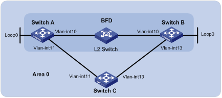

BFD for OSPF configuration example
As shown in Figure 17, run OSPF on Switch A, Switch B, and Switch C so that they are reachable to each other at the network layer.
·           When the link over which Switch A and Switch B communicate through a Layer 2 switch fails, BFD can quickly detect the failure and notify OSPF of the failure.
·           Switch A and Switch B then communicate through Switch C.
Figure 17 Network diagram
Device
Interface
IP address
Switch A
Vlan-int10
192.168.0.102/24
Switch A
Vlan-int11
10.1.1.102/24
Switch A
Loop0
121.1.1.1/32
Switch B
Vlan-int10
192.168.0.100/24
Switch B
Vlan-int13
13.1.1.1/24
Switch B
Loop0
120.1.1.1/32
Switch C
Vlan-int11
10.1.1.100/24
Switch C
Vlan-int13
13.1.1.2/24
2.      Enable OSPF:
[SwitchA] ospf
[SwitchA-ospf-1-area-0.0.0.0] network 192.168.0.0 0.0.0.255
[SwitchA-ospf-1-area-0.0.0.0] network 10.1.1.0 0.0.0.255
[SwitchA-ospf-1-area-0.0.0.0] network 121.1.1.1 0.0.0.0
[SwitchB] ospf
[SwitchB-ospf-1-area-0.0.0.0] network 192.168.0.0 0.0.0.255
[SwitchB-ospf-1-area-0.0.0.0] network 13.1.1.0 0.0.0.255
[SwitchB-ospf-1-area-0.0.0.0] network 120.1.1.1 0.0.0.0
[SwitchC] ospf
[SwitchC-ospf-1-area-0.0.0.0] network 13.1.1.0 0.0.0.255
3.      Configure BFD:
# Enable BFD on Switch A and configure BFD parameters.
[SwitchA] bfd session init-mode active
[SwitchA-Vlan-interface10] ospf bfd enable
[SwitchA-Vlan-interface10] bfd min-transmit-interval 500
[SwitchA-Vlan-interface10] bfd min-receive-interval 500
[SwitchA-Vlan-interface10] bfd detect-multiplier 7
[SwitchA-Vlan-interface10] quit
# Enable BFD on Switch B and configure BFD parameters.
[SwitchB] bfd session init-mode active
[SwitchB] interface vlan-interface 10
[SwitchB-Vlan-interface10] ospf bfd enable
[SwitchB-Vlan-interface10] bfd min-transmit-interval 500
[SwitchB-Vlan-interface10] bfd min-receive-interval 500
[SwitchB-Vlan-interface10] bfd detect-multiplier 6
[SwitchB-Vlan-interface10] quit
# Display the BFD information on Switch A.
<SwitchA> display bfd session
 Total Session Num: 1     Up Session Num: 1     Init Mode: Active
 IPv4 session working in control packet mode:
 LD/RD          SourceAddr      DestAddr        State    Holdtime    Interface
 3/1            192.168.0.102   192.168.0.100   Up       1700ms      Vlan10
# Display routes destined for 120.1.1.1/32 on Switch A.
<SwitchA> display ip routing-table 120.1.1.1 verbose
Summary Count : 1
Destination: 120.1.1.1/32
   Protocol: O_INTRA
 Process ID: 1
  SubProtID: 0x1                     Age: 04h20m37s
       Cost: 1                Preference: 10
      IpPre: N/A              QosLocalID: N/A
        Tag: 0                     State: Active Adv
  OrigTblID: 0x0                 OrigVrf: default-vrf
    TableID: 0x2                  OrigAs: 0
      NibID: 0x26000002           LastAs: 0
     AttrID: 0xffffffff         Neighbor: 0.0.0.0
      Flags: 0x1008c         OrigNextHop: 192.168.0.100
      Label: NULL            RealNextHop: 192.168.0.100
    BkLabel: NULL              BkNextHop: N/A
  Tunnel ID: Invalid           Interface: Vlan-interface10
BkTunnel ID: Invalid        BkInterface: N/A
   FtnIndex: 0x0           TrafficIndex: N/A
  Connector: N/A                 PathID: 0x0
The output shows that Switch A communicates with Switch B through VLAN-interface 10. Then the link over VLAN-interface 10 fails.
Summary Count : 1
   Protocol: O_INTRA
 Process ID: 1
       Cost: 2                Preference: 10
      Flags: 0x1008c         OrigNextHop: 10.1.1.100
      Label: NULL            RealNextHop: 10.1.1.100
  Tunnel ID: Invalid           Interface: Vlan-interface11
The output shows that Switch A communicates with Switch B through VLAN-interface 11.
OSPF FRR configuration example
As shown in Figure 18, Switch A, Switch B, and Switch C reside in the same OSPF domain. Configure OSPF FRR so that when the link between Switch A and Switch B fails, traffic is immediately switched to Link B.
Figure 18 Network diagram
Device
Interface
IP address
Switch A
Vlan-int100
12.12.12.1/24
Switch A
Vlan-int200
13.13.13.1/24
Switch A
Loop0
1.1.1.1/32
Switch B
Vlan-int101
24.24.24.4/24
Switch B
Vlan-int200
13.13.13.2/24
Switch B
Loop0
4.4.4.4/32
Switch C
Vlan-int100
12.12.12.2/24
Switch C
Vlan-int101
24.24.24.2/24
1.      Configure IP addresses and subnet masks for interfaces on the switches. (Details not shown.)
2.      Configure OSPF on the switches to ensure that Switch A, Switch B, and Switch C can communicate with each other at the network layer. (Details not shown.)
3.      Configure OSPF FRR to automatically calculate the backup next hop:
You can enable OSPF FRR to either calculate a backup next hop by using the LFA algorithm, or specify a backup next hop by using a routing policy.
¡  (Method 1.) Enable OSPF FRR to calculate the backup next hop by using the LFA algorithm:
[SwitchA] ospf 1
[SwitchA-ospf-1] fast-reroute lfa
[SwitchB] ospf 1
[SwitchB-ospf-1] fast-reroute lfa
¡  (Method 2.) Enable OSPF FRR to designate a backup next hop by using a routing policy.
[SwitchA] ip prefix-list abc index 10 permit 4.4.4.4 32
[SwitchA] route-policy frr permit node 10
[SwitchA-route-policy-frr-10] if-match ip address prefix-list abc
[SwitchA-route-policy-frr-10] apply fast-reroute backup-interface vlan-interface 100 backup-nexthop 12.12.12.2
[SwitchA-route-policy-frr-10] quit
[SwitchA] ospf 1
[SwitchA-ospf-1] fast-reroute route-policy frr
[SwitchB] ip prefix-list abc index 10 permit 1.1.1.1 32
[SwitchB] route-policy frr permit node 10
[SwitchB-route-policy-frr-10] if-match ip address prefix-list abc
[SwitchB-route-policy-frr-10] apply fast-reroute backup-interface vlan-interface 101 backup-nexthop 24.24.24.2
[SwitchB-route-policy-frr-10] quit
[SwitchB] ospf 1
[SwitchB-ospf-1] fast-reroute route-policy frr
# Display route 4.4.4.4/32 on Switch A to view the backup next hop information.
[SwitchA] display ip routing-table 4.4.4.4 verbose
Summary Count : 1
Destination: 4.4.4.4/32
   Protocol: O_INTRA
 Process ID: 1
      Flags: 0x1008c        OrigNextHop: 13.13.13.2
      Label: NULL           RealNextHop: 13.13.13.2
    BkLabel: NULL             BkNextHop: 12.12.12.2
  Tunnel ID: Invalid          Interface: Vlan-interface200
BkTunnel ID: Invalid        BkInterface: Vlan-interface100
# Display route 1.1.1.1/32 on Switch B to view the backup next hop information.
[SwitchB] display ip routing-table 1.1.1.1 verbose
Summary Count : 1
Destination: 1.1.1.1/32
   Protocol: O_INTRA
 Process ID: 1
      Flags: 0x1008c        OrigNextHop: 13.13.13.1
      Label: NULL           RealNextHop: 13.13.13.1
    BkLabel: NULL             BkNextHop: 24.24.24.2
BkTunnel ID: Invalid        BkInterface: Vlan-interface101
