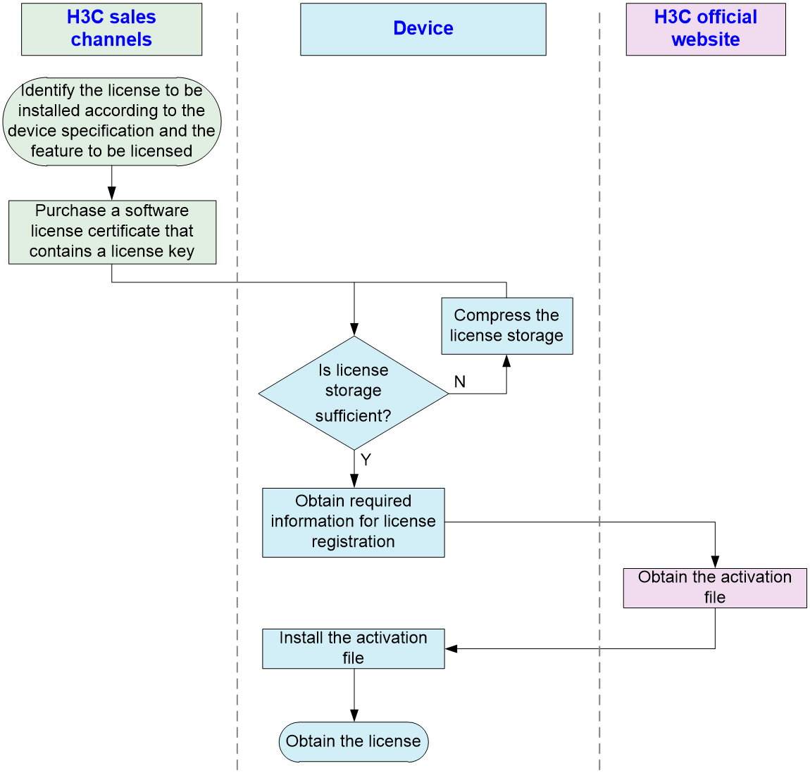

License registration and installation workflow
Figure 2 shows the procedure for registering and installing a license.
This chapter only describes the operations performed on the device and H3C license management platform. For more information, see the licensing guide for the device.
Figure 2 License registration and installation workflow

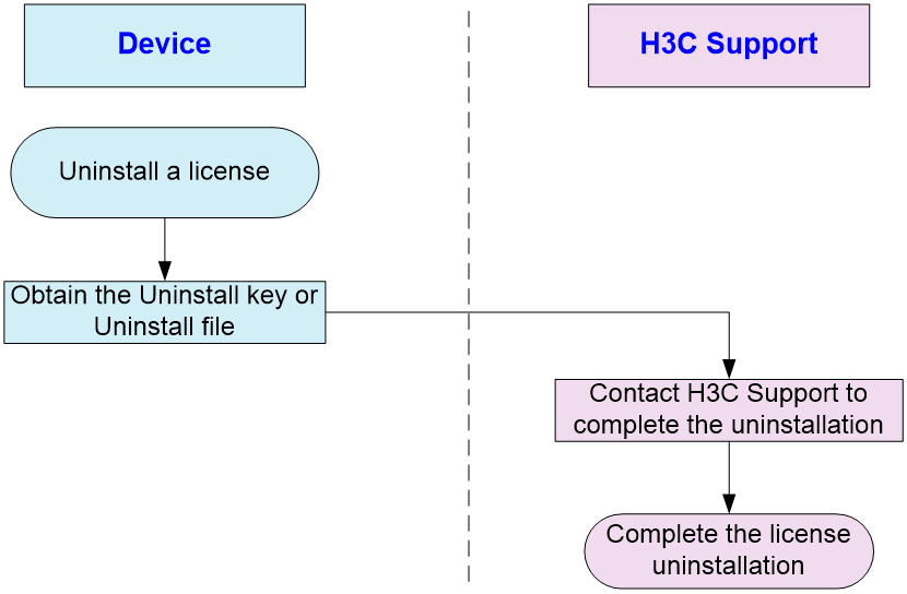

license activation-file uninstall license-file slot slot-number
You can uninstall a single .ak file or multiple .ak files through one operation. To uninstall multiple .ak files, save all activation files in the same directory and specify the directory as the value of the license-file argument.
Uninstalling a license
About license uninstallation
A license key is bound to a device once you activate the license key on the H3C license management platform. You cannot bind this license key to another device. To unbind a license key for a license that has not expired from a device, obtain the Uninstall key or Uninstall file for the license on the device. Then, contact H3C Support to complete the license uninstallation.
To restore the license on the local device or transfer the license to another device, you must contact H3C Support to obtain a new activation file for the license. Then, install the new activation file on the target device.
License uninstallation workflow
For information about obtaining the Uninstall file, see "Obtaining an Uninstall file." For more information about license uninstallation, contact H3C Support.
Figure 4 License uninstallation workflow
