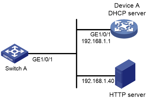

Typical server-based automatic configuration network
As shown in Figure 1, a typical server-based automatic configuration network consists of the following servers:
·     DHCP server.
·     File server (TFTP or HTTP server).
·     (Optional.) DNS server.
Figure 1 Server-based automatic configuration network diagram

Example: Using an HTTP server and Tcl scripts for automatic configuration
As shown in Figure 3, Switch A does not have a configuration file.
Configure the servers so Switch A can obtain a Tcl script to complete the following configuration tasks:
·     Enable the administrator to Telnet to Switch A to manage Switch A.
·     Require the administrator to enter the correct username and password at login.
Figure 3 Network diagram

Example: Using an HTTP server and Python scripts for automatic configuration
As shown in Figure 4, Switch A does not have a configuration file.
Configure the servers so Switch A can obtain a Python script to complete the following configuration tasks:
Figure 4 Network diagram
