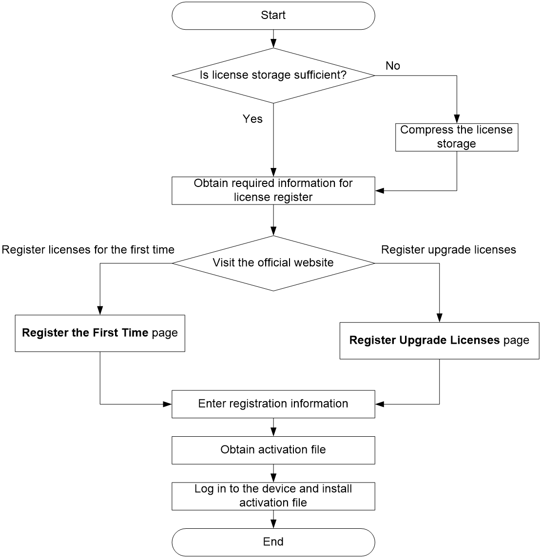

License registration and installation flowchart
Figure 1 License registration and installation flowchart
License management tasks at a glance
To manage licenses, perform the following tasks:
1.     Identifying the license storage
2.     (Optional.) Compressing the license storage
3.     Obtaining required information for license registrationObtaining required information for license registration
4.     Registering a license
5.     Installing a license

1.     Contact the customer service to unbind the license from the device.
2.     Remove the old MPU and install a new MPU.
3.     Compress the license storage to delete uninstalled license information. For more information, see "Compressing the license storage."
4.     Obtain the new SN and DID information of the license by using the display license device-id command.
5.     Visit the H3C website and use the license key, SN, and DID information to apply for a new activation file:
If the new MPU registers a license for the first time, select registering licenses for the first time. Otherwise, select registering upgrade licenses.
6.     Install the new activation file on the device.
