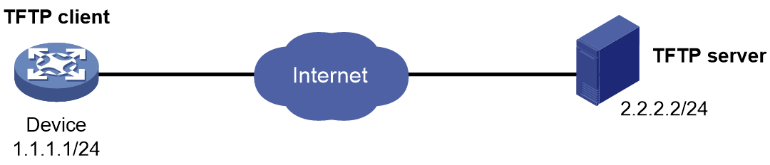

As shown in Figure 1, the IRF fabric has two members. Each member has one active MPU (slot 0) and one standby MPU (slot 1).
Upgrade the boot, system, and feature images from T0001015 to T0001016. The two versions are compatible.
Figure 1 Network diagram

Example: Upgrading the system software to an incompatible version
As shown in Figure 2, the IRF fabric has two members. Each member has one MPU in slot 0 (active MPU) and one MPU in slot 1 (standby MPU).
Upgrade the boot, system, and feature images from T0001015 to T0001017. The two versions are incompatible.
Figure 2 Network diagram
# Download the upgrade image files from the TFTP server.

Examples of using install commands for ISSU (in standalone mode)
As shown in Figure 3, the device has two MPUs. The active MPU is in slot 0. The standby MPU is in slot 1.
Upgrade the Feature1 feature image from T0001015 to T0001016. The two versions are compatible.
Figure 3 Network diagram
# Download the .ipe file that contains the T0001016 Feature1 feature image from the TFTP server.
<Sysname> tftp 2.2.2.2 get feature1-t0001016.ipe
  % Total    % Received % Xferd  Average Speed   Time    Time     Time  Current
                                 Dload  Upload   Total   Spent    Left  Speed
100   256  100  256     0     0    764      0 --:--:-- --:--:-- --:--:--   810
Writing file...Done.
