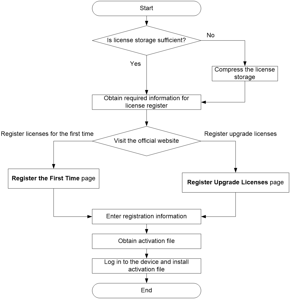

License registration and installation flowchart
Figure 1 License registration and installation flowchart

Registering a license
About registering a license
License registration has the following procedures:
·     Registering licenses for the first time—Register a license for a device that has not previously been registered.
·     Registering upgrade licenses—Register licenses for capacity expansion, feature enhancement, or a time extension. This procedure is also applicable to the scenario that you register a new license for a device that has expired or uninstalled licenses.
If you do not know which registration procedure should be used, select registering licenses for the first time. If the selection is not correct, the website will display messages for the correct registration choice after you enter the required information.
If you cannot download the activation file due to problems such as operating system and browser errors, try to re-register the license. If the problem persists, contact H3C Support.
1.     Visit the H3C website at http://www.h3c.com/en/License/.
2.     Select Register the First Time.
3.     Enter the authorization serial number in the Input the license key field and click Submit.
A dialog box opens, displaying product categories matching the license key.
4.     In the dialog box, select a product category from the Product category dropdown list and click OK.
5.     Enter the device S/N.
6.     Upload the DID file.
7.     Enter the required contact information and verify code, select I accept all terms of H3C Legal Statement, and click Get activation key or file.
8.     Download the activation file to the PC.
A copy of the activation file will also be sent to the email address that you enter in the contact information.
2.     Select Register Upgrade Licenses.
6.     Upload the DID file and click Submit.
