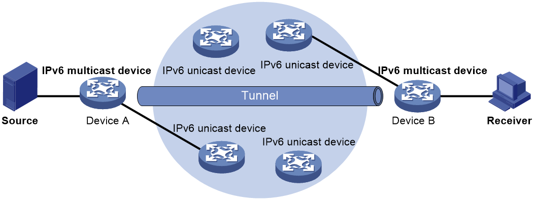

IPv6 multicast forwarding across IPv6 unicast subnets
Devices forward the IPv6 multicast data from an IPv6 multicast source hop by hop along the forwarding tree, but some devices might not support IPv6 multicast protocols in a network. When the IPv6 multicast data is forwarded to a device that does not support IPv6 multicast, the forwarding path is blocked. In this case, you can enable IPv6 multicast data forwarding across the IPv6 unicast subnets by establishing a tunnel between the devices at both ends of the IPv6 unicast subnets.
Figure 2 IPv6 multicast data transmission through a tunnel
As shown in Figure 2, a tunnel is established between Device A and Device B. Device A encapsulates the IPv6 multicast data in unicast IPv6 packets, and forwards them to Device B across the tunnel through unicast devices. Then, Device B strips off the unicast IPv6 header and continues to forward the IPv6 multicast data down toward the receivers.

Example: Configuring IPv6 multicast forwarding over a GRE tunnel
As shown in Figure 3:
·     IPv6 multicast routing and IPv6 PIM-DM are enabled on Router A and Router C.
·     Router B does not support IPv6 multicast.
·     Router A, Router B, and Router C run OSPFv3. The source-side interface GigabitEthernet 1/0/1 on Router A does not run OSPFv3.
Configure a GRE tunnel so that the receiver host can receive the IPv6 multicast data from Source.
Figure 3 Network diagram
1.     Assign an IPv6 address and prefix length to each interface, as shown in Figure 3. (Details not shown.)
2.     Configure OSPFv3 on the routers. Do not run OSPFv3 on the source-side interface GigabitEthernet 1/0/1 on Router A. (Details not shown.)
3.     Configure a GRE tunnel:
# Create an IPv6 GRE tunnel interface Tunnel 2 on Router A.
<RouterA> system-view
[RouterA] interface tunnel 2 mode gre ipv6
# Assign an IPv6 address to interface Tunnel 2 on Router A, and specify its source and destination addresses.
[RouterA-Tunnel2] ipv6 address 5001::1 64
[RouterA-Tunnel2] source 2001::1
[RouterA-Tunnel2] destination 3001::2
[RouterA-Tunnel2] quit
# Create an IPv6 GRE tunnel interface Tunnel 2 on Router C.
<RouterC> system-view
[RouterC] interface tunnel 2 mode gre ipv6
# Assign an IPv6 address to interface Tunnel 2, and specify its source and destination addresses.
[RouterC-Tunnel2] ipv6 address 5001::2 64
[RouterC-Tunnel2] source 3001::2
[RouterC-Tunnel2] destination 2001::1
[RouterC-Tunnel2] quit
4.     Enable IPv6 multicast routing, IPv6 PIM-DM, and MLD:
# On Router A, enable IPv6 multicast routing, and enable IPv6 PIM-DM on each interface.
[RouterA] ipv6 multicast routing
[RouterA-mrib6] quit
[RouterA] interface gigabitethernet 1/0/1
[RouterA-GigabitEthernet1/0/1] ipv6 pim dm
[RouterA-GigabitEthernet1/0/1] quit
[RouterA] interface gigabitethernet 1/0/2
[RouterA-GigabitEthernet1/0/2] ipv6 pim dm
[RouterA-GigabitEthernet1/0/2] quit
[RouterA-Tunnel2] ipv6 pim dm
# On Router C, enable IPv6 multicast routing.
[RouterC] ipv6 multicast routing
[RouterC-mrib6] quit
# Enable MLD on the receiver-side interface GigabitEthernet 1/0/1.
[RouterC] interface gigabitethernet 1/0/1
[RouterC-GigabitEthernet1/0/1] mld enable
[RouterC-GigabitEthernet1/0/1] quit
# Enable IPv6 PIM-DM on the other interfaces.
[RouterC] interface gigabitethernet 1/0/2
[RouterC-GigabitEthernet1/0/2] ipv6 pim dm
[RouterC-GigabitEthernet1/0/2] quit
[RouterC-Tunnel2] ipv6 pim dm
5.     On Router C, configure a static route with the destination address 1001::/64 and the outgoing interface Tunnel 2.
[RouterC] ipv6 route-static 1001::1 64 tunnel 2
# Send an MLD report from Receiver to join the IPv6 multicast group FF1E::101. (Details not shown.)
# Send IPv6 multicast data from Source to the IPv6 multicast group FF1E::101. (Details not shown.)
# Display PIM routing entries on Router C.
[RouterC] display ipv6 pim routing-table
 Total 1 (*, G) entry; 1 (S, G) entry
 (*, FF1E::101)
     Protocol: pim-dm, Flag: WC
     UpTime: 00:04:25
     Upstream interface: NULL
         Upstream neighbor: NULL
         RPF prime neighbor: NULL
     Downstream interface(s) information:
     Total number of downstreams: 1
         1: GigabitEthernet1/0/1
             Protocol: mld, UpTime: 00:04:25, Expires: -
 (1001::100, FF1E::101)
     Protocol: pim-dm, Flag: ACT
     UpTime: 00:06:14
     Upstream interface: Tunnel2
         Upstream neighbor: FE80::A01:101:1
         RPF prime neighbor: FE80::A01:101:1
             Protocol: pim-dm, UpTime: 00:04:25, Expires: -
The output shows the following information:
·     Router A is the RPF neighbor of Router C.
·     IPv6 multicast data from Router A is delivered over the GRE tunnel to Router C.

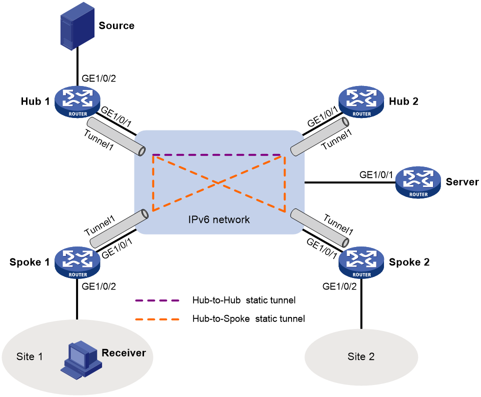

Example: Configuring IPv6 multicast forwarding over ADVPN tunnel interfaces
As shown in Figure 4:
·     An IPv6 ADVPN tunnel is established between each spoke and hub.
·     All hubs and spokes support IPv6 multicast. IPv6 PIM-SM runs on them, and NBMA runs on their IPv6 ADVPN tunnel interfaces.
·     OSPFv3 runs all hubs and spokes.
Configure the routers so that Spoke 1 can receive IPv6 multicast data from the source.
Figure 4 Network diagram
Table 1 Interface and IPv6 address assignment
Device
Interface
IPv6 address
Device
Interface
IPv6 address
Hub 1
GE1/0/1
1::1/64
Spoke 1
GE1/0/1
1::3/64
Hub 1
Tunnel1
192:168::1/64
FE80::1
Spoke 1
Tunnel1
192:168::3/64
FE80::3
Hub 1
Loop0
44::44/64
Spoke 1
GE1/0/2
200::100/64
Hub 1
GE1/0/2
100::100/64
Spoke 2
GE1/0/1
1::4/64
Hub 2
Tunnel1
192:168::2/64
FE80::2
Spoke 2
Tunnel1
192:168::4/64
FE80::4
Hub 2
Loop0
55::55/64
Server
GE1/0/1
1::11/64
Hub 2
GE1/0/1
1::2/64
1.     Assign an IPv6 address and prefix length to each interface, as shown in Table 1. (Details not shown.)

# Configure Loopback 0 as a C-BSR and a C-RP.
<Hub2> system-view
[Hub2] ipv6 pim
[Hub2-pim6] c-bsr 55::55
[Hub2-pim6] c-rp 55::55
[Hub2-pim6] quit
c.     Configure Spoke 1:
# Enable IPv6 multicast routing.
<Spoke1> system-view
[Spoke1] ipv6 multicast routing
[Spoke1-mrib6] quit
# Enable IPv6 PIM-SM and NBMA mode on Tunnel interface tunnel1.
[Spoke1] interface tunnel 1
[Spoke1-Tunnel1] ipv6 pim sm
[Spoke1-Tunnel1] ipv6 pim nbma-mode
[Spoke1-Tunnel1] quit
# Enable MLD on GigabitEthernet 1/0/2.
[Spoke1] interface gigabitethernet 1/0/2
[Spoke1-GigabitEthernet1/0/2] mld enable
[Spoke1-GigabitEthernet1/0/2] quit
d.     Configure Spoke 2:
<Spoke2> system-view
[Spoke2] ipv6 multicast routing
[Spoke2-mrib6] quit
[Spoke2] interface tunnel 1
[Spoke2-Tunnel1] ipv6 pim sm
[Spoke2-Tunnel1] ipv6 pim nbma-mode
[Spoke2-Tunnel1] quit
# Send an MLD report from Spoke 1 to join the IPv6 multicast group FF0E::1. (Details not shown.)
# Send IPv6 multicast data from the source to the IPv6 multicast group. (Details not shown.)
# Display IPv6 PIM routing entries on Hub 1.
[Hub1]display ipv6 pim routing-table
 Total 1 (*, G) entries; 1 (S, G) entries
 (*, FF0E::1)
     RP: 44::44 (local)
     Protocol: pim-sm, Flag: WC
     UpTime: 17:02:10
     Upstream interface: Register-Tunnel0
     Downstream interface information:
     Total number of downstream interfaces: 1
         1: Tunnel1, FE80::3
             Protocol: pim-sm, UpTime: 17:01:23, Expires: 00:02:41
 (100::1, FF0E::1)
     RP: 44::44 (local)
     Protocol: pim-sm, Flag: SPT LOC ACT
     UpTime: 00:00:02
     Upstream interface: GigabitEthernet1/0/3
         1: Tunnel1, FE80::3
             Protocol: pim-sm, UpTime: 00:00:02, Expires: 00:03:28
The output shows that Tunnel interface tunnel1 (FE80::3) on Spoke 1 will receive the IPv6 multicast data addressed to the IPv6 multicast group FF0E::1 from the source.
