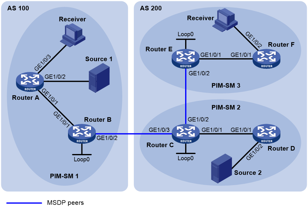

Example: Configuring PIM-SM inter-domain multicast
As shown in Figure 5:
·     OSPF runs within AS 100 and AS 200. BGP runs between the two ASs.
·     Each PIM-SM domain has a minimum of one multicast source or receiver.
Set up MSDP peering relationships between the RPs in the PIM-SM domains to share multicast source information among the PIM-SM domains.
Figure 5 Network diagram

1.     Assign an IP address and subnet mask to each interface according to Figure 5. (Details not shown.)
2.     Configure OSPF on the routers in the ASs. (Details not shown.)
3.     Enable IP multicast routing, enable PIM-SM and IGMP, and configure a PIM-SM domain border:
# On Router A, enable IP multicast routing.
<RouterA> system-view
[RouterA] multicast routing
[RouterA-mrib] quit
# Enable PIM-SM on GigabitEthernet 1/0/1 and GigabitEthernet 1/0/2.
[RouterA] interface gigabitethernet 1/0/1
[RouterA-GigabitEthernet1/0/1] pim sm
[RouterA-GigabitEthernet1/0/1] quit
[RouterA] interface gigabitethernet 1/0/2
[RouterA-GigabitEthernet1/0/2] pim sm
[RouterA-GigabitEthernet1/0/2] quit
# Enable IGMP on the receiver-side interface (GigabitEthernet 1/0/3).
[RouterA] interface gigabitethernet 1/0/3
[RouterA-GigabitEthernet1/0/3] igmp enable
[RouterA-GigabitEthernet1/0/3] quit
# Enable IP multicast routing, PIM-SM, and IGMP on Router B, Router C, Router D, Router E, and Router F in the same way Router A is configured. (Details not shown.)
# Configure a PIM domain border on Router B.
[RouterB] interface gigabitethernet 1/0/2
[RouterB-GigabitEthernet1/0/2] pim bsr-boundary
[RouterB-GigabitEthernet1/0/2] quit
# Configure a PIM domain border separately on Router C and Router E in the same way Router B is configured. (Details not shown.)
4.     Configure C-BSRs and C-RPs:
# Configure Loopback 0 on Router B as a C-BSR and a C-RP.
[RouterB] pim
[RouterB-pim] c-bsr 1.1.1.1
[RouterB-pim] c-rp 1.1.1.1
[RouterB-pim] quit
# Configure C-BSRs and C-RPs on Router C and Router E in the same way Router B is configured. (Details not shown.)
5.     Configure BGP for mutual route redistribution between BGP and OSPF:
# On Router B, configure an EBGP peer and redistribute OSPF routes.
[RouterB] bgp 100
[RouterB-bgp] router-id 1.1.1.1
[RouterB-bgp] peer 192.168.1.2 as-number 200
[RouterB-bgp] address-family ipv4
[RouterB-bgp-ipv4] import-route ospf 1
[RouterB-bgp-ipv4] peer 192.168.1.2 enable
[RouterB-bgp-ipv4] quit
[RouterB-bgp] quit
# On Router C, configure an EBGP peer and redistribute OSPF routes.
[RouterC] bgp 200
[RouterC-bgp] router-id 2.2.2.2
[RouterC-bgp] peer 192.168.1.1 as-number 100
[RouterC-bgp] address-family ipv4
[RouterC-bgp-ipv4] import-route ospf 1
[RouterB-bgp-ipv4] peer 192.168.1.1 enable
[RouterC-bgp-ipv4] quit
[RouterC-bgp] quit
# Redistribute BGP routing information into OSPF on Router B.
[RouterB] ospf 1
[RouterB-ospf-1] import-route bgp
[RouterB-ospf-1] quit
# Redistribute BGP routing information into OSPF on Router C.
[RouterC] ospf 1
[RouterC-ospf-1] import-route bgp
[RouterC-ospf-1] quit
6.     Configure MSDP peers:
# Configure an MSDP peer on Router B.
[RouterB] msdp
[RouterB-msdp] peer 192.168.1.2 connect-interface gigabitethernet 1/0/2
[RouterB-msdp] quit
# Configure MSDP peers on Router C.
[RouterC] msdp
[RouterC-msdp] peer 192.168.1.1 connect-interface gigabitethernet 1/0/3
[RouterC-msdp] peer 192.168.3.2 connect-interface gigabitethernet 1/0/2
[RouterC-msdp] quit
# Configure an MSDP peer on Router E.
[RouterE] msdp
[RouterE-msdp] peer 192.168.3.1 connect-interface gigabitethernet 1/0/2
[RouterE-msdp] quit

Example: Configuring inter-AS multicast by leveraging static RPF peers
As shown in Figure 6:
·     The network has two ASs: AS 100 and AS 200. OSPF runs within each AS. BGP runs between the two ASs.
·     PIM-SM 1 belongs to AS 100, and PIM-SM 2 and PIM-SM 3 belong to AS 200. Each PIM-SM domain has a minimum of one multicast source or receiver.
Configure inter-AS multicast as follows:
·     Configure Loopback 0 as the C-BSR and C-RP of the related PIM-SM domain on Router A, Router D and Router G.
·     According to the peer-RPF forwarding rule, the routers accept SA messages that pass the filtering policy from its static RPF peers. To share multicast source information among PIM-SM domains without changing the unicast topology structure, configure MSDP peering relationships for the RPs of the PIM-SM domains and configure the static RPF peering relationships.
Figure 6 Network diagram
Device
Interface
IP address
Device
Interface
IP address
Source 1
192.168.1.100/24
Router D
GE1/0/1
10.110.5.1/24
Source 2
192.168.3.100/24
Router D
GE1/0/2
10.110.3.2/24
Router A
GE1/0/1
10.110.1.1/24
Router D
Loop0
2.2.2.2/32
Router A
GE1/0/2
10.110.2.1/24
Router E
GE1/0/1
10.110.5.2/24
Router A
Loop0
1.1.1.1/32
Router E
GE1/0/2
192.168.3.1/24
Router B
GE1/0/1
10.110.1.2/24
Router F
GE1/0/1
10.110.6.1/24
Router B
GE1/0/2
192.168.1.1/24
Router F
GE1/0/2
10.110.4.2/24
Router B
GE1/0/3
10.110.3.1/24
Router G
GE1/0/1
10.110.6.2/24
Router C
GE1/0/1
10.110.2.2/24
Router G
GE1/0/2
192.168.4.1/24
Router C
GE1/0/2
192.168.2.1/24
Router G
Loop0
3.3.3.3/32
Router C
GE1/0/3
10.110.4.1/24
1.     Assign an IP address and subnet mask to each interface according to Table 2. (Details not shown.)
3.     Enable IP multicast routing, PIM-SM, and IGMP, and configure PIM-SM domain borders:
# On Router C, enable IP multicast routing.
<RouterC> system-view
[RouterC] multicast routing
[RouterC-mrib] quit
# Enable PIM-SM on each interface, and enable IGMP on the receiver-side interface (GigabitEthernet 1/0/2).
[RouterC] interface gigabitethernet 1/0/1
[RouterC-GigabitEthernet1/0/1] pim sm
[RouterC-GigabitEthernet1/0/1] quit
[RouterC] interface gigabitethernet 1/0/2
[RouterC-GigabitEthernet1/0/2] igmp enable
[RouterC-GigabitEthernet1/0/2] quit
[RouterC] interface gigabitethernet 1/0/3
[RouterC-GigabitEthernet1/0/3] pim sm
[RouterC-GigabitEthernet1/0/3] quit
# Configure Router A, Router B, Router D, Router E, Router F, and Router G in the same way Router C is configured. (Details not shown.)
# On Router B, configure the PIM domain borders.
[RouterB] interface gigabitethernet 1/0/3
[RouterB-GigabitEthernet1/0/3] pim bsr-boundary
[RouterB-GigabitEthernet1/0/3] quit
# Configure the PIM domain borders on Router C, Router D, and Router F in the same way Router B is configured. (Details not shown.)
# On Router A, configure Loopback 0 as a C-BSR and a C-RP.
[RouterA] pim
[RouterA-pim] c-bsr 1.1.1.1
[RouterA-pim] c-rp 1.1.1.1
[RouterA-pim] quit
# Configure C-BSRs and C-RPs on Router D and Router G in the same way Router A is configured. (Details not shown.)
5.     Configure BGP, and redistribute BGP routing information into OSPF and OSPF routing information into BGP:
# On Router B, configure an EBGP peer, and redistribute OSPF routing information.
[RouterB] bgp 100
[RouterB-bgp] router-id 1.1.1.2
[RouterB-bgp] peer 10.110.3.2 as-number 200
[RouterB-bgp] address-family ipv4 unicast
[RouterB-bgp-ipv4] peer 10.110.3.2 enable
[RouterB-bgp] quit
# On Router D, configure an EBGP peer, and redistribute OSPF routing information.
[RouterD] bgp 200
[RouterD-bgp] router-id 2.2.2.2
[RouterD-bgp] peer 10.110.3.1 as-number 100
[RouterD-bgp] address-family ipv4 unicast
[RouterD-bgp-ipv4] peer 10.110.3.1 enable
[RouterD-bgp-ipv4] import-route ospf 1
[RouterD-bgp-ipv4] quit
[RouterD-bgp] quit
# On Router C, configure an EBGP peer, and redistribute OSPF routing information.
[RouterC] bgp 100
[RouterC-bgp] router-id 1.1.1.3
[RouterC-bgp] peer 10.110.4.2 as-number 200
[RouterC-bgp] address-family ipv4 unicast
[RouterC-bgp-ipv4] peer 10.110.4.2 enable
[RouterC-bgp] quit
# On Router F, configure an EBGP peer, and redistribute OSPF routing information.
[RouterF] bgp 200
[RouterF-bgp] router-id 3.3.3.1
[RouterF-bgp] peer 10.110.4.1 as-number 100
[RouterF-bgp] address-family ipv4 unicast
[RouterF-bgp-ipv4] peer 10.110.4.1 enable
[RouterF-bgp-ipv4] import-route ospf 1
[RouterF-bgp-ipv4] quit
[RouterF-bgp] quit
# On Router B, redistribute BGP routing information into OSPF.
[RouterB] ospf 1
# On Router D, redistribute BGP routing information into OSPF.
[RouterD] ospf 1
[RouterD-ospf-1] import-route bgp
[RouterD-ospf-1] quit
# On Router C, redistribute BGP routing information into OSPF.
[RouterC] ospf 1
# On Router F, redistribute BGP routing information into OSPF.
[RouterF] ospf 1
[RouterF-ospf-1] import-route bgp
[RouterF-ospf-1] quit
6.     Configure MSDP peers and static RPF peers:
# On Router A, configure Router D and Router G as the MSDP peers and static RPF peers.
[RouterA] ip prefix-list list-dg permit 10.110.0.0 16 greater-equal 16 less-equal 32
[RouterA] msdp
[RouterA-msdp] peer 10.110.3.2 connect-interface gigabitethernet 1/0/1
[RouterA-msdp] peer 10.110.6.2 connect-interface gigabitethernet 1/0/2
[RouterA-msdp] static-rpf-peer 10.110.3.2 rp-policy list-dg
[RouterA-msdp] static-rpf-peer 10.110.6.2 rp-policy list-dg
[RouterA-msdp] quit
# On Router D, configure Router A as the MSDP peer and static RPF peer.
[RouterD] ip prefix-list list-a permit 10.110.0.0 16 greater-equal 16 less-equal 32
[RouterD] msdp
[RouterD-msdp] peer 10.110.1.1 connect-interface gigabitethernet 1/0/2
[RouterD-msdp] static-rpf-peer 10.110.1.1 rp-policy list-a
[RouterD-msdp] quit
# On Router G, configure Router A as the MSDP peer and static RPF peer.
[RouterG] ip prefix-list list-a permit 10.110.0.0 16 greater-equal 16 less-equal 32
[RouterG] msdp
[RouterG-msdp] peer 10.110.2.1 connect-interface gigabitethernet 1/0/1
[RouterG-msdp] static-rpf-peer 10.110.2.1 rp-policy list-a
[RouterG-msdp] quit
# Display the BGP peering relationships on Router A.
[RouterA] display bgp peer
No information is output, because no BGP peering relationship has been established between Router A and Router D, or between Router A and Router G. This means that the unicast topology is not changed.
# Display brief information about MSDP peers on Router A.
[RouterA] display msdp brief
Configured   Established  Listen       Connect      Shutdown     Disabled
2            2            0            0            0            0
Peer address    State       Up/Down time    AS         SA count   Reset count
10.110.3.2      Established 01:07:08        ?          8          0
10.110.6.2      Established 00:16:39        ?          13         0
# Display brief information about MSDP peers on Router D.
[RouterD] display msdp brief
1            1            0            0            0            0
10.110.1.1      Established 01:07:09        ?          8          0
# Display brief information about MSDP peers on Router G.
[RouterG] display msdp brief
1            1            0            0            0            0
10.110.2.1      Established 00:16:40        ?          13         0
# Verify that receivers in PIM-SM 1 and PIM-SM 3 can receive the multicast data from Source 1 and Source 2 to a multicast group. (Details not shown.)

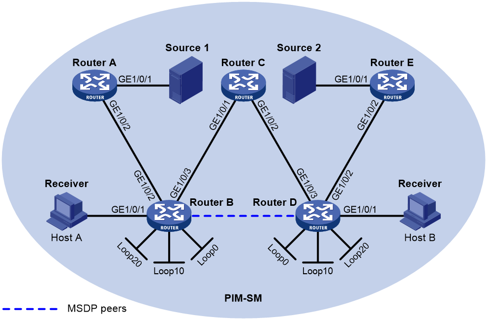

Example: Configuring Anycast RP
As shown in Figure 7, OSPF runs within the domain to provide unicast routes.
Configure the Anycast RP application so that the receiver-side DRs and the source-side DRs can initiate a join process to their respective RPs that are topologically closest to them.
Configure the router IDs of Router B and Router D as 1.1.1.1 and 2.2.2.2, respectively. Set up an MSDP peering relationship between Router B and Router D.
Figure 7 Network diagram
Table 3 Interface and IP address assignment
Device
Interface
IP address
Device
Interface
IP address
Source 1
10.110.5.100/24
Router C
GE1/0/1
192.168.1.2/24
Source 2
10.110.6.100/24
Router C
GE1/0/2
192.168.2.2/24
Router A
GE1/0/1
10.110.5.1/24
Router D
GE1/0/1
10.110.3.1/24
Router A
GE1/0/2
10.110.2.2/24
Router D
GE1/0/2
10.110.4.1/24
Router B
GE1/0/1
10.110.1.1/24
Router D
GE1/0/3
192.168.2.1/24
Router B
GE1/0/2
10.110.2.1/24
Router D
Loop0
2.2.2.2/32
Router B
GE1/0/3
192.168.1.1/24
Router D
Loop10
4.4.4.4/32
Router B
Loop0
1.1.1.1/32
Router D
Loop20
10.1.1.1/32
Router B
Loop10
3.3.3.3/32
Router E
GE1/0/1
10.110.6.1/24
Router B
Loop20
10.1.1.1/32
Router E
GE1/0/2
10.110.4.2/24
1.     Assign an IP address and subnet mask to each interface according to Figure 7. (Details not shown.)
2.     Configure OSPF on the routers in the PIM-SM domain. (Details not shown.)
3.     Enable IP multicast routing, IGMP, and PIM-SM:
# On Router B, enable IP multicast routing.
<RouterB> system-view
[RouterB] multicast routing
[RouterB-mrib] quit
# Enable IGMP on the receiver-side interface (GigabitEthernet 1/0/1).
[RouterB-GigabitEthernet1/0/1] igmp enable
[RouterB-GigabitEthernet1/0/1] quit
# Enable PIM-SM on the other interfaces.
[RouterB-GigabitEthernet1/0/2] pim sm
[RouterB-GigabitEthernet1/0/3] pim sm
[RouterB] interface loopback 0
[RouterB-LoopBack0] pim sm
[RouterB-LoopBack0] quit
[RouterB] interface loopback 10
[RouterB-LoopBack10] pim sm
[RouterB-LoopBack10] quit
[RouterB] interface loopback 20
[RouterB-LoopBack20] pim sm
[RouterB-LoopBack20] quit
# Enable IP multicast routing, IGMP, and PIM-SM on Router A, Router C, Router D, and Router E in the same way Router B is configured. (Details not shown.)
# On Router B, configure Loopback 10 as a C-BSR and configure Loopback 20 as a C-RP.
[RouterB] pim
[RouterB-pim] c-bsr 3.3.3.3
[RouterB-pim] c-rp 10.1.1.1
[RouterB-pim] quit
# Configure a C-BSR and a C-RP on Router D in the same way Router B is configured. (Details not shown.)
5.     Configure MSDP peers:
# Configure an MSDP peer on Loopback 0 of Router B.
[RouterB] msdp
[RouterB-msdp] originating-rp loopback 0
[RouterB-msdp] peer 2.2.2.2 connect-interface loopback 0
[RouterB-msdp] quit
# Configure an MSDP peer on Loopback 0 of Router D.
[RouterD] msdp
[RouterD-msdp] originating-rp loopback 0
[RouterD-msdp] peer 1.1.1.1 connect-interface loopback 0
[RouterD-msdp] quit
# Display brief information about MSDP peers on Router B.
[RouterB] display msdp brief
1          1          0         0         0         0
2.2.2.2         Established 00:00:13        ?          0          0
1            1            0            0            0            0
1.1.1.1         Established 00:00:13        ?          0          0
# Send an IGMP report from Host A to join the multicast group 225.1.1.1. (Details not shown.)
# Send multicast data from Source 1 10.110.5.100/24 to the multicast group 225.1.1.1. (Details not shown.)
# Display the PIM routing table on Router D.
[RouterD] display pim routing-table
No information is output on Router D.
# Display the PIM routing table on Router B.
[RouterB] display pim routing-table
 Total 1 (*, G) entry; 1 (S, G) entry
 (*, 225.1.1.1)
     RP: 10.1.1.1 (local)
     Protocol: pim-sm, Flag: WC
     UpTime: 00:15:04
     Upstream interface: Register-Tunnel0
         Upstream neighbor: NULL
         RPF prime neighbor: NULL
     Downstream interface(s) information:
     Total number of downstreams: 1
         1: GigabitEthernet1/0/1
             Protocol: igmp, UpTime: 00:15:04, Expires: -
 (10.110.5.100, 225.1.1.1)
     Protocol: pim-sm, Flag: SPT 2MSDP ACT
     UpTime: 00:46:28
     Upstream interface: GigabitEthernet1/0/2
         Upstream neighbor: 10.110.2.2
         RPF prime neighbor: 10.110.2.2
             Protocol: pim-sm, UpTime:  - , Expires:  -
The output shows that Router B now acts as the RP for Source 1 and Host A.
# Send an IGMP leave message from Host A to leave multicast group 225.1.1.1. (Details not shown.),
# Send an IGMP report from Host B to join multicast group 225.1.1.1. (Details not shown.)
# Send multicast data from Source 2 to multicast group 225.1.1.1. (Details not shown.)
No information is output on Router B.
# Display PIM routing information on Router D.
 (*, 225.1.1.1)
     UpTime: 00:12:07
             Protocol: igmp, UpTime: 00:12:07, Expires: -
 (10.110.6.100, 225.1.1.1)
     UpTime: 00:40:22
         Upstream neighbor: 10.110.4.2
         RPF prime neighbor: 10.110.4.2
The output shows that Router D now acts as the RP for Source 2 and Host B.

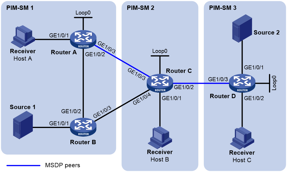

Example: Configuring SA message filtering
As shown in Figure 8:
·     OSPF runs within and among the PIM-SM domains to provide unicast routing.
·     Set up an MSDP peering relationship between Router A and Router C and between Router C and Router D.
·     Source 1 sends multicast data to multicast groups 225.1.1.0/30 and 226.1.1.0/30. Source 2 sends multicast data to the multicast group 227.1.1.0/30.
Configure SA message policies to meet the following requirements:
·     Host A and Host B receive the multicast data only addressed to multicast groups 225.1.1.0/30 and 226.1.1.0/30.
·     Host C receives the multicast data only addressed to multicast groups 226.1.1.0/30 and 227.1.1.0/30.
Figure 8 Network diagram
Table 4 Interface and IP address assignment
Device
Interface
IP address
Device
Interface
IP address
Source 1
10.110.3.100/24
Router C
GE1/0/1
10.110.4.1/24
Source 2
10.110.6.100/24
Router C
GE1/0/2
10.110.5.1/24
Router A
GE1/0/1
10.110.1.1/24
Router C
GE1/0/3
192.168.1.2/24
Router A
GE1/0/2
10.110.2.1/24
Router C
GE1/0/4
192.168.2.2/24
Router A
GE1/0/3
192.168.1.1/24
Router C
Loop0
2.2.2.2/32
Router A
Loop0
1.1.1.1/32
Router D
GE1/0/1
10.110.6.1/24
Router B
GE1/0/1
10.110.3.1/24
Router D
GE1/0/2
10.110.7.1/24
Router B
GE1/0/2
10.110.2.2/24
Router D
GE1/0/3
10.110.5.2/24
Router B
GE1/0/3
192.168.2.1/24
Router D
Loop0
3.3.3.3/32
1.     Assign an IP address and subnet mask to each interface according to Figure 8. (Details not shown.)
2.     Configure OSPF on the routers in the PIM-SM domains. (Details not shown.)
3.     Enable IP multicast routing, IGMP, and PIM-SM, and configure a PIM domain border:
[RouterA-mrib] quit
[RouterA-GigabitEthernet1/0/1] igmp enable
[RouterA-GigabitEthernet1/0/3] pim sm
[RouterA] interface loopback 0
[RouterA-LoopBack0] pim sm
[RouterA-LoopBack0] quit
# Enable IP multicast routing, IGMP, and PIM-SM on Router B, Router C, and Router D in the same way Router A is configured. (Details not shown.)
# Configure PIM domain borders on Router C.
[RouterC-GigabitEthernet1/0/2] pim bsr-boundary
[RouterC-GigabitEthernet1/0/3] pim bsr-boundary
[RouterC] interface gigabitethernet 1/0/4
[RouterC-GigabitEthernet1/0/4] pim bsr-boundary
[RouterC-GigabitEthernet1/0/4] quit
# Configure PIM domain borders on Router A, Router B, and Router D in the same way Router C is configured. (Details not shown.)
# Configure Loopback 0 on Router A as a C-BSR and a C-RP.
[RouterA] pim
[RouterA-pim] quit
# Configure C-BSRs and C-RPs on Router C and Router D in the same way Router A is configured. (Details not shown.)
# Configure an MSDP peer on Router A.
[RouterA] msdp
[RouterA-msdp] peer 192.168.1.2 connect-interface gigabitethernet 1/0/3
[RouterA-msdp] quit
[RouterC] msdp
[RouterC-msdp] peer 10.110.5.2 connect-interface gigabitethernet 1/0/2
[RouterC-msdp] quit
# Configure an MSDP peer on Router D.
[RouterD] msdp
[RouterD-msdp] peer 10.110.5.1 connect-interface gigabitethernet 1/0/3
[RouterD-msdp] quit
6.     Configure SA message policies:
# Configure an SA accepting and forwarding policy on Router C so that Router C will not forward SA messages for (Source 1, 225.1.1.0/30) to Router D.
[RouterC] acl advanced 3001
[RouterC-acl-ipv4-adv-3001] rule deny ip source 10.110.3.100 0 destination 225.1.1.0 0.0.0.3
[RouterC-acl-ipv4-adv-3001] rule permit ip source any destination any
[RouterC-acl-ipv4-adv-3001] quit
[RouterC] msdp
[RouterC-msdp] peer 10.110.5.2 sa-policy export acl 3001
[RouterC-msdp] quit
# Configure an SA creation policy on Router D so that Router D will not create SA messages for Source 2.
[RouterD] acl basic 2001
[RouterD-acl-ipv4-basic-2001] rule deny source 10.110.6.100 0
[RouterD-acl-ipv4-basic-2001] quit
[RouterD] msdp
[RouterD-msdp] import-source acl 2001
[RouterD-msdp] quit
