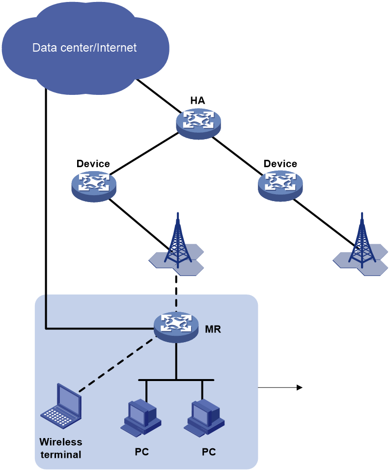

Connecting the mobile network to the home network through the wired link
As shown in Figure 2, the 3G or 4G wireless link is the backup link for the wired link between the mobile network and the home network.
When the mobile network roams, the wired link is disconnected. The mobile network is connected to the home network through the 3G or 4G wireless link. After the move is completed, the wired link is recovered, and the wireless link becomes the backup link.
Figure 2 Connecting the mobile network and the home network through the wired link

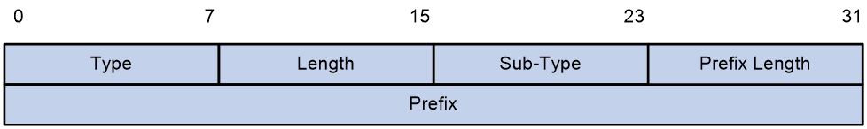

Mobile network extension
A mobile network extension contains the following fields:
·     Type—Type of the extension. The value is 148.
·     Length—Length of the extension, excluding the Type filed. The value is 6.
·     Sub-Type—Sub-type of the extension. The value is 0.
·     Prefix Length—Prefix length of the mobile network.
·     Prefix—Prefix of the mobile network.
Figure 6 Mobile network extension format

As shown in Figure 9, the home agent is a Cisco device. The mobile router uses a USB 3G modem to register with the home agent and access the 3G network through Dial-on-Demand Routing (DDR).
Configure NEMO on the mobile router to meet the following requirements when the mobile network moves:
·     The hosts on the mobile network use their home addresses for communication.
·     Application connectivity is maintained on the hosts.
Figure 9 Network diagram
1.     Configure the mobile router:
# Assign the IP address 20.1.1.1 to GigabitEthernet 1/0/1.
<MR> system-view
[MR] interface gigabitethernet 1/0/1
[MR-GigabitEthernet1/0/1] ip address 20.1.1.1 255.255.255.0
[MR-GigabitEthernet1/0/1] quit
# Enable mobile IP.
[MR] router mobile
[MR-MIP] quit
# Enable the mobile router feature.
[MR] ip mobile router
# Assign a home address to the mobile router.
[MR-mobile-router] address 1.1.1.3
# Specify the IP address of the home agent 1.1.1.2 (IP address of the interface Loopback 0 on the home agent) on the mobile router.
[MR-mobile-router] home-agent 1.1.1.2
# Specify GigabitEthernet 1/0/1 as the mobile router interface.
[MR-mobile-router] mobile-network gigabitethernet 1/0/1
[MR-mobile-router] quit
# Channelize Cellular 2/4/0 into a synchronous/asynchronous serial interface.
[MR] controller cellular 2/4/0
[MR-Cellular2/4/0] serial-set 0
[MR-Cellular2/4/0] quit
# Configure Serial 2/4/0:0 as the roaming interface. (In this example, the IP address of the roaming interface is assigned by the service provider. For more information, see Layer 2—WAN Access Configuration Guide.)
[MR] interface serial 2/4/0:0
[MR-Serial2/4/0:0] ip mobile router-service roam
[MR-Serial2/4/0:0] quit
# Configure a security association that contains the home agent address 1.1.1.2, SPI 100, and the plaintext key abc. Make sure the same security association is configured on the home agent.
[MR] ip mobile secure home-agent 1.1.1.2 spi 100 key ascii simple abc
2.     Configure the home agent as described in its user documentation. (Details not shown.)
# Display registration information for the mobile router.
[MR] display ip mobile router registration
Registration accepted on 12/04/13 at 10:43:52, On Serial2/4/0:0
Care-of addr: 208.122.148.233, HA addr: 1.1.1.2, Home addr: 1.1.1.3
Lifetime requested: 65534, Granted: 36000
Remaining: 9 hours 58 minutes 36 seconds
Flags sbDmG-T-
Identification d64985e8.bd34f00e
Next registration: 9 hours 56 minutes 36 seconds
Extensions:
  Mobile Network 20.1.1.0/24
  Authentication SPI: 100
# Display registration information for the mobile router after it moves to another network.
Registration accepted on 12/04/13 at 11:35:45, On Serial2/4/0:0
Care-of addr: 212.48.124.187, HA addr: 1.1.1.2, Home addr: 1.1.1.3
Flags sbDmG-T-
Identification d6499211.bc35e11d
Extensions:
The output shows that the mobile router retains the home address and maintains the application connectivity when it moves.
