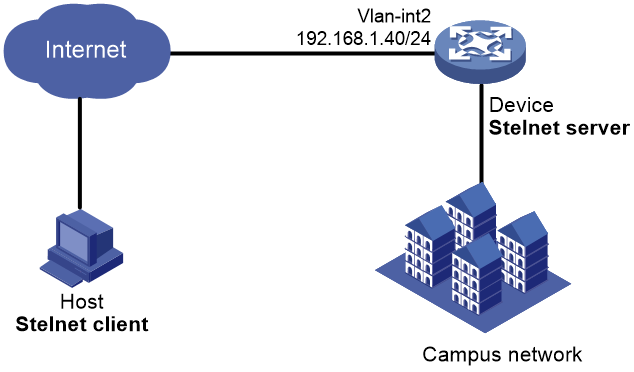

Example: Configuring the device as an Stelnet server using password authentication

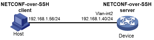

As shown in Figure 1:
·     The device uses local password authentication.
·     The login username and password are client001 and aabbcc, respectively.
Establish an Stelnet connection between the host and the device, so you can log in to the device to manage the campus network.
Figure 1 Network diagram
Analysis
To meet the network requirements, you must perform the following tasks:
·     To ensure correct SSH version negotiation and algorithm negotiation, and to ensure that the server can pass the client's authentication, generate DSA, ECDSA, and RSA key pairs on the server.
·     To perform local authentication, create a local user and configure a password for the local user on the Stelnet server.
·     To enable an SSH user to use all commands after login, set the user role of the local user to network-admin. By default, the user role of a local user is network-operator.
·     The authentication mode for Stelnet user lines must be AAA (scheme).

As shown in Figure 4:
·     The device uses publickey authentication and RSA public key algorithm.
·     The login username is client001.
Import the client's host public key to the server to ensure correct format and content of the public key.
Figure 4 Network diagram

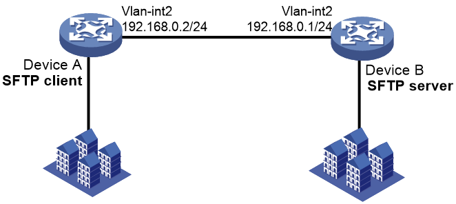

Example: Configuring the device as an Stelnet client for password authentication
As shown in Figure 12:
·     Device B uses local password authentication.
Establish an Stelnet connection between Device A and Device B, so you can log in to Device B to use all commands and perform secure data exchange.
To ensure communication security, configure Device A to use the host public key of Device B to authenticate Device B.
Figure 12 Network diagram
Analysis
·     Because the Stelnet client uses the host public key of the server to authenticate the server, you must configure the host public key of the server on the client.

Example: Configuring SFTP with password-publickey authentication
As shown in Figure 13:
·     Device B uses password-publickey authentication and RSA public key algorithm.
Establish an SFTP connection between Device A and Device B, so you can log in to Device B to perform file and directory operations.
Figure 13 Network diagram

Example: Configuring SCP file transfer with remote password authentication
As shown in Figure 14, configure the devices and the RADIUS server to meet the following requirements:
·     Establish an SCP connection between Device A and Device B, so you can log in to Device B to perform file transfer.
·     Use the RADIUS server for SSH user authentication and authorization. The user name and password are hello@bbb and aabbcc, respectively.
·     Include the domain name in the username sent to the RADIUS server.
·     Assign the default user role network-admin to the SSH user, so the user can use all commands after login.
Figure 14 Network diagram

Example: Configuring NETCONF over SSH with password authentication
As shown in Figure 17:
·     The client's username client001 and password aabbcc are saved on the device.
Establish a NETCONF-over-SSH connection between the host and the device, so that you can perform NETCONF operations after logging in to the device.
Figure 17 Network diagram
Analysis
·     To ensure correct SSH version negotiation and algorithm negotiation, and to ensure that the server can pass the client's authentication, generate DSA, ECDSA, and RSA key pairs on the SSH server.
·     The authentication mode for SSH user lines must be AAA (scheme).

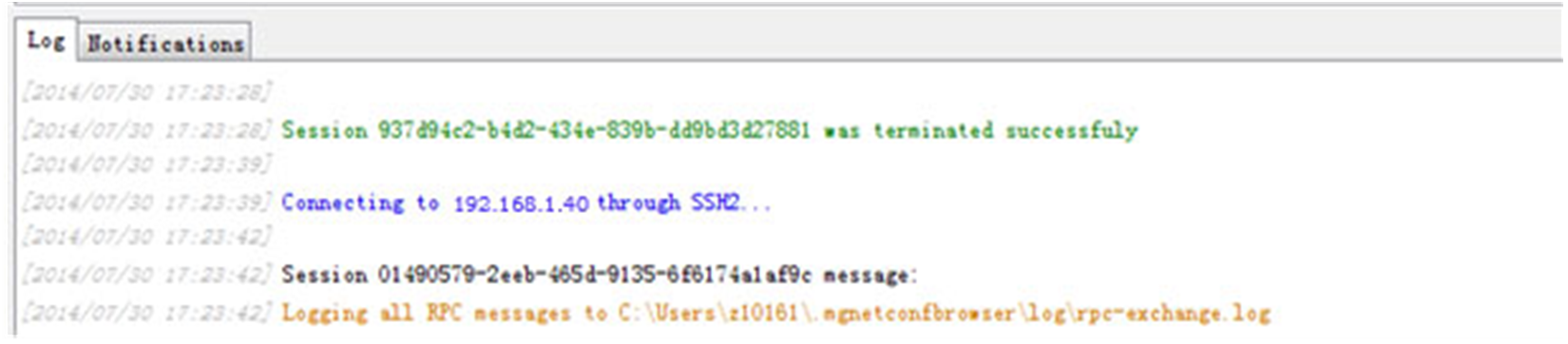

This example uses NetConf Browser 2013 (version 3.1).

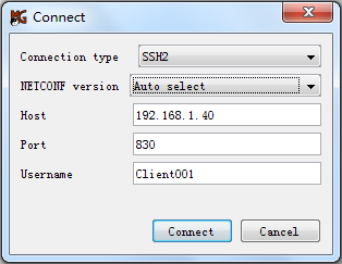

To verify that you can log in to the NETCONF-over-SSH server and perform NETCONF operations:
1.     Launch NetConf Browser 2013 (version 3.1).
2.     Select File > Connect… from the menu.
a.     Select Auto select from the NETCONF version list.
b.     Enter 192.168.1.40 in the Host field.
c.     Enter 830 in the Port field.
d.     Enter Client001 in the Username field.
3.     Click Connect.
Figure 18 Connecting to the device

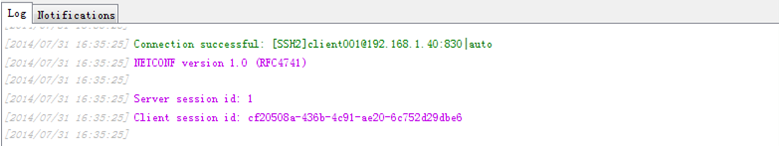

4.     Enter the password aabbcc, and click OK.
The page shown in Figure 20 appears, and you enter the NETCONF configuration interface.
Figure 19 Entering the password
Figure 20 Logging in to the device
5.     Enter <get-sessions/> in the Command XML area.
The following message is displayed in the Output XML area.
