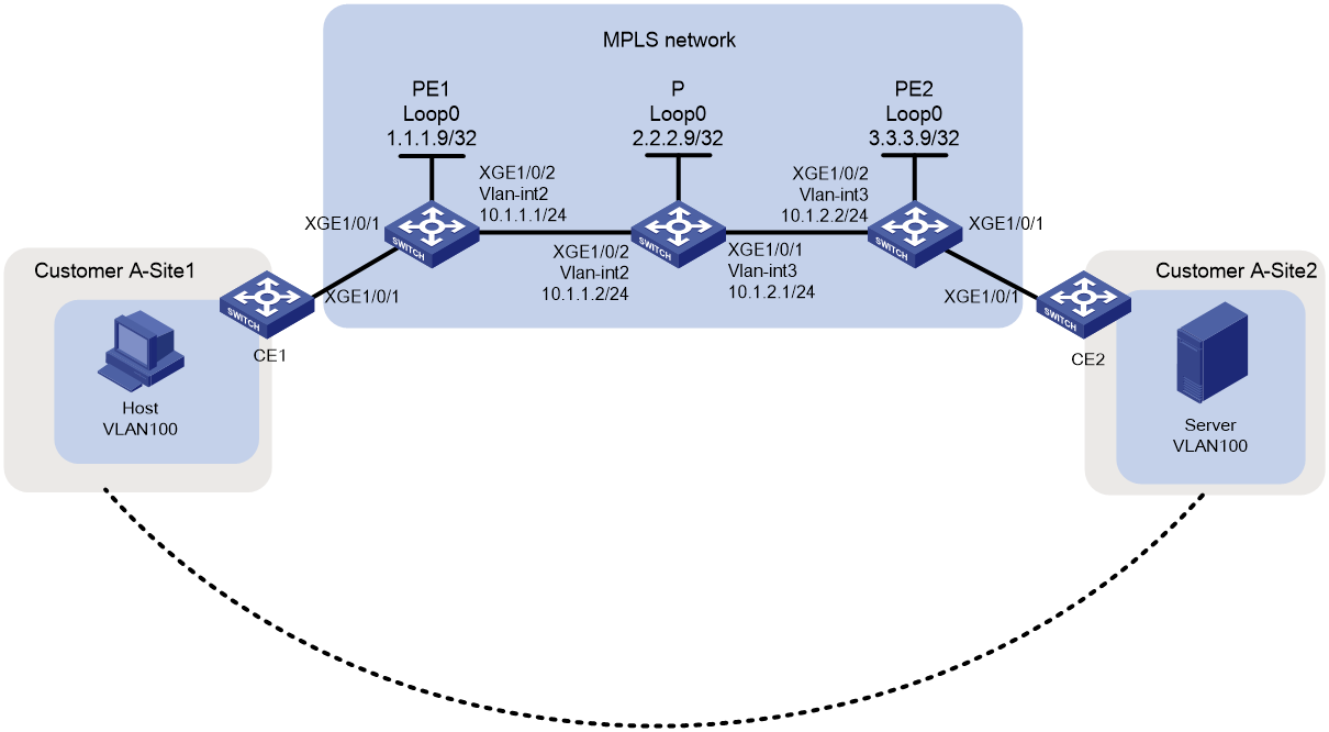

Example: Configuring remote CCC connections
As shown in Figure 1, configure remote CCC connections between PE 1 and PE 2 to allow communication between the two sites as if they were in the same LAN. The same VLAN in different sites can communicate with each other.
Figure 1 Network diagram

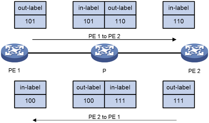

Analysis
To establish a remote CCC connection, specify the incoming and outgoing labels on the PEs, and create a static LSP for each direction of the connection on the P device. The outgoing label specified on a device must be the same as the incoming label specified on the next hop device as shown in Figure 2.
Figure 2 Incoming and outgoing label assignment

# On P, create a static LSP for forwarding packets of VLAN 100 from PE 1 to PE 2.
[P] static-lsp transit pe1-pe2-100 in-label 101 nexthop 10.1.2.2 out-label 110
# On P, create a static LSP for forwarding packets of VLAN 101 from PE 1 to PE 2.
[P] static-lsp transit pe1-pe2-101 in-label 201 nexthop 10.1.2.2 out-label 210
# On P, create a static LSP for forwarding packets of VLAN 100 from PE 2 to PE 1.
[P] static-lsp transit pe2-pe1-100 in-label 111 nexthop 10.1.1.1 out-label 100
# On P, create a static LSP for forwarding packets of VLAN 101 from PE 2 to PE 1.
[P] static-lsp transit pe2-pe1-101 in-label 211 nexthop 10.1.1.1 out-label 200

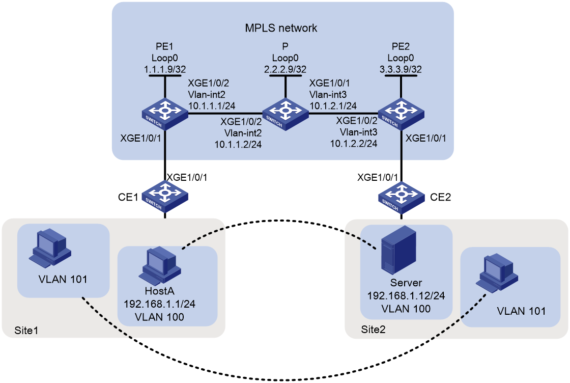

3.     Allow CE access to PEs:
# On CE 1, configure Ten-GigabitEthernet 1/0/1 as a trunk port and assign the port to VLAN 100 and VLAN 101.
<CE1> system-view
[CE1] vlan 100 to 101
[CE1] interface Ten-GigabitEthernet 1/0/1
[CE1-Ten-GigabitEthernet1/0/1] port link-type trunk
[CE1-Ten-GigabitEthernet1/0/1] port trunk permit vlan 100 101
# On CE 2, configure Ten-GigabitEthernet 1/0/1 as a trunk port and assign the port to VLAN 100 and VLAN 101.
<CE2> system-view
[CE2] vlan 100 to 101
[CE2] interface Ten-GigabitEthernet 1/0/1
[CE2-Ten-GigabitEthernet1/0/1] port link-type trunk
[CE2-Ten-GigabitEthernet1/0/1] port trunk permit vlan 100 101
# Display L2VPN PW information on PE 1. The output shows that two remote CCC connections (identified by PW ID/Rmt Site "-" and Proto Static) have been established.
[PE1] display l2vpn pw
Flags: M - main, B - backup, H - hub link, S - spoke link, N - no split horizon
Total number of PWs: 2, 2 up, 0 blocked, 0 down, 0 defect
Xconnect-group Name: vpna
Peer            PW ID/Rmt Site    In/Out Label    Proto   Flag  Link ID  State
10.1.1.2        -                 100/101         Static  M     1        Up
Xconnect-group Name: vpnb
10.1.1.2        -                 200/201         Static  M     1        Up
# Display L2VPN PW information on PE 2. The output shows that two remote CCC connections have been established.
[PE2] display l2vpn pw
10.1.2.1        -                 110/111         Static  M     1        Up
10.1.2.1        -                 210/211         Static  M     1        Up
# Verify that Host A and Server can ping each other and hosts of VLAN 101 in different sites can ping each other. (Details not shown.)

Example: Configuring static PWs
As shown in Figure 3, the MPLS network provides L2VPN services for two customers. Each customer has two fixed sites. Configure static PWs between PE 1 and PE 2 to allow communication between the sites of the same customer.
Figure 3 Network diagram
Analysis
To use static PWs to implement MPLS L2VPN, configure two levels of labels:
·     Inner labels—PW labels specified manually.
·     Outer labels—Public tunnel labels dynamically generated by LDP in this example.
To ensure that a static PW can be successfully established for the sites of a customer, specify the incoming label on the local PE the same as the outgoing label on the remote PE.
Procedures

·     Inner labelsPW labels dynamically generated by LDP.
To identify packets to be transported by MPLS L2VPN, configure service instances and match criteria on the CE-facing ports of PEs.

1.     Configure OSPF on the MPLS backbone to ensure IP connectivity within the backbone:
# On PE 1, configure an IP address for Loopback 0.
<PE1> system-view
[PE1] interface loopback 0
[PE1-LoopBack0] ip address 1.1.1.9 32
[PE1-LoopBack0] quit
# On PE 1, create VLAN 2 and assign Ten-GigabitEthernet 1/0/2 to the VLAN.
[PE1] vlan 2
[PE1-vlan2] port Ten-GigabitEthernet 1/0/2
[PE1-vlan2] quit
# On PE 1, configure an IP address for VLAN-interface 2.
[PE1] interface vlan-interface 2
[PE1-Vlan-interface2] ip address 10.1.1.1 24
[PE1-Vlan-interface2] quit
# On PE 1, configure OSPF.
[PE1] ospf
[PE1-ospf-1] area 0
[PE1-ospf-1-area-0.0.0.0] network 10.1.1.0 0.0.0.255
[PE1-ospf-1-area-0.0.0.0] network 1.1.1.9 0.0.0.0
[PE1-ospf-1-area-0.0.0.0] quit
[PE1-ospf-1] quit
# On P, configure an IP address for Loopback 0.
<P> system-view
[P] interface loopback 0
[P-LoopBack0] ip address 2.2.2.9 32
[P-LoopBack0] quit
# On P, create VLAN 2 and assign Ten-GigabitEthernet 1/0/2 to the VLAN.
[P] vlan 2
[P-vlan2] port Ten-GigabitEthernet1/0/2
[P-vlan2] quit
# On P, configure an IP address for VLAN-interface 2.
[P] interface vlan-interface 2
[P-Vlan-interface2] ip address 10.1.1.2 24
[P-Vlan-interface2] quit
# On P, create VLAN 3 and assign Ten-GigabitEthernet 1/0/1 to the VLAN.
[P] vlan 3
[P-vlan3] port Ten-GigabitEthernet1/0/1
[P-vlan3] quit
# On P, configure an IP address for VLAN-interface 3.
[P] interface vlan-interface 3
[P-Vlan-interface3] ip address 10.1.2.1 24
[P-Vlan-interface3] quit
# On P, configure OSPF.
[P] ospf
[P-ospf-1] area 0
[P-ospf-1-area-0.0.0.0] network 10.1.1.0 0.0.0.255
[P-ospf-1-area-0.0.0.0] network 10.1.2.0 0.0.0.255
[P-ospf-1-area-0.0.0.0] network 2.2.2.9 0.0.0.0
[P-ospf-1-area-0.0.0.0] quit
[P-ospf-1] quit
# On PE 2, configure an IP address for Loopback 0.
<PE2> system-view
[PE2] interface loopback 0
[PE2-LoopBack0] ip address 3.3.3.9 32
[PE2-LoopBack0] quit
# On PE 2, create VLAN 3 and assign Ten-GigabitEthernet 1/0/2 to the VLAN.
[PE2] vlan 3
[PE2-vlan3] port Ten-GigabitEthernet 1/0/2
[PE2-vlan3] quit
# On PE 2, configure an IP address for VLAN-interface 3.
[PE2] interface vlan-interface 3
[PE2-Vlan-interface3] ip address 10.1.2.2 24
[PE2-Vlan-interface3] quit
# On PE 2, configure OSPF.
[PE2] ospf
[PE2-ospf-1] area 0
[PE2-ospf-1-area-0.0.0.0] network 10.1.2.0 0.0.0.255
[PE2-ospf-1-area-0.0.0.0] network 3.3.3.9 0.0.0.0
[PE2-ospf-1-area-0.0.0.0] quit
[PE2-ospf-1] quit
2.     Configure basic MPLS and MPLS LDP on the MPLS backbone to establish LDP LSPs:
# On PE 1, configure an LSR ID.
[PE1] mpls lsr-id 1.1.1.9
# On PE 1, enable LDP globally.
[PE1] mpls ldp
[PE1-ldp] quit
# On PE 1, enable MPLS and LDP on VLAN-interface 2.
[PE1-Vlan-interface2] mpls enable
[PE1-Vlan-interface2] mpls ldp enable
# On P, configure an LSR ID.
[P] mpls lsr-id 2.2.2.9
# On P, enable LDP globally.
[P] mpls ldp
[P-ldp] quit
# On P, enable MPLS and LDP on VLAN-interface 2.
[P-Vlan-interface2] mpls enable
[P-Vlan-interface2] mpls ldp enable
# On P, enable MPLS and LDP on VLAN-interface 3.
[P-Vlan-interface3] mpls enable
[P-Vlan-interface3] mpls ldp enable
# On PE 2, configure an LSR ID.
[PE2] mpls lsr-id 3.3.3.9
# On PE 2, enable LDP globally.
[PE2] mpls ldp
[PE2-ldp] quit
# On PE 2, enable MPLS and LDP on VLAN-interface 3.
[PE2-Vlan-interface3] mpls enable
[PE2-Vlan-interface3] mpls ldp enable
3.     Configure a service instance for each department and bind the service instances to their respective VPN connections:
# On PE 1, enable MPLS L2VPN globally.
[PE1] l2vpn enable
# On PE 1, create service instance 100 on Ten-GigabitEthernet 1/0/1 to match packets from VLAN 100.
[PE1] interface ten-gigabitethernet1/0/1
[PE1-Ten-GigabitEthernet1/0/1] service-instance 100
[PE1-Ten-GigabitEthernet1/0/1-srv100] encapsulation s-vid 100
[PE1-Ten-GigabitEthernet1/0/1-srv100] quit
# On PE 1, create service instance 200 on Ten-GigabitEthernet 1/0/1 to match packets from VLAN 200.
[PE1-Ten-GigabitEthernet1/0/1] service-instance 200
[PE1-Ten-GigabitEthernet1/0/1-srv200] encapsulation s-vid 200
[PE1-Ten-GigabitEthernet1/0/1-srv200] quit
[PE1-Ten-GigabitEthernet1/0/1] quit
# On PE 1, create cross-connect group vpna, create cross-connect ldp in the group, and bind service instance 100 on Ten-GigabitEthernet 1/0/1 to the cross-connect.
[PE1] xconnect-group vpna
[PE1-xcg-vpna] connection ldp
[PE1-xcg-vpna-ldp] ac interface Ten-GigabitEthernet 1/0/1 service-instance 100
# On PE 1, create an LDP PW for the cross-connect to bind the AC to the PW.
[PE1-xcg-vpna-ldp] peer 3.3.3.9 pw-id 100
[PE1-xcg-vpna-ldp-3.3.3.9-100] quit
[PE1-xcg-vpna-ldp] quit
[PE1-xcg-vpna] quit
# On PE 1, create cross-connect group vpnb, create cross-connect ldp in the group, and bind service instance 200 on Ten-GigabitEthernet 1/0/1 to the cross-connect.
[PE1] xconnect-group vpnb
[PE1-xcg-vpnb] connection ldp
[PE1-xcg-vpnb-ldp] ac interface Ten-GigabitEthernet 1/0/1 service-instance 200
[PE1-xcg-vpnb-ldp] peer 3.3.3.9 pw-id 200
[PE1-xcg-vpnb-ldp-3.3.3.9-200] quit
[PE1-xcg-vpnb-ldp] quit
[PE1-xcg-vpnb] quit
# On PE 2, enable MPLS L2VPN globally.
[PE2] l2vpn enable
# On PE 2, create service instance 100 on Ten-GigabitEthernet 1/0/1 to match packets from VLAN 100.
[PE2] interface ten-gigabitethernet1/0/1
[PE2-Ten-GigabitEthernet1/0/1] service-instance 100
[PE2-Ten-GigabitEthernet1/0/1-srv100] encapsulation s-vid 100
[PE2-Ten-GigabitEthernet1/0/1-srv100] quit
# On PE 2, create service instance 200 on Ten-GigabitEthernet 1/0/1 to match packets from VLAN 200.
[PE2-Ten-GigabitEthernet1/0/1] service-instance 200
[PE2-Ten-GigabitEthernet1/0/1-srv200] encapsulation s-vid 200
[PE2-Ten-GigabitEthernet1/0/1-srv200] quit
[PE2-Ten-GigabitEthernet1/0/1] quit
# On PE 2, create cross-connect group vpna, create cross-connect ldp in the group, and bind service instance 100 on Ten-GigabitEthernet 1/0/1 to the cross-connect.
[PE2] xconnect-group vpna
[PE2-xcg-vpna] connection ldp
[PE2-xcg-vpna-ldp] ac interface Ten-GigabitEthernet 1/0/1 service-instance 100
# On PE 2, create an LDP PW for the cross-connect to bind the AC to the PW.
[PE2-xcg-vpna-ldp] peer 1.1.1.9 pw-id 100
[PE2-xcg-vpna-ldp-1.1.1.9-100] quit
[PE2-xcg-vpna-ldp] quit
[PE2-xcg-vpna] quit
# On PE 2, create cross-connect group vpnb, create cross-connect ldp in the group, and bind service instance 200 on Ten-GigabitEthernet 1/0/1 to the cross-connect.
[PE2] xconnect-group vpnb
[PE2-xcg-vpnb] connection ldp
[PE2-xcg-vpnb-ldp] ac interface Ten-GigabitEthernet 1/0/1 service-instance 200
[PE2-xcg-vpnb-ldp] peer 1.1.1.9 pw-id 200
[PE2-xcg-vpnb-ldp-1.1.1.9-200] quit
[PE2-xcg-vpnb-ldp] quit
[PE2-xcg-vpnb] quit
4.     Allow CE access to PEs:
# On CE 1, configure the interface connected to the PE to permit tagged packets from the customer VLANs.
<CE1> system-view
[CE1] vlan 100
[CE1-vlan100] quit
[CE1] vlan 200
[CE1-vlan200] quit
[CE1-Ten-GigabitEthernet1/0/1] port trunk permit vlan 100 200
# Configure other CEs in the same way that CE 1 is configured. (Details not shown.)
# Display L2VPN PW information on PE 1. The output shows that two LDP PWs have been established.
Peer            PW ID      In/Out Label    Proto  Flag  Link ID    State
3.3.3.9         100        65663/65663     LDP    M     1          Up
3.3.3.9         200        65662/65662     LDP    M     1          Up
# Display L2VPN PW information on PE 2. The output shows that two LDP PWs have been established.
1.1.1.9         100        65663/65663     LDP    M     1          Up
1.1.1.9         200        65662/65662     LDP    M     1          Up
# Verify that the host and the server in the same VLAN can ping each other. (Details not shown.)
[P] ospf
[P-ospf-1] area 0
[P-ospf-1] quit
<PE2> system-view
[PE2] vlan 3
[PE2-vlan3] quit
[PE2] ospf
[PE2-ospf-1] area 0
[PE2-ospf-1] quit
# On PE 1, enable MPLS L2VPN and LDP globally.
[PE1] l2vpn enable
[PE1] mpls ldp
[PE1-ldp] quit
[P] mpls ldp
[P-ldp] quit
# On PE 2, enable MPLS L2VPN and LDP globally.
[PE2] l2vpn enable
[PE2] mpls ldp
[PE2-ldp] quit
3.     Establish IBGP connections between PEs:
# On PE 1, establish an IBGP connection to PE 2.
[PE1] bgp 100
[PE1-bgp] peer 3.3.3.9 as-number 100
[PE1-bgp] peer 3.3.3.9 connect-interface loopback 0
# On PE 1, enable BGP to exchange L2VPN information with PE 2.
[PE1-bgp] address-family l2vpn
[PE1-bgp-l2vpn] peer 3.3.3.9 enable
[PE1-bgp-l2vpn] quit
[PE1-bgp] quit
# On PE 1, create cross-connect group vpna, create local site site 1, and create a BGP PW from site 1 to the remote site site 2.
[PE1-xcg-vpna] auto-discovery bgp
[PE1-xcg-vpna-auto] route-distinguisher 2:2
[PE1-xcg-vpna-auto] vpn-target 2:2 export-extcommunity
[PE1-xcg-vpna-auto] vpn-target 2:2 import-extcommunity
[PE1-xcg-vpna-auto] site 1 range 10 default-offset 0
[PE1-xcg-vpna-auto-1] connection remote-site-id 2
# On PE 1, bind service instance 100 on Ten-GigabitEthernet 1/0/1 to the PW.
[PE1-xcg-vpna-auto-1-2] ac interface Ten-GigabitEthernet 1/0/1 service-instance 100
[PE1-xcg-vpna-auto-1-2] return
# On PE 2, establish an IBGP connection to PE 1.
[PE2] bgp 100
[PE2-bgp] peer 1.1.1.9 as-number 100
[PE2-bgp] peer 1.1.1.9 connect-interface loopback 0
# On PE 2, enable BGP to exchange L2VPN information with PE 1.
[PE2-bgp] address-family l2vpn
[PE2-bgp-l2vpn] peer 1.1.1.9 enable
[PE2-bgp-l2vpn] quit
[PE2-bgp] quit
# On PE 2, create cross-connect group vpna, create local site site 2, and create a BGP PW from site 2 to the remote site site 1.
[PE2-xcg-vpna] auto-discovery bgp
[PE2-xcg-vpna-auto] route-distinguisher 2:2
[PE2-xcg-vpna-auto] vpn-target 2:2 export-extcommunity
[PE2-xcg-vpna-auto] vpn-target 2:2 import-extcommunity
[PE2-xcg-vpna-auto] site 2 range 10 default-offset 0
[PE2-xcg-vpna-auto-2] connection remote-site-id 1
# On PE 2, bind service instance 100 on Ten-GigabitEthernet 1/0/1 to the PW.
[PE2-xcg-vpna-auto-2-1] ac interface Ten-GigabitEthernet 1/0/1 service-instance 100
[PE2-xcg-vpna-auto-2-1] return
# On CE 1, configure the interface connected to the PE to permit tagged packets from the customer VLAN.
<CE1> system-view
[CE1] vlan 100
[CE1-vlan100] quit
# Display L2VPN PW information on PE 1. The output shows that a BGP PW has been established.
<PE1> display l2vpn pw
Total number of PWs: 1, 1 up, 0 blocked, 0 down, 0 defect
3.3.3.9         2                 65538/65537     BGP     M     1        Up
# Display L2VPN PW information on PE 2. The output shows that a BGP PW has been established.
<PE2> display l2vpn pw
1.1.1.9         1                 65537/65538     BGP     M     1        Up
# Verify that the host and the server can ping each other. (Details not shown.)
