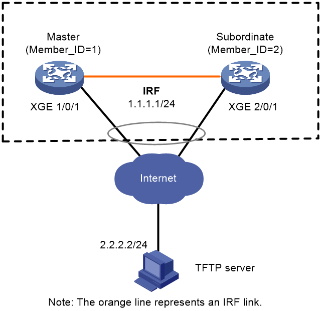

As shown in Figure 1, the two-chassis IRF fabric and the TFTP server can reach each other. Perform a compatible ISSU on the IRF to upgrade startup images from R7150 to R7585P05.
Figure 1 Network diagram

Example: Performing an incompatible ISSU
As shown in Figure 2, the two-chassis IRF fabric and the TFTP server can reach each other. Perform an incompatible ISSU on the IRF to upgrade startup images from R7150 to R7585P05.
Figure 2 Network diagram
Procedures
