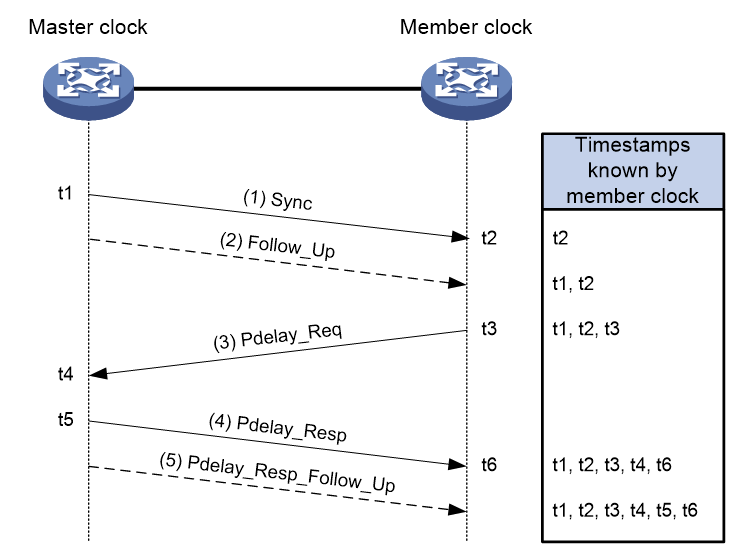

Figure 3 Operation procedure of the Peer Delay mechanism
The Peer Delay mechanism uses Pdelay messages to calculate link delay, which applies only to point-to-point delay measurement. Figure 3 shows an example of the Peer Delay mechanism by using the two-step mode.
1.     The master clock sends a Sync message to the member clock, and records the sending time t1. Upon receiving the message, the member clock records the receiving time t2.
2.     After sending the Sync message, the master clock immediately sends a Follow_Up message that carries time t1.
3.     The member clock sends a Pdelay_Req message to calculate the transmission delay in the reverse direction, and records the sending time t3. Upon receiving the message, the master clock records the receiving time t4.
4.     The master clock returns a Pdelay_Resp message that carries time t4, and records the sending time t5. Upon receiving the message, the member clock records the receiving time t6.
5.     After sending the Pdelay_Resp message, the master clock immediately sends a Pdelay_Resp_Follow_Up message that carries time t5.
After this procedure, the member clock collects all six timestamps and obtains the round-trip delay to the master clock by using the following calculation:

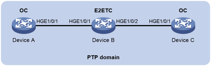

Example: Configuring PTP configuration (IEEE 1588 version 2, IEEE 802.3/Ethernet encapsulation)
As shown in Figure 4, a PTP domain contains Device A, Device B, and Device C.
·     Configure all devices to use the IEEE 1588 version 2 PTP profile.
·     Configure PTP messages to be encapsulated in IEEE 802.3/Ethernet packets.
·     Specify the OC clock node type for Device A and Device C, and E2ETC clock node type for Device B. All clock nodes elect a GM through BMC based on their respective default GM attributes.
Figure 4 Network diagram
1.     Configure Device A:
# Specify the IEEE 1588 version 2 PTP profile.
<DeviceA> system-view
[DeviceA] ptp profile 1588v2
# Specify the OC clock node type.
[DeviceA] ptp mode oc
# Specify PTP for obtaining the time.
[DeviceA] clock protocol ptp
# Enable PTP on HundredGigE 1/0/1.
[DeviceA] interface hundredgige 1/0/1
[DeviceA-HundredGigE1/0/1] ptp enable
[DeviceA-HundredGigE1/0/1] quit
2.     Configure Device B:
<DeviceB> system-view
[DeviceB] ptp profile 1588v2
# Specify the E2ETC clock node type.
[DeviceB] ptp mode e2etc
[DeviceB] clock protocol ptp
[DeviceB] interface hundredgige 1/0/1
[DeviceB-HundredGigE1/0/1] ptp enable
[DeviceB-HundredGigE1/0/1] quit
# Enable PTP on HundredGigE 1/0/2.
[DeviceB] interface hundredgige 1/0/2
[DeviceB-HundredGigE1/0/2] ptp enable
[DeviceB-HundredGigE1/0/2] quit
3.     Configure Device C:
<DeviceC> system-view
[DeviceC] ptp profile 1588v2
[DeviceC] ptp mode oc
[DeviceC] clock protocol ptp
[DeviceC] interface hundredgige 1/0/1
[DeviceC-HundredGigE1/0/1] ptp enable
[DeviceC-HundredGigE1/0/1] quit
When the network is stable, perform the following tasks to verify that Device A is elected as the GM, HundredGigE1/0/1 on Device A is the master port, and Device B has synchronized to Device A:
·     Use the display ptp clock command to display PTP clock information.
·     Use the display ptp interface brief command to display brief PTP statistics on an interface.
# Display PTP clock information on Device A.
[DeviceA] display ptp clock
PTP profile         : IEEE 1588 Version 2

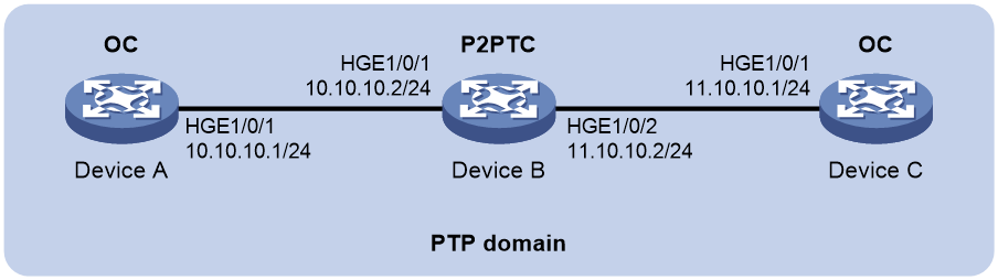

Example: Configuring PTP (IEEE 1588 version 2, multicast transmission)
As shown in Figure 5, a PTP domain contains Device A, Device B, and Device C.
·     Configure the source IP address for multicast PTP message transmission over UDP.
·     Specify the OC clock node type for Device A and Device C, and the P2PTC clock node type for Device B. All clock nodes elect a GM through BMC based on their respective default GM attributes.
·     Configure the peer delay measurement mechanism (p2p) for Device A and Device C.
Figure 5 Network diagram
# Configure the source IP address for multicast PTP message transmission over UDP.
[DeviceA] ptp source 10.10.10.1
# On HundredGigE 1/0/1, specify the PTP transport protocol as UDP, specify the delay measurement mechanism as p2p, and enable PTP.
[DeviceA-HundredGigE1/0/1] ptp transport-protocol udp [DeviceA-HundredGigE1/0/1] ptp delay-mechanism p2p
# Specify the P2PTC clock node type.
[DeviceB] ptp mode p2ptc
[DeviceB] ptp source 10.10.10.2
# On HundredGigE 1/0/1, specify the PTP transport protocol as UDP and enable PTP.
DeviceB-HundredGigE1/0/1] ptp transport-protocol udp
# On HundredGigE 1/0/2, specify the PTP transport protocol as UDP and enable PTP.
[DeviceB-HundredGigE1/0/2] ptp transport-protocol udp
[DeviceC] ptp source 11.10.10.1
[DeviceC-HundredGigE1/0/1] ptp transport-protocol udp [DeviceC-HundredGigE1/0/1] ptp delay-mechanism p2p

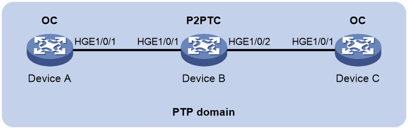

Example: Configuring PTP (IEEE 802.1AS)
As shown in Figure 6, a PTP domain contains Device A, Device B, and Device C.
·     Configure all devices to use the IEEE 802.1AS PTP profile.
Figure 6 Network diagram
# Specify the IEEE 802.1AS PTP profile.
[DeviceA] ptp profile 802.1AS
[DeviceB] ptp profile 802.1AS

Example: Configuring PTP (SMPTE ST 2059-2, multicast transmission)
As shown in Figure 7, Device A, Device B, and Device C are in a PTP domain. Configure PTP (SMPTE ST 2059-2, multicast transmission) on the three devices as follows for time synchronization:
·     Configure the devices to use the SMPTE ST 2059-2 PTP profile.
Figure 7 Network diagram
# Specify the SMPTE ST 2059-2 PTP profile.
[DeviceA] ptp profile st2059-2
# On HundredGigE 1/0/1, specify the delay measurement mechanism as p2p and enable PTP.
[DeviceB] ptp profile st2059-2
# On HundredGigE 1/0/1, enable PTP.
# On HundredGigE 1/0/2, enable PTP.
[DeviceC] ptp profile st2059-2
When the network is stable, perform the following tasks to verify the PTP configuration:
PTP profile         : SMPTE ST 2059-2
PTP mode            : OC
Slave only          : No
Clock ID            : 000FE2-FFFE-FF0000
Clock type          : Local
Clock domain        : 0
Number of PTP ports : 1
Priority1     : 128
Priority2     : 128
Clock quality :
 Class                 : 248
 Accuracy              : 254
 Offset (log variance) : 65535
Offset from master : 0 (ns)
Mean path delay    : 0 (ns)
Steps removed      : 0
Local clock time   : Sun Jan 15 20:57:29 2011
# Display brief PTP statistics on Device A.
[DeviceA] display ptp interface brief
Name         State         Delay mechanism  Clock step  Asymmetry correction
GE1/0/1      Master        P2P              Two         0
# Display PTP clock information on Device B.
[DeviceB] display ptp clock
PTP mode            : P2PTC
Slave only          : No
Clock ID            : 000FE2-FFFE-FF0001
Clock type          : Local
Clock domain        : 0
Number of PTP ports : 2
Priority1     : 128
Priority2     : 128
Clock quality :
 Class                 : 248
 Accuracy              : 254
Offset from master : N/A
Mean path delay    : N/A
Steps removed      : N/A
# Display brief PTP statistics on Device B.
[DeviceB] display ptp interface brief
GE1/0/1      N/A           P2P              Two         0
GE1/0/2      N/A           P2P              Two         0
The output shows that Device A is elected as the GM and HundredGigE1/0/1 on Device A is the master port.
