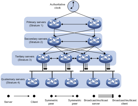

NTP architecture
NTP uses stratums 1 to 16 to define clock accuracy, as shown in Figure 2. A lower stratum value represents higher accuracy. Clocks at stratums 1 through 15 are in synchronized state, and clocks at stratum 16 are not synchronized.
Figure 2 NTP architecture
A stratum 1 NTP server gets its time from an authoritative time source, such as an atomic clock. It provides time for other devices as the primary NTP server. A stratum 2 time server receives its time from a stratum 1 time server, and so on.
To ensure time accuracy and availability, you can specify multiple NTP servers for a device. The device selects an optimal NTP server as the clock source based on parameters such as stratum. The clock that the device selects is called the reference source. For more information about clock selection, see the related protocols and standards.
If the devices in a network cannot synchronize to an authoritative time source, you can perform the following tasks:
·           Select a device that has a relatively accurate clock from the network.
·           Use the local clock of the device as the reference clock to synchronize other devices in the network.
Association modes

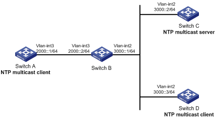

IPv6 NTP multicast mode configuration example
Network requirements
As shown in Figure 11, Switch C functions as the NTP server for multiple devices on different network segments and synchronizes the time among multiple devices.
·           Configure Switch C's local clock as a reference source, with stratum level 2.
·           Configure Switch C to operate in IPv6 multicast server mode and send IPv6 multicast messages from VLAN-interface 2.
·           Configure Switch A and Switch D to operate in IPv6 multicast client mode and receive IPv6 multicast messages through VLAN-interface 3 and VLAN-interface 2, respectively.
Figure 11 Network diagram
Configuration procedure
1.      Assign an IP address to each interface, and make sure the switches can reach each other, as shown in Figure 11. (Details not shown.)
2.      Configure Switch C:
# Enable the NTP service.
<SwitchC> system-view
[SwitchC] ntp-service enable
# Specify the local clock as the reference source, with stratum level 2.
[SwitchC] ntp-service refclock-master 2
# Configure Switch C to operate in IPv6 multicast server mode and send multicast messages through VLAN-interface 2.
[SwitchC] interface vlan-interface 2
[SwitchC-Vlan-interface2] ntp-service ipv6 multicast-server ff24::1
3.      Configure Switch D:
<SwitchD> system-view
[SwitchD] ntp-service enable
# Configure Switch D to operate in IPv6 multicast client mode and receive multicast messages on VLAN-interface 2.
[SwitchD] interface vlan-interface 2
[SwitchD-Vlan-interface2] ntp-service ipv6 multicast-client ff24::1
4.      Verify the configuration:
Switch D and Switch C are on the same subnet, so Switch D can do the following:
¡  Receive the IPv6 multicast messages from Switch C without being enabled with the IPv6 multicast functions.
¡  Synchronize to Switch C.
# Verify that Switch D has synchronized to Switch C, and the clock stratum level is 3 on Switch D and 2 on Switch C.
[SwitchD-Vlan-interface2] display ntp-service status
 Clock status: synchronized
 Clock stratum: 3
 System peer: 3000::2
 Local mode: bclient
 Reference clock ID: 165.84.121.65
 Leap indicator: 00
 Clock jitter: 0.000977 s
 Stability: 0.000 pps
 Clock precision: 2^-18
 Root delay: 0.00000 ms
 Root dispersion: 8.00578 ms
 Reference time: d0c60680.9754fb17  Wed, Dec 29 2010 19:12:00.591
 System poll interval: 64 s
# Verify that an IPv6 NTP association has been established between Switch D and Switch C.
[SwitchD-Vlan-interface2] display ntp-service ipv6 sessions
Notes: 1 source(master), 2 source(peer), 3 selected, 4 candidate, 5 configured.
 Source:  [1234]3000::2
 Reference: 127.127.1.0           Clock stratum: 2
 Reachabilities: 111              Poll interval: 64
 Last receive time: 23            Offset: -0.0
 Roundtrip delay: 0.0             Dispersion: 0.0
 Total sessions: 1
5.      Configure Switch B:
Because Switch A and Switch C are on different subnets, you must enable the IPv6 multicast functions on Switch B before Switch A can receive IPv6 multicast messages from Switch C.
# Enable IPv6 multicast functions.
<SwitchB> system-view
[SwitchB] ipv6 multicast routing
[SwitchB-mrib6] quit
[SwitchB-Vlan-interface2] ipv6 pim dm
[SwitchB-Vlan-interface2] quit
[SwitchB] vlan 3
[SwitchB-vlan3] port ten-gigabitethernet 1/1/1
[SwitchB-vlan3] quit
[SwitchB] interface vlan-interface 3
[SwitchB-Vlan-interface3] mld enable
[SwitchB-Vlan-interface3] mld static-group ff24::1
[SwitchB-Vlan-interface3] quit
[SwitchB] mld-snooping
[SwitchB-mld-snooping] quit
[SwitchB] interface ten-gigabitethernet 1/1/1
[SwitchB-Ten-GigabitEthernet1/1/1] mld-snooping static-group ff24::1 vlan 3
6.      Configure Switch A:
<SwitchA> system-view
[SwitchA] ntp-service enable
# Configure Switch A to operate in IPv6 multicast client mode and receive IPv6 multicast messages on VLAN-interface 3.
[SwitchA] interface vlan-interface 3
[SwitchA-Vlan-interface3] ntp-service ipv6 multicast-client ff24::1
7.      Verify the configuration:
# Verify that Switch A has synchronized to Switch C, and the clock stratum level is 3 on Switch A and 2 on Switch C.
[SwitchA-Vlan-interface3] display ntp-service status
 Clock stratum: 3
 Local mode: bclient
 Leap indicator: 00
 Clock jitter: 0.165741 s
 Root delay: 0.00534 ms
 Root dispersion: 4.51282 ms
 Reference time: d0c61289.10b1193f  Wed, Dec 29 2010 20:03:21.065
# Verify that an IPv6 NTP association has been established between Switch A and Switch C.
[SwitchA-Vlan-interface3] display ntp-service ipv6 sessions
 Source:   [124]3000::2
 Reachabilities: 2                Poll interval: 64
 Last receive time: 71            Offset: -0.0
 Total sessions: 1
