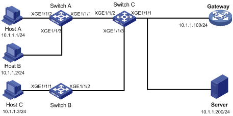

Manual-mode MFF configuration example in a tree network
Network requirements
As shown in Figure 2, all the devices are in VLAN 100. Hosts A, B, and C are assigned IP addresses manually.
Configure MFF to isolate the hosts at Layer 2 and allow them to communicate with each other through the gateway at Layer 3.
Figure 2 Network diagram
Configuration procedure
1.      Configure the IP addresses of the hosts and the gateway, as shown in Figure 2.
2.      Configure Switch A:
# Configure manual-mode MFF on VLAN 100.
[SwitchA] vlan 100
[SwitchA-vlan100] mac-forced-forwarding default-gateway 10.1.1.100
# Specify the IP address of the server.
[SwitchA-vlan100] mac-forced-forwarding server 10.1.1.200
# Enable ARP snooping on VLAN 100.
[SwitchA-vlan100] arp snooping enable
[SwitchA-vlan100] quit
# Configure Ten-GigabitEthernet 1/1/1 as a network port.
[SwitchA] interface ten-gigabitethernet 1/1/1
[SwitchA-Ten-GigabitEthernet1/1/1] mac-forced-forwarding network-port
3.      Configure Switch B:
[SwitchB] vlan 100
[SwitchB-vlan100] mac-forced-forwarding default-gateway 10.1.1.100
[SwitchB-vlan100] mac-forced-forwarding server 10.1.1.200
[SwitchB-vlan100] arp snooping enable
[SwitchB-vlan100] quit
# Configure Ten-GigabitEthernet 1/1/2 as a network port.
[SwitchB] interface ten-gigabitethernet 1/1/2 1/1/6
[SwitchB-Ten-GigabitEthernet1/1/2] mac-forced-forwarding network-port

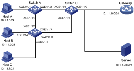

Manual-mode MFF configuration example in a ring network
As shown in Figure 3, all the devices are in VLAN 100, and the switches form a ring. Hosts A, B, and C are assigned IP addresses manually.
Figure 3 Network diagram
1.      Configure the IP addresses of the hosts and the gateway, as in shown in Figure 3.
# Enable STP globally to make sure STP is enabled on interfaces.
[SwitchA] stp global enable
[SwitchA] vlan 100
# Configure Ten-GigabitEthernet 1/1/2 and Ten-GigabitEthernet 1/1/3 as network ports.
[SwitchA] interface ten-gigabitethernet 1/1/2
[SwitchA-Ten-GigabitEthernet1/1/2] mac-forced-forwarding network-port
[SwitchA-Ten-GigabitEthernet1/1/2] quit
[SwitchA] interface ten-gigabitethernet 1/1/3
[SwitchA-Ten-GigabitEthernet1/1/3] mac-forced-forwarding network-port
[SwitchB] stp global enable
[SwitchB] vlan 100
# Configure Ten-GigabitEthernet 1/1/1 and Ten-GigabitEthernet 1/1/3 as network ports.
[SwitchB] interface ten-gigabitethernet 1/1/1
[SwitchB-Ten-GigabitEthernet1/1/1] mac-forced-forwarding network-port
[SwitchB-Ten-GigabitEthernet1/1/1] quit
[SwitchB] interface ten-gigabitethernet 1/1/3
[SwitchB-Ten-GigabitEthernet1/1/3] mac-forced-forwarding network-port
4.      Enable STP on Switch C globally to make sure STP is enabled on interfaces.
<SwitchC> system-view
[SwitchC] stp global enable
