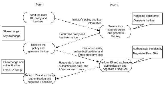

IKE negotiates keys and SAs for IPsec in two phases:
1.      Phase 1—The two peers establish an IKE SA, a secure, authenticated channel for communication. In this phase, two modes are available: main mode and aggressive mode.
2.      Phase 2—Using the IKE SA established in phase 1, the two peers negotiate to establish IPsec SAs.
Figure 7 IKE exchange process in main mode
As shown in Figure 7, the main mode of IKE negotiation in phase 1 involves three pairs of messages:
·           SA exchange—Used for negotiating the IKE security policy.
·           Key exchange—Used for exchanging the DH public value and other values, such as the random number. The two peers use the exchanged data to generate key data and use the encryption key and authentication key to ensure the security of IP packets.
·           ID and authentication data exchange—Used for identity authentication.
The main difference between the main mode and the aggressive mode is that the aggressive mode does not provide identity information protection and exchanges only three messages, rather than three pairs. The main mode provides identity information protection but is slower.

IKEv2 negotiation process
Compared with IKEv1, IKEv2 simplifies the negotiation process and is much more efficient.
IKEv2 defines three types of exchanges: initial exchanges, CREATE_CHILD_SA exchange, and INFORMATIONAL exchange.
As shown in Figure 10, IKEv2 uses two exchanges during the initial exchange process: IKE_SA_INIT and IKE_AUTH, each with two messages.
·           IKE_SA_INIT exchange—Negotiates IKE SA parameters and exchanges keys.
·           IKE_AUTH exchange—Authenticates the identity of the peer and establishes IPsec SAs.
After the four-message initial exchanges, IKEv2 sets up one IKE SA and one pair of IPsec SAs. For IKEv1 to set up one IKE SA and one pair of IPsec SAs, it must go through two phases that use a minimum of six messages.
To set up one more pair of IPsec SAs within the IKE SA, IKEv2 goes on to perform an additional two-message exchange—the CREATE_CHILD_SA exchange. One CREATE_CHILD_SA exchange creates one pair of IPsec SAs. IKEv2 also uses the CREATE_CHILD_SA exchange to rekey IKE SAs and Child SAs.
IKEv2 uses the INFORMATIONAL exchange to convey control messages about errors and notifications.
Figure 10 IKEv2 Initial exchange process
