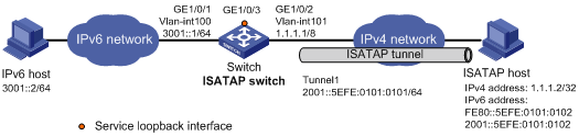

ISATAP tunneling
ISATAP address. The address format is prefix:0:5EFE:abcd:efgh/64.
·          The 64-bit prefix is a valid IPv6 unicast address prefix.
·          The abcd:efgh/64 segments represent a 32-bit IPv4 address, which identifies the tunnel destination but does not require global uniqueness.

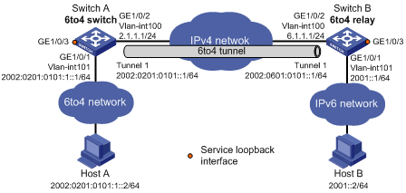

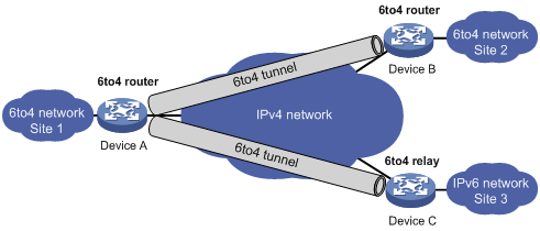

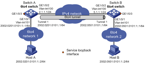

·           6to4 tunneling
¡  Ordinary 6to4 tunneling—A point-to-multipoint automatic tunnel. It is used to connect multiple isolated IPv6 networks over an IPv4 network.
¡  6to4 relay—Connects a 6to4 network and an IPv6 network that uses an IP prefix other than 2002::/16. A 6to4 relay router is a gateway that forwards packets from a 6to4 network to an IPv6 network.
As shown in Figure 2, 6to4 network Site 1 communicates with IPv6 network Site 3 over a 6to4 tunnel. Configure a static route on the border router (Device A) in the 6to4 network. The next hop address must be the 6to4 address of the 6to4 relay router (Device C). Device A forwards all packets destined for the IPv6 network over the 6to4 tunnel, and Device C then forwards them to the IPv6 network.
Figure 2 Principle of 6to4 tunneling and 6to4 relay
·           ISATAP tunneling—A point-to-multipoint automatic tunnel. It provides a solution to connect an IPv6 host and an IPv6 network over an IPv4 network. ISATAP tunnels are mainly used for communication between IPv6 routers or between an IPv6 host and an IPv6 router over an IPv4 network.
Figure 3 Principle of ISATAP tunneling

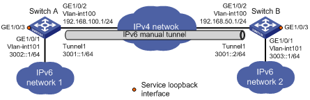

Configuring an IPv6 over IPv4 manual tunnel
Follow these guidelines when you configure an IPv6 over IPv4 manual tunnel:
·           The tunnel destination address specified on the local device must be identical with the tunnel source address specified on the tunnel peer device.
·           Do not specify the same tunnel source and destination addresses for the tunnel interfaces in the same mode on a device.
·           To ensure correct packet forwarding, identify whether the destination IPv6 network and the IPv6 address of the local tunnel interface are on the same subnet. If they are not, configure a route reaching the destination IPv6 network through the tunnel interface. You can configure the route by using one of the following methods:
¡  Configure a static route, and specify the local tunnel interface as the egress interface or specify the IPv6 address of the peer tunnel interface as the next hop.
¡  Enable a dynamic routing protocol on both tunnel interfaces to achieve the same purpose.
For more information about route configuration, see Layer 3—IP Routing Configuration Guide.

Configuration example
Network requirements
As shown in Figure 4, configure an IPv6 over IPv4 tunnel between Switch A and Switch B so the two IPv6 networks can reach each other over the IPv4 network. Because the tunnel destination IPv4 address cannot be automatically obtained from the destination IPv6 addresses, configure an IPv6 over IPv4 manual tunnel.
Figure 4 Network diagram
Configuration procedure
Make sure Switch A and Switch B have the corresponding VLAN interfaces created and can reach each other through IPv4.
·           Configure Switch A:
# Add GigabitEthernet 1/0/2 (the physical interface of the tunnel) to VLAN 100.
<SwitchA> system-view
[SwitchA] vlan 100
[SwitchA-vlan100] port gigabitethernet 1/0/2
[SwitchA-vlan100] quit
# Specify an IPv4 address for VLAN-interface 100.
[SwitchA-Vlan-interface100] ip address 192.168.100.1 255.255.255.0
# Add GigabitEthernet 1/0/1 to VLAN 101.
[SwitchA] vlan 101
[SwitchA-vlan101] port gigabitethernet 1/0/1
[SwitchA-vlan101] quit
# Specify an IPv6 address for VLAN-interface 101.
[SwitchA] interface vlan-interface 101
[SwitchA-Vlan-interface101] ipv6 address 3002::1 64
[SwitchA-Vlan-interface101] quit
# Create service loopback group 1, and specify its service type as tunnel.
[SwitchA] service-loopback group 1 type tunnel
# Add GigabitEthernet 1/0/3 to service loopback group 1.
[SwitchA] interface gigabitethernet 1/0/3
[SwitchA-GigabitEthernet1/0/3] port service-loopback group 1
[SwitchA-GigabitEthernet1/0/3] quit
# Create IPv6 over IPv4 manual tunnel interface Tunnel 1.
[SwitchA] interface tunnel 1 mode ipv6-ipv4
# Specify an IPv6 address for the tunnel interface.
[SwitchA-Tunnel1] ipv6 address 3001::1/64
# Specify VLAN-interface 100 as the source interface of the tunnel interface.
[SwitchA-Tunnel1] source vlan-interface 100
# Specify the destination address for the tunnel interface as the IP address of the VLAN-interface 100 on Switch B.
[SwitchA-Tunnel1] destination 192.168.50.1
[SwitchA-Tunnel1] quit
# Configure a static route destined for IPv6 network 2 through tunnel 1.
[SwitchA] ipv6 route-static 3003:: 64 tunnel 1
·           Configure Switch B:
<SwitchB> system-view
[SwitchB] vlan 100
[SwitchB-vlan100] port gigabitethernet 1/0/2
[SwitchB-vlan100] quit
[SwitchB-Vlan-interface100] ip address 192.168.50.1 255.255.255.0
[SwitchB] vlan 101
[SwitchB-vlan101] port gigabitethernet 1/0/1
[SwitchB-vlan101] quit
[SwitchB] interface vlan-interface 101
[SwitchB-Vlan-interface101] ipv6 address 3003::1 64
[SwitchB-Vlan-interface101] quit
[SwitchB] service-loopback group 1 type tunnel
[SwitchB] interface gigabitethernet 1/0/3
[SwitchB-GigabitEthernet1/0/3] port service-loopback group 1
[SwitchB-GigabitEthernet1/0/3] quit
[SwitchB] interface tunnel 1 mode ipv6-ipv4
[SwitchB-Tunnel1] ipv6 address 3001::2/64
[SwitchB-Tunnel1] source vlan-interface 100
# Specify the destination address for the tunnel interface as the IP address of VLAN-interface 100 of Switch A.
[SwitchB-Tunnel1] destination 192.168.100.1
[SwitchB-Tunnel1] quit
# Configure a static route destined for IPv6 network 1 through tunnel 1.
[SwitchB] ipv6 route-static 3002:: 64 tunnel 1
# Use the display ipv6 interface command to display tunnel interface status on Switch A and Switch B. Verify that the interface tunnel 1 is up. (Details not shown.)
# Verify that Switch B and Switch A can ping the IPv6 address of VLAN-interface 101 of each other. This example uses Switch A.
[SwitchA] ping ipv6 3003::1
Ping6(56 data bytes) 3001::1 --> 3003::1, press CTRL_C to break
56 bytes from 3003::1, icmp_seq=0 hlim=64 time=45.000 ms
56 bytes from 3003::1, icmp_seq=1 hlim=64 time=10.000 ms
56 bytes from 3003::1, icmp_seq=2 hlim=64 time=4.000 ms
56 bytes from 3003::1, icmp_seq=3 hlim=64 time=10.000 ms
56 bytes from 3003::1, icmp_seq=4 hlim=64 time=11.000 ms
--- Ping6 statistics for 3003::1 ---
round-trip min/avg/max/std-dev = 4.000/16.000/45.000/14.711 ms
Configuring a 6to4 tunnel

6to4 tunnel configuration example
As shown in Figure 5, configure a 6to4 tunnel between 6to4 switches Switch A and Switch B so the two hosts can reach each other over the IPv4 network.
Figure 5 Network diagram
Requirements analysis
To enable communication between 6to4 networks, configure 6to4 addresses for 6to4 switches and hosts in the 6to4 networks.
·           The IPv4 address of VLAN-interface 100 on Switch A is 2.1.1.1/24, and the corresponding 6to4 prefix is 2002:0201:0101::/48. Host A must use this prefix.
·           The IPv4 address of VLAN-interface 100 on Switch B is 5.1.1.1/24, and the corresponding 6to4 prefix is 2002:0501:0101::/48. Host B must use this prefix.
[SwitchA] vlan 100
[SwitchA-Vlan-interface100] ip address 2.1.1.1 24
[SwitchA] vlan 101
# Specify a 6to4 address for VLAN-interface 101.
[SwitchA-Vlan-interface101] ipv6 address 2002:0201:0101:1::1/64
# Assign GigabitEthernet 1/0/3 to service loopback group 1.
# Create 6to4 tunnel interface Tunnel 1.
[SwitchA] interface tunnel 1 mode ipv6-ipv4 6to4
[SwitchA-Tunnel1] ipv6 address 2002:0201:0101::1/64
# Specify the source interface as VLAN-interface 100 for the tunnel interface.
# Configure a static route destined for 2002::/16 through the tunnel interface.
[SwitchA] ipv6 route-static 2002:: 16 tunnel 1
[SwitchB] vlan 100
[SwitchB-Vlan-interface100] ip address 5.1.1.1 24
[SwitchB] vlan 101
[SwitchB-Vlan-interface101] ipv6 address 2002:0501:0101:1::1/64
[SwitchB] interface tunnel 1 mode ipv6-ipv4 6to4
[SwitchB-Tunnel1] ipv6 address 2002:0501:0101::1/64
[SwitchB] ipv6 route-static 2002:: 16 tunnel 1
# Verify that the Linux-running hosts Host A and Host B can ping each other.
D:\>ping6 -s 2002:201:101:1::2 2002:501:101:1::2
Pinging 2002:501:101:1::2
from 2002:201:101:1::2 with 32 bytes of data:
Reply from 2002:501:101:1::2: bytes=32 time=13ms
Reply from 2002:501:101:1::2: bytes=32 time=1ms
Reply from 2002:501:101:1::2: bytes=32 time<1ms
Ping statistics for 2002:501:101:1::2:
    Minimum = 0ms, Maximum = 13ms, Average = 3ms
6to4 relay configuration example
As shown in Figure 6, Switch A is a 6to4 switch, and 6to4 addresses are used on the connected IPv6 network. Switch B acts as a 6to4 relay switch and is connected to the IPv6 network (2001::/16). Configure a 6to4 tunnel between Switch A and Switch B to make Host A and Host B reachable to each other.
The configuration on a 6to4 relay switch is similar to that on a 6to4 switch. To enable communication between the 6to4 network and the IPv6 network, configure a route destined for the IPv6 network on the 6to4 switch. The IPv4 address of VLAN-interface 100 on the relay switch is 6.1.1.1/24 and its corresponding 6to4 prefix is 2002:0601:0101::/48. The next hop of the static route must be an address using this prefix.
Figure 6 Network diagram
[SwitchA] vlan 100
[SwitchA-Vlan-interface100] ip address 2.1.1.1 255.255.255.0
[SwitchA] vlan 101
# Configure a static route destined for the 6to4 relay switch.
[SwitchA] ipv6 route-static 2002:0601:0101:: 64 tunnel 1
# Configure a default route to reach the IPv6 network, which specifies the 6to4 address of the 6to4 relay switch as the next hop.
[SwitchA] ipv6 route-static :: 0 2002:0601:0101::1
[SwitchB] vlan 100
[SwitchB-Vlan-interface100] ip address 6.1.1.1 255.255.255.0
[SwitchB] vlan 101
[SwitchB-Vlan-interface101] ipv6 address 2001::1/16
[SwitchB-Tunnel1] ipv6 address 2002:0601:0101::1/64
As shown in Figure 7, configure an ISATAP tunnel between the switch and the ISATAP host so the ISATAP host in the IPv4 network can access the IPv6 network.
Figure 7 Network diagram
·           Configure the switch:

# Create ISATAP tunnel interface Tunnel 1.
[Switch] interface tunnel 1 mode ipv6-ipv4 isatap
# Specify an EUI-64 IPv6 address for the tunnel interface.
[Switch-Tunnel1] ipv6 address 2001:: 64 eui-64
# Specify VLAN-interface 101 as the source interface of the tunnel interface.
[Switch-Tunnel1] source vlan-interface 101
# Disable RA message suppression so that the ISATAP host can acquire information such as the address prefix from the RA message advertised by the ISATAP switch.
[Switch-Tunnel1] undo ipv6 nd ra halt
[Switch-Tunnel1] quit

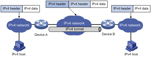

IPv4 over IPv4 tunneling
Overview
IPv4 over IPv4 tunneling (RFC 1853) enables isolated IPv4 networks to communicate. For example, an IPv4 over IPv4 tunnel can connect isolated private IPv4 networks over a public IPv4 network.
Figure 8 IPv4 over IPv4 tunnel
Figure 8 shows the encapsulation and de-encapsulation processes.
·           Encapsulation:
a.    Device A receives an IP packet from an IPv4 host and submits it to the IP protocol stack.
b.    The IPv4 protocol stack determines how to forward the packet according to the destination address in the IP header. If the packet is destined for the IPv4 host connected to Device B, Device A delivers the packet to the tunnel interface.
c.    The tunnel interface adds a new IPv4 header to the IPv4 packet and submits it to the IP protocol stack.
In the new header, the source IP address specifies the tunnel source, and the destination IP address specifies the tunnel destination.
d.    The IP protocol stack uses the destination IP address of the new IP header to look up the routing table, and then sends the packet out.
·           De-encapsulation:
a.    After receiving the packet, Device B delivers it to the IP protocol stack.
b.    If the protocol number is 4 (indicating an IPv4 packet is encapsulated within the packet), the IP protocol stack delivers the packet to the tunnel module for de-encapsulation.
c.    The tunnel module de-encapsulates the IP packet and sends it back to the IP protocol stack.
d.    The protocol stack forwards the de-encapsulated packet.
Configuring an IPv4 over IPv4 tunnel
Follow these guidelines when you configure an IPv4 over IPv4 tunnel:
·           Do not specify the same source and destination addresses for local tunnel interfaces in the same tunnel mode.
·           The IPv4 address of the local tunnel interface cannot be on the same subnet as the destination address configured on the tunnel interface.
·           To ensure correct packet forwarding, identify whether the destination IPv4 network and the IPv4 address of the local tunnel interface are on the same subnet. If they are not, configure a route reaching the destination IPv4 network through the tunnel interface. You can configure the route by using one of the following methods:
¡  Configure a static route, and specify the local tunnel interface as the egress interface or specify the IPv4 address of the peer tunnel interface as the next hop.

To configure an IPv4 over IPv4 tunnel:
Step
Remarks
1.      Enter system view.
N/A
2.      Enter IPv4 over IPv4 tunnel interface view.
interface tunnel number [ mode ipv4-ipv4 ]
N/A
3.      Configure an IPv4 address for the tunnel interface.
ip address ip-address { mask | mask-length } [ sub ]
By default, no IPv4 address is configured for the tunnel interface.
4.      Configure a source address or source interface for the tunnel interface.
source { ipv4-address | interface-type interface-number }
By default, no source address or source interface is configured for the tunnel interface.
If you specify a source address, it is used as the source IP address of tunneled packets.
If you specify a source interface, the primary IP address of this interface is used as the source IP address of tunneled packets.
5.      Configure a destination address for the tunnel interface.
destination ipv4-address
By default, no destination address is configured for the tunnel interface.
The tunnel destination address must be the IP address of the receiving interface on the tunnel peer. It is used as the destination IP address of tunneled packets.
6.      (Optional.) Set the DF bit for tunneled packets.
tunnel dfbit enable
By default, the DF bit is not set for tunneled packets.

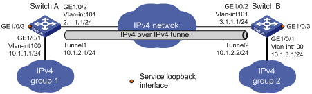

As shown in Figure 9, the two subnets IPv4 group 1 and IPv4 group 2 use private IPv4 addresses. Configure an IPv4 over IPv4 tunnel between Switch A and Switch B to make the two subnets reachable to each other.
Figure 9 Network diagram
# Add GigabitEthernet 1/0/1 to VLAN 100.
[SwitchA] vlan 100
[SwitchA-vlan100] port gigabitethernet 1/0/1
[SwitchA-Vlan-interface100] ip address 10.1.1.1 255.255.255.0
# Add GigabitEthernet 1/0/2 (the physical interface of the tunnel) to VLAN 101.
[SwitchA] vlan 101
[SwitchA-vlan101] port gigabitethernet 1/0/2
# Specify an IPv4 address for VLAN-interface 101.
[SwitchA-Vlan-interface101] ip address 2.1.1.1 255.255.255.0
# Create IPv4 over IPv4 tunnel interface Tunnel 1.
[SwitchA] interface tunnel 1 mode ipv4-ipv4
# Specify an IPv4 address for the tunnel interface.
[SwitchA-Tunnel1] ip address 10.1.2.1 255.255.255.0
# Specify the IP address of VLAN-interface 101 as the source address for the tunnel interface.
[SwitchA-Tunnel1] source 2.1.1.1
# Specify the IP address of VLAN-interface 101 on Switch B as the destination address for the tunnel interface.
[SwitchA-Tunnel1] destination 3.1.1.1
# Configure a static route destined for IPv4 group 2 through the tunnel interface.
[SwitchA] ip route-static 10.1.3.0 255.255.255.0 tunnel 1
[SwitchB] vlan 100
[SwitchB-vlan100] port gigabitethernet 1/0/1
[SwitchB-Vlan-interface100] ip address 10.1.3.1 255.255.255.0
[SwitchB] vlan 101
[SwitchB-vlan101] port gigabitethernet 1/0/2
[SwitchB-Vlan-interface101] ip address 3.1.1.1 255.255.255.0
# Create IPv4 over IPv4 tunnel interface Tunnel 2.
[SwitchB] interface tunnel 2 mode ipv4-ipv4
[SwitchB-Tunnel2] ip address 10.1.2.2 255.255.255.0
[SwitchB-Tunnel2] source 3.1.1.1
# Specify the IP address of VLAN-interface 101 on Switch A as the destination address for the tunnel interface.
[SwitchB-Tunnel2] destination 2.1.1.1
[SwitchB-Tunnel2] quit
# Configure a static route destined for IPv4 group 1 through the tunnel interface.
[SwitchB] ip route-static 10.1.1.0 255.255.255.0 tunnel 2
# Use the display interface tunnel command to display the status of the tunnel interfaces on Switch A and Switch B. Verify that the tunnel interfaces are up. (Details not shown.)
# Verify that Switch A and Switch B can ping the IPv4 address of the peer interface VLAN-interface 100. This example uses Switch A.
[SwitchA] ping -a 10.1.1.1 10.1.3.1
Ping 10.1.3.1 (10.1.3.1) from 10.1.1.1: 56 data bytes, press CTRL_C to break
56 bytes from 10.1.3.1: icmp_seq=0 ttl=255 time=2.000 ms
56 bytes from 10.1.3.1: icmp_seq=1 ttl=255 time=1.000 ms
56 bytes from 10.1.3.1: icmp_seq=2 ttl=255 time=0.000 ms

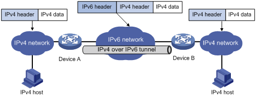

IPv4 over IPv6 tunneling
Overview
Implementation
IPv4 over IPv6 tunneling adds an IPv6 header to IPv4 packets so that the IPv4 packets can pass an IPv6 network through a tunnel to realize interworking between isolated IPv4 networks.
Figure 10 IPv4 over IPv6 tunnel
Figure 10 shows the encapsulation and de-encapsulation processes.
·           Encapsulation:
a.    Upon receiving an IPv4 packet, Device A delivers it to the IPv4 protocol stack.
b.    The IPv4 protocol stack uses the destination address of the packet to determine the egress interface. If the egress interface is the tunnel interface, the IPv4 protocol stack delivers the packet to the tunnel interface.
c.    The tunnel interface adds an IPv6 header to the original IPv4 packet and delivers the packet to the IPv6 protocol stack.
d.    The IPv6 protocol stack uses the destination IPv6 address of the packet to look up the routing table, and then sends it out.
·           De-encapsulation:
a.    Upon receiving the IPv6 packet from the attached IPv6 network, Device B delivers the packet to the IPv6 protocol stack to examine the protocol type encapsulated in the data portion of the packet.
b.    If the protocol type is IPv4, the IPv6 protocol stack delivers the packet to the tunneling module.
c.    The tunneling module removes the IPv6 header and delivers the remaining IPv4 packet to the IPv4 protocol stack.
d.    The IPv4 protocol stack forwards the IPv4 packet.

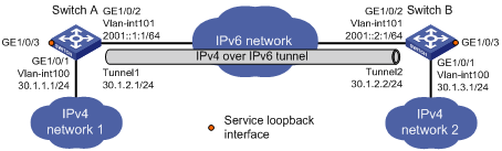

As shown in Figure 11, configure an IPv4 over IPv6 manual tunnel between Switch A and Switch B so the two networks can reach each other over the IPv6 network.
Figure 11 Network diagram

Make sure Switch A and Switch B have the corresponding VLAN interfaces created and can reach each other through IPv6.
[SwitchA] vlan 100
[SwitchA-Vlan-interface100] ip address 30.1.1.1 255.255.255.0
[SwitchA] vlan 101
[SwitchA-Vlan-interface101] ipv6 address 2001::1:1 64
# Create IPv6 tunnel interface Tunnel 1.
[SwitchA-Tunnel1] ip address 30.1.2.1 255.255.255.0
[SwitchA-Tunnel1] source 2001::1:1
[SwitchA-Tunnel1] destination 2001::2:1
# Configure a static route destined for IPv4 network 2 through the tunnel interface.
[SwitchA] ip route-static 30.1.3.0 255.255.255.0 tunnel 1

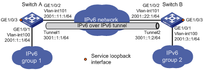

As shown in Figure 13, configure an IPv6 over IPv6 tunnel between Switch A and Switch B so the two networks can reach each other without disclosing their IPv6 addresses.
Figure 13 Network diagram
[SwitchA] vlan 100
# Specify an IPv6 address for VLAN-interface 100.
[SwitchA-Vlan-interface100] ipv6 address 2001:1::1 64
[SwitchA] vlan 101
[SwitchA-Vlan-interface101] ipv6 address 2001::11:1 64
[SwitchA-Tunnel1] ipv6 address 3001::1:1 64
[SwitchA-Tunnel1] source 2001::11:1
[SwitchA-Tunnel1] destination 2001::22:1
# Configure a static route destined for the IPv6 network group 2 through the tunnel interface.
[SwitchA] ipv6 route-static 2001:3:: 64 tunnel 1

[SwitchB-Tunnel2] ipv6 address 3001::1:2 64
[SwitchB-Tunnel2] source 2001::22:1
[SwitchB-Tunnel2] destination 2001::11:1
# Configure a static route destined for the IPv6 network group 1 through the tunnel interface.
[SwitchB] ipv6 route-static 2001:1:: 64 tunnel 2
# Use the display ipv6 interface command to display the status of the tunnel interfaces on Switch A and Switch B. Verify that the tunnel interfaces are up. (Details not shown.)
# Verify that Switch A and Switch B can ping the IPv4 address of the peer interface. This example uses Switch A.
[SwitchA] ping ipv6 -a 2001:1::1 2001:3::1
Ping6(56 data bytes) 2001:1::1 --> 2001:3::1, press CTRL_C to break
56 bytes from 2001:3::1, icmp_seq=0 hlim=64 time=9.000 ms
56 bytes from 2001:3::1, icmp_seq=1 hlim=64 time=1.000 ms
56 bytes from 2001:3::1, icmp_seq=2 hlim=64 time=0.000 ms
56 bytes from 2001:3::1, icmp_seq=3 hlim=64 time=0.000 ms
56 bytes from 2001:3::1, icmp_seq=4 hlim=64 time=0.000 ms
--- Ping6 statistics for 2001:3::1 ---
round-trip min/avg/max/std-dev = 0.000/2.000/9.000/3.521 ms
