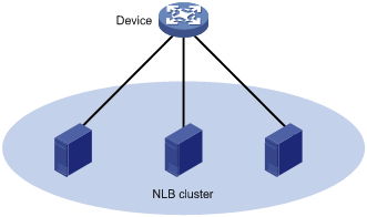

You can configure a multiport unicast MAC address entry to associate a unicast destination MAC address with multiple ports. The frame with a destination MAC address matching the entry is sent out of multiple ports.
For example, in NLB unicast mode (see Figure 1):
·           All servers within a cluster uses the cluster's MAC address as their own address.
·           Frames destined for the cluster are forwarded to every server in the group.
In this case, you can configure a multiport unicast MAC address entry on the device connected to the server group. Then, the device forwards the frame destined for the server group to every server through all ports connected to the servers within the cluster.

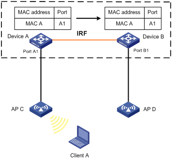

As shown in Figure 2:
·           Device A and Device B form an IRF fabric enabled with MAC address synchronization.
·           Device A and Device B connect to AP C and AP D, respectively.

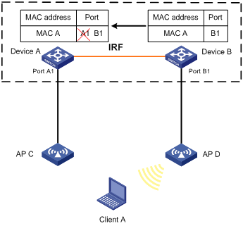

When Client A associates with AP C, Device A learns a MAC address entry for Client A and advertises it to Device B.
Figure 2 MAC address tables of devices when Client A accesses AP C
When Client A roams to AP D, Device B learns a MAC address entry for Client A. Device B advertises it to Device A to ensure service continuity for Client A, as shown in Figure 3.
Figure 3 MAC address tables of devices when Client A roams to AP D

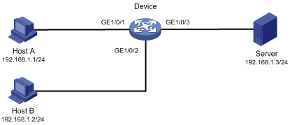

MAC address table configuration example
Network requirements
As shown in Figure 5:
·           Host A at MAC address 000f-e235-dc71 is connected to GigabitEthernet 1/0/1 of Device and belongs to VLAN 1.
·           Host B at MAC address 000f-e235-abcd, which behaved suspiciously on the network, also belongs to VLAN 1.
Configure the MAC address table as follows:
·           To prevent MAC address spoofing, add a static entry for Host A in the MAC address table of Device.
·           To drop all frames destined for Host B, add a blackhole MAC address entry for Host B.
·           Set the aging timer to 500 seconds for dynamic MAC address entries.
Figure 5 Network diagram

MAC Information configuration example
Enable MAC Information on GigabitEthernet 1/0/1 on Device in Figure 6 to send MAC address changes in syslog messages to the log host, Host B, through interface GigabitEthernet 1/0/2.
Figure 6 Network diagram
When you edit the file /etc/syslog.conf, follow these restrictions and guidelines:
·           Comments must be on a separate line and must begin with a pound sign (#).
·           No redundant spaces are allowed after the file name.
·           The logging facility name and the severity level specified in the /etc/syslog.conf file must be the same as those configured on the device. Otherwise, the log information might not be output correctly to the log host. The logging facility name and the severity level are configured by using the info-center loghost and info-center source commands, respectively.
