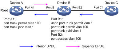

In RSTP, a non-root bridge actively sends RSTP BPDUs at the hello time through designated ports without waiting for the root bridge to send RSTP BPDUs. This enables RSTP to quickly detect link failures. If a device fails to receive any RSTP BPDUs on a port within triple the hello time, the device considers that a link failure has occurred. After the stored configuration BPDU expires, the device floods RSTP BPDUs with the TC flag set to initiate a new RSTP calculation.
In RSTP, a port in blocking state can immediately respond to an RSTP BPDU with a lower priority than its own BPDU.
As shown in Figure 6, Device A is the root bridge. The priority of Device B is higher than the priority of Device C. Port C2 on Device C is blocked.
When the link between Device A and Device B fails, the following events occur:
1.     Device B sends an RSTP BPDU with itself as the root bridge to Device C.
2.     Device C compares the RSTP BPDU with its own BPDU.
3.     Because the RSTP BPDU from Device B has a lower priority, Device C sends its own BPDU to Device B.
4.     Device B considers that Port B2 is the root port and stops sending RSTP BPDUs to Device C.

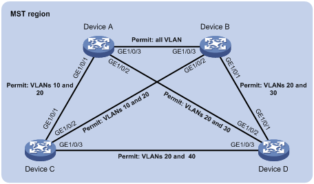

Figure 9 shows a switched network that contains four MST regions, each MST region containing four MSTP devices. Figure 10 shows the networking topology of MST region 3.
Figure 9 Basic concepts in MSTP
Figure 10 Network diagram and topology of MST region 3
MST region
A multiple spanning tree region (MST region) consists of multiple devices in a switched network and the network segments among them. All these devices have the following characteristics:

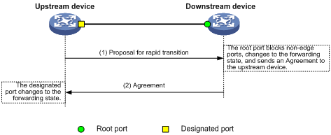

P/A transition
The P/A transition enables a designated port to rapidly transit to the forwarding state after a handshake with its peer. The P/A transition applies only to point-to-point links.
·     P/A transition for RSTP and PVST.
In RSTP or PVST, the ports on a new link or recovered link are designated ports in blocking state. When one of the designated ports transits to the discarding or learning state, it sets the proposal flag in its BPDU. Its peer bridge receives the BPDU and determines whether the receiving port is the root port. If it is the root port, the bridge blocks the other ports except edge ports. The bridge then replies an agreement BPDU to the designated port. The designated port immediately transits to the forwarding state upon receiving the agreement BPDU. If the designated port does not receive the agreement BPDU, it waits for twice the forward delay to transit to the forwarding state.

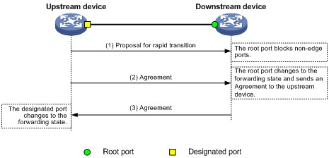

·     P/A transition for MSTP.
In MSTP, an upstream bridge sets both the proposal and agreement flags in its BPDU. If a downstream bridge receives the BPDU and its receiving port is elected as the root port, the bridge blocks all the other ports except edge ports. The downstream bridge then replies an agreement BPDU to the upstream bridge. The upstream port immediately transits to the forwarding state upon receiving the agreement BPDU. If the upstream port does not receive the agreement BPDU, it waits for twice the forward delay to transit to the forwarding state.
As shown in Figure 15, the P/A transition operates as follows:
a.     Device A sets the proposal and agreement flags in its BPDU and sends it to Device B through Port A1.
b.     Device B receives the BPDU. Port B1 of Device B is elected as the root port.
c.     Device B then blocks all its ports except the edge ports.
d.     The root port Port B1 of Device B transits to the forwarding state and sends an agreement BPDU to Device A.
e.     Port A1 of Device A immediately transits to the forwarding state upon receiving the agreement BPDU.
Figure 15 P/A transition for MSTP

Figure 17 Rapid state transition of an MSTP designated port
Figure 18 Rapid state transition of an RSTP designated port

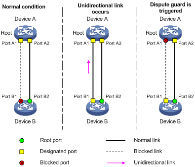

Disabling dispute guard
Dispute guard can be triggered by unidirectional link failures. If a designated port in the forwarding or learning state of a unidirectional link receives inferior BPDUs from the other end, a loop appears. Dispute guard blocks the designated port to prevent the loop.
As shown in Figure 21, in normal conditions, Device A is the root bridge, and Port B1 is blocked after spanning tree calculation. When the link between Port A1 and Port B1 becomes unidirectional (the link fails in the direction of Port A1 to Port B1), the following events occur:
1.     Port A1 can only receive BPDUs and cannot send BPDUs to Port B1.
2.     Port B1 does not receive BPDUs from Port A1 for a certain period of time.
3.     Device B determines itself as the root bridge.
4.     Port B1 sends its BPDUs to Port A1.
5.     Port A1 determines the received BPDUs are inferior to its own BPDUs. A dispute is detected.
6.     Dispute guard is triggered and blocks Port A1 to avoid a loop.
Figure 21 Dispute guard triggering scenario
Disabling dispute guard can avoid blocked links in VLAN networks. As shown in Figure 22, the spanning tree feature is disabled on Device B and enabled on Device A and device C. Device B transparently transmits BPDUs.
Device C cannot receive superior BPDUs of VLAN 1 from Device A because Port B1 of Device B is configured to deny packets of VLAN 1. Device C determines itself as the root bridge after a certain period of time. Then, Port C1 sends an inferior BPDU of VLAN 100 to Device A.
When Device A receives the inferior BPDU, dispute guard blocks Port A1, which causes traffic interruption. To ensure service continuity, you can disable dispute guard on Device A to prevent the link from being blocked.
Figure 22 Disabling dispute guard application scenario
You can disable dispute guard if the network does not have unidirectional link failures.

Spanning tree configuration example
MSTP configuration example
Network requirements
As shown in Figure 23, all devices on the network are in the same MST region. Device A and Device B work at the distribution layer. Device C and Device D work at the access layer.
Configure MSTP so that frames of different VLANs are forwarded along different spanning trees.
·     VLAN 10 frames are forwarded along MSTI 1.
·     VLAN 30 frames are forwarded along MSTI 3.
·     VLAN 40 frames are forwarded along MSTI 4.
·     VLAN 20 frames are forwarded along MSTI 0.
VLAN 10 and VLAN 30 are terminated on the distribution layer devices, and VLAN 40 is terminated on the access layer devices. The root bridges of MSTI 1 and MSTI 3 are Device A and Device B, respectively, and the root bridge of MSTI 4 is Device C.
Figure 23 Network diagram
Configuration procedure
1.     Configure VLANs and VLAN member ports. (Details not shown.)
¡     Create VLAN 10, VLAN 20, and VLAN 30 on both Device A and Device B.
¡     Create VLAN 10, VLAN 20, and VLAN 40 on Device C.
¡     Create VLAN 20, VLAN 30, and VLAN 40 on Device D.
¡     Configure the ports on these devices as trunk ports and assign them to related VLANs.
2.     Configure Device A:
# Enter MST region view, and configure the MST region name as example.
<DeviceA> system-view
[DeviceA] stp region-configuration
[DeviceA-mst-region] region-name example
# Map VLAN 10, VLAN 30, and VLAN 40 to MSTI 1, MSTI 3, and MSTI 4, respectively.
[DeviceA-mst-region] instance 1 vlan 10
[DeviceA-mst-region] instance 3 vlan 30
[DeviceA-mst-region] instance 4 vlan 40
# Configure the revision level of the MST region as 0.
[DeviceA-mst-region] revision-level 0
# Activate MST region configuration.
[DeviceA-mst-region] active region-configuration
[DeviceA-mst-region] quit
# Configure the Device A as the root bridge of MSTI 1.
[DeviceA] stp instance 1 root primary
# Enable the spanning tree feature globally.
[DeviceA] stp global enable
3.     Configure Device B:
<DeviceB> system-view
[DeviceB] stp region-configuration
[DeviceB-mst-region] region-name example
[DeviceB-mst-region] instance 1 vlan 10
[DeviceB-mst-region] instance 3 vlan 30
[DeviceB-mst-region] instance 4 vlan 40
[DeviceB-mst-region] revision-level 0
[DeviceB-mst-region] active region-configuration
[DeviceB-mst-region] quit
# Configure Device B as the root bridge of MSTI 3.
[DeviceB] stp instance 3 root primary
[DeviceB] stp global enable
4.     Configure Device C:
<DeviceC> system-view
[DeviceC] stp region-configuration
[DeviceC-mst-region] region-name example
[DeviceC-mst-region] instance 1 vlan 10
[DeviceC-mst-region] instance 3 vlan 30
[DeviceC-mst-region] instance 4 vlan 40
[DeviceC-mst-region] revision-level 0
[DeviceC-mst-region] active region-configuration
[DeviceC-mst-region] quit
# Configure the Device C as the root bridge of MSTI 4.
[DeviceC] stp instance 4 root primary
[DeviceC] stp global enable
5.     Configure Device D:
<DeviceD> system-view
[DeviceD] stp region-configuration
[DeviceD-mst-region] region-name example
[DeviceD-mst-region] instance 1 vlan 10
[DeviceD-mst-region] instance 3 vlan 30
[DeviceD-mst-region] instance 4 vlan 40
[DeviceD-mst-region] revision-level 0
[DeviceD-mst-region] active region-configuration
[DeviceD-mst-region] quit
[DeviceD] stp global enable
In this example, Device B has the lowest root bridge ID. As a result, Device B is elected as the root bridge in MSTI 0.
When the network is stable, you can use the display stp brief command to display brief spanning tree information on each device.
# Display brief spanning tree information on Device A.
[DeviceA] display stp brief
 MST ID      Port                         Role  STP State     Protection
 0           GigabitEthernet1/0/1         ALTE  DISCARDING    NONE
 0           GigabitEthernet1/0/2         DESI  FORWARDING    NONE
 0           GigabitEthernet1/0/3         ROOT  FORWARDING    NONE
 1           GigabitEthernet1/0/1         DESI  FORWARDING    NONE
 1           GigabitEthernet1/0/3         DESI  FORWARDING    NONE
 3           GigabitEthernet1/0/2         DESI  FORWARDING    NONE
 3           GigabitEthernet1/0/3         ROOT  FORWARDING    NONE
# Display brief spanning tree information on Device B.
[DeviceB] display stp brief
 0           GigabitEthernet1/0/1         DESI  FORWARDING    NONE
 0           GigabitEthernet1/0/3         DESI  FORWARDING    NONE
 1           GigabitEthernet1/0/2         DESI  FORWARDING    NONE
 1           GigabitEthernet1/0/3         ROOT  FORWARDING    NONE
 3           GigabitEthernet1/0/1         DESI  FORWARDING    NONE
 3           GigabitEthernet1/0/3         DESI  FORWARDING    NONE
# Display brief spanning tree information on Device C.
[DeviceC] display stp brief
 0           GigabitEthernet1/0/2         ROOT  FORWARDING    NONE
 1           GigabitEthernet1/0/1         ROOT  FORWARDING    NONE
 1           GigabitEthernet1/0/2         ALTE  DISCARDING    NONE
 4           GigabitEthernet1/0/3         DESI  FORWARDING    NONE
# Display brief spanning tree information on Device D.
[DeviceD] display stp brief
 0           GigabitEthernet1/0/1         ROOT  FORWARDING    NONE
 0           GigabitEthernet1/0/2         ALTE  DISCARDING    NONE
 0           GigabitEthernet1/0/3         ALTE  DISCARDING    NONE
 3           GigabitEthernet1/0/1         ROOT  FORWARDING    NONE
 3           GigabitEthernet1/0/2         ALTE  DISCARDING    NONE
 4           GigabitEthernet1/0/3         ROOT  FORWARDING    NONE
Based on the output, you can draw each MSTI mapped to each VLAN, as shown in Figure 24.
Figure 24 MSTIs mapped to different VLANs

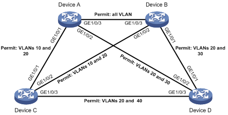

PVST configuration example
As shown in Figure 25, Device A and Device B work at the distribution layer, and Device C and Device D work at the access layer.
Configure PVST to meet the following requirements:
·     Frames of a VLAN are forwarded along the spanning trees of the VLAN.
·     VLAN 10, VLAN 20, and VLAN 30 are terminated on the distribution layer devices, and VLAN 40 is terminated on the access layer devices.
·     The root bridge of VLAN 10 and VLAN 20 is Device A.
·     The root bridge of VLAN 30 is Device B.
·     The root bridge of VLAN 40 is Device C.
Figure 25 Network diagram
# Set the spanning tree mode to PVST.
[DeviceA] stp mode pvst
# Configure the device as the root bridge of VLAN 10 and VLAN 20.
[DeviceA] stp vlan 10 20 root primary
# Enable the spanning tree feature globally and in VLAN 10, VLAN 20, and VLAN 30.
[DeviceA] stp vlan 10 20 30 enable
[DeviceB] stp mode pvst
# Configure the device as the root bridge of VLAN 30.
[DeviceB] stp vlan 30 root primary
[DeviceB] stp vlan 10 20 30 enable
[DeviceC] stp mode pvst
# Configure the device as the root bridge of VLAN 40.
[DeviceC] stp vlan 40 root primary
# Enable the spanning tree feature globally and in VLAN 10, VLAN 20, and VLAN 40.
[DeviceC] stp vlan 10 20 40 enable
[DeviceD] stp mode pvst
# Enable the spanning tree feature globally and in VLAN 20, VLAN 30, and VLAN 40.
[DeviceD] stp vlan 20 30 40 enable
 VLAN ID     Port                         Role  STP State     Protection
 10          GigabitEthernet1/0/1         DESI  FORWARDING    NONE
 10          GigabitEthernet1/0/3         DESI  FORWARDING    NONE
 20          GigabitEthernet1/0/1         DESI  FORWARDING    NONE
 20          GigabitEthernet1/0/2         DESI  FORWARDING    NONE
 20          GigabitEthernet1/0/3         DESI  FORWARDING    NONE
 30          GigabitEthernet1/0/2         DESI  FORWARDING    NONE
 30          GigabitEthernet1/0/3         ROOT  FORWARDING    NONE
 10          GigabitEthernet1/0/2         DESI  FORWARDING    NONE
 10          GigabitEthernet1/0/3         ROOT  FORWARDING    NONE
 20          GigabitEthernet1/0/3         ROOT  FORWARDING    NONE
 30          GigabitEthernet1/0/1         DESI  FORWARDING    NONE
 30          GigabitEthernet1/0/3         DESI  FORWARDING    NONE
 10          GigabitEthernet1/0/1         ROOT  FORWARDING    NONE
 10          GigabitEthernet1/0/2         ALTE  DISCARDING    NONE
 20          GigabitEthernet1/0/1         ROOT  FORWARDING    NONE
 20          GigabitEthernet1/0/2         ALTE  DISCARDING    NONE
 40          GigabitEthernet1/0/3         DESI  FORWARDING    NONE
 20          GigabitEthernet1/0/1         ALTE  DISCARDING    NONE
 20          GigabitEthernet1/0/2         ROOT  FORWARDING    NONE
 20          GigabitEthernet1/0/3         ALTE  DISCARDING    NONE
 30          GigabitEthernet1/0/1         ROOT  FORWARDING    NONE
 30          GigabitEthernet1/0/2         ALTE  DISCARDING    NONE
 40          GigabitEthernet1/0/3         ROOT  FORWARDING    NONE
Based on the output, you can draw a topology for each VLAN spanning tree, as shown in Figure 26.
Figure 26 VLAN spanning tree topologies

¡     Create VLAN 10, and VLAN 20 on Device C.
¡     Create VLAN 20, and VLAN 30 on Device D.
2.     Configure DRNI on Device A and Device B. (Details not shown.)
For more information about DRNI, see "Configuring DRNI."
3.     Configure Device A:
4.     Configure Device B in the same way Device A is configured. (Details not shown.)
5.     Configure Device C:
# Enable the spanning tree feature globally and in VLAN 10, and VLAN 20.
[DeviceC] stp vlan 10 20 enable
6.     Configure Device D:
# Enable the spanning tree feature globally and in VLAN 20, and VLAN 30.
[DeviceD] stp vlan 20 30 enable
# Display brief spanning tree information of the DR system on the primary DR device, Device A.
 10         Bridge-Aggregation1          DESI  FORWARDING    NONE
 20         Bridge-Aggregation1          DESI  FORWARDING    NONE
 20         Bridge-Aggregation2          DESI  FORWARDING    NONE
 30         Bridge-Aggregation2          DESI  FORWARDING    NONE
 10         Bridge-Aggregation1          ROOT  FORWARDING    NONE
 20         Bridge-Aggregation1          ROOT  FORWARDING    NONE
 20         Bridge-Aggregation2          ROOT  FORWARDING    NONE
 30         Bridge-Aggregation2          ROOT  FORWARDING    NONE
