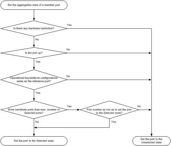

After the reference port is chosen, the system sets the aggregation state of each member port in the static aggregation group.
Figure 2 Setting the aggregation state of a member port in a static aggregation group
After the limit on Selected ports is reached, the aggregation state of a new member port varies by following conditions:
·     The port is placed in Unselected state if the port and the Selected ports have the same port priority. This mechanism prevents traffic interruption on the existing Selected ports. A device reboot can cause the device to recalculate the aggregation states of member ports.
·     The port is placed in Selected state when the following conditions are met:
¡     The port and the Selected ports have different port priorities, and the port has a higher port priority than a minimum of one Selected port.
¡     The port has the same attribute configurations as the aggregate interface.
Any operational key or attribute configuration change might affect the aggregation states of link aggregation member ports.

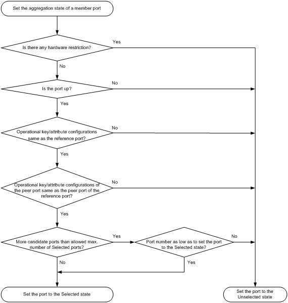

Dynamic link aggregation
LACP
Dynamic aggregation is implemented through IEEE 802.3ad Link Aggregation Control Protocol (LACP).
LACP uses LACPDUs to exchange aggregation information between LACP-enabled devices. Each member port in a dynamic aggregation group can exchange information with its peer. When a member port receives an LACPDU, it compares the received information with information received on the other member ports. In this way, the two systems reach an agreement on which ports are placed in Selected state.

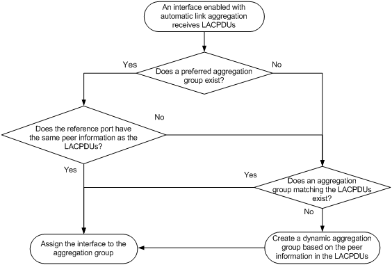

·     Automatic assignment—Enable automatic assignment on interfaces to have them automatically join a dynamic link aggregation group depending on the peer information in the received LACPDUs.
When you use automatic assignment on one end, you must use manual assignment on the other end.
Automatic member port assignment
This feature automates the assignment of aggregation member ports to an aggregation group. You can use this feature when setting up an aggregate link to a server.
As shown in Figure 3, an interface enabled with automatic assignment joins a dynamic aggregation group based on the peer information in the LACPDUs received from the aggregation peer. If none of the existing dynamic aggregation groups is qualified, the device automatically creates a new dynamic aggregation group, Then, the device assigns the interface to that group and synchronizes the interface's attribute configurations to the aggregate interface.
A dynamic aggregation group that contains automatically assigned member ports selects a reference port and Selected ports as described in "How dynamic link aggregation works." The assignment methods of member ports do not change the processes of reference port selection and Selected port selection.
Figure 3 Automatic member port assignment process

Setting the aggregation state of each member port
After the reference port is chosen, the system with the smaller system ID sets the state of each member port on its side.
Figure 4 Setting the state of a member port in a dynamic aggregation group
The system with the greater system ID can detect the aggregation state changes on the peer system. The system with the greater system ID sets the aggregation state of local member ports the same as their peer ports.

Configuring automatic link aggregation
Overview
On a SmartMC network, you can use automatic link aggregation to aggregate the redundant physical links between devices to ease management and increase bandwidth and availability. For more information about SmartMC, see Network Management and Monitoring Configuration Guide.
On an interface, the port link-aggregation group setting takes precedence over automatic link aggregation. The interface will not be added to the aggregation group of an automatically created aggregate interface if it has been the member port of a manually created aggregate interface.
When automatic link aggregation is enabled, subinterface creation might fail on LLDP-enabled Layer 3 Ethernet interfaces.
To ensure correct operation of an automatically created aggregate interface, do not modify the configuration on the member ports of its aggregation group. Doing so might cause the member ports to be removed from the aggregation group.
For DRNI to operate correctly, do not configure automatic link aggregation on a DR system.
As a best practice to ensure correct operation of dynamic aggregation groups, do not use automatic link aggregation and automatic member port assignment together.
Configuration prerequisites
Before you configure automatic link aggregation, enable LLDP on the peer devices.
Configuration procedure
Step
Remarks
N/A
2.     Enable automatic link aggregation.
link-aggregation auto-aggregation enable
By default, automatic link aggregation is disabled.
