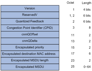

?  PDU EtherType—2 bytes in length. It indicates the Ethernet type of the PDU and has a value of 0x22E7.
?  CNM PDU—24 to 88 bytes of payload of the PDU.
Figure 2 CNM PDU format
As shown in Figure 3, a payload contains the following fields:
Field
Length

Figure 3 CNM PDU format

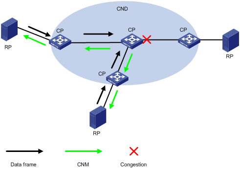

How QCN works
Figure 4 shows how QCN works.
·          The CP periodically samples frames from QCN-enabled queues and sends CNMs to the RPs when congestion occurs.
·          The RPs reduce their transmission rates when receiving CNMs. The RPs also periodically probe the bandwidth and increase their transmission rates if they fail to receive CNMs for a specific period of time.
Figure 4 How QCN works

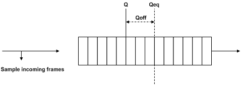

The CP measures the queue size by periodically sampling frames and computes the congestion state based on the sampling result.
As shown in Figure 5, the CP algorithm includes the following parameters:
·          Q—Indicates the instantaneous queue size at the sampling point.
·          Qeq—Indicates the desired queue size.
·          Qold—Indicates the queue size at the previous sampling point.
·          Fb—Indicates the extent of congestion in the form of a quantized value.
The following formulas apply:
·          Qoff = Q – Qeq
·          Qδ = Q – Qold
·          Fb = – (Qoff + wQδ)
where w is a constant to control the weight of Qδ in determining the value of Fb.
The CP determines whether to generate CNMs based on the Fb value.
·          When Fb ≥ 0, no congestion occurs, and the CP does not generate a CNM.
·          When Fb < 0, congestion occurs, and the CP generates an CNM containing the QntzFb. QntzFb is the quantized value of |Fb| and is calculated according to the following rules:
?  If Fb < – Qeq x (2 x w + 1), QntzFb takes the maximum value of 63.
?  Otherwise, QntzFb = – Fb x 63/(Qeq x (2 x w + 1)).
Figure 5 Congestion detection

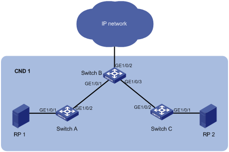

Basic QCN configuration example
Network requirements
As shown in Figure 6, RP 1 and RP 2 are in the same VLAN and both support QCN.
Configure QCN for CNPV 1 to meet the following requirements:
·          Switch A, Switch B, and Switch C detect congestion for traffic with 802.1p priority 1.
·          Switch A, Switch B, and Switch C do not detect congestion for all other traffic.
Figure 6 Network diagram
Configuration procedure
1.        Configure Switch A:
# Create VLAN 100, and assign GigabitEthernet 1/0/1 to the VLAN.
<SwitchA> system-view
[SwitchA] vlan 100
[SwitchA-vlan100] port gigabitethernet 1/0/1
[SwitchA-vlan100] quit
# Configure GigabitEthernet 1/0/2 as a trunk port, and assign it to VLAN 100.
[SwitchA] interface gigabitethernet 1/0/2
[SwitchA-GigabitEthernet1/0/2] port link-type trunk
[SwitchA-GigabitEthernet1/0/2] port trunk permit vlan 100
[SwitchA-GigabitEthernet1/0/2] quit

2.        Configure Switch B:
# Create VLAN 100.
<SwitchB> system-view
[SwitchB] vlan 100
[SwitchB-vlan100] quit
# Configure the following interfaces as trunk ports, and assign all of them to VLAN 100:
?  GigabitEthernet 1/0/1.
?  GigabitEthernet 1/0/2.
?  GigabitEthernet 1/0/3.
[SwitchB] interface gigabitethernet 1/0/1
[SwitchB-GigabitEthernet1/0/1] port link-type trunk
[SwitchB-GigabitEthernet1/0/1] port trunk permit vlan 100
[SwitchB-GigabitEthernet1/0/1] quit
[SwitchB] interface gigabitethernet 1/0/2
[SwitchB-GigabitEthernet1/0/2] port link-type trunk
[SwitchB-GigabitEthernet1/0/2] port trunk permit vlan 100
[SwitchB-GigabitEthernet1/0/2] quit
[SwitchB] interface gigabitethernet 1/0/3
[SwitchB-GigabitEthernet1/0/3] port link-type trunk
[SwitchB-GigabitEthernet1/0/3] port trunk permit vlan 100
[SwitchB-GigabitEthernet1/0/3] quit
# Enable LLDP globally.
[SwitchB] lldp global enable
# Enable CN TLV advertising on GigabitEthernet 1/0/1 and GigabitEthernet 1/0/3.
[SwitchB-GigabitEthernet1/0/1] lldp tlv-enable dot1-tlv congestion-notification
[SwitchB-GigabitEthernet1/0/3] lldp tlv-enable dot1-tlv congestion-notification
# Enable QCN.
[SwitchB] qcn enable
# Assign the switch to the CND with CNPV 1.
[SwitchB] qcn priority 1 auto
# Configure the CND defense mode edge and alternate value 0 for interface GigabitEthernet 1/0/2.
[SwitchB-GigabitEthernet1/0/2] qcn port priority 1 admin defense-mode edge alternate 0
# Assign the switch to the CND with CNPV 1, and configure all interfaces to negotiate the defense mode and alternate priority by using LLDP.
3.        Configure Switch C in the same way Switch A is configured. (Details not shown.)
# Display the CND settings for interfaces on Switch A.
[SwitchA] display qcn interface
Interface: GE1/0/1
 CNPV  Mode   Defense-mode     Alternate
 1     comp   interior-ready   0
Interface: GE1/0/2
# Display the CND settings for interfaces on Switch B.
[SwitchB] display qcn interface
Interface: GE1/0/1
Interface: GE1/0/2
 1     admin  edge             0
Interface: GE1/0/3
# Display the CND settings for interfaces on Switch C.
[SwitchC] display qcn interface
Interface: GE1/0/1
Interface: GE1/0/2
