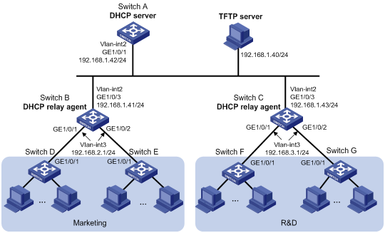

Typical server-based automatic configuration network
As shown in Figure 1, server-based automatic configuration requires the following servers:
·          DHCP server.
·          File server (TFTP or HTTP server).
·          (Optional.) DNS server.
Figure 1 Server-based automatic configuration network diagram

Configuring the file server
For devices to obtain configuration information from a TFTP server, start TFTP service on the file server.
For devices to obtain configuration information from an HTTP server, start HTTP service on the file server.

Configuring the gateway
If the devices to be automatically configured and the servers for automatic configuration reside in different network segments, you must perform the following tasks:
·          Deploy a gateway and make sure the devices can communicate with the servers.
·          Configure the DHCP relay agent feature on the gateway.
·          Configure the UDP helper feature on the gateway.
When a device sends a request through a broadcast packet to the file server, the UDP helper changes the broadcast packet to a unicast packet and forwards the unicast packet to the file server. For more information about UDP helper, see Layer 3—IP Services Configuration Guide.

Server-based automatic configuration examples
Automatic configuration using TFTP server
Network requirements
As shown in Figure 2, two departments of a company are connected to the network through gateways (Switch B and Switch C). Access devices Switch D, Switch E, Switch F, and Switch G do not have a configuration file.
Configure the servers and gateways so the access devices can obtain a configuration file to complete the following configuration tasks:
·          Enable administrators of access devices to Telnet to and manage their respective access devices.
·          Require administrators to enter their respective usernames and passwords at login.
Figure 2 Network diagram
Configuration procedure
1.        Configure the DHCP server:
# Create a VLAN interface and assign an IP address to the interface.
<SwitchA> system-view
[SwitchA] vlan 2
[SwitchA-vlan2] port gigabitethernet 1/0/1
[SwitchA-vlan2] quit
[SwitchA-Vlan-interface2] ip address 192.168.1.42 24
# Enable DHCP.
[SwitchA] dhcp enable
# Enable the DHCP server on VLAN-interface 2.
[SwitchA-Vlan-interface2] dhcp select server
# Configure address pool market to assign IP addresses on the 192.168.2.0/24 subnet to clients in the Marketing department. Specify the TFTP server, gateway, and configuration file name for the clients.
[SwitchA] dhcp server ip-pool market
[SwitchA-dhcp-pool-market] network 192.168.2.0 24
[SwitchA-dhcp-pool-market] tftp-server ip-address 192.168.1.40
[SwitchA-dhcp-pool-market] gateway-list 192.168.2.1
[SwitchA-dhcp-pool-market] bootfile-name market.cfg
[SwitchA-dhcp-pool-market] quit
# Configure address pool rd to assign IP addresses on the 192.168.3.0/24 subnet to clients in the R&D department. Specify the TFTP server, gateway, and configuration file name for the clients.
[SwitchA] dhcp server ip-pool rd
[SwitchA-dhcp-pool-rd] network 192.168.3.0 24
[SwitchA-dhcp-pool-rd] tftp-server ip-address 192.168.1.40
[SwitchA-dhcp-pool-rd] gateway-list 192.168.3.1
[SwitchA-dhcp-pool-rd] bootfile-name rd.cfg
[SwitchA-dhcp-pool-rd] quit
# Configure static routes to the DHCP relay agents.
[SwitchA] ip route-static 192.168.2.0 24 192.168.1.41
[SwitchA] ip route-static 192.168.3.0 24 192.168.1.43
[SwitchA] quit
2.        Configure the gateway Switch B:
# Create VLAN interfaces and assign IP addresses to the interfaces.
<SwitchB> system-view
[SwitchB] vlan 2
[SwitchB-vlan2] port gigabitethernet 1/0/3
[SwitchB-vlan2] quit
[SwitchB-Vlan-interface2] ip address 192.168.1.41 24
[SwitchB-Vlan-interface2] quit
[SwitchB] vlan 3
[SwitchB-vlan3] port gigabitethernet 1/0/1
[SwitchB-vlan3] port gigabitethernet 1/0/2
[SwitchB-vlan3] quit
[SwitchB] interface vlan-interface 3
[SwitchB-Vlan-interface3] ip address 192.168.2.1 24
[SwitchB-Vlan-interface3] quit
# Enable DHCP.
[SwitchB] dhcp enable
# Enable the DHCP relay agent on VLAN-interface 3.
[SwitchB-Vlan-interface3] dhcp select relay
# Specify the DHCP server address.
[SwitchB-Vlan-interface3] dhcp relay server-address 192.168.1.42
3.        Configure the gateway Switch C:
<SwitchC> system-view
[SwitchC] vlan 2
[SwitchC-vlan2] port gigabitethernet 1/0/3
[SwitchC-vlan2] quit
[SwitchC] interface vlan-interface 2
[SwitchC-Vlan-interface2] ip address 192.168.1.43 24
[SwitchC-Vlan-interface2] quit
[SwitchC] vlan 3
[SwitchC-vlan3] port gigabitethernet 1/0/1
[SwitchC-vlan3] port gigabitethernet 1/0/2
[SwitchC-vlan3] quit
[SwitchC] interface vlan-interface 3
[SwitchC-Vlan-interface3] ip address 192.168.3.1 24
[SwitchC-Vlan-interface3] quit
# Enable DHCP.
[SwitchC] dhcp enable
[SwitchC-Vlan-interface3] dhcp select relay
[SwitchC-Vlan-interface3] dhcp relay server-address 192.168.1.42
4.        Configure the TFTP server:
# On the TFTP server, create a configuration file named market.cfg.
 sysname Market
 telnet server enable
vlan 3
local-user market
 password simple market
 service-type telnet
interface Vlan-interface3
 ip address dhcp-alloc
interface gigabitethernet 1/0/1
 port access vlan 3
user-interface vty 0 63
 authentication-mode scheme
 user-role network-admin
return
# On the TFTP server, create a configuration file named rd.cfg.
 sysname RD
vlan 3
local-user rd
 password simple rd
 service-type telnet
 port access vlan 3
return
# Start TFTP service software, and specify the folder where the two configuration files reside as the working directory. (Details not shown.)
# Verify that the TFTP server and DHCP relay agents can reach each other. (Details not shown.)
1.        Power on Switch D, Switch E, Switch F, and Switch G.
2.        After the access devices start up, display assigned IP addresses on Switch A.
<SwitchA> display dhcp server ip-in-use
IP address       Client-identifier/    Lease expiration      Type
                 Hardware address
192.168.2.2      3030-3066-2e65-3233-  May 6 05:21:25 2013   Auto(C)
                 642e-3561-6633-2d56-
                 6c61-6e2d-696e-7465-
                 7266-6163-6533
192.168.2.3      3030-3066-2e65-3230-  May 6 05:22:50 2013   Auto(C)
                 302e-3232-3033-2d56-
                 7266-6163-6533
192.168.3.2      3030-6530-2e66-6330-  May 6 05:23:15 2013   Auto(C)
                 302e-3335-3131-2d56-
                 7266-6163-6531
192.168.3.3      3030-6530-2e66-6330-  May 6 05:24:10 2013   Auto(C)
                 302e-3335-3135-2d56-
                 7266-6163-6532
3.        Telnet to 192.168.2.2 from Switch A.
<SwitchA> telnet 192.168.2.2
4.        Enter username market and password market as prompted. (Details not shown.)
You are logged in to Switch D or Switch E.
