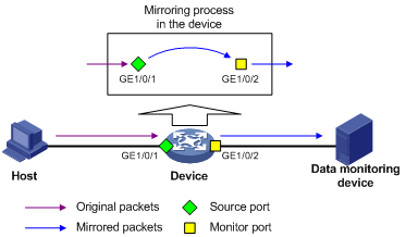

A local mirroring group is a mirroring group that contains the mirroring sources and the mirroring destination on the same device.
Figure 1 Local port mirroring implementation
As shown in Figure 1, the source port (GigabitEthernet 1/0/1) and the monitor port (GigabitEthernet 1/0/2) reside on the same device. Packets received on GigabitEthernet 1/0/1 are copied to GigabitEthernet 1/0/2. GigabitEthernet 1/0/2 then forwards the packets to the data monitoring device for analysis.

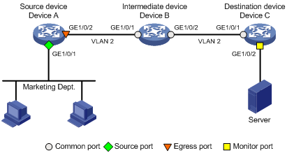

·          Layer 2 remote port mirroring—The mirroring sources and the mirroring destination are located on different devices on the same Layer 2 network.

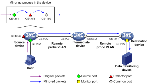

Layer 2 remote port mirroring can be implemented when a reflector port or an egress port is available on the source device. The method to use the reflector port and the method to use the egress port are called reflector port method and egress port method, respectively.

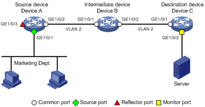

¡  Reflector port method—Packets are mirrored as follows:
-      The source device copies packets received on the mirroring sources to the reflector port.
-      The reflector port broadcasts the mirrored packets in the remote probe VLAN.
-      The intermediate devices transmit the mirrored packets to the destination device through the remote probe VLAN.
-      Upon receiving the mirrored packets, the destination device determines whether the ID of the mirrored packets is the same as the remote probe VLAN ID. If the two VLAN IDs match, the destination device forwards the mirrored packets to the data monitoring device through the monitor port.
Figure 2 Layer 2 remote port mirroring implementation through the reflector port method

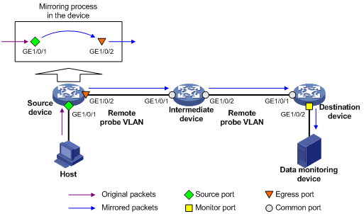

¡  Egress port method—Packets are mirrored as follows:
-      The source device copies packets received on the mirroring sources to the egress port.
-      The egress port forwards the mirrored packets to the intermediate devices.
-      The intermediate devices flood the mirrored packets in the remote probe VLAN and transmit the mirrored packets to the destination device.
Figure 3 Layer 2 remote port mirroring implementation through the egress port method

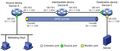

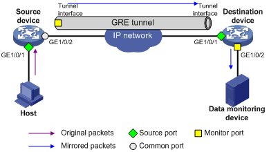

·          Layer 3 remote port mirroring—The mirroring sources and destination are separated by IP networks.
Layer 3 remote port mirroring is implemented through creating a local mirroring group on both the source device and the destination device. For example, in a network as shown in Figure 4, Layer 3 remote port mirroring works in the following flow:
a.    The source device sends one copy of a packet received on the source port (GigabitEthernet 1/0/1) to the tunnel interface.
The tunnel interface acts as the monitor port in the local mirroring group created on the source device.
b.    The tunnel interface on the source device forwards the mirrored packet to the tunnel interface on the destination device through the GRE tunnel.
c.    The destination device receives the mirrored packet from the physical interface of the tunnel interface.
The tunnel interface acts as the source port in the local mirroring group created on the destination device.
d.    The physical interface of the tunnel interface sends one copy of the packet to the monitor port (GigabitEthernet 1/0/2).
e.    GigabitEthernet 1/0/2 forwards the packet to the data monitoring device.
For more information about GRE tunnels and tunnel interfaces, see Layer 3—IP Services Configuration Guide.
Figure 4 Layer 3 remote port mirroring implementation

Configuring the monitor port in system view
Step
Remarks
1.       Enter system view.
N/A
2.       Configure the monitor port for a local mirroring group.
mirroring-group group-id monitor-port interface-type interface-number
By default, no monitor port is configured for a local mirroring group.
Configuring the monitor port in interface view
Step
Remarks
N/A
2.       Enter interface view.
N/A
3.       Configure the port as the monitor port for a mirroring group.
By default, a port does not act as the monitor port for any local mirroring groups.
Configuring Layer 2 remote port mirroring
To configure Layer 2 remote port mirroring, perform the following tasks:
·          Configure a remote source group on the source device.
·          Configure a cooperating remote destination group on the destination device.
·          If intermediate devices exist, configure the following devices and ports to allow the remote probe VLAN to pass through.
¡  Intermediate devices.
¡  Ports connected to the intermediate devices on the source and destinations devices.
When you configure Layer 2 remote port mirroring, follow these restrictions and guidelines:
·          The egress port must be assigned to the remote probe VLAN. The reflector port is not necessarily assigned to the remote probe VLAN.
·          For a mirrored packet to successfully arrive at the remote destination device, make sure its VLAN ID is not removed or changed.
·          Do not configure both MVRP and Layer 2 remote port mirroring. Otherwise, MVRP might register the remote probe VLAN with incorrect ports, which would cause the monitor port to receive undesired copies. For more information about MVRP, see Layer 2—LAN Switching Configuration Guide.
·          As a best practice, configure devices in the order of the destination device, the intermediate devices, and the source device.
Layer 2 remote port mirroring with reflector port configuration task list
Tasks at a glance
(Required.) Configuring a remote destination group on the destination device:
1.       Creating a remote destination group
2.       Configuring the monitor port for a remote destination group
3.       Configuring the remote probe VLAN for a remote destination group
4.       Assigning the monitor port to the remote probe VLAN
(Required.) Configuring a remote source group on the source device:
1.       Creating a remote source group
2.       Configuring source ports for a remote source group
3.       Configuring the reflector port for a remote source group
4.       Configuring the remote probe VLAN for a remote source group
Layer 2 remote port mirroring with egress port configuration task list
Tasks at a glance
3.       Configuring the egress port for a remote source group
To configure the reflector port for a remote source group, use one of the following methods:
·          Configure the reflector port for the remote source group in system view.
·          Assign a port to the remote source group as the reflector port in interface view.
When you configure the reflector port for a remote source group, follow these restrictions and guidelines:
·          The port to be configured as a reflector port must be a port not in use. Do not connect a network cable to a reflector port.
·          When a port is configured as a reflector port, all existing configurations of the port are cleared. You cannot configure other features on the reflector port.
·          If an IRF port is bound to only one physical interface, do not configure the physical interface as a reflector port. Otherwise, the IRF might split.
·          A mirroring group contains only one reflector port.
·          You cannot change the duplex mode, MDI settings, or speed for a reflector port.
Configuring the reflector port for a remote source group in system view
Step
Remarks
N/A
2.       Configure the reflector port for a remote source group.
mirroring-group group-id reflector-port interface-type interface-number
By default, no reflector port is configured for a remote source group.
Configuring the reflector port for a remote source group in interface view
Step
Remarks
N/A
N/A
3.       Configure the port as the reflector port for a remote source group.
By default, a port does not act as the reflector port for any remote source groups.
To configure the egress port for a remote source group, use one of the following methods:
·          Configure the egress port for the remote source group in system view.
·          Assign a port to the remote source group as the egress port in interface view.
When you configure the egress port for a remote source group, follow these restrictions and guidelines:
·          Disable the following features on the egress port:
¡  Spanning tree.
¡  802.1X.
¡  IGMP snooping.
¡  Static ARP.
¡  MAC address learning.
·          A mirroring group contains only one egress port.
·          A port of an existing mirroring group cannot be configured as an egress port.
Configuring the egress port for a remote source group in system view
Step
Remarks
N/A
2.       Configure the egress port for a remote source group.
mirroring-group group-id monitor-egress interface-type interface-number
By default, no egress port is configured for a remote source group.
Configuring the egress port for a remote source group in interface view
Step
Remarks
N/A
N/A
3.       Configure the port as the egress port for a remote source group.
By default, a port does not act as the egress port for any remote source groups.
When you configure the remote probe VLAN for a remote source group, follow these restrictions and guidelines:
·          Only an existing static VLAN can be configured as a remote probe VLAN.
·          When a VLAN is configured as a remote probe VLAN, use the remote probe VLAN for port mirroring exclusively.
·          The remote mirroring groups on the source device and destination device must use the same remote probe VLAN.
To configure the remote probe VLAN for a remote source group:
Step
Remarks
N/A
2.       Configure the remote probe VLAN for a remote source group.
mirroring-group group-id remote-probe vlan vlan-id
By default, no remote probe VLAN is configured for a remote source group.
Configuring local mirroring group with multiple monitor ports
In typical local port mirroring configuration, you can configure only one monitor port in a local mirroring group. As a result, you cannot monitor traffic of a local device on multiple data monitoring devices. To do that, you can take advantage of the remote probe VLAN used in Layer 2 remote port mirroring.
In Layer 2 remote port mirroring, a remote probe VLAN is configured, and the mirrored packets are broadcast within the remote probe VLAN. By connecting multiple data monitoring devices to the remote probe VLAN member ports, you can monitor traffic of the local device on multiple data monitoring devices.
The configuration flow is as follows:
1.        Configure a remote source group on the device.
2.        Configure source ports for the remote source group.
3.        Configure a remote probe VLAN for the remote source group.
4.        Assign the ports connecting the data monitoring devices to the remote probe VLAN.
In this way, mirrored packets on the source ports are broadcast in the remote probe VLAN. Then, they will be sent out of the ports connecting the data monitoring devices, and the data monitoring devices can receive these mirrored packets.

Configuring Layer 3 remote port mirroring
To configure Layer 3 remote port mirroring, perform the following tasks:
·          Create a local mirroring group on both the source device and the destination device.
·          Configure the monitor port and source ports for each mirroring group.
The source and destination devices are connected by a tunnel. If intermediate devices exist, configure a unicast routing protocol on the intermediate devices to ensure Layer 3 reachability between the source and destination devices.
On the source device, perform the following tasks:
·          Configure source ports you want to monitor.
·          Configure the tunnel interface as the monitor port.
On the destination device, perform the following tasks:
·          Configure the physical interface corresponding to the tunnel interface as the source port.
·          Configure the port that connects to the data monitoring device as the monitor port.

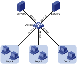

As shown in Figure 5, configure local port mirroring in source port mode to enable the server to monitor the bidirectional traffic of the two departments.
Figure 5 Network diagram
Configuration procedure

Layer 2 remote port mirroring configuration example (reflector port)
Network requirements
As shown in Figure 6, configure Layer 2 remote port mirroring to enable the server to monitor the bidirectional traffic of the Marketing Department.
Figure 6 Network diagram
1.        Configure Device C (the destination device):
# Configure GigabitEthernet 1/0/1 as a trunk port, and assign the port to VLAN 2.
<DeviceC> system-view
[DeviceC] interface gigabitethernet 1/0/1
[DeviceC-GigabitEthernet1/0/1] port link-type trunk
[DeviceC-GigabitEthernet1/0/1] port trunk permit vlan 2
[DeviceC-GigabitEthernet1/0/1] quit
# Create a remote destination group.
[DeviceC] mirroring-group 2 remote-destination
# Create VLAN 2.
[DeviceC] vlan 2
# Disable MAC address learning for VLAN 2.
[DeviceC-vlan2] undo mac-address mac-learning enable
[DeviceC-vlan2] quit
# Configure VLAN 2 as the remote probe VLAN for the mirroring group.
[DeviceC] mirroring-group 2 remote-probe vlan 2
# Configure GigabitEthernet 1/0/2 as the monitor port for the mirroring group.
[DeviceC] interface gigabitethernet 1/0/2
[DeviceC-GigabitEthernet1/0/2] mirroring-group 2 monitor-port
# Disable the spanning tree feature on GigabitEthernet 1/0/2.
[DeviceC-GigabitEthernet1/0/2] undo stp enable
# Assign GigabitEthernet 1/0/2 to VLAN 2.
[DeviceC-GigabitEthernet1/0/2] port access vlan 2
[DeviceC-GigabitEthernet1/0/2] quit
2.        Configure Device B (the intermediate device):
# Create VLAN 2.
<DeviceB> system-view
[DeviceB] vlan 2
[DeviceB-vlan2] undo mac-address mac-learning enable
[DeviceB-vlan2] quit
[DeviceB-GigabitEthernet1/0/1] port link-type trunk
[DeviceB-GigabitEthernet1/0/1] port trunk permit vlan 2
[DeviceB-GigabitEthernet1/0/1] quit
# Configure GigabitEthernet 1/0/2 as a trunk port, and assign the port to VLAN 2.
[DeviceB] interface gigabitethernet 1/0/2
[DeviceB-GigabitEthernet1/0/2] port link-type trunk
[DeviceB-GigabitEthernet1/0/2] port trunk permit vlan 2
[DeviceB-GigabitEthernet1/0/2] quit
3.        Configure Device A (the source device):
# Create a remote source group.
<DeviceA> system-view
[DeviceA] mirroring-group 1 remote-source
# Create VLAN 2.
[DeviceA] vlan 2
[DeviceA-vlan2] undo mac-address mac-learning enable
[DeviceA-vlan2] quit
[DeviceA] mirroring-group 1 remote-probe vlan 2
# Configure GigabitEthernet 1/0/1 as a source port for the mirroring group.
[DeviceA] mirroring-group 1 mirroring-port gigabitethernet 1/0/1 both
# Configure GigabitEthernet 1/0/3 as the reflector port for the mirroring group.
[DeviceA] mirroring-group 1 reflector-port gigabitethernet 1/0/3
This operation may delete all settings made on the interface. Continue? [Y/N]: y
[DeviceA] interface gigabitethernet 1/0/2
[DeviceA-GigabitEthernet1/0/2] port link-type trunk
[DeviceA-GigabitEthernet1/0/2] port trunk permit vlan 2
[DeviceA-GigabitEthernet1/0/2] quit
# Verify the mirroring group configuration on Device C.
[DeviceC] display mirroring-group all
Mirroring group 2:
    Type: Remote destination
    Status: Active
    Monitor port: GigabitEthernet1/0/2
    Remote probe VLAN: 2
# Verify the mirroring group configuration on Device A.
[DeviceA] display mirroring-group all
Mirroring group 1:
    Type: Remote source
    Status: Active
    Mirroring port:
        GigabitEthernet1/0/1  Both
    Reflector port: GigabitEthernet1/0/3
Layer 2 remote port mirroring configuration example (with egress port)
On the Layer 2 network shown in Figure 7, configure Layer 2 remote port mirroring to enable the server to monitor the bidirectional traffic of the Marketing Department.
Figure 7 Network diagram
# Create VLAN 2.
[DeviceA] vlan 2
# Configure VLAN 2 as the remote probe VLAN of the mirroring group.
# Configure GigabitEthernet 1/0/2 as the egress port for the mirroring group.
[DeviceA] mirroring-group 1 monitor-egress gigabitethernet 1/0/2
# Disable the spanning tree feature on the port.
[DeviceA-GigabitEthernet1/0/2] undo stp enable
Mirroring group 2:
    Status: Active
Mirroring group 1:
    Type: Remote source
    Status: Active
    Mirroring port:
    Monitor egress port: GigabitEthernet1/0/2
Local port mirroring with multiple monitor ports configuration example
As shown in Figure 8, Dept. A, Dept. B, and Dept. C are connected to the device through GigabitEthernet 1/0/1, GigabitEthernet 1/0/2, and GigabitEthernet 1/0/3, respectively.
Configure port mirroring to enable data monitoring devices Server A and Server B to monitor both the incoming and outgoing traffic of the three departments.
Figure 8 Network diagram
# Create remote source group 1.
<Device> system-view
[Device] mirroring-group 1 remote-source
# Configure GigabitEthernet 1/0/1 through GigabitEthernet 1/0/3 as source ports of remote source group 1.
[Device] mirroring-group 1 mirroring-port gigabitethernet 1/0/1 to gigabitethernet 1/0/3 both
# Configure an unused port (GigabitEthernet 1/0/6 in this example) as the reflector port of remote source group 1.
[Device] mirroring-group 1 reflector-port gigabitethernet 1/0/6
This operation may delete all settings made on the interface. Continue? [Y/N]:y
# Create VLAN 10 and assign the ports (GigabitEthernet 1/0/4 and GigabitEthernet 1/0/5) connecting the data monitoring devices  to the VLAN.
[Device] vlan 10
[Device-vlan10] port gigabitethernet 1/0/4 to gigabitethernet 1/0/5
[Device-vlan10] quit
# Configure VLAN 10 as the remote probe VLAN of remote source group 1.
[Device] mirroring-group 1 remote-probe vlan 10
Layer 3 remote port mirroring configuration example
On a Layer 3 network shown in Figure 9, configure Layer 3 remote port mirroring to enable the server to monitor the bidirectional traffic of the Marketing Department.
Figure 9 Network diagram
1.        Configure IP addresses for the tunnel interfaces and related ports on the devices. (Details not shown.)
2.        Configure Device A (the source device):
# Create service loopback group 1 and specify the unicast tunnel service for the group.
[DeviceA] service-loopback group 1 type tunnel
# Assign GigabitEthernet 1/0/3 to the service loopback group 1.
[DeviceA] interface gigabitethernet 1/0/3
[DeviceA-GigabitEthernet1/0/3] port service-loopback group 1
All configurations on the interface will be lost. Continue?[Y/N]:y
[DeviceA-GigabitEthernet1/0/3] quit
# Create tunnel interface Tunnel 0 that operates in GRE mode, and configure an IP address and subnet mask for the interface.
[DeviceA] interface tunnel 0 mode gre
[DeviceA-Tunnel0] ip address 50.1.1.1 24
# Configure source and destination IP addresses for Tunnel 0.
[DeviceA-Tunnel0] source 20.1.1.1
[DeviceA-Tunnel0] destination 30.1.1.2
[DeviceA-Tunnel0] quit
# Enable the OSPF protocol.
[DeviceA] ospf 1
[DeviceA-ospf-1] area 0
[DeviceA-ospf-1-area-0.0.0.0] network 10.1.1.0 0.0.0.255
[DeviceA-ospf-1-area-0.0.0.0] network 20.1.1.0 0.0.0.255
[DeviceA-ospf-1-area-0.0.0.0] quit
[DeviceA-ospf-1] quit
# Create local mirroring group 1.
[DeviceA] mirroring-group 1 local
# Configure GigabitEthernet 1/0/1 as a source port and Tunnel 0 as the monitor port of local mirroring group 1.
[DeviceA] mirroring-group 1 monitor-port tunnel 0
3.        Enable the OSPF protocol on Device B (the intermediate device).
[DeviceB] ospf 1
[DeviceB-ospf-1] area 0
[DeviceB-ospf-1-area-0.0.0.0] network 20.1.1.0 0.0.0.255
[DeviceB-ospf-1-area-0.0.0.0] network 30.1.1.0 0.0.0.255
[DeviceB-ospf-1-area-0.0.0.0] quit
[DeviceB-ospf-1] quit
4.        Configure Device C (the destination device):
[DeviceC] service-loopback group 1 type tunnel
# Assign GigabitEthernet 1/0/3 to service loopback group 1.
[DeviceC] interface gigabitethernet 1/0/3
[DeviceC-GigabitEthernet1/0/3] port service-loopback group 1
[DeviceC-GigabitEthernet1/0/3] quit
[DeviceC] interface tunnel 0 mode gre
[DeviceC-Tunnel0] ip address 50.1.1.2 24
[DeviceC-Tunnel0] source 30.1.1.2
[DeviceC-Tunnel0] destination 20.1.1.1
[DeviceC-Tunnel0] quit
[DeviceC] ospf 1
[DeviceC-ospf-1] area 0
[DeviceC-ospf-1-area-0.0.0.0] network 30.1.1.0 0.0.0.255
[DeviceC-ospf-1-area-0.0.0.0] network 40.1.1.0 0.0.0.255
[DeviceC-ospf-1-area-0.0.0.0] quit
[DeviceC-ospf-1] quit
[DeviceC] mirroring-group 1 local
# Configure GigabitEthernet 1/0/1 as a source port for local mirroring group 1.
[DeviceC] mirroring-group 1 mirroring-port gigabitethernet 1/0/1 inbound
# Configure GigabitEthernet 1/0/2 as the monitor port for local mirroring group 1.
[DeviceC] mirroring-group 1 monitor-port gigabitethernet 1/0/2
Mirroring group 1:
    Type: Local
    Status: Active
    Mirroring port:
    Monitor port: Tunnel0
# Display information about all mirroring groups on Device C.
Mirroring group 1:
    Type: Local
    Status: Active
    Mirroring port:
        GigabitEthernet1/0/1  Inbound

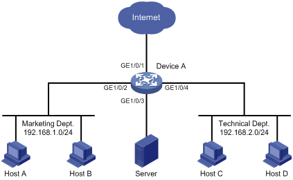

Flow mirroring configuration example
As shown in Figure 10, configure flow mirroring so that the server can monitor the following traffic:
·          All traffic that the Technical Department sends to access the Internet.
·          IP traffic that the Technical Department sends to the Marketing Department during working hours (8:00 to 18:00) on weekdays.
Figure 10 Network diagram
# Create working hour range work, in which working hours are from 8:00 to 18:00 on weekdays.
[DeviceA] time-range work 8:00 to 18:00 working-day
# Create IPv4 advanced ACL 3000 to allow packets from the Technical Department to access the Internet and the Marketing Department during working hours.
[DeviceA] acl advanced 3000
[DeviceA-acl-ipv4-adv-3000] rule permit tcp source 192.168.2.0 0.0.0.255 destination-port eq www
[DeviceA-acl-ipv4-adv-3000] rule permit ip source 192.168.2.0 0.0.0.255 destination 192.168.1.0 0.0.0.255 time-range work
[DeviceA-acl-ipv4-adv-3000] quit
# Create traffic class tech_c, and configure the match criterion as ACL 3000.
[DeviceA] traffic classifier tech_c
[DeviceA-classifier-tech_c] if-match acl 3000
[DeviceA-classifier-tech_c] quit
# Create traffic behavior tech_b, configure the action of mirroring traffic to GigabitEthernet 1/0/3.
[DeviceA] traffic behavior tech_b
[DeviceA-behavior-tech_b] mirror-to interface gigabitethernet 1/0/3
[DeviceA-behavior-tech_b] quit
# Create QoS policy tech_p, and associate traffic class tech_c with traffic behavior tech_b in the QoS policy.
[DeviceA] qos policy tech_p
[DeviceA-qospolicy-tech_p] classifier tech_c behavior tech_b
[DeviceA-qospolicy-tech_p] quit
# Apply QoS policy tech_p to the incoming packets of GigabitEthernet 1/0/4.
[DeviceA] interface gigabitethernet 1/0/4
[DeviceA-GigabitEthernet1/0/4] qos apply policy tech_p inbound
[DeviceA-GigabitEthernet1/0/4] quit
# Verify that the server can monitor the following traffic:
·          All traffic sent by the Technical Department to access the Internet.
·          IP traffic that the Technical Department sends to the Marketing Department during working hours on weekdays.
