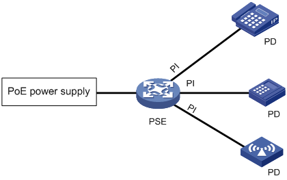

As shown in Figure 1, a PoE system includes the following elements:
·          PoE power supply—The PoE power supply provides power for the entire PoE system.
·          PSE—A power sourcing equipment (PSE) detects and classifies powered devices (PDs), supplies power to PDs, and monitors the PD power and connection status. PSEs include endpoint PSEs and midspan PSEs.
PSEs for the device are endpoint PSEs. A PSE can be a device with only one built-in PSE, or it can be a PoE-capable interface card or subcard on a device. A device with multiple PSEs uses PSE IDs to identify different PSEs. The display poe device command displays the mapping between a PSE ID and the slot or subslot number of a PSE.
·          PI—A power interface (PI) is a PoE-capable Ethernet interface on a PSE.
·          PD—A PD receives power from the PSE.
PDs include IP telephones, APs, portable chargers, POS terminals, and Web cameras.
You can also connect a PD to a redundant power source for reliability.
Figure 1 PoE system diagram

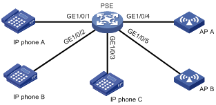

PoE configuration example
Network requirements
As shown in Figure 2, configure PoE to meet the following requirements:
·          Enable the device to supply power to IP telephones and APs.
·          Enable the device to supply power to IP telephones first when overload occurs.
·          Allocate AP B a maximum power of 9000 milliwatts.
Figure 2 Network diagram
Configuration procedure
# Enable PI power management.
<PSE> system-view
[PSE] poe pd-policy priority
# Enable PoE for the PSE.
[PSE] poe enable pse 4
# Enable PoE on GigabitEthernet 1/0/1, GigabitEthernet 1/0/2, and GigabitEthernet 1/0/3, and configure their power supply priority as critical.
[PSE] interface gigabitethernet 1/0/1
[PSE-GigabitEthernet1/0/1] poe enable
[PSE-GigabitEthernet1/0/1] poe priority critical
[PSE-GigabitEthernet1/0/1] quit
[PSE] interface gigabitethernet 1/0/2
[PSE-GigabitEthernet1/0/2] poe enable
[PSE-GigabitEthernet1/0/2] poe priority critical
[PSE-GigabitEthernet1/0/2] quit
[PSE] interface gigabitethernet 1/0/3
[PSE-GigabitEthernet1/0/3] poe enable
[PSE-GigabitEthernet1/0/3] poe priority critical
[PSE-GigabitEthernet1/0/3] quit
# Enable PoE on GigabitEthernet 1/0/4 and GigabitEthernet 1/0/5, and set the maximum power of GigabitEthernet 1/0/5 to 9000 milliwatts.
[PSE] interface gigabitethernet 1/0/4
[PSE-GigabitEthernet1/0/4] poe enable
[PSE-GigabitEthernet1/0/4] quit
[PSE] interface gigabitethernet 1/0/5
[PSE-GigabitEthernet1/0/5] poe enable
[PSE-GigabitEthernet1/0/5] poe max-power 9000
# Connect the IP telephones and APs to the PSE to verify that they can obtain power and operate correctly. (Details not shown.)
