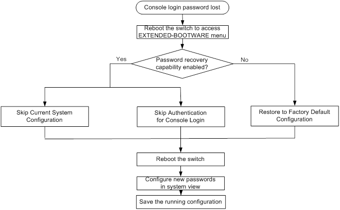

<5> Restore to Factory Default Configuration
Restore the factory-default configuration.
Restoring the factory-default configuration
<6> Skip Current System Configuration
Skip the configuration file at the next startup.
This option is not available if password recovery capability is disabled.
Skipping the configuration file at the next startup
<7> BootWare Operation Menu
Back up, recover, and upgrade the BootWare image.
Managing the BootWare image

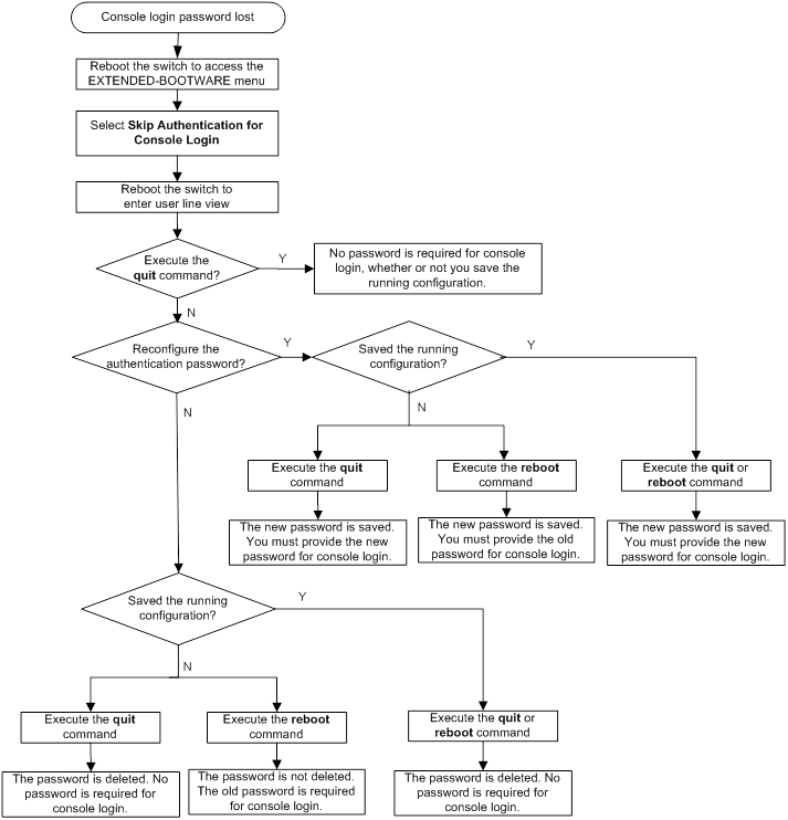

<8> Skip Authentication for Console Login
Enable console login without authentication.
This is a one-time operation and takes effect only for the first system boot or reboot after you choose this option.
Skipping console login authentication
IMPORTANT
IMPORTANT:
·      To perform this task, make sure password recovery capability is enabled. If the capability is disabled, you cannot perform this task.
·      Perform this task only if the switch has one MPU. If the switch has two MPUs, you cannot skip console login authentication.
If you cannot remember the console login password, enter 8 in the EXTENDED-BOOTWARE menu, and then enter 1 or 0 in the EXTENDED-BOOTWARE menu. The switch will reboot and load the next-startup configuration file with the console login password ignored.
Enter your choice(0-9): 8
Clear Image Password Success!
After the switch starts up, you can configure a new console login password and save the running configuration so the new password takes effect (see Figure 1). If you do not configure a new console login password, the old password continues to take effect for the subsequent reboot.
Figure 1 Skipping console login authentication

Disabling password recovery capability
Password recovery capability controls console user access to the device configuration and SDRAM from BootWare menus. This feature also decides the method for handling console login password loss (see Figure 2).
If password recovery capability is enabled, a console user can access the device configuration without authentication to configure new passwords.
If password recovery capability is disabled, console users must restore the factory-default configuration before they can configure new passwords. Restoring the factory-default configuration deletes the next-startup configuration files.
To enhance system security, disable password recovery capability.
Figure 2 Handling console login password loss
Table 13 summarizes options whose availability depends on the password recovery capability setting.
Table 13 BootWare options and password recovery capability compatibility matrix
BootWare menu option
Password recovery enabled
Password recovery disabled
Tasks that can be performed
Download Image Program To SDRAM And Run
Yes
No
Load and run Comware software images in SDRAM.
Yes
No
Yes
No
This is a one-time operation. It takes effect only for the first system boot or reboot after you choose this option.
This option does not delete the configuration file.
No
Yes
Delete the next-startup configuration file and load the factory-default configuration.
Download Files(*.*)
Yes
No
Download a file to the current storage medium.
To disable password recovery capability:
Step
Remarks
1.       Enter system view.
N/A
2.       Disable password recovery capability.
undo password-recovery enable
By default, password recovery capability is enabled.
When password recovery capability is disabled, you cannot use BootWare menus to downgrade the device software to a version that does not support the capability. You can downgrade the device software to the version at the CLI, but the configured BootWare menu password becomes effective again.
